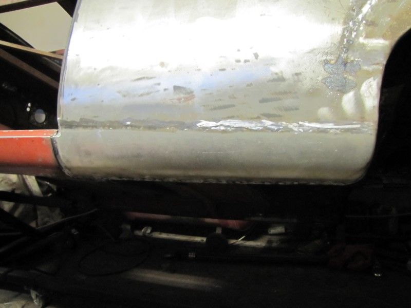

    Here is a little update:
    I cut the rocker so low that was necessary,i didnt want to mess the quarter panel at this point.The inner rocker was pitted,so i fabricated new one:
    I had to replace lower piece of the inner fender too.My beadroller's tipping dies really ****,so i had to make it from 2 pieces.Those damn tipping dies made me really pissed off and right after i got it done i bought better ones from ebay.Thats the way i gather my tools,get pissed off and then some quality time on ebay...
    I fitted the replacement with clamps and clecos.I used the clecos in the batterybox project too.What a brilliant invention,works like a wiener in wc:D
    And its done.I really i hope this was the last rust issue on the body.
    Well,there is some door corner rounding and rocker seam smoothing project in the future,but i'll mess with them when the body is back on the frame.

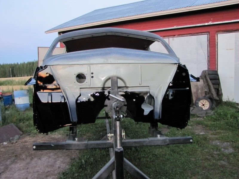

    Looks good! Could you take some closer pics of how you have the body mounted on the rotisserie? I want to do that but I've heard these bodies are too weak for it. Looks like I heard wrong! How long is the mounted rotisserie? Thanks!
  12. Finnrodder
    Joined: Oct 18, 2009
    Posts: 2,970
    Finnrodder
    from Finland
    Thanks!
    I shot pics of the rotisserie mounting,the front mounting:
    And rear:
    Shoebox body is a kind of tricky to mount on rotisserie,the trunk lid area is curvy and the front body mounting legs are on the way.
    So its difficult to bolt it to the rotisserie from firewall or from the trunk lid/tail light area.
    I made that rotisserie completely adjustable.So i can mount bodies from firewall/trunk lid area or from under on rotisserie,by using the same mounting parts i've made.
    That rotisserie is 5 meters(16,4 feet)long when its in the full lengt.The length is adjustable too.
    I mounted it on the rotisserie by using the floor braces at front and from back i mounted it to the trunk floor subframe.
    I guess these bodies are flexy,but welding a bracing inside of the body will help.
    I made an extra bracing for the inner rocker job too,but its cut off on the pics above.
    Well,i hope those pics help you.

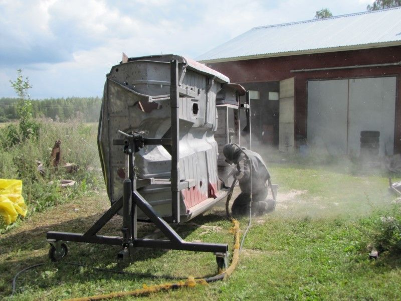

    Its been really hot in this week too,but we started the sandblasting operation anyway.
    The brothers i've known since they were kids,came to help me with their late dads portable compressor and sandblasting gear.Work in progress:
    The rotisserie was a great help in this job:
    Almost there:
    It was a really close call.We were almost done,when we hear thunder and it started to rain.We pushed the rotisserie back to garage asap when first raindrops hitted on the ground.
    The body got few drops too,but luckily it was really hot day and the drops dried immediately from hot steel.Looks like there is no harm done with the rain.
    Unfortunately the blasting revealed few spots that needs fixing and i need to buy more primer.But the plan is to get the body primered asap.
