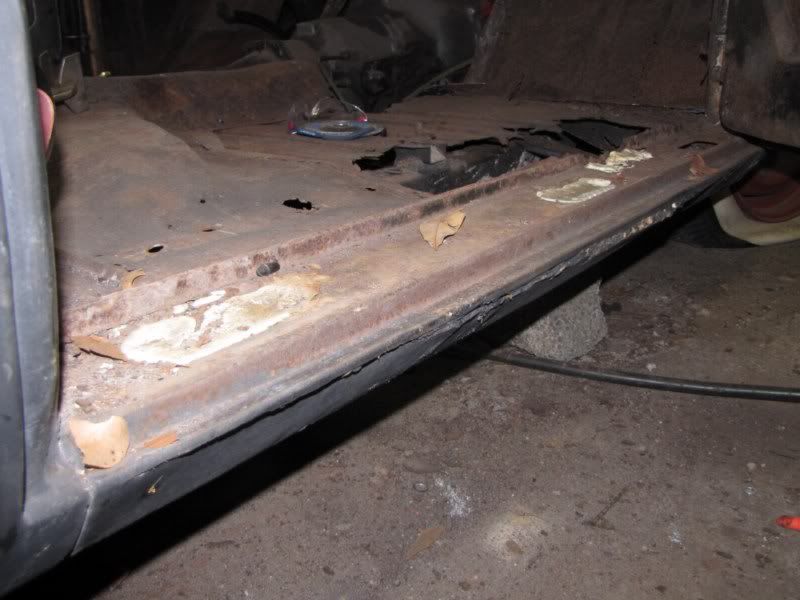

    I am not sure is this thread really a worth of printing how to build your shoebox guide.There are few things that i would do differently,but no way i am going to change anything at this point.
    One mistake was that i tried to save so much POS floor pans that was possible,that caused some problems later.If your floorpans are ****,they are ****.No mercy for crispy panels,cut all of them all off and fab completely new floorpans.

  21. Yep, me too, should have just cut the whole damn floor out. Same with the wheel wells, you replaced yours, I worked around my crusty ones and now I wish I hadn't. There's a lot of stuff I would like to do better, but I'll save that for the next build.

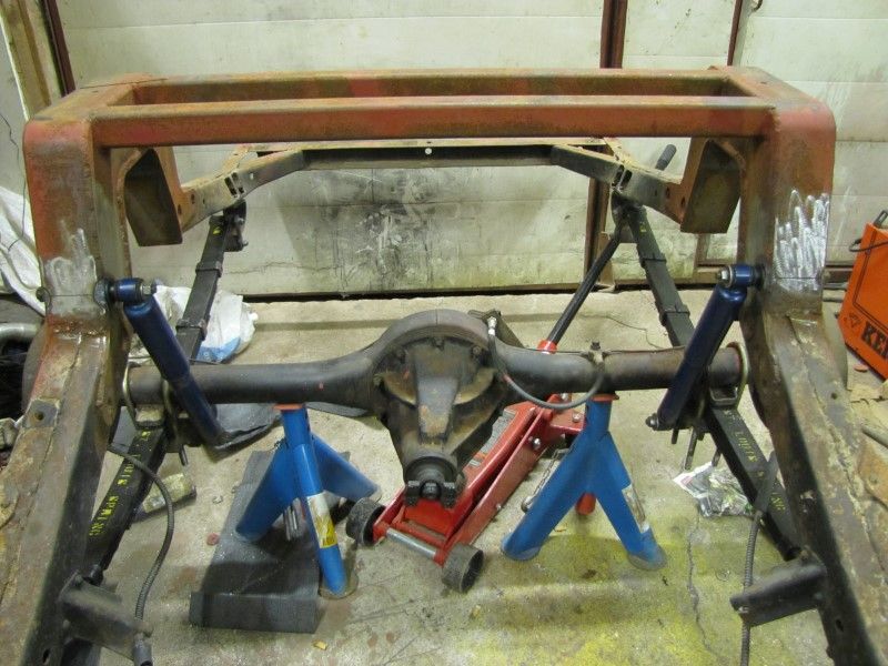

    I made these simply sleeves with a lathe.
    The outer hole is smaller than the shock side hole,just to get the stud nuts seat better.
    After some tig welding i got the rear shocks mounted with the OEM shock studs:
    And i also notched the crossmember too:
    I guess its time to start dis***embling the frame for the sandblaster,before the weather gets colder in here..
