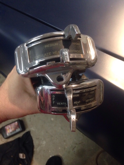

    So you don't need one of these too? ImageUploadedByH.A.M.B.1423843800.278098.jpg
    I have an extra.

    Looks like there is no need for the heat/air control unit,but thanks for the offer again,i appreciate it!
    The one i have on the dash is a bit different than yours,its not so curvy than those in the pic and its located below the gauge clusters left side on the dash.And its in OK condition,the levers move fine.Only one cable clamp is missing,but i dont think thats an issue.
    I guess those your control units are from '50 and they are mounted under the dash,on the right side of the gauge cluster?

    Yes controls are 50. Before I put my heater back in I ran the 49 type mounted to the steering column. The controls mount right under the ignition area.
  25. I'm pretty sure I have extra '51 control cables if you need them. I'll take a look today.

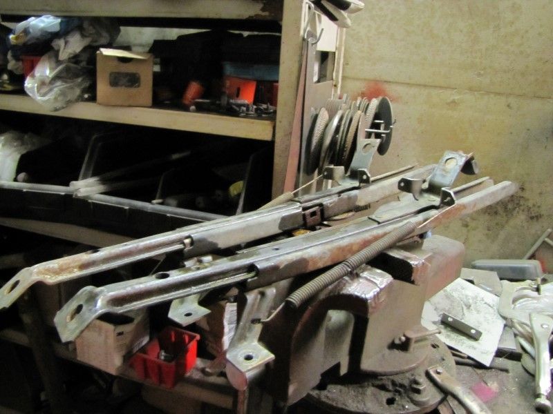

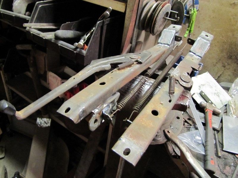

    I've been thinking what to do with the benchseat tracks.The seat i bought is from '50 and the tracks wont seat properly on the '51 floors.And the seat adjusting rod that runs across under the seat is a real pain in the ***.It just hits on the transmission tunnel.I guess it works fine with the factory tunnel,but not with a modified ones.
    So i thought that wire operated seat tracks would work better.I didnt want to spend 100 bucks for a pair of universal tracks,that are made in China.
    So i asked my bro does he have any extra seat tracks.He got few pairs from Chevy's and i decided to use Chevy pick up tracks,they have the most simpliest design.He gave me these tracks free,thanks bro!
    Next i made some seat mounting pieces:
    And cut off the GM factory mounts and welded my own versions on the tracks:
    And now i have a wire operated shoebox bench seat:

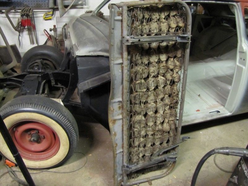

    Next i have to make a mounting brackets on the floor...

    I made brackets for the seat tracks and the tracks worked fine.The problem was the seat height,i just couldnt get it correct height because of the raised transmission tunnel.So it looks like i have to make a slight notch for the seat frame.And i have to make a new pair of those damn brackets too.Sometimes things just dont go like they do in the movies..
