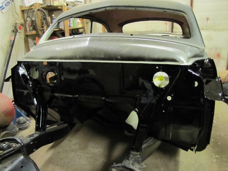

    The weather is getting colder and this job had to be done before its impossible thing to do in the garage that isnt 24/7 warm.
    The deal was that the firewall needed paint.There is no point to bolt powdercoated parts on the car,if the firewall is still in primer or on bare metal..
    Like i've said before,i just cant paint a **** so i asked friend of mine to help me with the paint job.The firewall is sanded and ready for primer:
    No pics of the primered firewall,but it looks like this after a fresh coat of paint.Its the same stuff i used on the bottom of the car:
    The inside of the firewall got some fresh paint too:
    Too bad that i forget to do the panel sealing,so thats why only the top of the innerside is painted at this point.
    Thanks for the help,Janne!

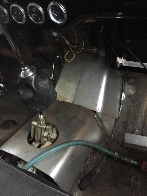

    The SBC with the 700r4 eats up a lot of floor room. To save money I ended up making my own transmission tunnel out of 18 gauge. Only thing I wish I did different was maybe roll some panel flanges. Once it is fully welded it should stiffen up pretty good. ImageUploadedByH.A.M.B.1446407339.159583.jpg

    Yeah,i modified the transmission tunnel,but i had PG on car back then building the tunnel/floors.I left extra room,so i guess its not an issue.
    Thanks!
