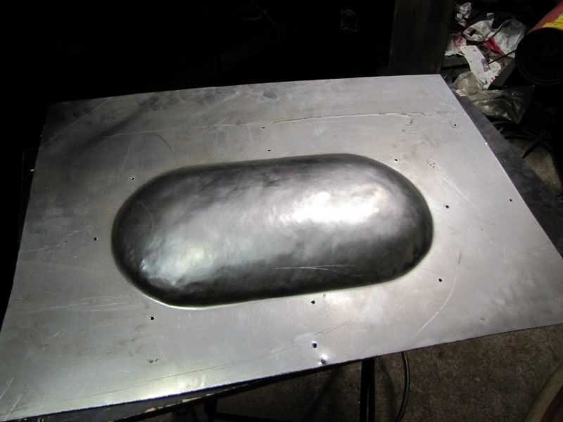

    I thought that i wont post any boring details how i did it,but whatta hell..
    I have to say that i am not much a carpenter,my carpenter skills are pretty much limited on chopping wood for sauna heater.But making templates from thick plywood isnt that hard.
    So,first i made these:
    Then i put a piece of sheetmetal between the templates and screwed them together.
    And beat the **** out of it with a domed teflon hammer.I noticed that the hammers i have,have pretty small radius,so it took forever to get it done:
    And here its after the beating:
    After that i made visit to my friends paint/bodyshop and gave a little finishing touch with the planishing hammer.I guess there are a lot easier ways to make notchings on panels like that,but i thought it could be a great practise to do it by this way.

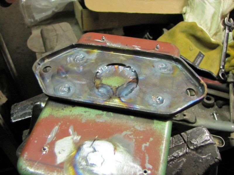

    And now a little update.
    I split the blister:
    The OEM panels bottom was so crispy,that i decided to make a new bottom of the split blister.Made some measuring and marked it before braking it.
    And after that welded it with tig.I guess that is deep enought:
    I havent checked out how ****py the p***engers side panel is,but i remember that it was better.If so,i think i dont make a whole new bottom part,but we'll see..

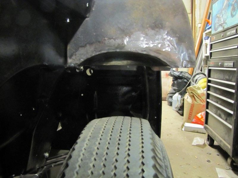

    Anyway,after the heater was put in pieces,i finished the p***engers side panel.
    I guess there is enought space on this side too:
    The p***engers side panel was a bit wider than the drivers side,but there was enought stuff around the blister,so i was able to make it as a bottom part too:

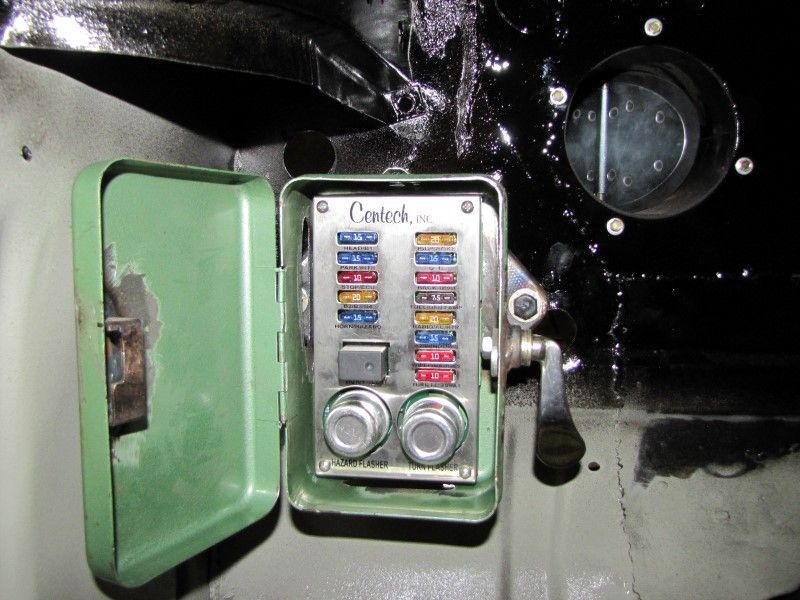

    Not a huge update,but something anyway.I had to relocate the little cashbox that i converted to fusebox,because the fresh air channels are back on the firewall.
    I made this bracket,the drivers side "blister" panel is bolted on the bracket.
    And i made a mounting bracket and welded it on the backside of fusebox:
    And here it is:
