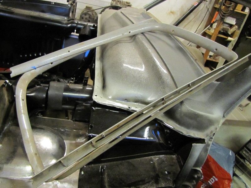

    I mocked up the dashboard,that will help me to figure out how to modify the steering column.The ***embly/dis***embly game is on again,i guess i have to mock up the dashboard few times before the final ***embly..
    Anyway,i noticed that i havent chopped the windshield garnish mouldings yet:
    So i cut them up and tig welded them back together:
    I guess those were the most easiest ones of the garnish mouldings to chop.
    I bought all the garnish mouldings few yrs ago and i dont remember were the center clips included in the deal,i didnt find them so they are not in the pic.
    Well,maybe they are in somewhere of my stash.

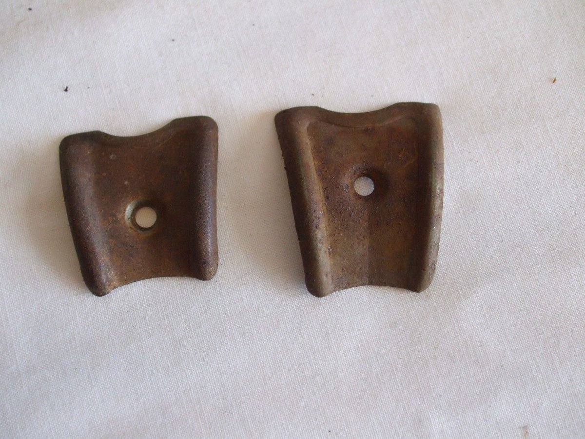

    Yeah,there are supposed to be a clips on the center like these:

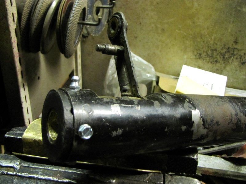

    The bearing chamber idea didnt work at all,so i made the new steering column bushing from plastic and inner bushing from br***.A kind of amateur ****,but it'll work:
    I secured the bushing with few screws on the column and put a grease zerk on it too:
    And mocked it up on the car:
    Looks like the dual u-joint i bought,doesnt work with this setup.So i have to buy an another one.Too bad that Borgeson is moving their business to South-Carolina at the moment,so i havent seen their products available now.Hell no i am not going to buy any Chinese ****,so i guess i have to wait for awhile..
