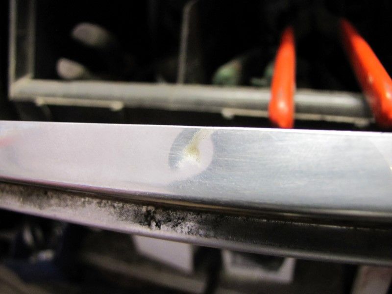

    I guess the biggest problem was this at the drivers side:
    A damn nasty ding on the middle of the vent window post.I decided to try to fix it and spent around 50 bucks for the jewellers hammers and an anvil plate.Those hammers worked fine and after filing,sanding and polishing it,i think its good enought.The vent window frame modification took less time than fixing than damn post.
    So here it is,my very first chopped vent window ***embly ever:

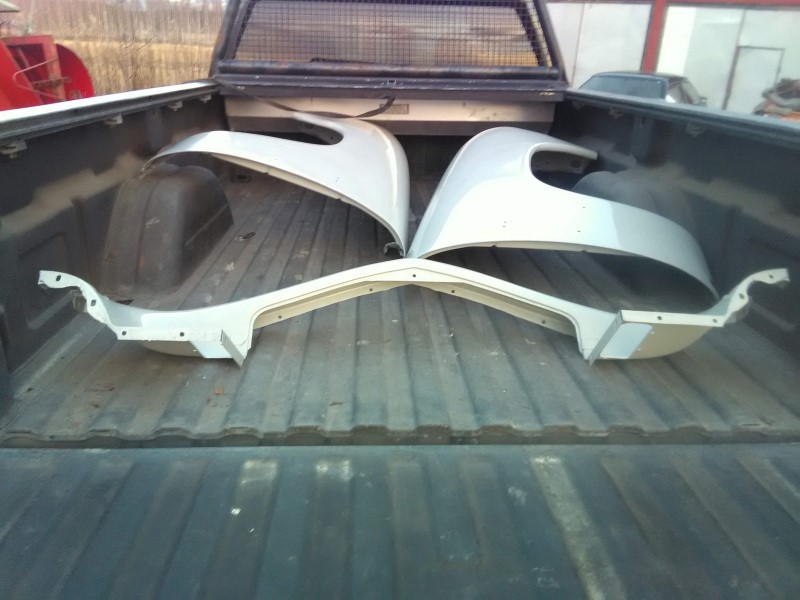

    I dont usually upload anything from my phone,so i guess i've forgotten this photo.After i got home from LA,i picked up my fenders and Merc' grille surrounding.Its an old pic,but better late than never..
    Sure they need some work,but atleast they are primered.

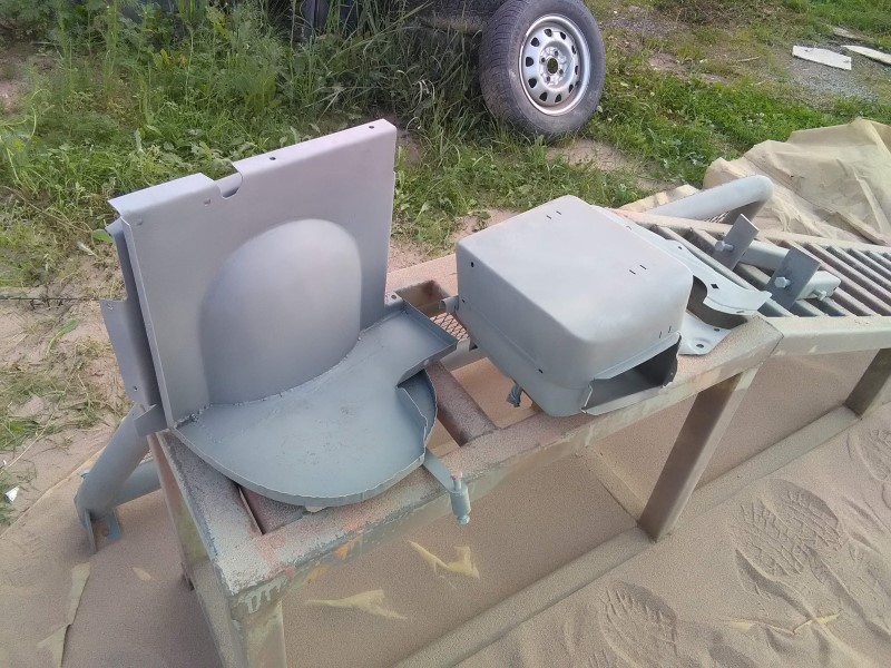

    We had few sunny days when i was on vacation,so i did some sandblasting and took an another batch of parts for powdercoating.They offered a zinc plating for those parts too,i never know that they had that stuff too and i have used their services almost 10 yrs..

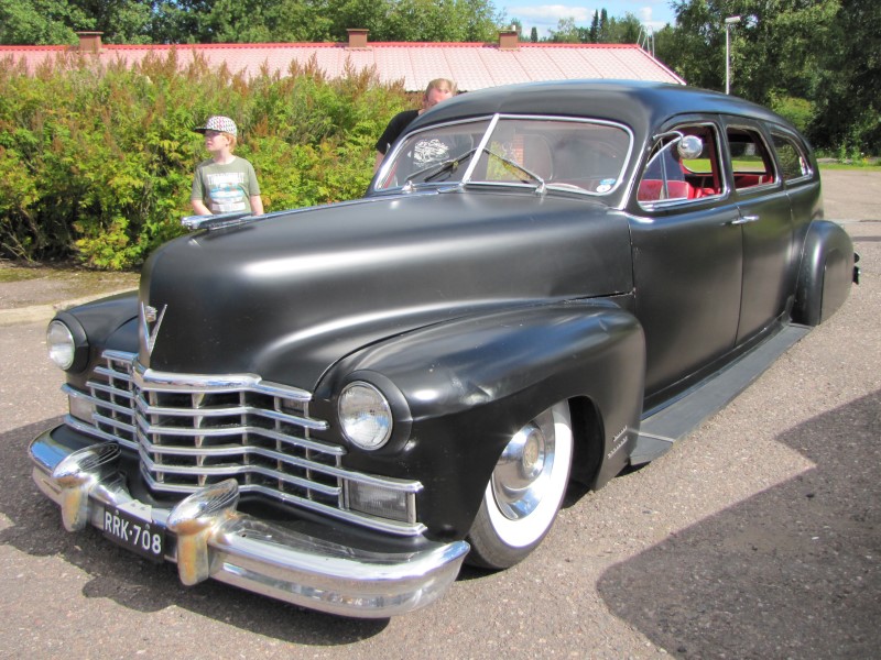

    Well,only '46 Cadillac he**** i know in here is mr.Luntamo's He****,i guess thats the same car?
    .Its a pretty cool ride and it was at our clubs car/bike show 2 yrs ago.They chopped it,but with a good taste.Here's a pic of it from our Riverside kustom day.
