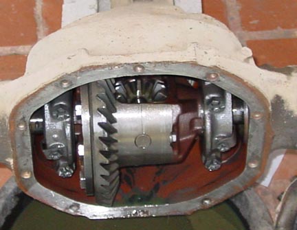

    Hi. I know this thread is 10 years old but is that first picture with the cover off of the axle a Ford Auburn 8" ?

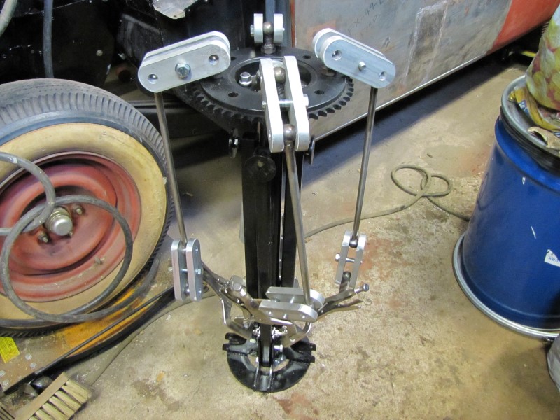

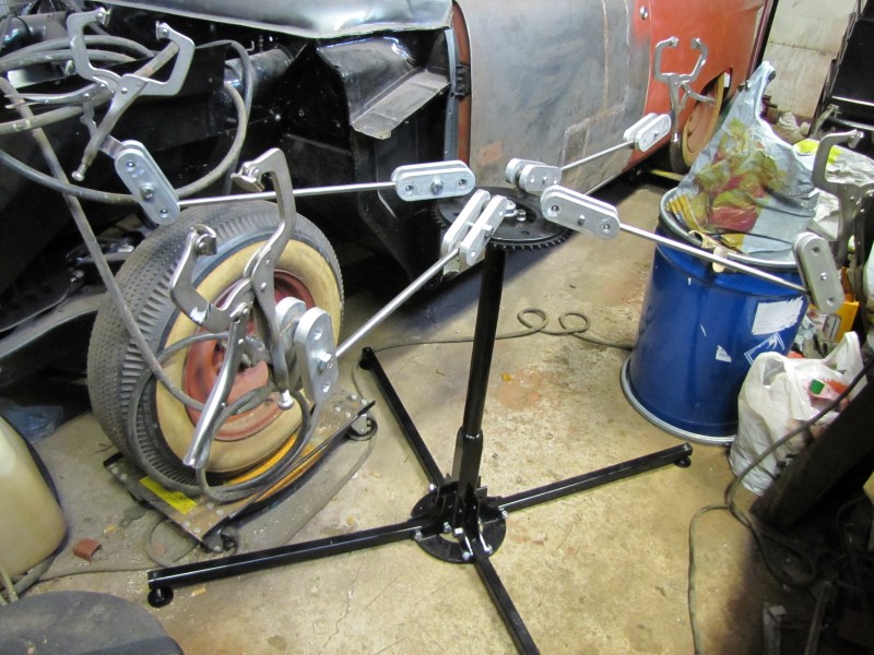

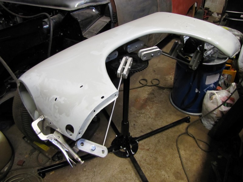

    Its been a really long time since i've updated this thread. The last year was kind of quiet with the build. Mostly because some personal shite i had, but looks like there's some light again at the end of the tunnel. I've been thinking about making a somekind of adjustable and rotating body panel stand, where i can mount fenders, doors, trunk lids etc. So i made this one:

    Very cool contraption !

    Well, i guess some people think its completely waste of time to build gadgets like that. But if i need it in the project, its a progress in my books...

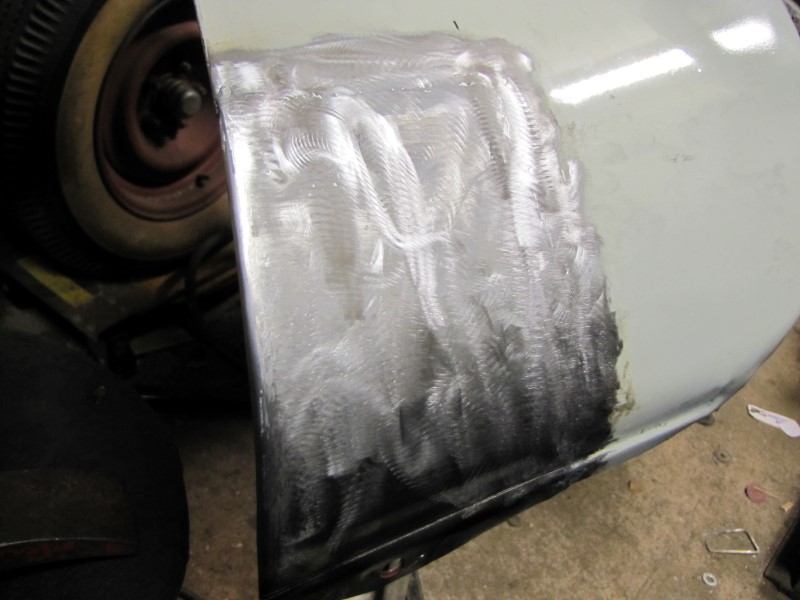

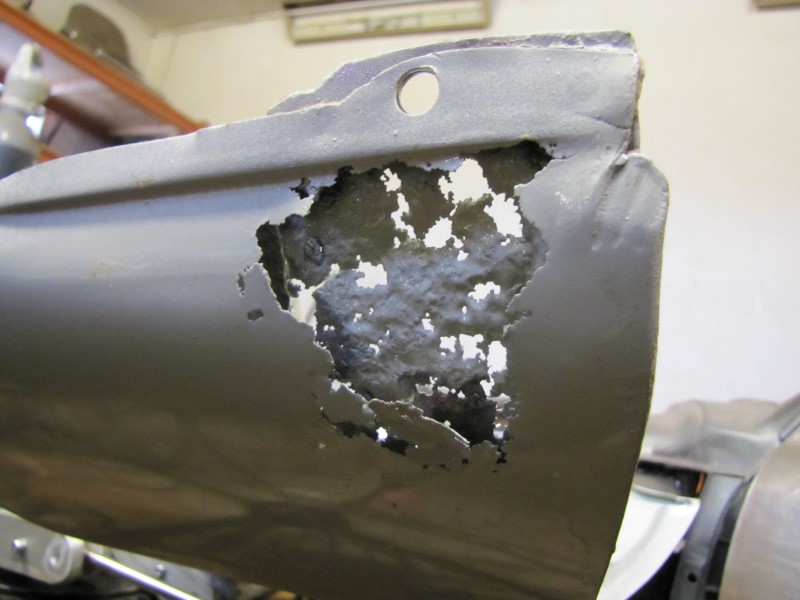

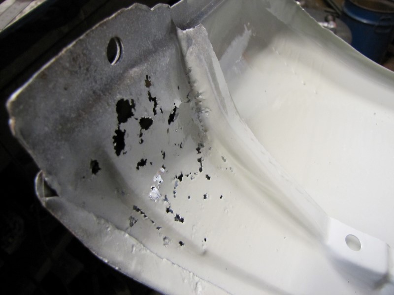

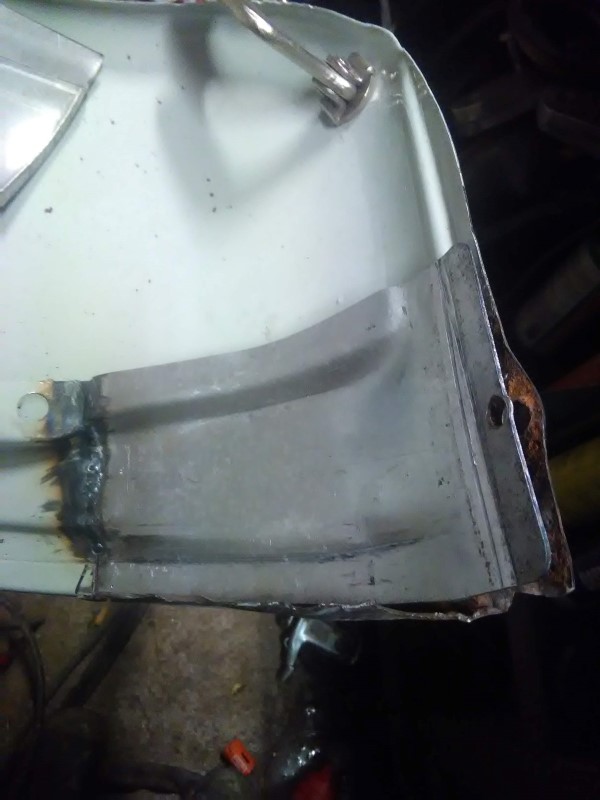

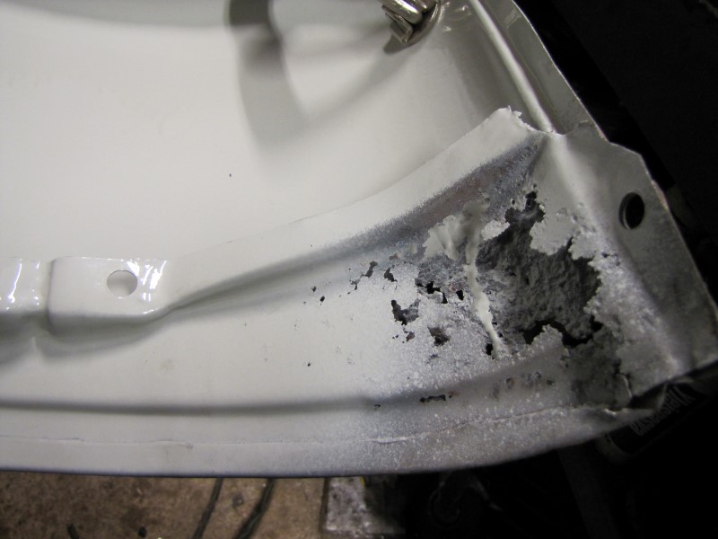

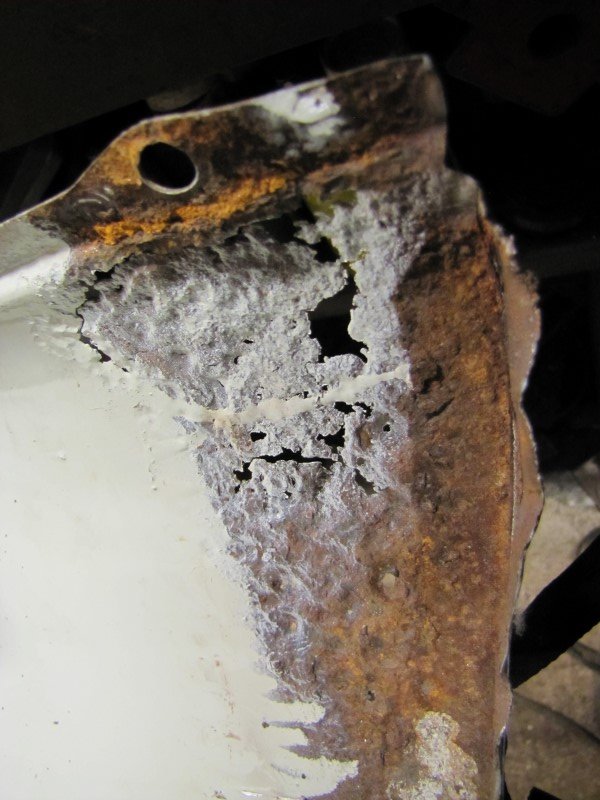

    Anyway, the front fenders i have, had some rot in the lower corners. So,they needed some patch job.
    Thats the spot that usually rottens first, so nothing new in this case. I bought a repair pieces for the fender braces. Those are a kind of tricky to make, so its just easier to buy them. The outer skin piece was a lot easier thing to do, so i made it by myself.

    You make it look so easy! I didn't even know those brace pieces were available.

    The brace repair pieces are from company called EMS. Their products sure make life a bit easier. They sell floorbraces too, an another thing thats tricky to fabricate.

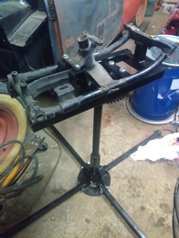

    This isnt exactly a project update, but i borrowed a hacked up Harley frame piece from a friend of mine and did a Harley frame adapter for the stand too. I guess that will be handy at some point. Its not a frame jig, but it will make welding tabs or other stuff a bit easier job.

    Anyway, i remembered that the passenger side fender was better. Nope, same crap there than was at the drivers side. I guess that will be this weekends agenda to get that done.

    The repairs look great . Rust never sleeps, unfortunately .

    Yep, that looks about normal. I repaired both fenders and bottoms of the front doors last summer, they looked a lot like that.. On the bike- they ALWAYS get out of hand lol.

    I guess its pretty common spot on other cars too. Friend of mine visited when i was working with the passenger side fender. He is a hardcore Cadillac guy, specially with the '59's. He said that the '59's have same rust issues on same spots.
    These fenders arent the same that came with the car, i bought better pair. Well,not much better. Same rust issues, but less bondo.
    I got the passenger side done. Well, the rust issued are done. There are couple of dings that needs some hammering and i have to plug the trim and parking light holes...
