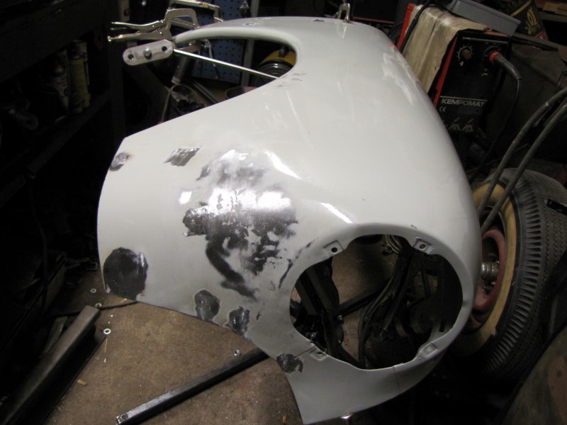

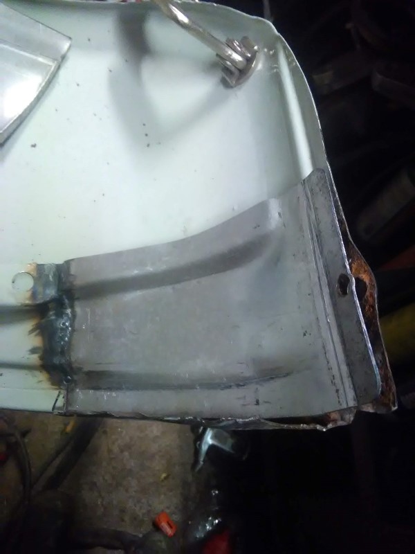

    I started plugging the fender holes. Thats not a bad job, but this one needed more attention because of couple of dents and some wrinkled metal around one of the biggest dents. I did some hammer/dolly work and i got most of it out and the wrinkles flatten too. Its not perfect, but a lot better than it was. There is some work on the fender mounting lip, but thats pretty pointless job to do at this point. I am going to cut it off anyway because of merc grille surround, so why bother..

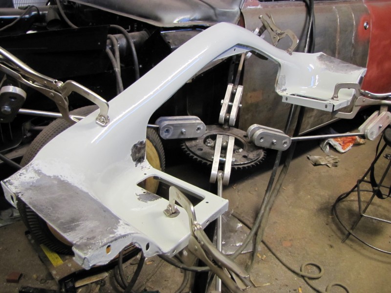

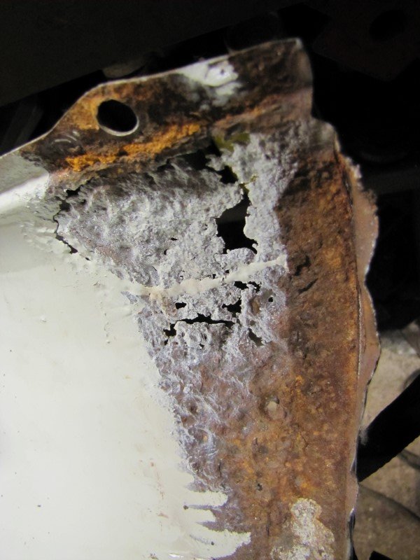

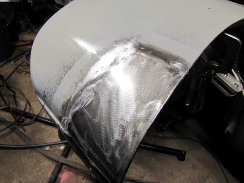

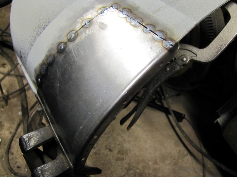

    So, the plugging saga continues. The fenders are done with the plugging job. I started to mess with the gravel panel. First i thought that i'll sandblast it, but it looked pretty solid. So i stripped with stripping discs. I found only few spots with some deep pitting and one dent. I brushed a rust removing chemical on the pitted spots, to eliminate the rust. My wild guess is that the anti-rust poison will eat the pitting so deeply that i'll have to weld couple of matchbox sized patches. The biggest surprise was that panel is better from the bottom side than it was on the top side. Kind of strange..
    IMG_5130 (Custom).JPG IMG_5134 (Custom).JPG IMG_5138 (Custom).JPG IMG_5145 (Custom).JPG

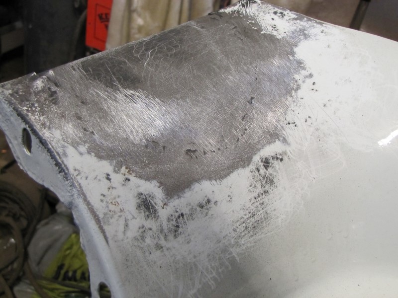

    A small update: I got the gravel panel plugged, but there was still some slight pitting. I bought a bottle of phosporic acid, a bit more HC stuff than that i brushed earlier on the panel. That should do the trick faster. I also got that dent bumped out of from the upper center left part of the panel. If the weather is fine, i think that sandblasting operation will at wednesday or thursday. I hope that plan doesnt backfire..

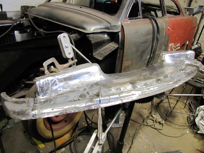

    And the plugging finale, what comes to the front end parts. So the next piece is the Merc grille surround. I guess most guys do this job when they fit the grille surround on the car. I thought it could be easier to do before the grille surround is cutted and sliced and has lost the sturdiness. I cut off the parking light humps and i cut off the OEM grille mounting (?) holes too. I dont know how they are from the factory, but those holes were stretched. I think i have to cut off around 1-2" from the both sides, where those patches are and a lot of more stuff will be cut off too..

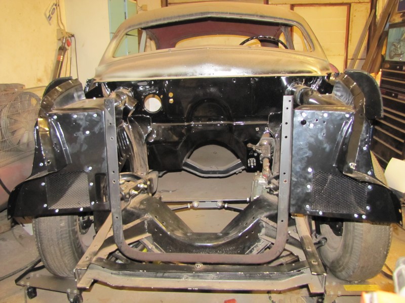

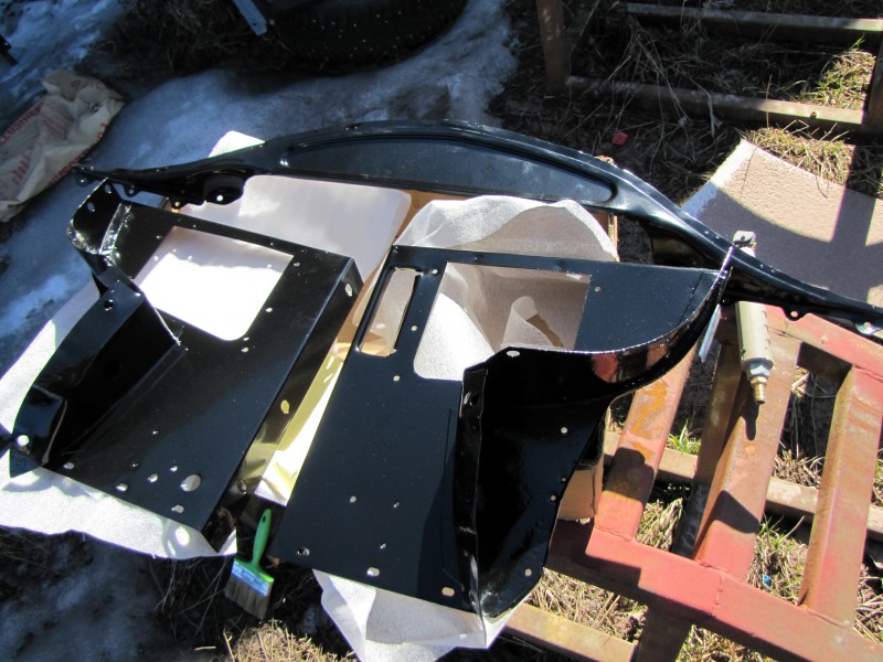

    It was faster than i thought, i picked up the panels from powdercoater at today. Thats the good news, the bad news are that there will be extra work with the fenders.
    The top mounting holes on the fenders doesnt line up with the inner fenders.I guess thats because the fenders are '50 and the original '51 fenders that came with the car, i sold them long time ago.
    So i cant compare them, i think only way to handle this is drilling new holes on the fenders. I mounted the inner fender end panels to the inner fenders and glued the anti squeak welt on the inner fender side panels.
    The welt was stapled to the side panels from the factory, so i made few "staples" from welding rod and stapled welt to the panels via factory staple holes. Sounds a bit HC restorer ****e, but that way the welt will stay on the panels when i am struggling with fenders. I bought an aluminum grille mesh for the fresh air channels. Never thought that i am going to buy a ricer stuff for the kustom project...
