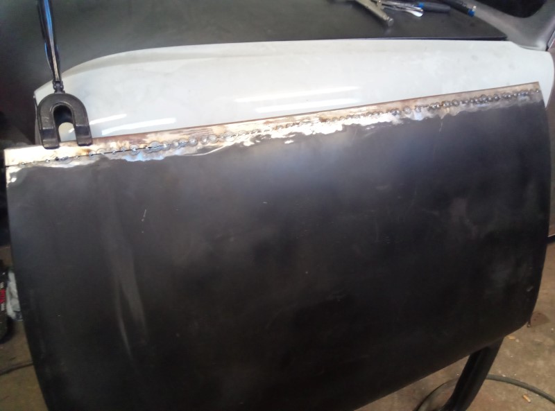

    Allrite, like i earlier posted, there are couple of spots i dont like in this door. One is this B-pilar side window frame. There's a piece of the corner missing, i think that piece is cut off because its a relief cut when making the slanted pilars to door. Its not a big thing and i guess most guys just leave it like it is, but it was annoying the **** out of me. So i had to patch it. It was cut off nicely, so it wasnt bad job to fix. I made a patch with my shrinker/ stretcher, cut some extras off and welded it. Dremel cutting discs were handy, when removing the extra material. Its a bit too tight spot for angle grinder and pneumatic cutter was too clumsy for the job. Well, here's some progress pics.

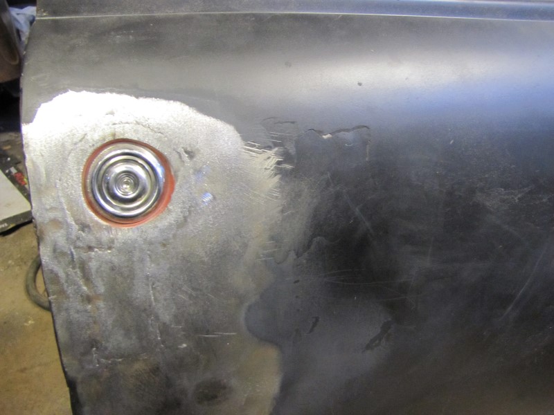

    Here's a little update. I guess it doesnt look like much, but there was a much more work than it looks in the pics.
    I guess the easiest way to shave doors, is just lapweld the bigger holes. Its one way to do it, but personally i am not a huge fan of jobs like that. The p***enger side door was shaved like this, but it wasnt a huge issue because my plan was to use the Lincoln push****ons with stamped frenching rings. I think those frenching rings are only way to do it on these cars. The door is just too curvy on the spot where push****on is supposed to be and it doesnt seat well. I made a dies for those rings and stamped them long time ago and now was time to use them. That frenching ring covered all of the lapwelded patch, so there was no problems with that. The biggest issue was below the push****on, the metals was stretched, so i cut off the stretched piece. Unfortunately there was still some extra stuff on the door and it caused some oil canning below the patch. It was a kind of ****show, but i got it done with shrinking it with heat and wet rags. I did the fine tuning with shrinking disc. I really hope that drivers side NOS door is easier than this one..

    Looks like there's more surprises with this '49 door conversion. Its not a big update again, but i guess this could be useful info for someone who is using '49 doors on '50 or '51 shoeboxes. The outer door handle is completely different and the door latch is different too. I guess most guys & gals know that. But this was new to me. I welded the '49 OEM latch holes on the door and made the conversion holes for the '51 latch. It didnt seat well and i noticed that the "pocket" at end of the inner handle ***embly channel was too deep on '49 door. I think there's not much use for the ****py '51 door, so i cut off a donor pocket and welded it to the '49 door. It wasnt a bad job with that donor piece, but it could be a lot time consuming work without any donor parts.
    So, that's an another pain in the *** with '49 doors. Here's a pic of the result.
