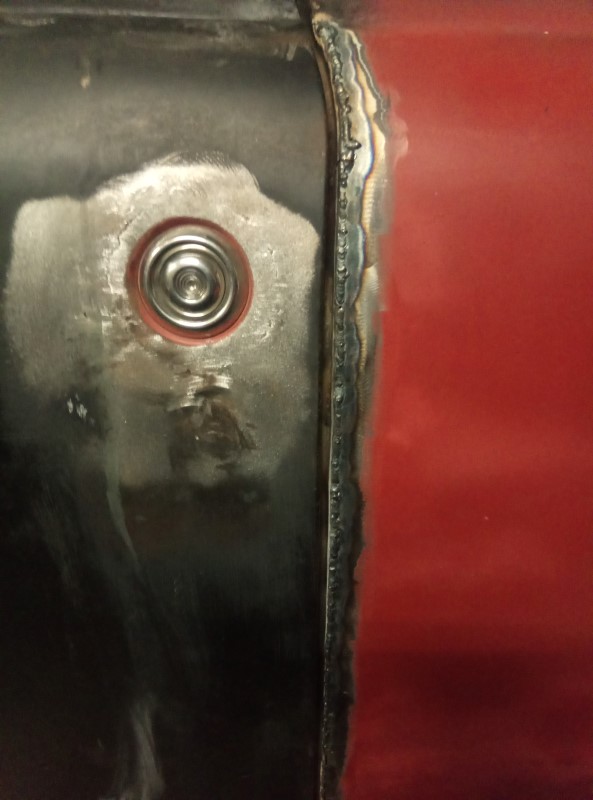

    I got the argon issues solved and bought a bottle. I counted that the refilling will be a half of the price than it was with the rental bottle. One of the things i've should done a long time ago..
    Anyway, i got the push****on frenching ring done on the drivers side door. I had to modify slightly the vent window mounting points on the door, to get vent window mounted. The vent window fits in this freshly chopped door too, so i guess i did something right.

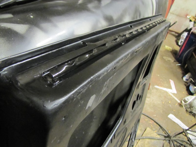

    I almost forget this one, the final piece for the p***enger side door fix. The door seal brace on the bottom of the door, that annoying wavy thing that most likely rottens first.
    There wasnt much left of it on the p***engers side door, but i made a template from the drivers side brace.
    I saw that there were aftermarket braces and they didnt cost an arm or leg, but they were sold as pairs and i only needed one.
    I bought an air nibbler while ago and it made the fabrication job really fast. I guess it might look like a bit complicated thing to do, but it was actually really easy with a template.
    I brushed some phosphoric acid based antirust stuff on that piece before painting it, maybe it will last a bit longer with that.

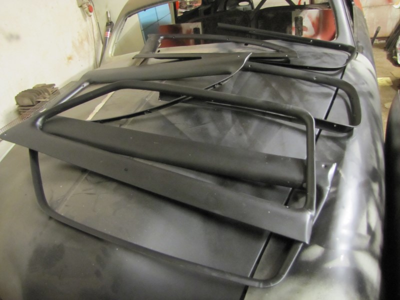

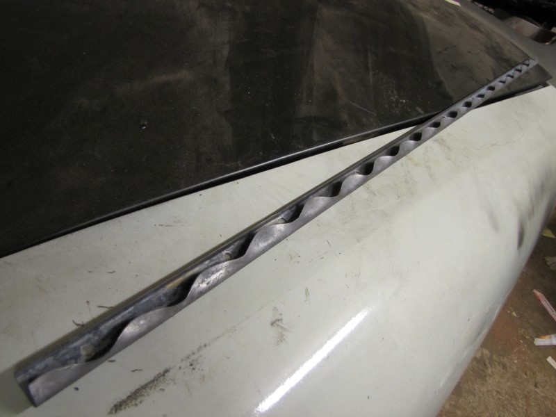

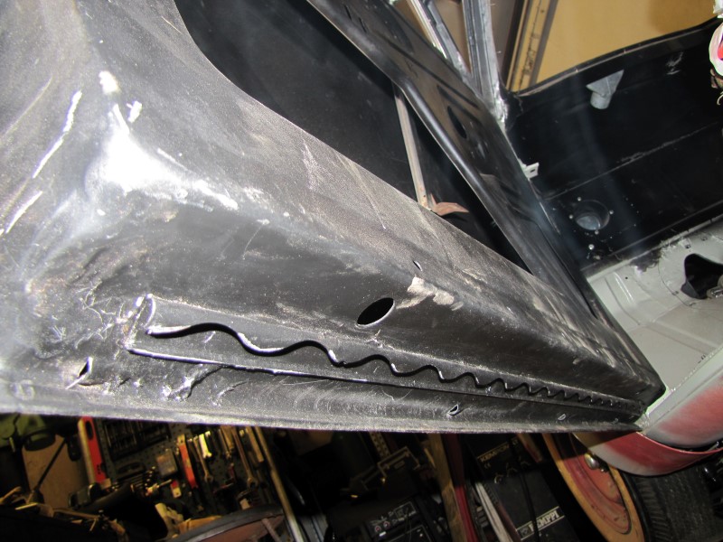

    I welded the wavy thing on the bottom of the door, so i guess most of the door is done. Well, maybe some gap filling on the latch side, but otherwise its good to go.
    I had some citric acid mixture left and i cleaned all the garnish mouldings and primered them. I think they need some finishing touch and one is still unchopped. I guess i'll mess with them awhile as a small sideproject.

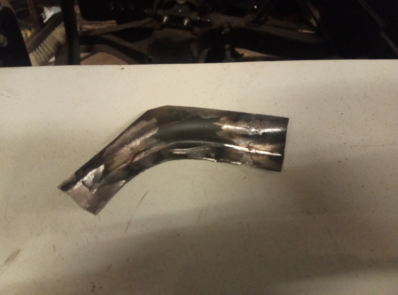

    Okey, i got the last garnish moulding chopped. I think its better than the p***engers side, that i did before. But i guess the p***enger side will better after some finishing touch. I didnt like how drivers side door garnish moulding seats on the door, so i had to do some rework on that one. Its not done yet, but its getting there.

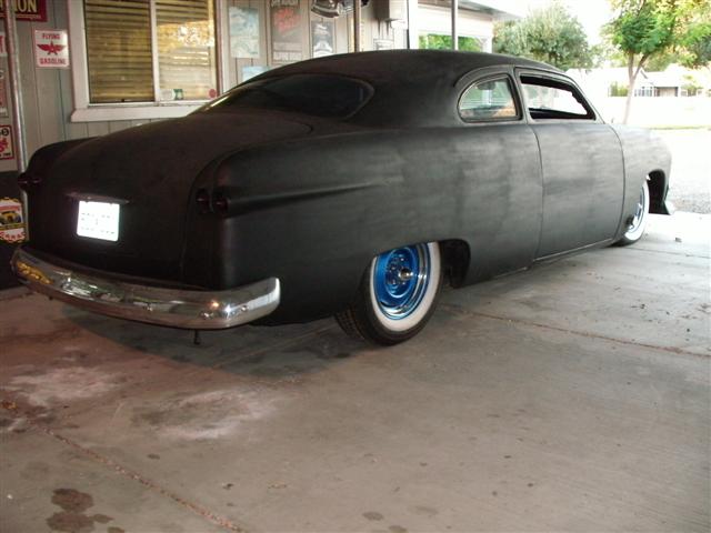

    Cool - years back i had a chopped '51 More 2 012 (Small).jpg '51 More 2 013 (Small).jpg '51 project

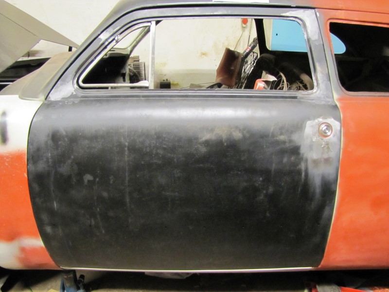

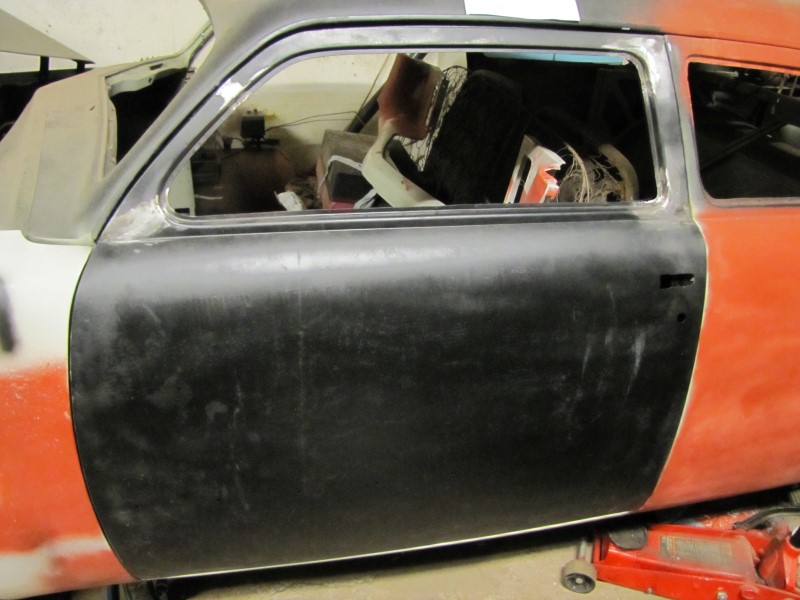

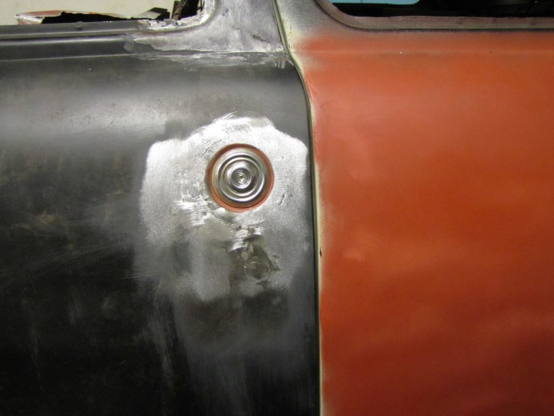

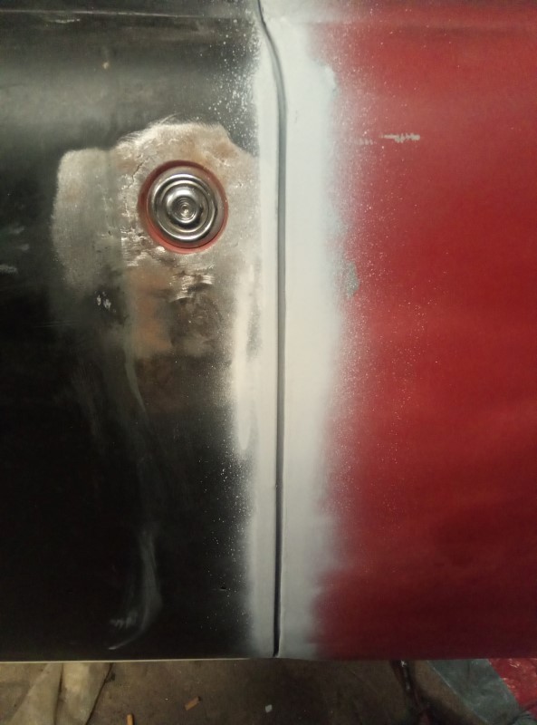

    Allrite, here's a small update. An another thing that doesnt look like much, but that took few hrs to do. So, i wasnt quite happy with the B-pilar side door gap, it was just too tight. The problem was that there was no room to move door forward and slicing the door skin wasnt the best way to do this. So i made a cut for the quarter panel to create a decent gap. This same problem is on the p***enger side B-pilar gap too.
    The p***engers side doors edge is grinded for making gap at some point before i got the car. So the problem has been there before. That edge isnt completely straight, so there will be a welding/filing/sanding operation ahead before i can cut the p***engers side quarter panel too.Here's couple of pics of the process:

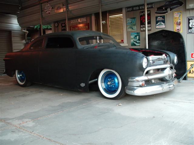

    Love shoebox fords! Here's one I traded for. Was chopped when I got it. shuboxRockys.jpg
