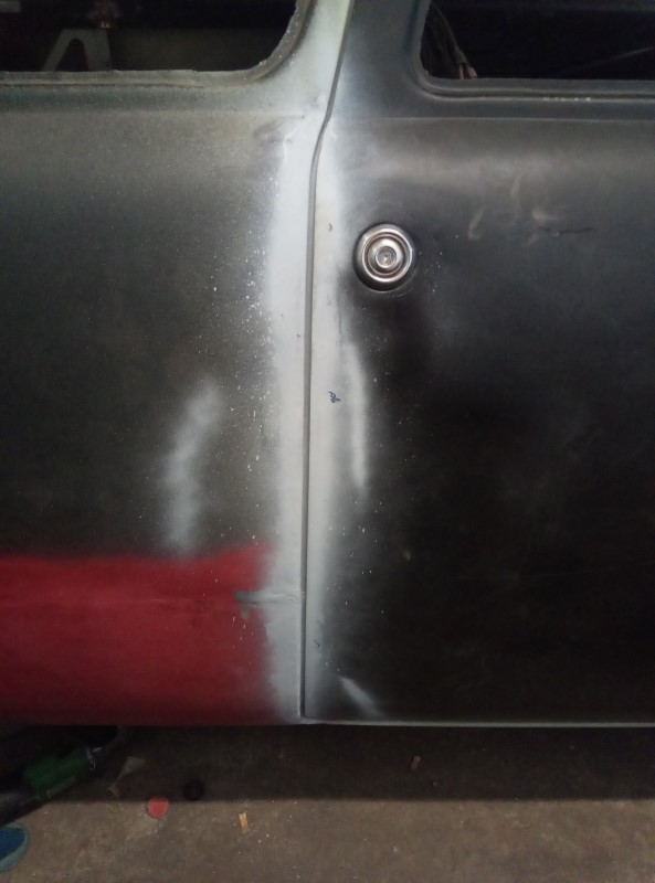

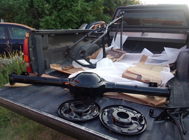

    Allrite, i guess its finally time to post an update for this thread. I got the shovelhead frame job done and i also made a small upgrade for the panel rotation device i made earlier.
    It really needed a latch, so i made a springloaded one from scratch. It was easypeacy when the shoebox fenders were mounted on that thing, but it wasnt in balance with a Harley frame, so it keeped rotating by itself.
    Anyway, i did some sandblasting, blasted some bike parts, the Maverick rear end and the brake backing plates too. Those are at the powdercoater at the moment, not sure when i'll get them back. But we'll see...
    And some building job for the project. I remember that i said earlier that the p***enger side door gap was a real mess and it sure was. Someone had tried to repair the gap by grinding the **** out of the B-pilar side door edge. It was grinded wavy and some grinds were so deep that the edge was gone. So, i spend few hrs of welding, filing, welding, sanding, filing etc with the door edge. It doesnt look like much in the pics, but if you look closely, you see the wavy **** on the edge. I was sure that it will overlap with the quarterpanel, but nope. It fits there, but the gap is too tight, like it was at the drivers side.
    So i have to do same thing as i did on the drivers side. At this point i have no plans for this weekend, so i guess this will be this weekends project.

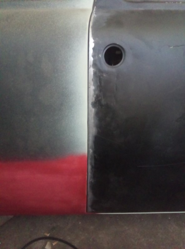

    Allrite, the weekend gap-project is pretty much done. I guess it needs some finishing touch, but atleast there is a gap between door and quarterpanel now. I didnt take pics of the process, but it was a same job as it was on the drivers side. I cut the whole quarterpanel open near the door opening, then hammered the quarter panel's door lip towards the quarter panel and welded it when i was happy with the gap. That was the only way to do it. Like on drivers side, moving the door to front was out of question. It was a really annoying job, i am glad its out of the to do-list.

    I think its more practical thing than detail thing with the decent gaps. That gap was something like 1mm (0.040) from the tightest spot, so that will damage the paintjob. Now they are around 5mm (0.20), that should be enought with the paintjob. Those gaps will shrink a bit when its painted.
    Next thing will be adjusting the hood and fenders. The fenders arent that bad, there's a decent gap between doors and fenders, but that damn hood will cause me a nervous breakdown. Well. i guess its time to do some homework how to do it.

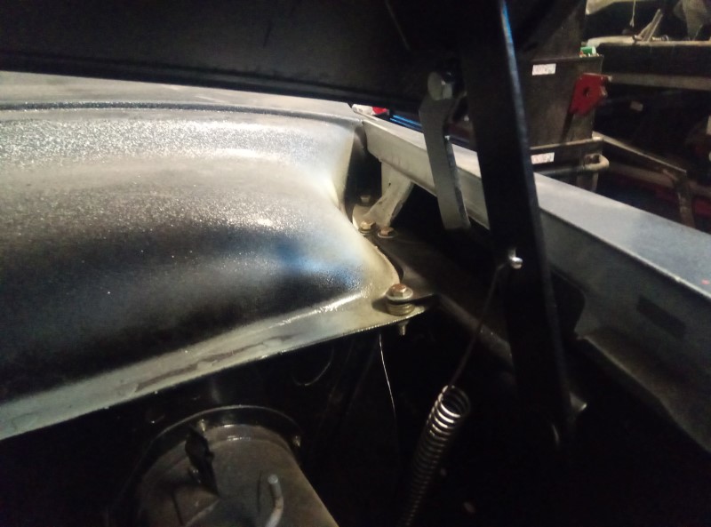

    Allrite, its getting there. I got the hood to cowl seal and it came pretty fast, only 6 days from US to europe by USPS. No corona delays in this case. Ofcourse i dont have the hood bumpers, that mounts on the fenders. I ordered them too, hopefully they come fast too.
    The hood gaps are pretty much there, but those rubber parts will tell what kind of adjusting it needs.
    I struggled a lot with the rear hood corners, they were high and it took some time to figure out how deal with them. I dont know what kind of voodoo magic they have done at the factory to deal with this problem, but i added a stack of washers under the hinge's front bolt. That made the hinge raise from the front and lowered the corner.
    I think it will work backwards too, if you have to raise the hood corner, add washers under the hinges rear bolt.
    I did some test triggering for the hood latch and it failed every second time. I think at this point is good to get rid off that piece of **** and figure out a different style latch for the hood.

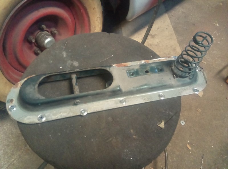

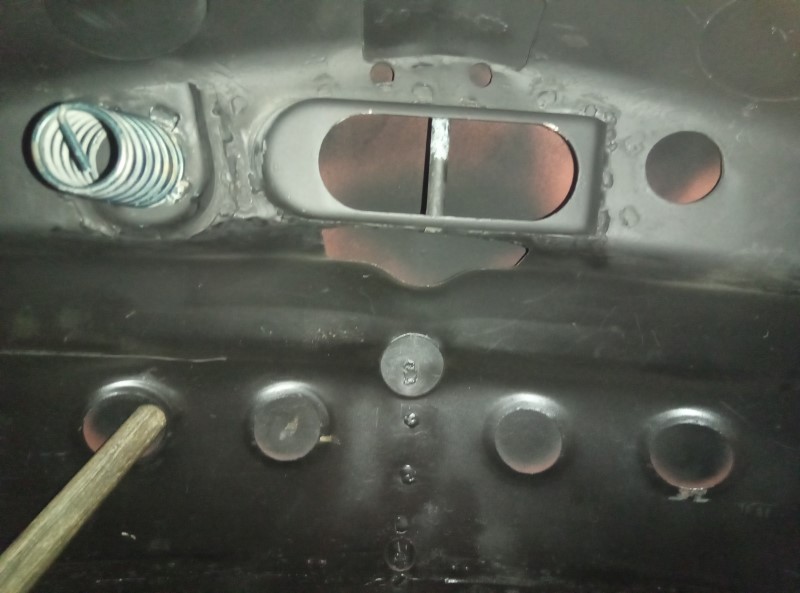

    Everyone knows that shoebox hood latches really ****s, a lot of damaged hoods and roofs because of those damn latches. I talked about this with a friend of mine, he said that have ever heard that '70-80's Chevy's had hood blown open?

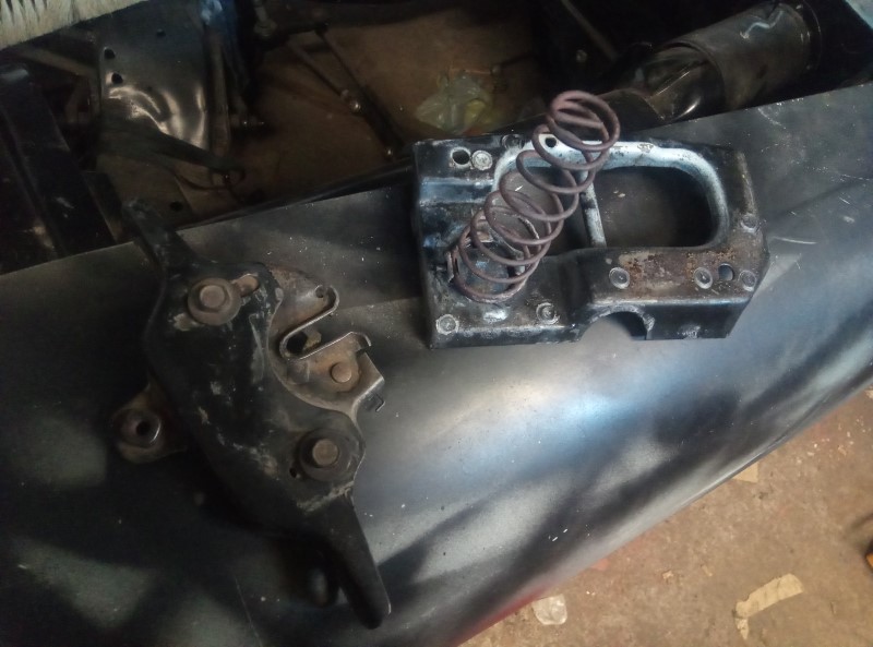

    Well, nope. I decided to try that one. He gave me a '80's Chevrolet Caprice hood latch and latch bracket as a freebie. Thanks Janne!
    So i started to mate the GM latch to the shoebox latch panel. Cut off the OEM latch piece, welded a piece of sheetmetal on that spot and slotted it for the new latch. I also made a reinforcement/ bracket mounting piece, that i welded under the latch panel.
    IMG_20200711_163253_9 (Custom).jpg IMG_20200711_163305_6 (Custom).jpg IMG_20200714_174921_8 (Custom).jpg IMG_20200714_214250_0 (Custom).jpg IMG_20200725_213942_3 (Custom).jpg
    Tony Ray, warhorseracing and brEad like this.
  25. Finnrodder
    Joined: Oct 18, 2009
    Posts: 2,970
    Finnrodder
    from Finland
    I had a ****py Caprice hood, the plan was to cut off the catch part and use that, but it didnt work like i planned. There's a pic of that catch in previous post. There's step on that part and i needed a straight one.
    So, my bro has a '95 Chevy van, that he's been tinkering. His van hood was dented and he decided to replace it. Fixing that would been a time wasting, specially when he had a better hood in his stash. Van's hood looked like a lot better candidate than Caprices was, so i bought the hood from my bro around 20 bucks and cut the catch piece off. I had to shorten it and slightly modify it to make it fit to the shoebox hood. Sides of the shoebox hood front brace are canted. The bottom part of the Van's hood spring is also a canted, so i used that one too. So the hood spring is pretty much straight now with that donor piece.
    I tried what hood spring could work better and the winner in this case is van's hood spring. Its pretty much same lenght as the OEM hood spring, and it has enought force to pop the hood open, when pulling the cable. In this case pulling the tig welding rod, that i used as a temporary hood opening wire.
    Benefits of this mod is that you can adjust the hood sideways too from the front of the hood, makes easier to get the hood gaps even from the front.
    I guess it still needs a little tinkering and adjusting, but it works fine. Just to make it safier, i think i'll get a safety latch too.

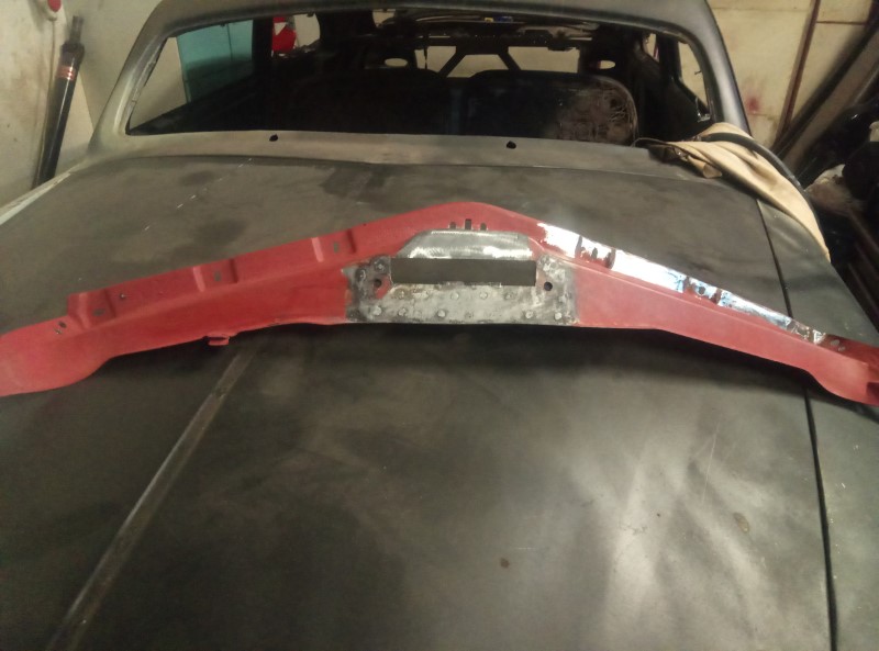

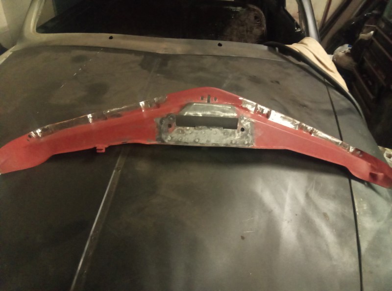

    I did some eyeballing of the latch panel and i figured out that it needs a slight modification.
    It is designed to work with the original upper grille parts and i think its fine with them.
    But Merc surrounds are a different story. The corners of the panel front lips are too much out and they could push the Merc surround forward. So easiest way to do this is just cut off the extras of the lip, but i didnt want to lose the stiffness of that panel. So i sliced them from the corners toward center and narrowed the lips a bit.
    My plan is to keep this latch panel as a bolt on piece, i think it will make front end sheetmetal aligning easier in the future. So next step will be fabricating a connecting panel, that i am going to weld on the Merc surround.
    Its a kind of interesting project, i havent never done this before. I have figured out what to to cut and what to weld from the surround, but if anyone has hints for the job, i am listening.
