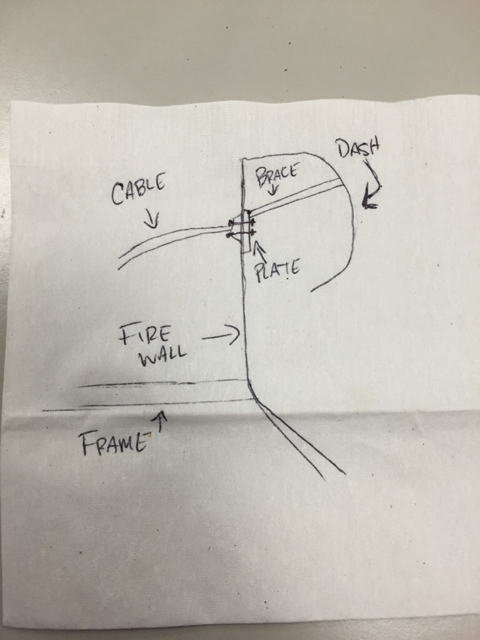

    I could use some input from you guys.
    I installed my clutch pedal, cable and firewall adjuster yesterday. ImageUploadedByH.A.M.B.1455728047.613084.jpg
    The firewall flexes every time the pedal is depressed. The weight of the clutch pulls it in probably 1/8" to 3/16" each time. I need to reinforce it from the inside somehow. I would like to do it without damaging the paint of possible.
    My thoughts are a 1x1x3/16" angle or 1/4" flat plate epoxied to the inside of the firewall. Hopefully if it is scuffed up sufficiently the epoxy will hold it. If not, I could run 2 chrome bolts through it, but I would rather not have any more bolts through my pinstriping.
    What do you guys think?

    Make a plate that mounds against the inside of the fire wall and use the existing bolt holes to mount the cable to the plate with longer bolts. Then brace the plate under the dash or to the pedal ***embly. That way you don't make more holes in your firewall. And the clutch cable isn't actually mounted to the firewall. Basically the same principle as the brake master.
    Here is a crude picture I drew on a napkin Because I'm on lunch. Haha

    Chris, your "crude" picture didn't attach brother...

    Very nice sir :)

    That is a good idea and probably stronger than bolting it to the firewall. Thanks for the idea! I'll post up my results.

    This will be epoxied to the inside of the firewall and the adjuster will bolt to it from the outside. I will still need to brace it off of the pedal ***embly as the firewall still moves quite a bit with this installed. So, that is next on my list.

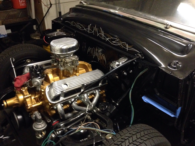

  20. Man, youre engine looks so good in that pic. ;)
    I think im going to paint mine the same color, I love it
    voodookustoms likes this.

    voodookustoms
    That's awesome. I'm into all kinds of guns, but for now I have an AR, glock 17, a little 45 back up and a hunting rifle. I'm thinking about getting my ccw and learning how to hunt soon. Seems like we have quite a few similar interests.

    I hope it can provide some inspiration like so many other people's threads have done for me. Post yours up when you start working on it.

    Thank you! I'm planning on painting the valleys in the valve covers and air cleaner in the same gold.
    I also just picked up a polished carb from a member here so it should be looking pretty clean when it's all done.

    I finally got a minute to spend in the garage tonight. I finished bracing the 3/16" clutch plate. I used some L1x1 welded to the plate and bolted through to the brake pedal ***embly. my welds look like **** since I couldn't get at the right angle with the gun, but they are strong. It should still be possible to remove some day if I ever need to and it completely got rid of the movement. Also got the tach and turn signal switch mounted back on the column. I got all the wires under the dash cleaned back up and zip tied in place. Next I'll be making a little bracket for a brake light switch.
