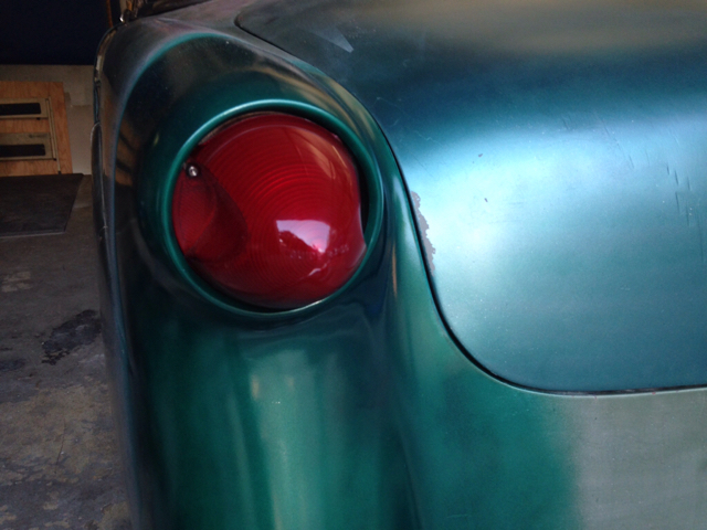

    I finished up the tail lights this weekend. ImageUploadedByH.A.M.B.1433041223.005926.jpg

  19. Pinstriper40
    Joined: Sep 24, 2007
    Posts: 3,655
    Pinstriper40
    Perfect! The only way to get that "in progress" look is to be progressing! I really dig it!
