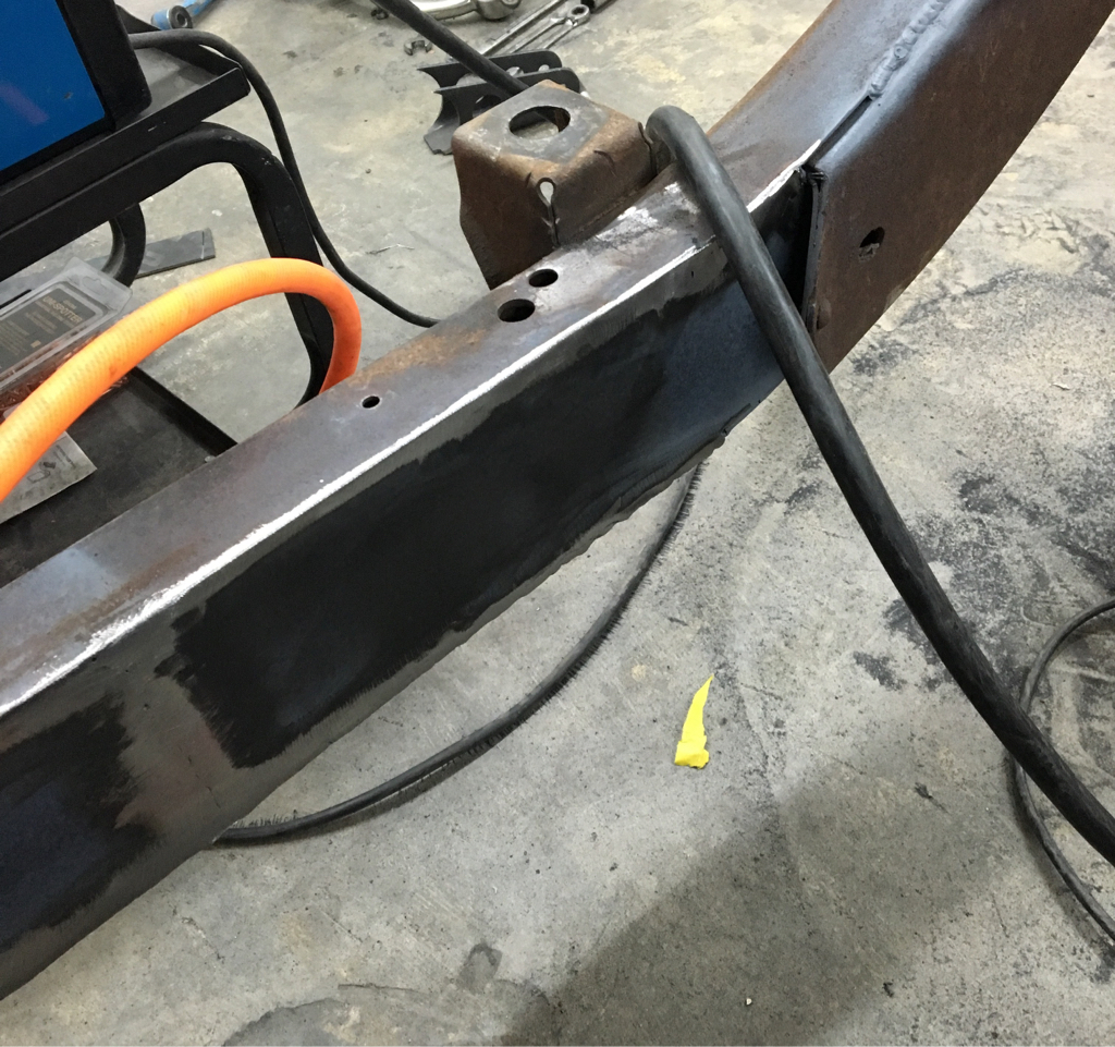

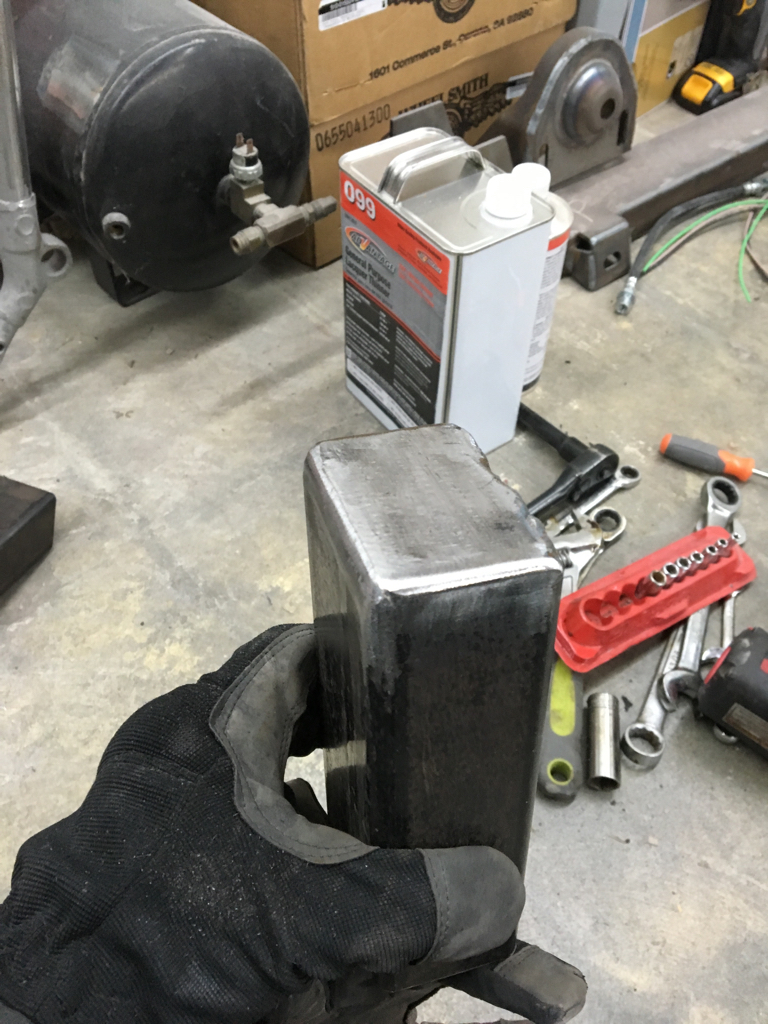

    Got to prepping for the notch . I believe these cars only need a 2 to 3 " notch to lay out on 6.70s. Since there's a coil pocket in the frame , it would make it a little tricky to reinforce on the inside if I did a baby half moon c notch. I got a killer deal on this Gambino notch with bag plates so I decided to run with it. I'll try posting as many pics as I can through out the build ... ImageUploadedByH.A.M.B.1453181947.290011.jpg
    And here's progress on my lower link ch***is mounts ImageUploadedByH.A.M.B.1453182103.084201.jpg

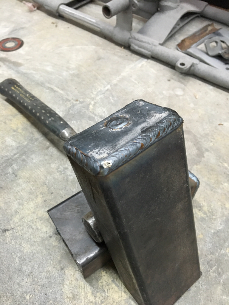

    Really nice weld......Ive only been welding for a year. Im ***uming this is MIG, but it has a nice look to it, almost TIG. Did you use a V pattern and just keep going or did you start and stop to get that overlapped look? Thanks
  14. layedout49
    Joined: Jan 15, 2008
    Posts: 483
    layedout49
    It's mig . I guess more like what people consider and e or backwards e . I've done more sheet metal work than anything so I'm not the best of help. Haha sorry, I start my weld , get it hot and move mostly from left to right (cause it's comfortable for me) and once I get the first puddle and move down and towards the top and push the weld back into my trail . I can't explain it too well but I'll help as much as I can
  15. Fender1325
    Joined: Aug 31, 2014
    Posts: 729
    Fender1325
    The backwards e makes sense. I'll have to try that. I usually make a coil from top to bottom and keep working left to right as well. I rarely work on material that heavy though - was that 1/4"?
  16. layedout49
    Posts: 483
    layedout49
    I think it's was 1/4 or at least 3/16 gauge
