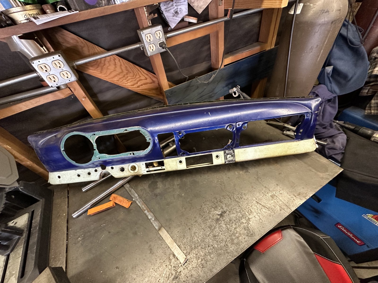

  4. ftwmfer
    Joined: Jan 24, 2013
    Posts: 79
    ftwmfer
    from Orange Ca

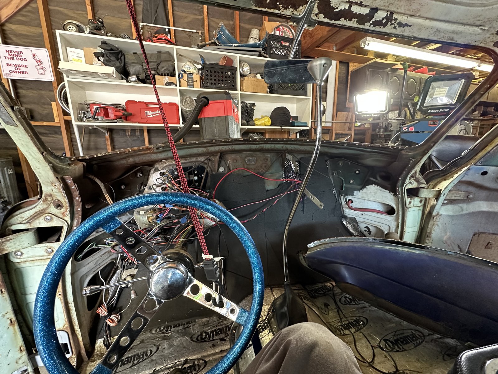

    Decided to remove my dash for some work

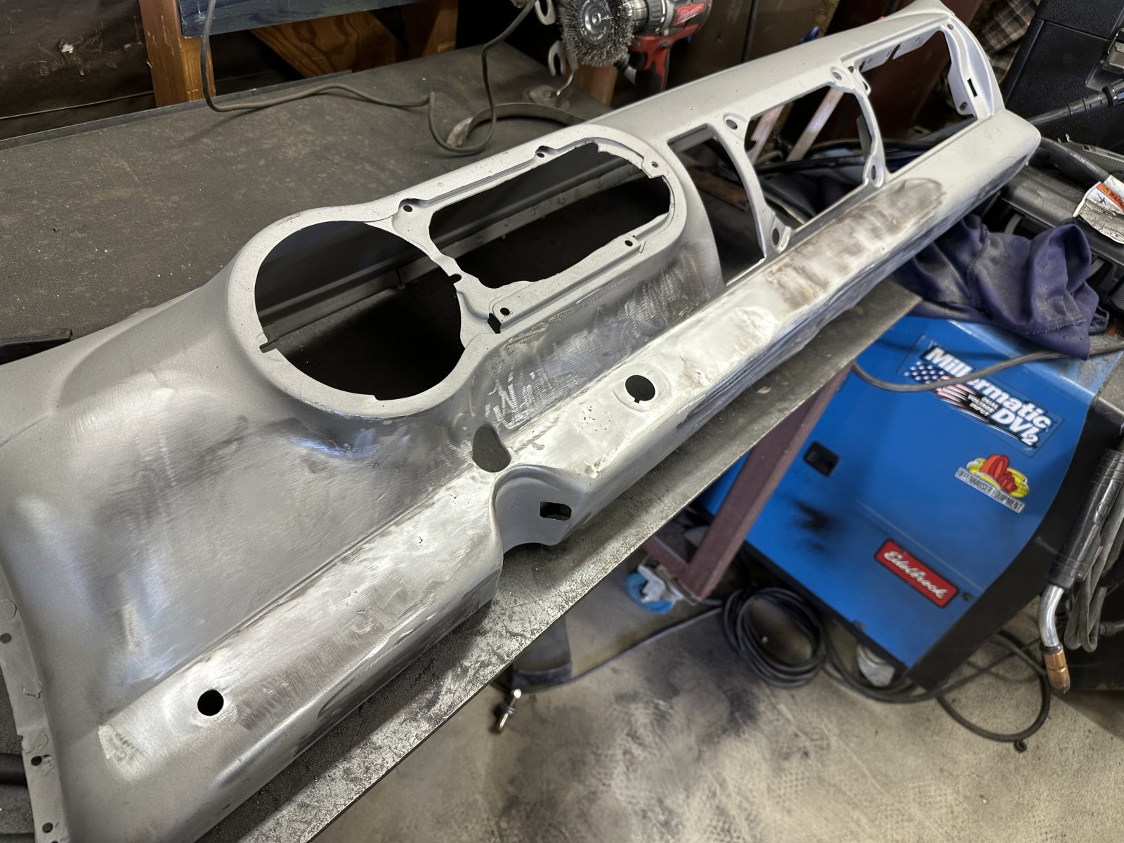

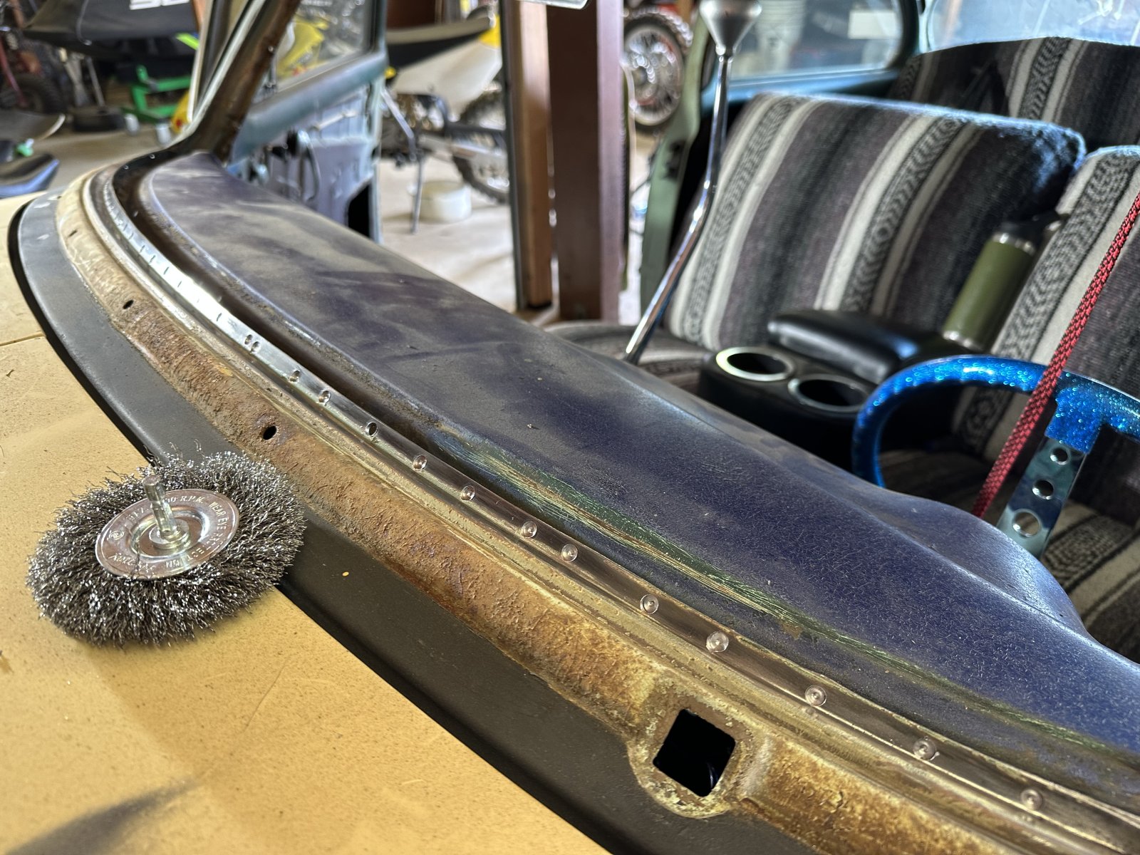

  6. ftwmfer
    Posts: 79
    ftwmfer
    from Orange Ca

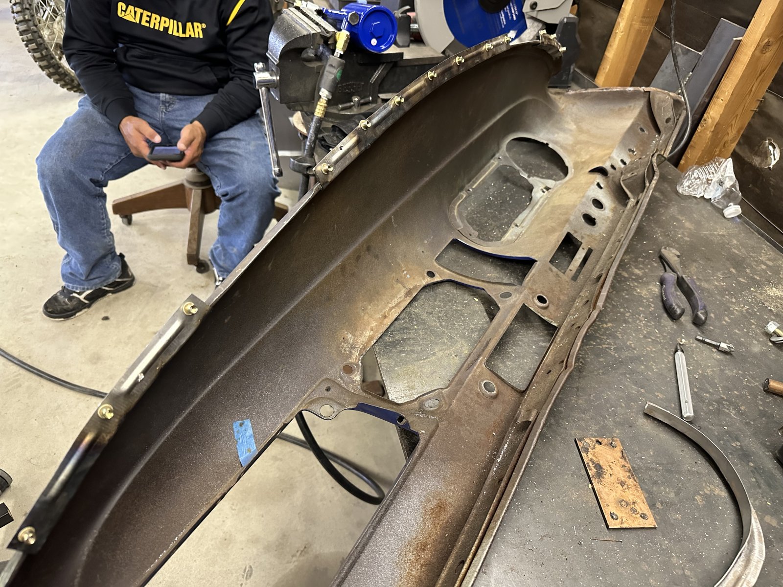

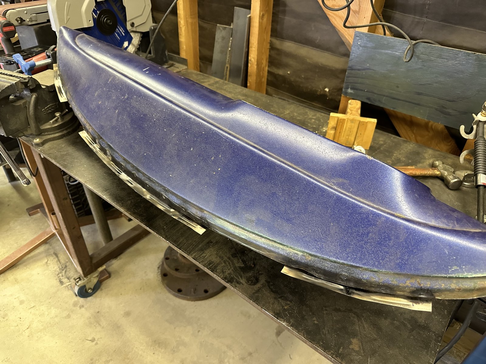

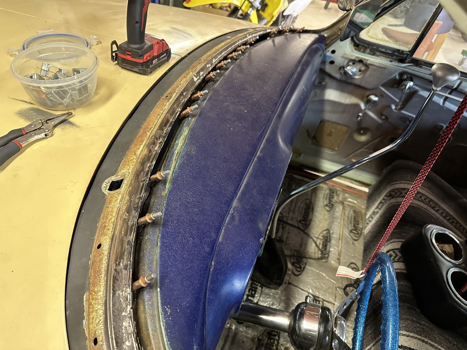

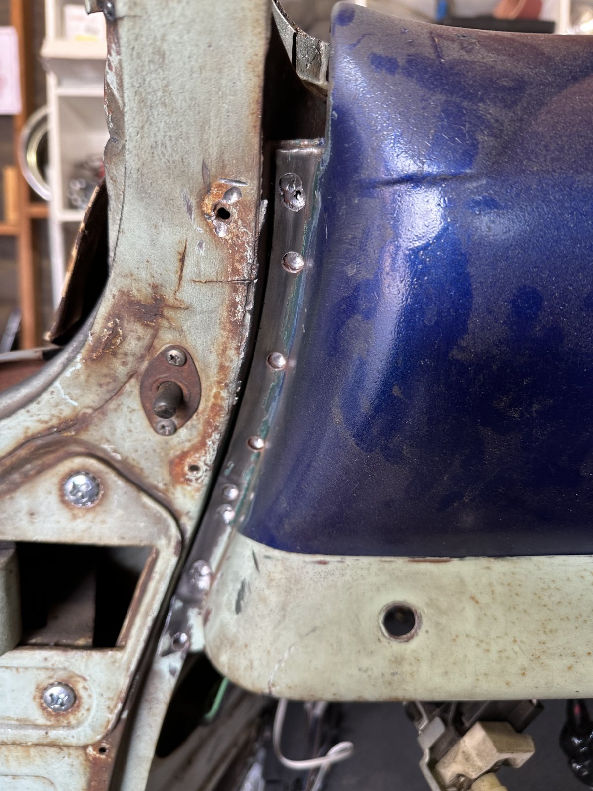

    I was originally going to weld the dash back in but decided to make it removable, so cut it up and rewelded the pinch seam back in then built a flange with some bead rolls to keep it rigid and used riv-nuts with some ****on heads. Wasn’t sure how it would work out but I’m happy with the outcome. IMG_9135.jpeg IMG_9136.jpeg IMG_9598.jpeg IMG_9599.jpeg IMG_9603.jpeg IMG_9604.jpeg IMG_9605.jpeg

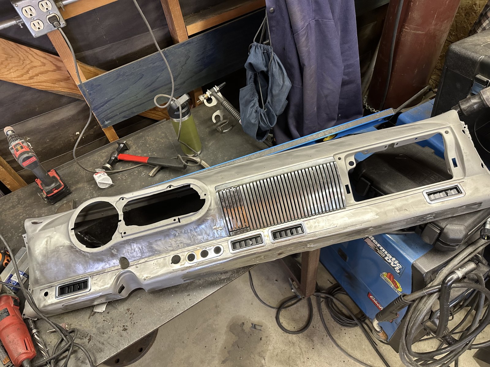

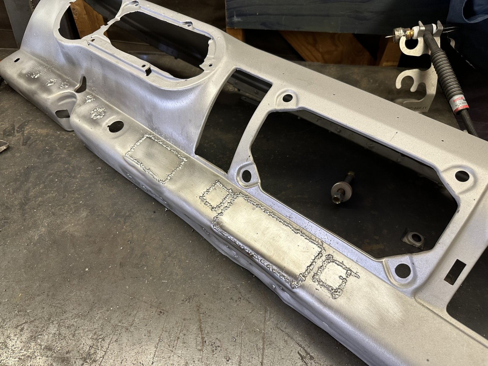

    Shaving holes just so I can cut more

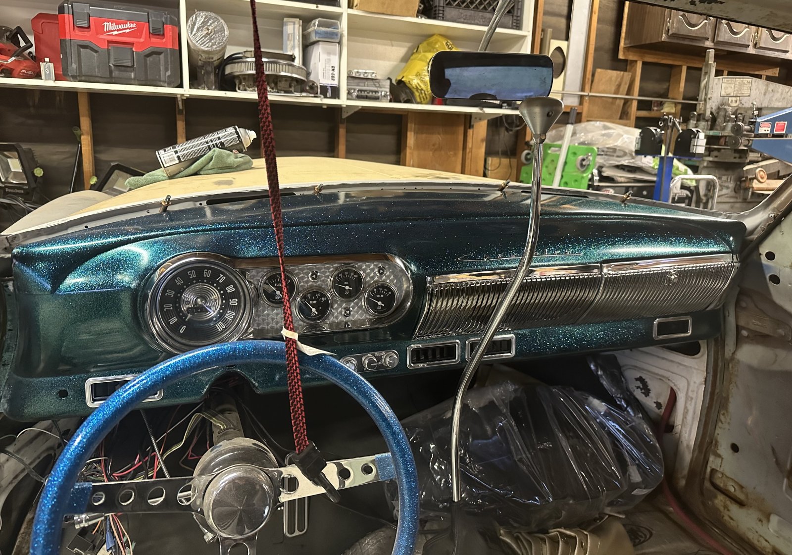

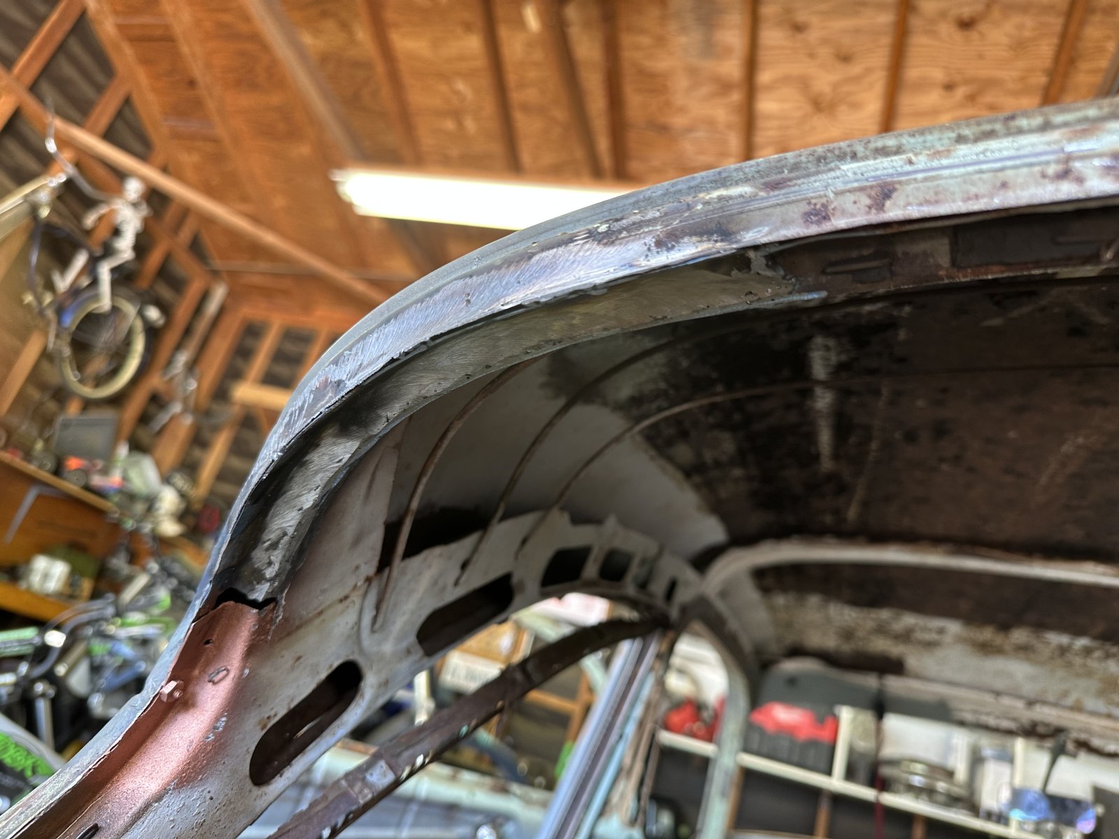

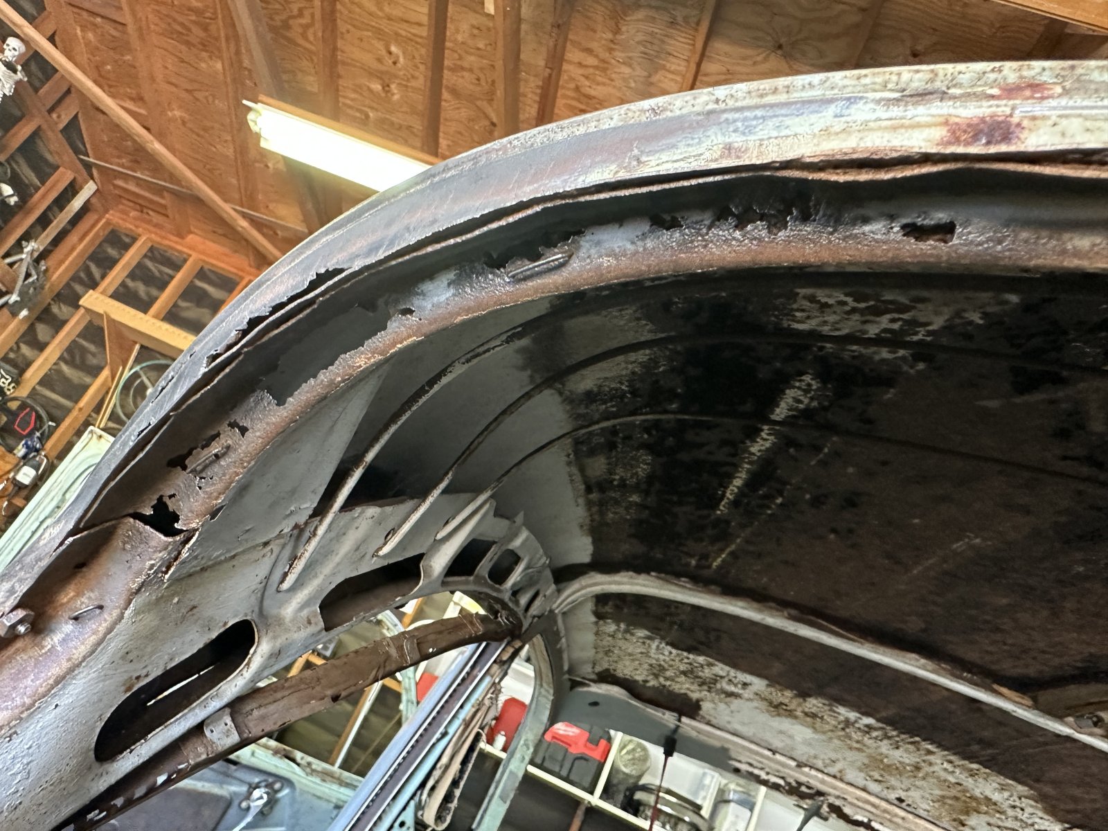

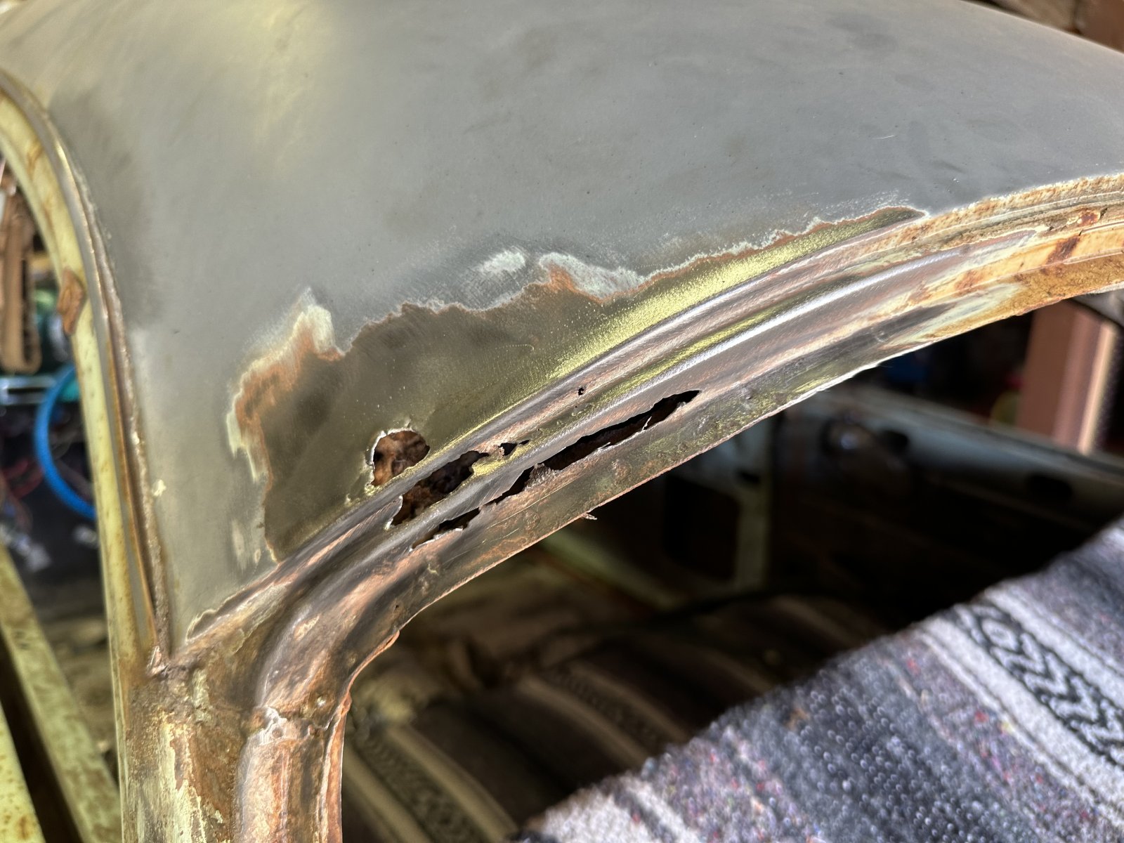

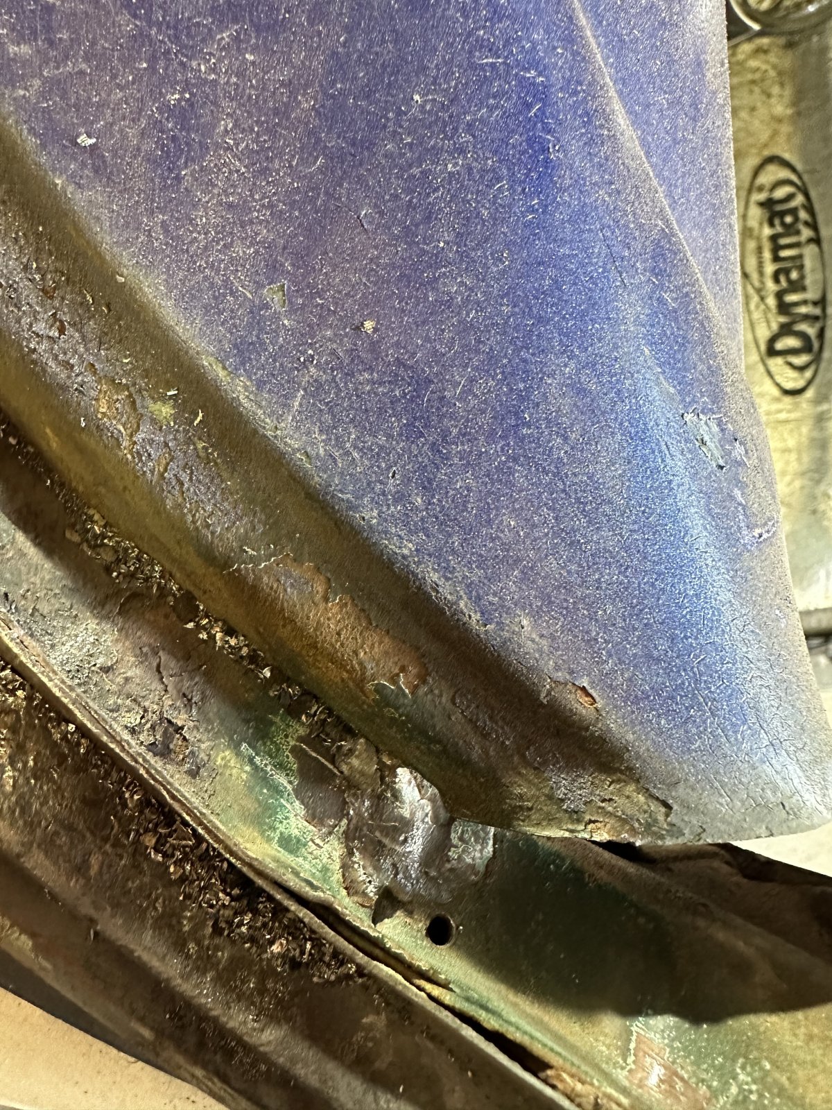

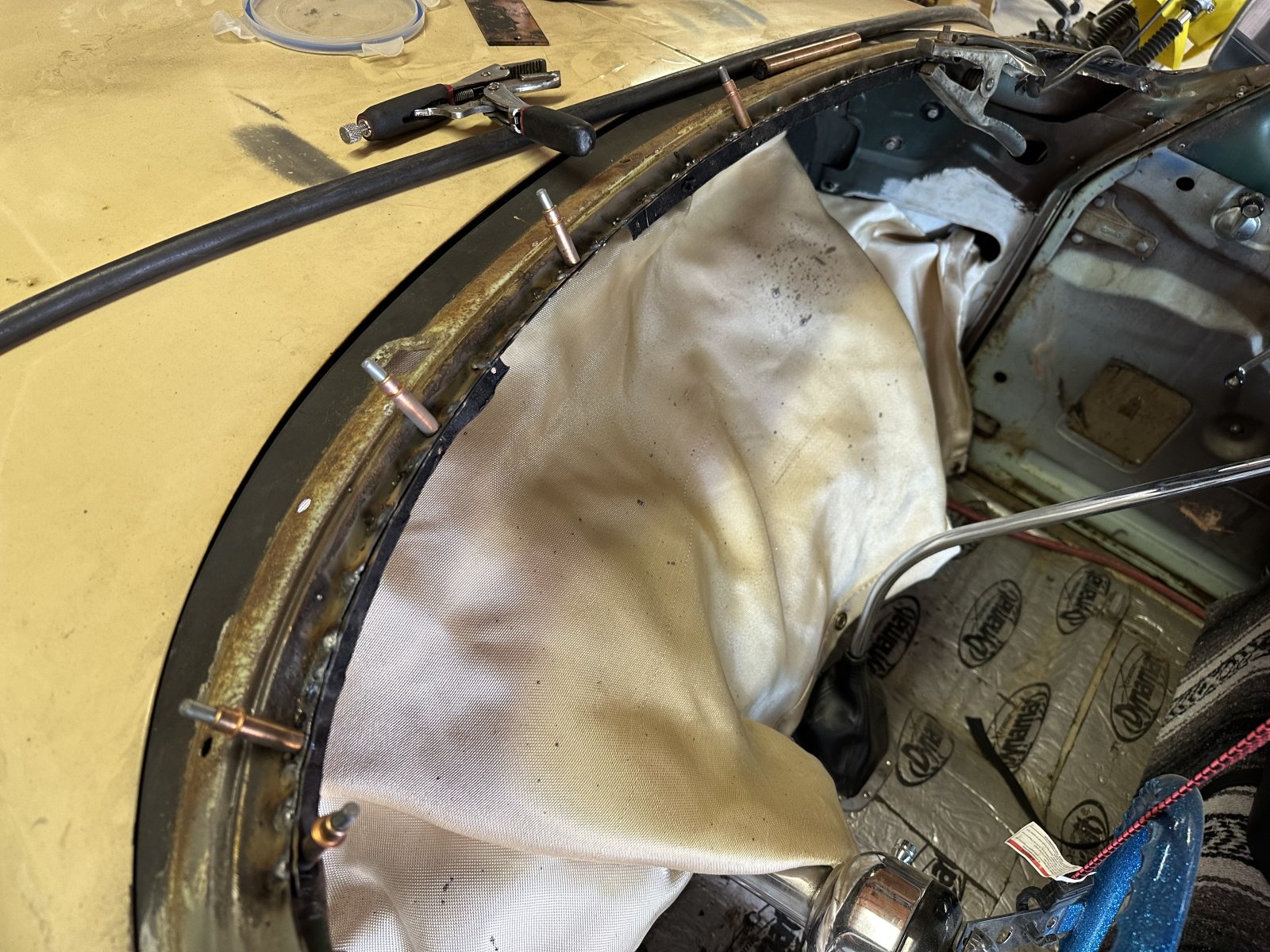

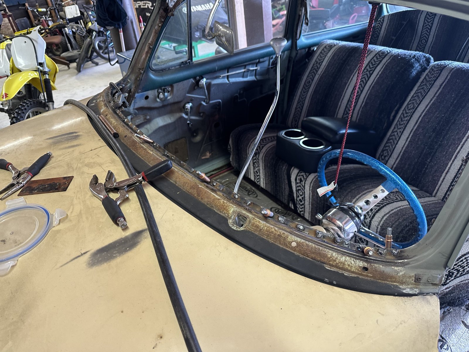

    Pulled the rear window and found surprises IMG_1154.jpeg IMG_1156.jpeg IMG_1370.jpeg

    Man that’s a bummer. I know you could build it with a shrinker stretcher but given you live in Cali, I’d be inclined to find a parts car that you can cut those parts out of.
