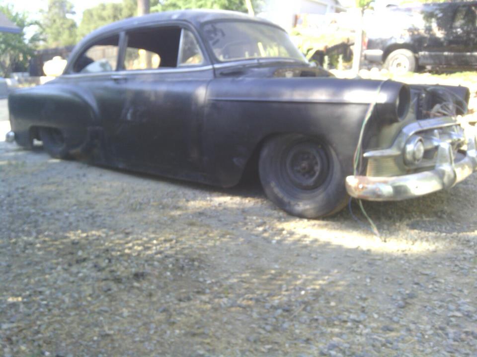

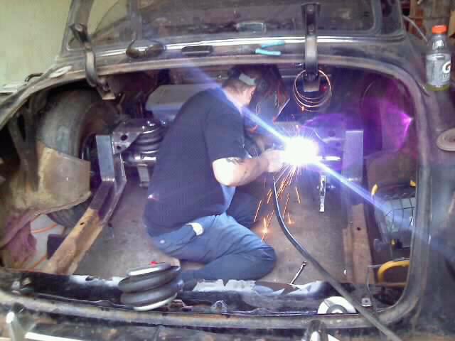

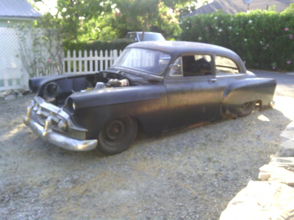

    just a couple action photos. finally got some time away from everyone else's projects and got to work on mine. i just need to cut my wheel wells out more so nothing touching the tires when aired all the way down.

    finally she can hold air and she rolls just need to get a set of drop up rights for the front and she should be sitting pretty.

    few more side shots

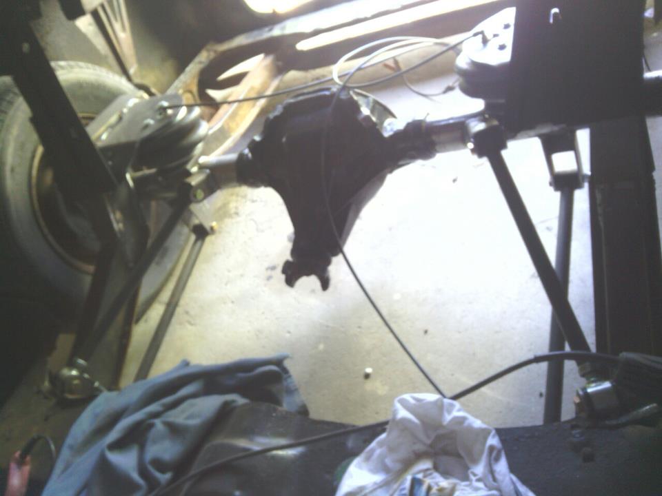

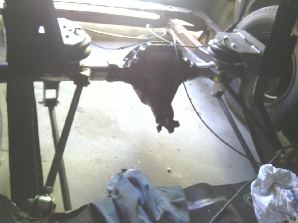

    How did you run the upper bars Dave?
  21. DAVEO!
    Joined: Dec 4, 2011
    Posts: 291
    DAVEO!
    i measured from the cast part of the rear end and i measured 3 inches over from there i kept the bracket on the rearend flush with the top of the axle tube . hope that makes sense
  22. Leebo!
    Joined: Nov 22, 2005
    Posts: 800
    Leebo!
    from Yale OK
    Thats cool. Was curious how you mounted the upper bars to the frame. Thanks!
