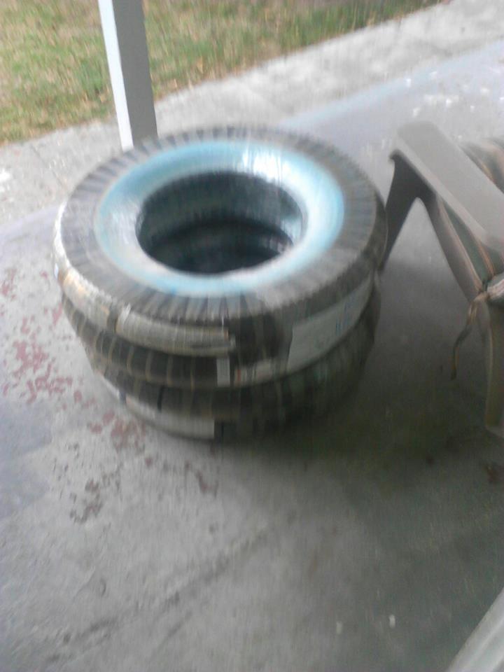

    well i got my tires in today i ended up going with the Firestone 670-15 gonna get them mounted on the rims tomorrow. sorry i haven't been active on here lately haven't done much to the 53 lately been working alot. i got all the metal for the trunk so ill be working on that after this week end. i gotta chop a 46 ford pickup this weekend.

    670-15's are mounted just need to get all new lug nuts... super happy

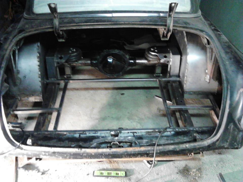

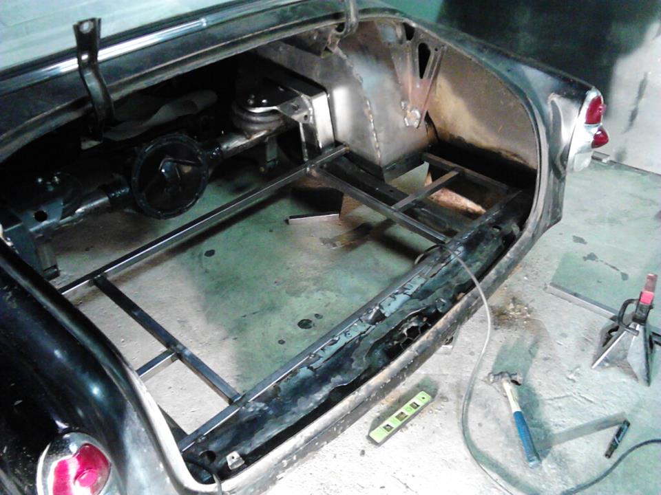

  6. DAVEO!
    Joined: Dec 4, 2011
    Posts: 291
    DAVEO!

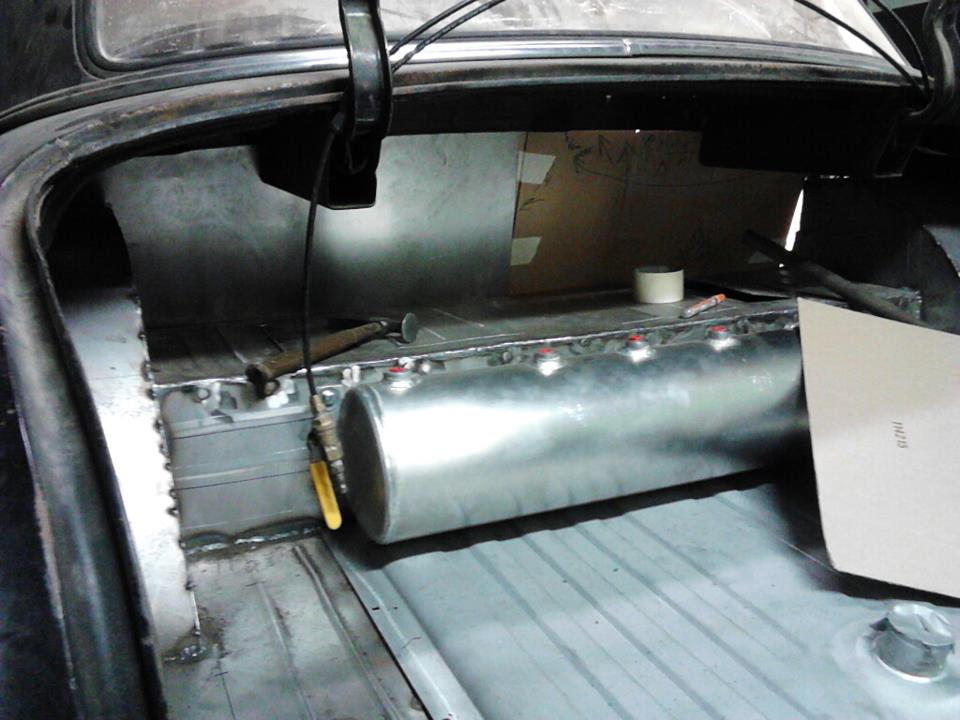

    FINALLY!! got some time to work on the chevy got the wheel wells and the frame for the gas tank built today....

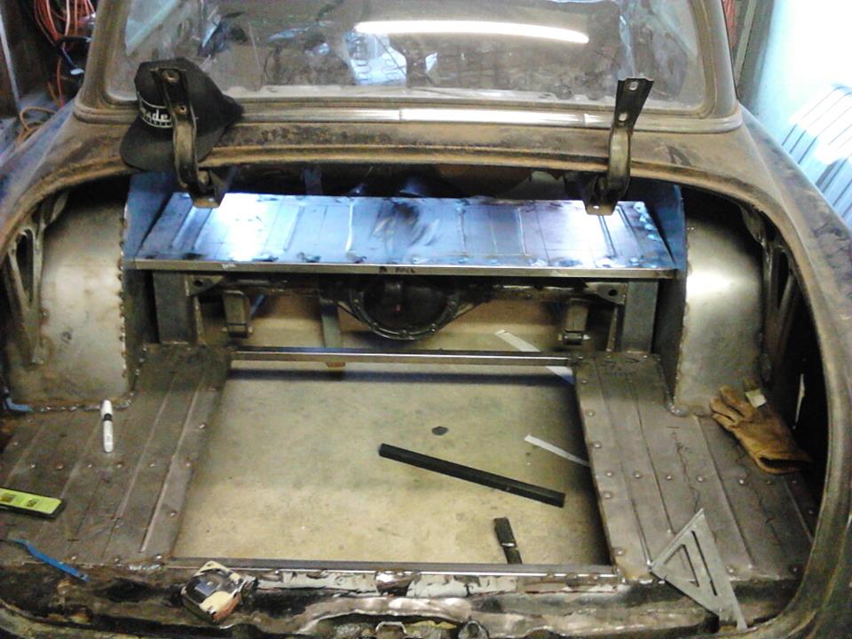

  16. DAVEO!
    Joined: Dec 4, 2011
    Posts: 291
    DAVEO!
    Made the Top Peace above the Step Notch today was going great till i ran the Inner beads today it got snagged in the bead roller a bit not perfectly straight ugh :( but it will do i guess. its just laying in there now

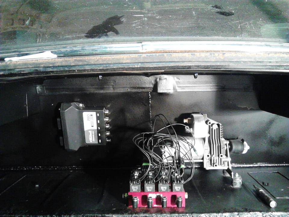

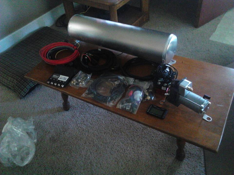

    My Air Compressor System came in today :D so Stoked!

    got a bit work done gonna try to knock out the rest of the sheet metal work this week then start running the wiring out back and mount all the air system :) super excited cuz i have a hand full of time to get stuff done i have two months off work :D HAMMER DOWN TIME!!!!

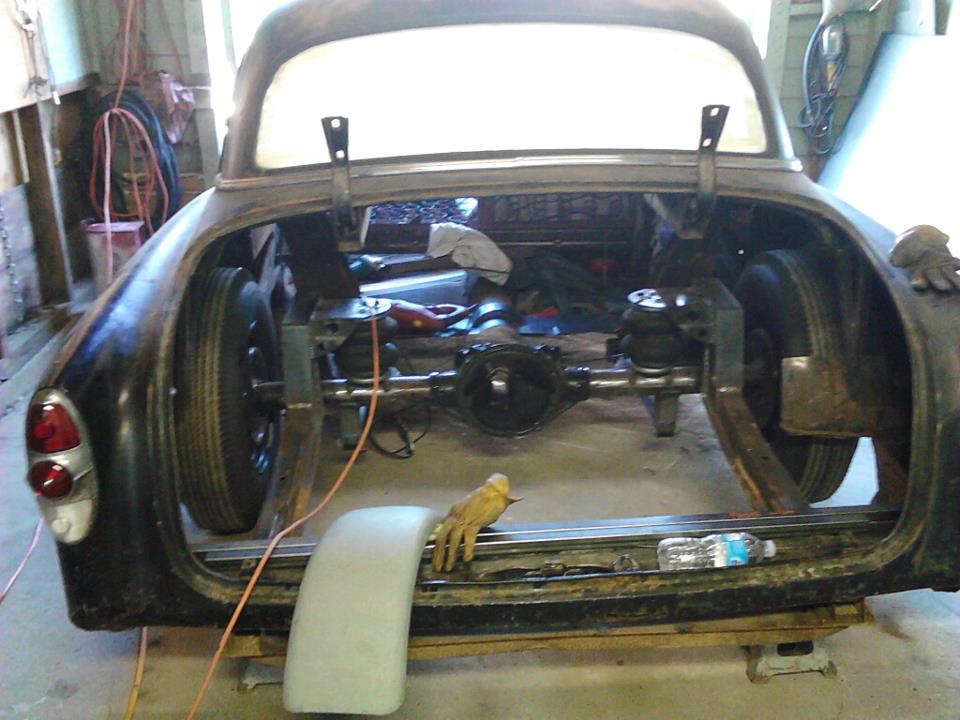

  25. StayGold54
    Joined: Jan 19, 2012
    Posts: 140
    StayGold54
    Hey Daveo! What gauge sheetmetal did you use for the floor and inner wheel tubs? 20 gauge? I'm getting ready to do this as well..also do you know how much you went up on cutting into the fender. I know it varies with what tire size/diameter, but just want to compare some measurements if ya got em so I can know what to expect. Thanks man!
  26. DAVEO!
    Joined: Dec 4, 2011
    Posts: 291
    DAVEO!

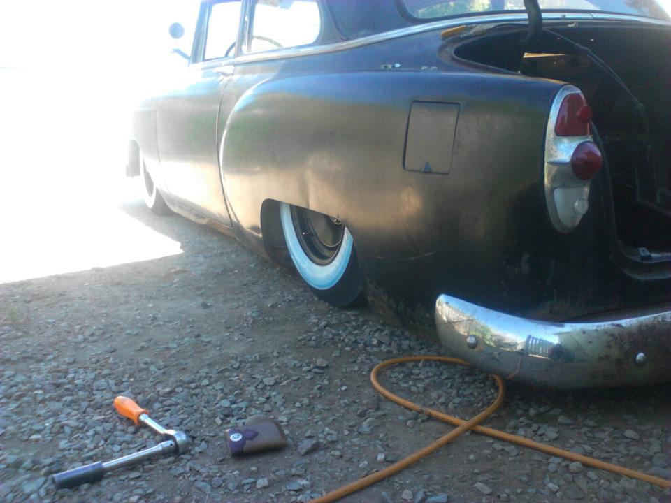

    i used 18 Gauge sheet metal thru out the car could go thinner. and i dont have the Measurements for the wheel wells what i did is when its all the way aired out i marked about an Inch around the whole wheel and that gave me plenty of clearance around the whole wheel

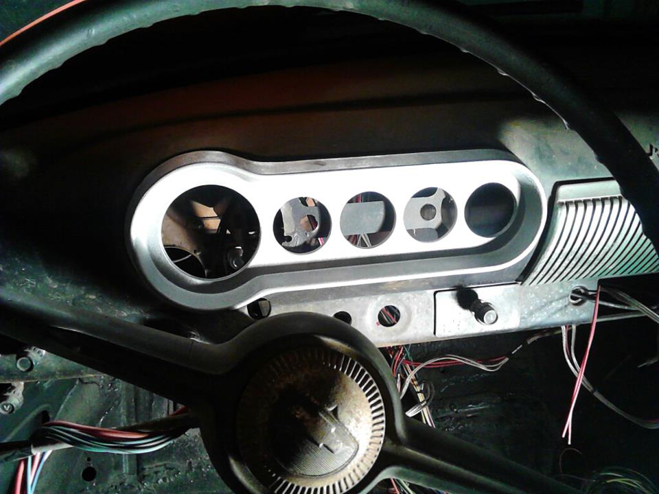

  30. DAVEO!
    Joined: Dec 4, 2011
    Posts: 291
    DAVEO!
    havnt really dont alot been cold as hell here but i got a Cast aluminum gauge panel from So-Cal before and after picture there and my boy reggie hanging out side with me :)
