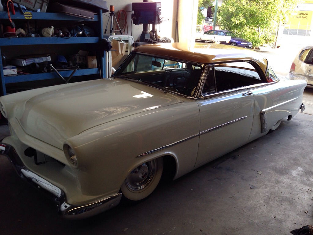

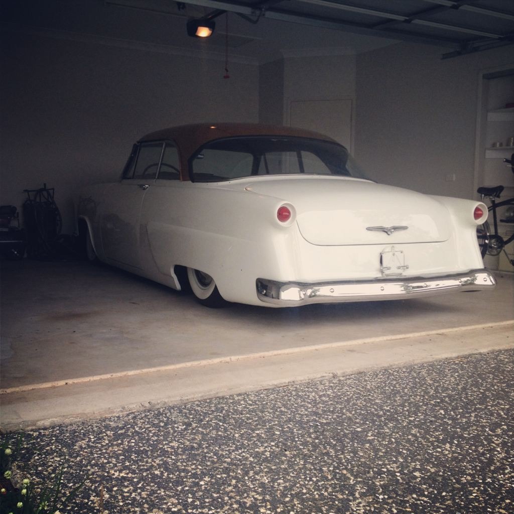

    How much lower is it now? And how did you lower it?
    Looks great!!
  3. chriscos
    Joined: Jul 22, 2009
    Posts: 67
    chriscos
    from australia
    It sits about a inch off the ground I notched it a inch and half ,4linked the rear ,bag over diff .notched the frame in used stock lower and top control arms also fitted re7 slam bags on all 4 corners

    nice work man. Can you post some pics for the work you have done with the Accuair ride set up I was thinking about going that way with my 53 ford? I like to keep all the stock front and 4 link the back like you did. I see you choose you went with re7 slam bags did they fit right up or did you have a little work on it? thanks
  8. Chevydeuce
    Joined: Apr 20, 2006
    Posts: 139
    Chevydeuce
    X2
    I would like to see it, too.
    Don't know if I want to notch the frame much on my 53, but it seems to be very necessary if i want to have it low.

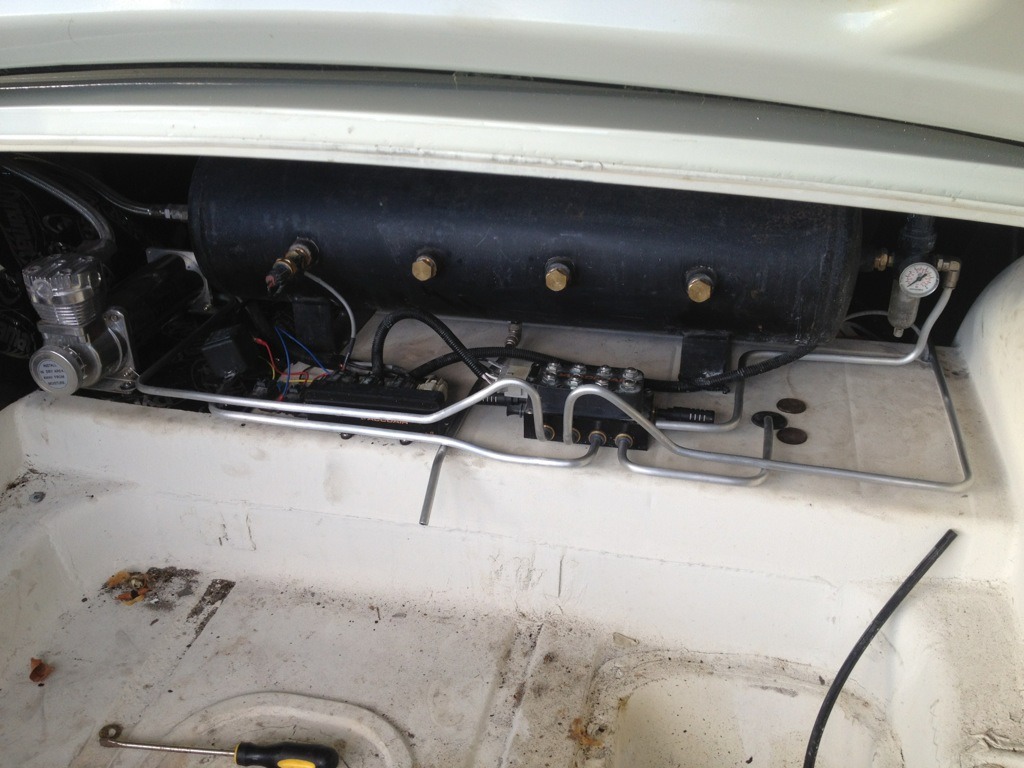

    ImageUploadedByH.A.M.B.1389774161.816254.jpg Just finished the hard lines just gotta neaten the wiring up even know you won't see any of it because it will be trimmed over I know it's done haha

    Hi made the 4 link, bag cups, bridge shock mounts myself but used re7 slam bags all round ,Accuair e level but would have spent around $2000 on that stuff .it would be heaps cheaper in the states if u live there

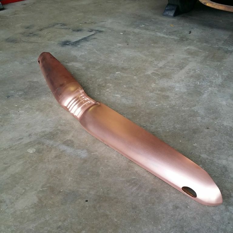

    One more coat of copper then chrome can't wait to put it on

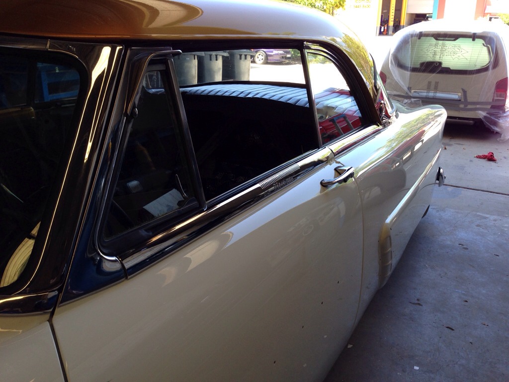

    ImageUploadedByH.A.M.B.1392800851.392227.jpg Just waiting on the rear quarter bits of stainless and the out side is done
