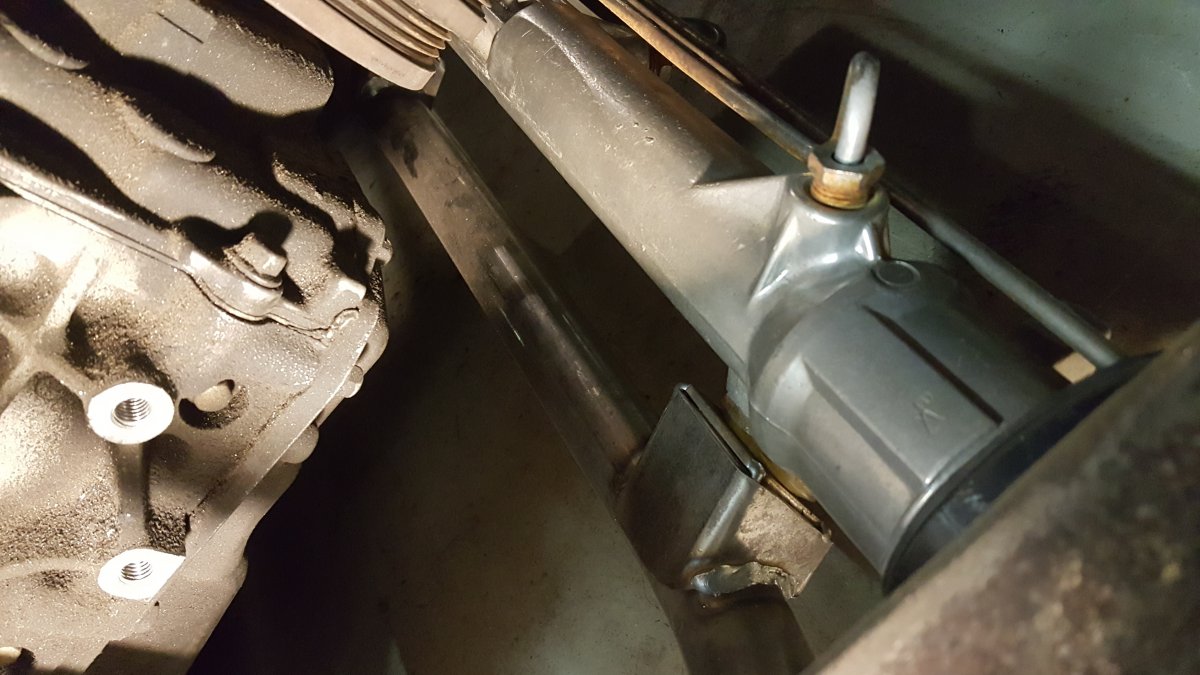

    Got the steering rack in its final position.

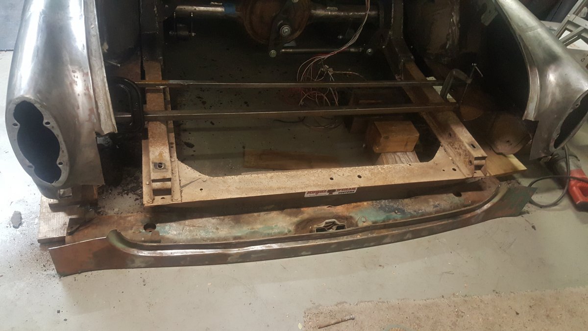

    I ended up bringing down the rear wheel well. Didn't like the smaller well on the front compared to the rear. The car had multiple body damage to both rear quarters. Even a poor half quarter replacement on the driver side. I came up on a parts car so I'll likely be redoing both quarters.
    Im thinking about redoing the rear window using a original frame and stretching the roof over how i have stretched the catwalk now.

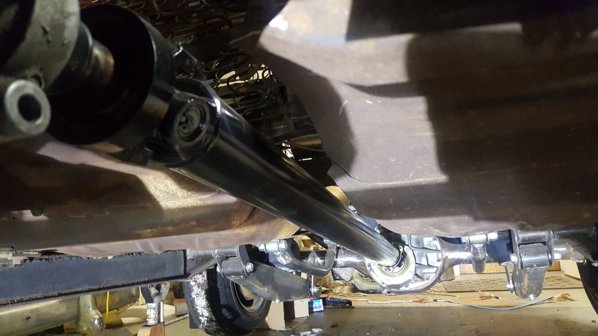

    Had alot of rust under the trunk latch so I replaced it with one off a donor car. 20180130_000929.jpg ran my brake line down the link bar. All stainless lines. 20180404_215506.jpg started fitting the new window frame.
    Everything fitted and new valve covers
