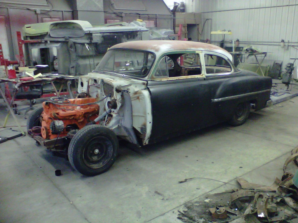

    Ok, I'm sure everyone wants an update on what I've been up to the last 5 days. I will let the pics do the talking and say that my Gambino kit isnt sitting on my living room floor anymore, enjoy! I will post the breakdown of the fab after I get the pics uploaded.......

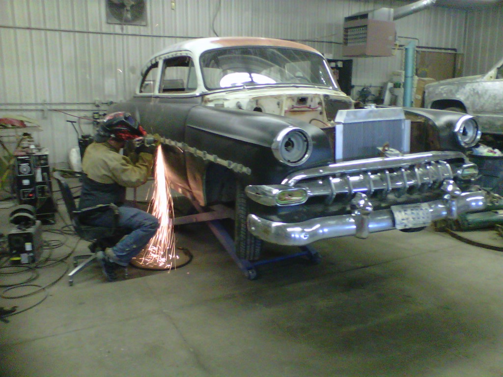

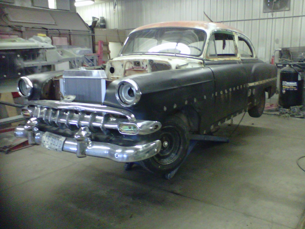

    All I can say is, good hell 54 chevys have alot of holes in them! Maybe I should have just left all the trim on. It seems like the grinding and welding will never end. Heres a couple pics for ya'all to enjoy......

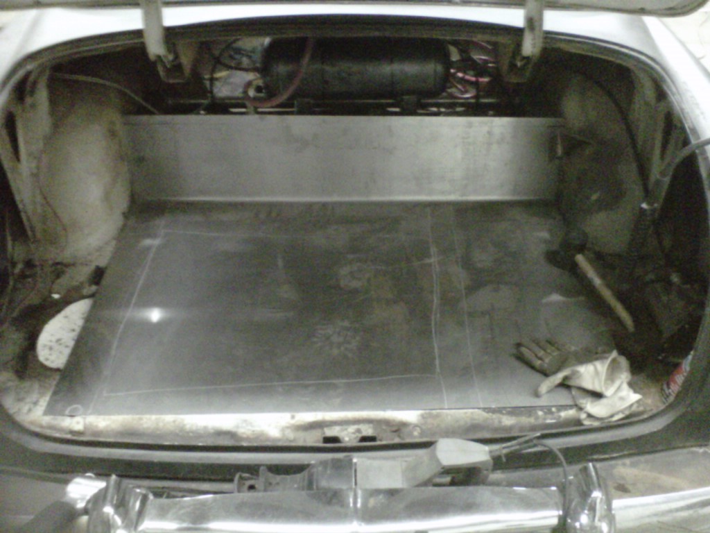

    Ok, all the holes are welded up and ground smooth, YAY! So I moved onto the trunk floor. Cut it all out and started fresh. I'm going to fab in the stock fuel tank so its raised off the ground a bit, ditch the spare tire well, and fab in a battery box and compressor mount for dual viair's. Heres a couple pics of the progress so far......

    Ok, its been a couple weeks since I gave an update, cuz I been slammin *** trying to finish this car! Im not showing anymore pics till the trunk and floor are done, and with any luck, that will be wrapped tomorrow. The trunk is done except for mounting the tank, battery, and compressors. Im building some covers under the back seat to hide the upper 4 link bars, then moving on to the driveline tunnel. should have it whipped tomorrow night. Wish me luck......
