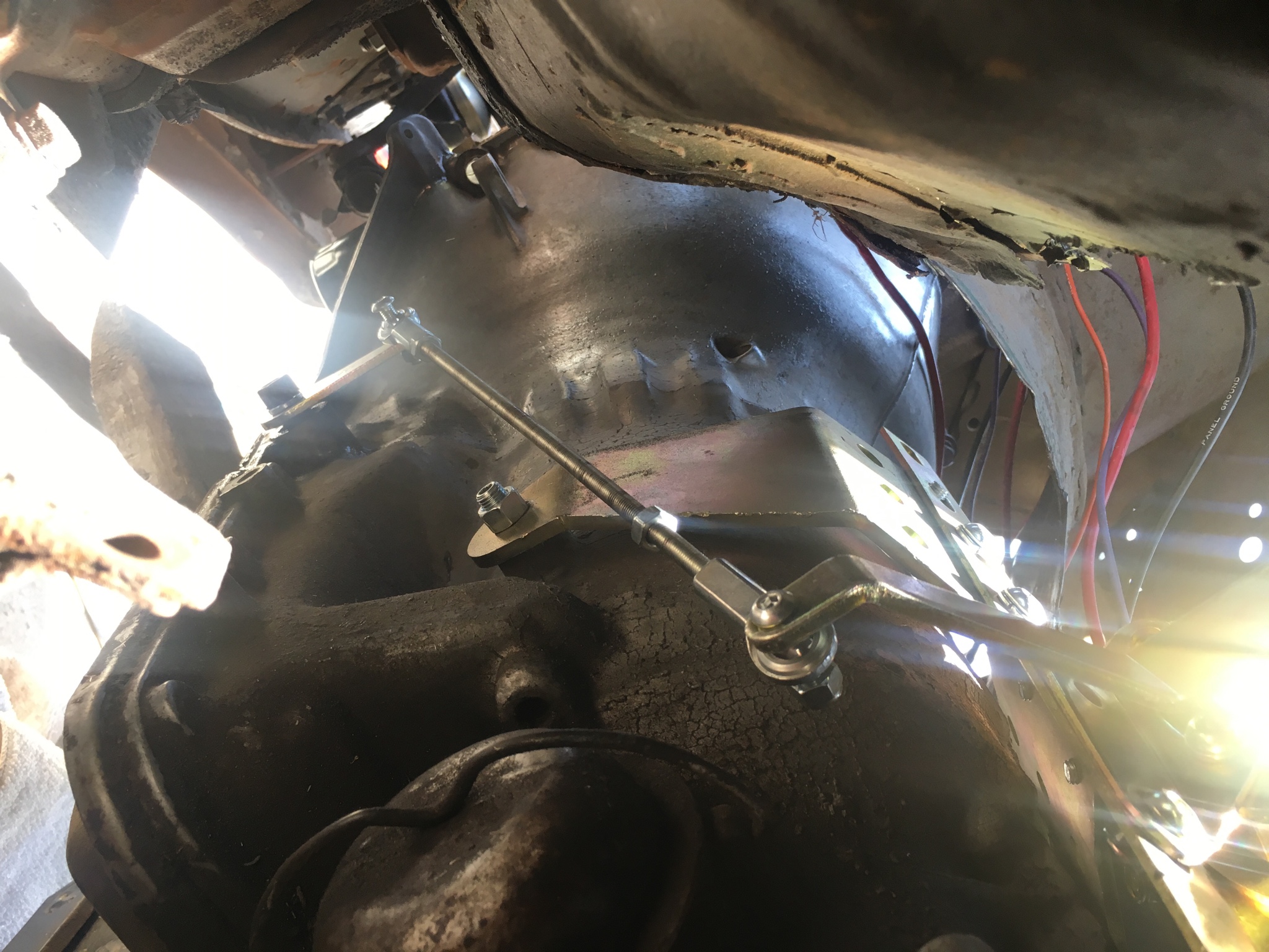

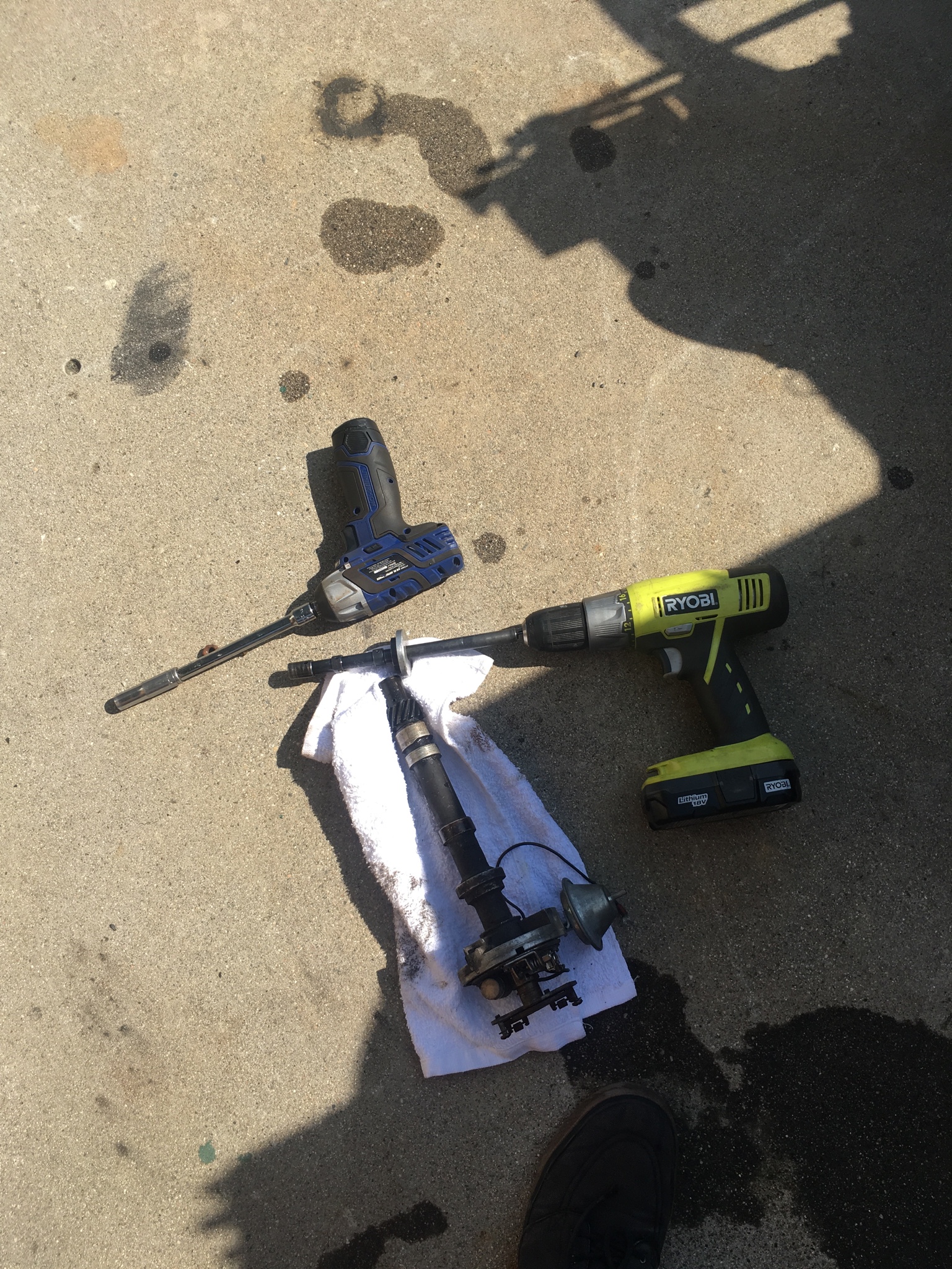

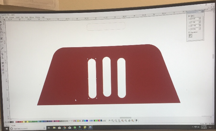

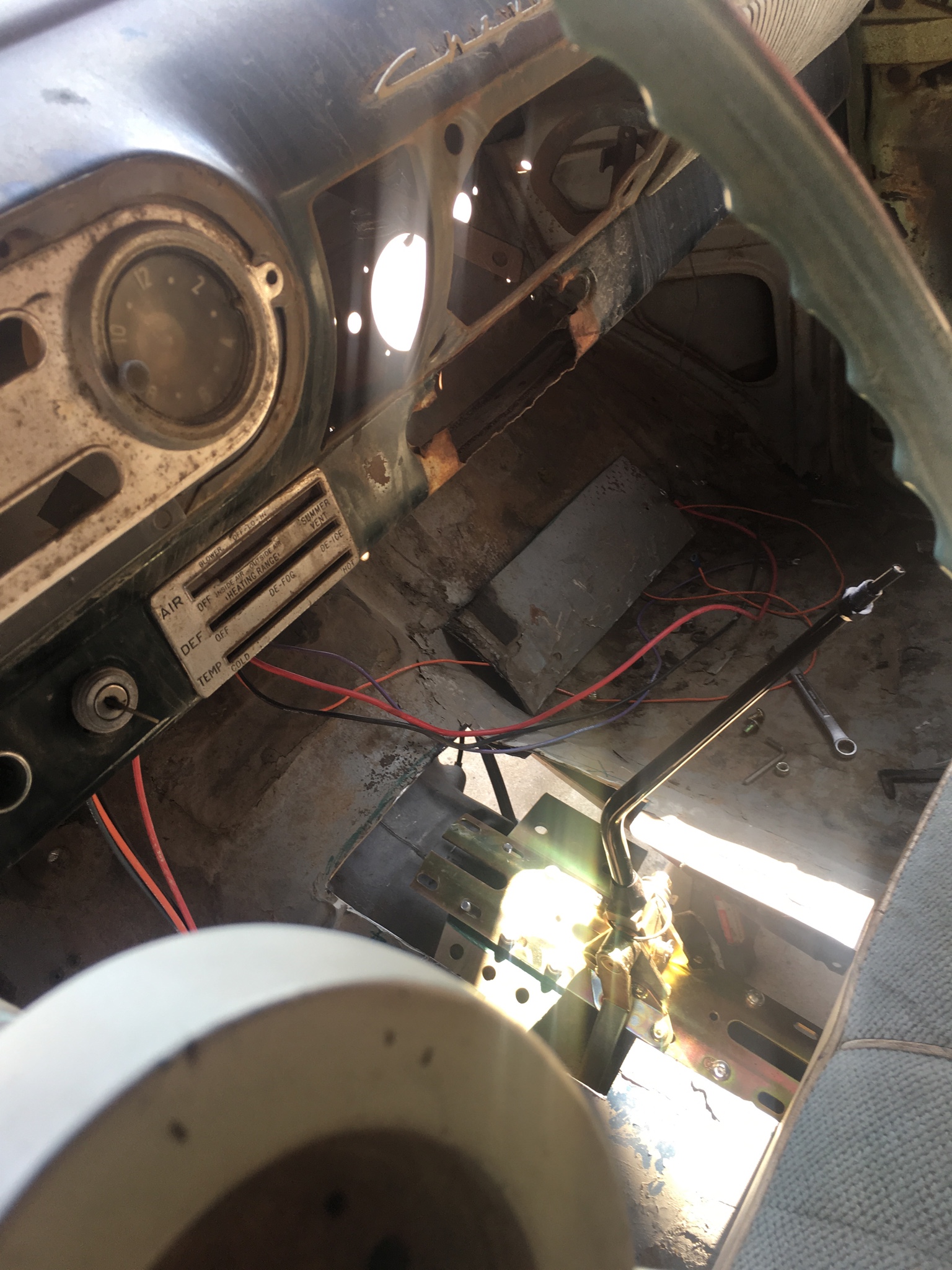

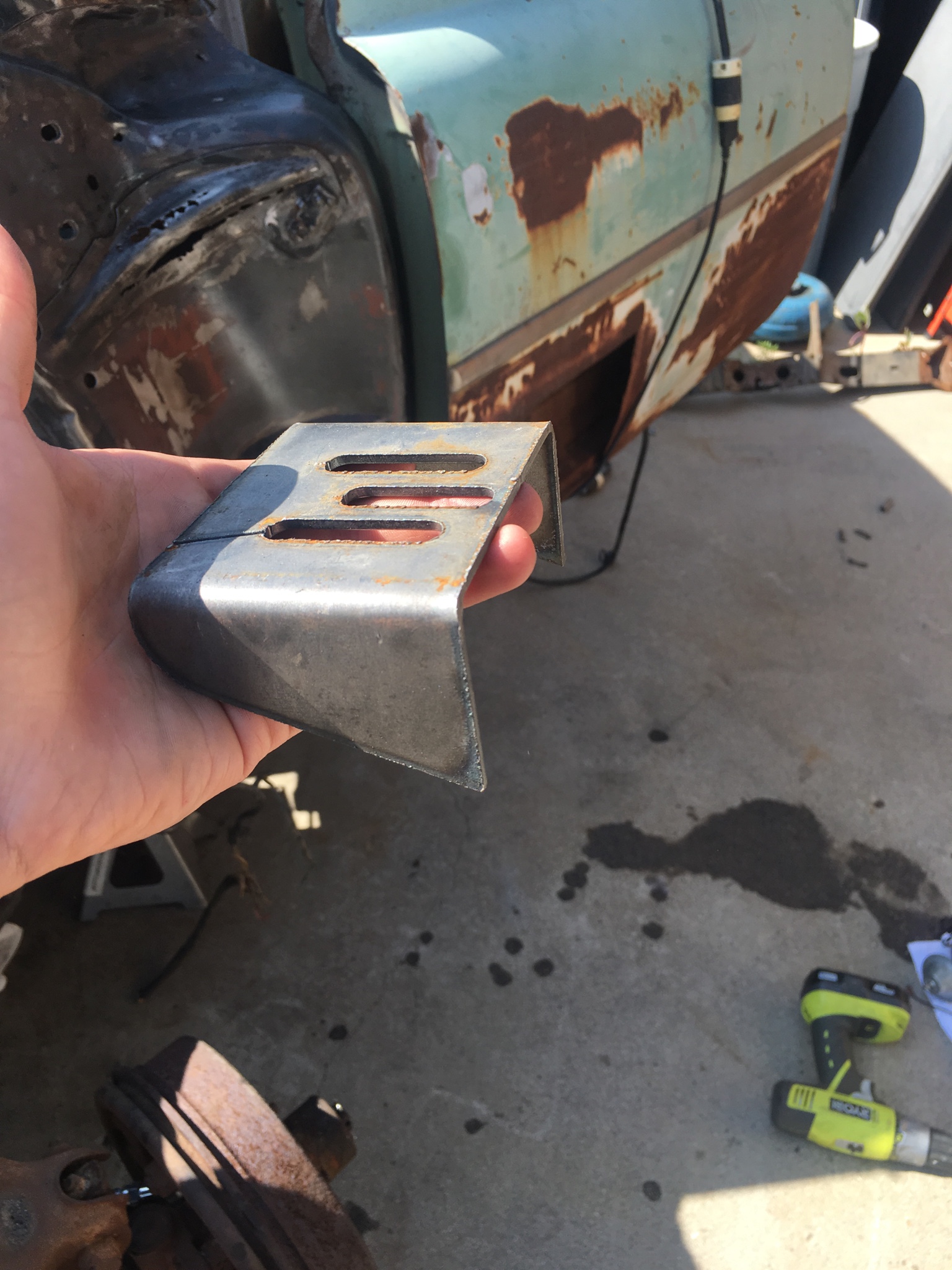

    Alright guys little update, I’ve been working on this car every day since my last post. I opted to go for quality over quan***y on posts.
    I got the engine and trans in the car and the alternator bracket on. [​IMG]
    I also cut a hole in the floor for the shifter [​IMG]
    Cut linkage for the transmission shifter
    Got seat in for mock-up
    Filled it with oil then pre oiled the car... I figured out the hard way that the oil pressure fitting needs to be installed for this lol.
    Made a transmission mount on my dads Cnc plasma. [​IMG][​IMG]
    Ran engine wiring should be turn key for when start which will hopefully be soon.[​IMG]
    Making progress I’m going to weld the cross member tomorrow so you guys get so some of my welds ... not looking forward to it [emoji4]

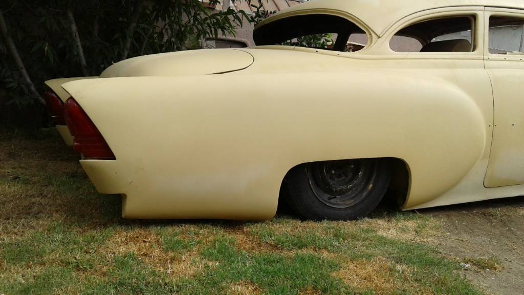

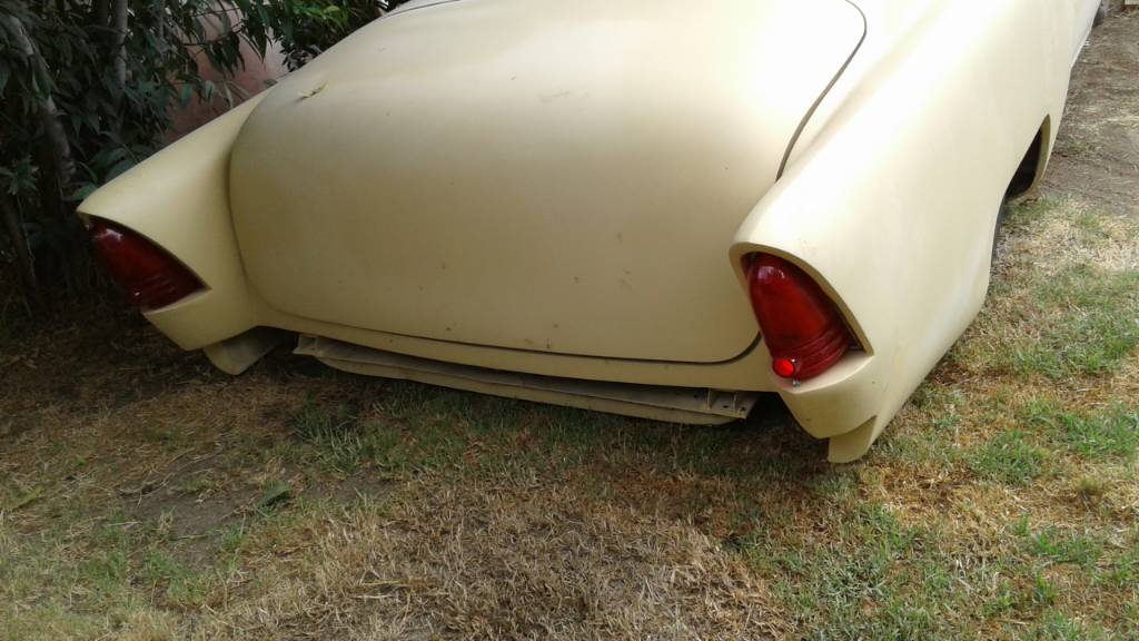

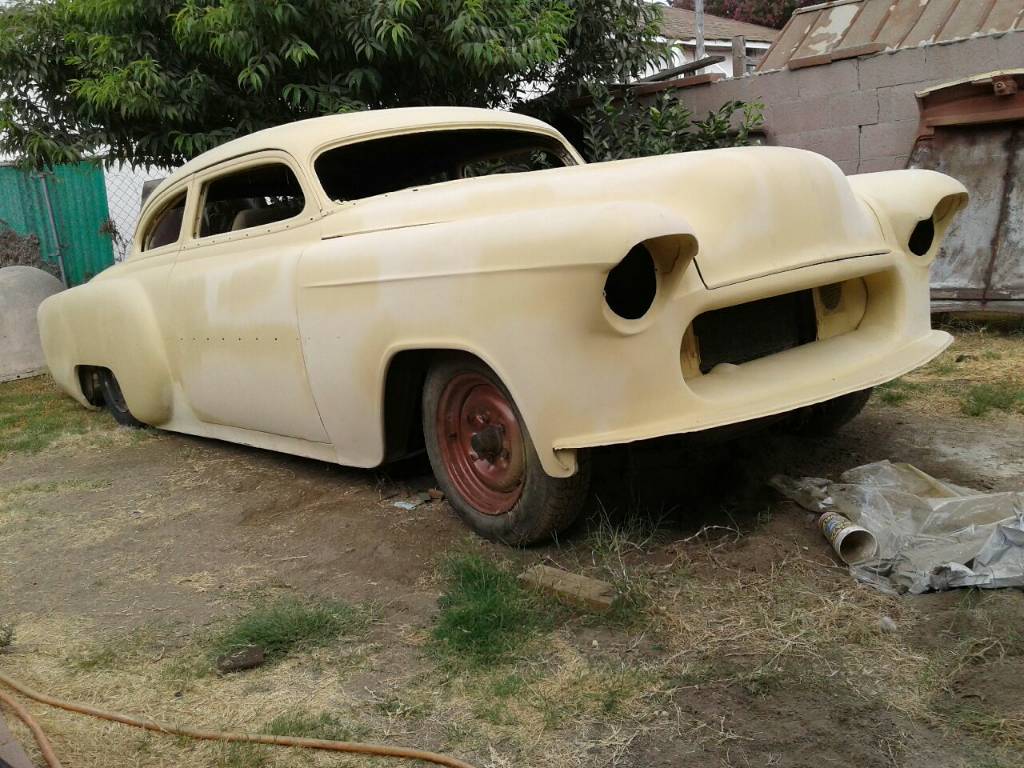

    Hello,just came up on ur thread.you remind me of myself at 15 yrs old ,except my dad was not a "car guy" anymore,so all I had for help was my older bro who was a lowrider...
    I built a 1953 210 coupe a couple years ago,I have chopped many cars,customs forever modo...from what I've seen in the pics,the windshield lines look to be aligned,which is very very important,or ur gl*** guy will not touch ur car.FYI,Allpro gl*** in Hesperia is a good source and knows his stuff.
    On my car I used the original rear gl*** opening,just cut down...most guys opt for the small window.here are some build pics...there are pics of car in my profile posts...keep it up,the 53-54 make a bad *** custom.. letgo1504457081825.jpeg letgo1504458498107.jpeg LetgoImage_1504457158227.jpeg LetgoImage_1504457251445.jpeg
