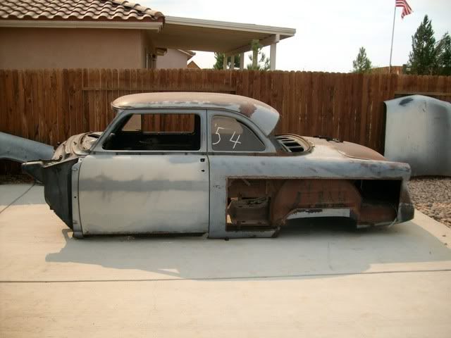

    here is my car i got a couple of years ago. the person that had it before wanted to repair the rust but didnt know what to do so they hacked it up a little. i have a little more to fix but its ok here is some pics
    here is some of the work that i have started last week i started the step notch and todat i stripped the rear axle so i can start mounting the four link tomorrow
    i tapered the frame rails back to the notch so it is square and not angled like it is stock. ill post more after the link is done.

    Coupe body styles are really cool... Looks like yours is going to be really low........

    thanks man im going as low as i can i am even thinking about cutting the rockers down to about a inch and a half for a bodydrop. draggin is rad
