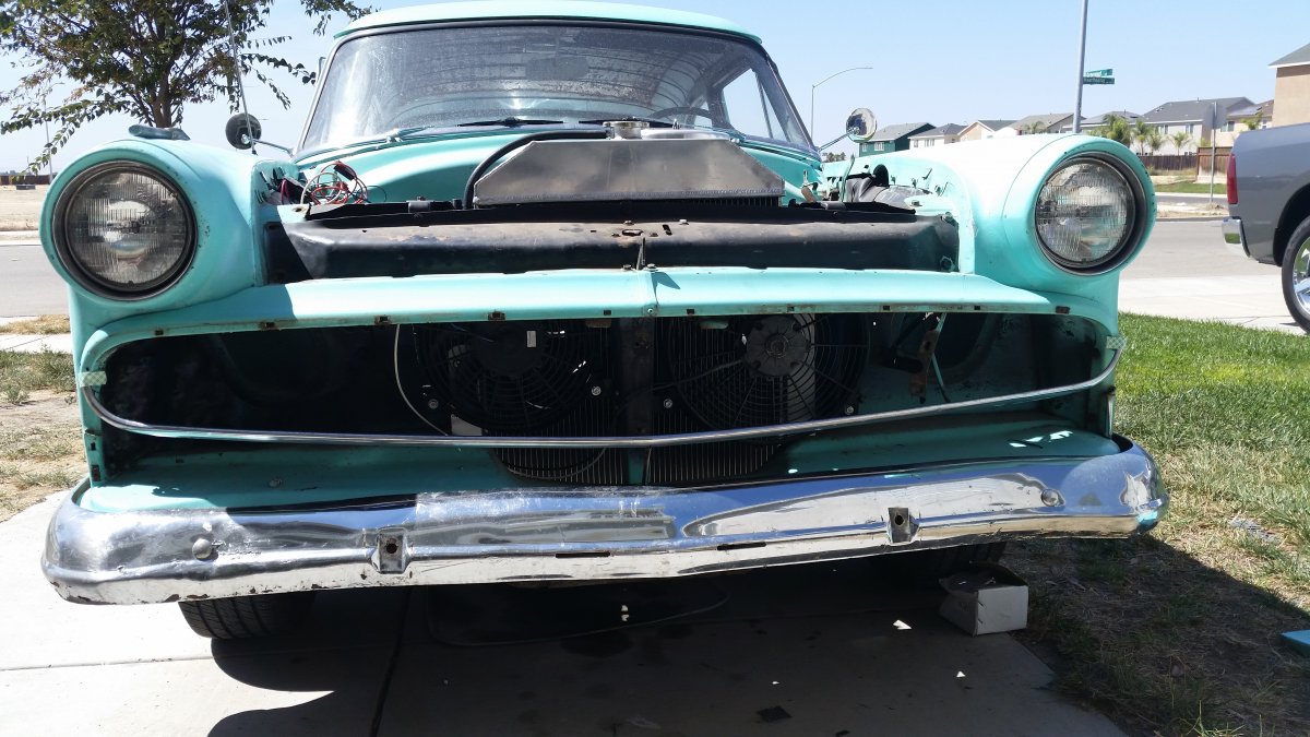

    20150806_122609.jpg 20150806_154234.jpg 00I0I_N2Cne1FLsR_600x450.jpg 20150830_102239.jpg 20150828_140530.jpg IMG_20150818_103638.jpg Well I recently purchased a 54 ford mainline project/driver ! I plan on building a 50 ' s style kustom out of it ! Since I bought it I added Aerostar front springs and 3" blocks in the rear ! I also narrowed the grill 10 3/4" started Frenching the taillights with the Moon 52-54 french kit but am running 50 Pontiac lights in them (pic was when I mocked them up )also shaved the trunk and emblems off the fenders and the gravel guards . I also picked up a set of 53 ford he alight rings I'm going to French ! Also plan on running 46 lincoln style door buttons merc side spears and eventually running a late model drive train in it ( currently 223 with 3 speed with overdrive ) still in the air about chopping the top yet !! There is a pic of when I got it !!

    I really like the look of the rings , they're deeper than if you French the stock bezels ! They came out alright wish I would of done them a little different ( cut off the stock mounting flange for the tail lights and sliced and diced the quarter to move it around a little more ) but it came out alright needs a little filler

    Lookin' good. I'm digging that grille idea. What taillight rings are those?

    What's with the different head light ring?

    elnutty
    The headlight rings are 52-53 merc / ford and they're going to get frenched ! The tag has been on all my cars since around 2005 and started as a joke !
