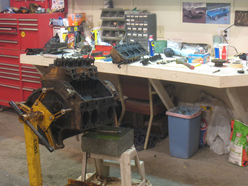

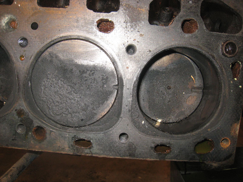

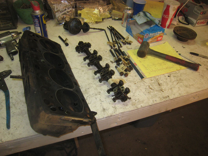

    I've spent a little more time this weekend completely-completely taking apart my front clip. I took all of the parts down to the sandblaster, and picked up the cab. I'm just OK with the work that he did. He didn't sandblast/epoxy prime the space behind the floorboards where it forms a rail in front of the rear part of the cab lowers. I don't know if that make sense, but it's the pocket, rail right below where the back of the bench seat will be. I'll post pics of that later.
    But, here are some pics of the engine being pulled. We got the transmission seperated, and both heads off. I was able to pull the rocker arm ***emblies apart. If you look at another thread I started, you'll find that I was impatiently waiting for some help with the rocker arm posts, and found some. :) Thanks again Jalopy heads.
    But, enjoy the pics. I'll be starting body work and modifications soon, so it'll be more enjoyable.

    Here are the pics. Don't know why they didn't attach the first time around.

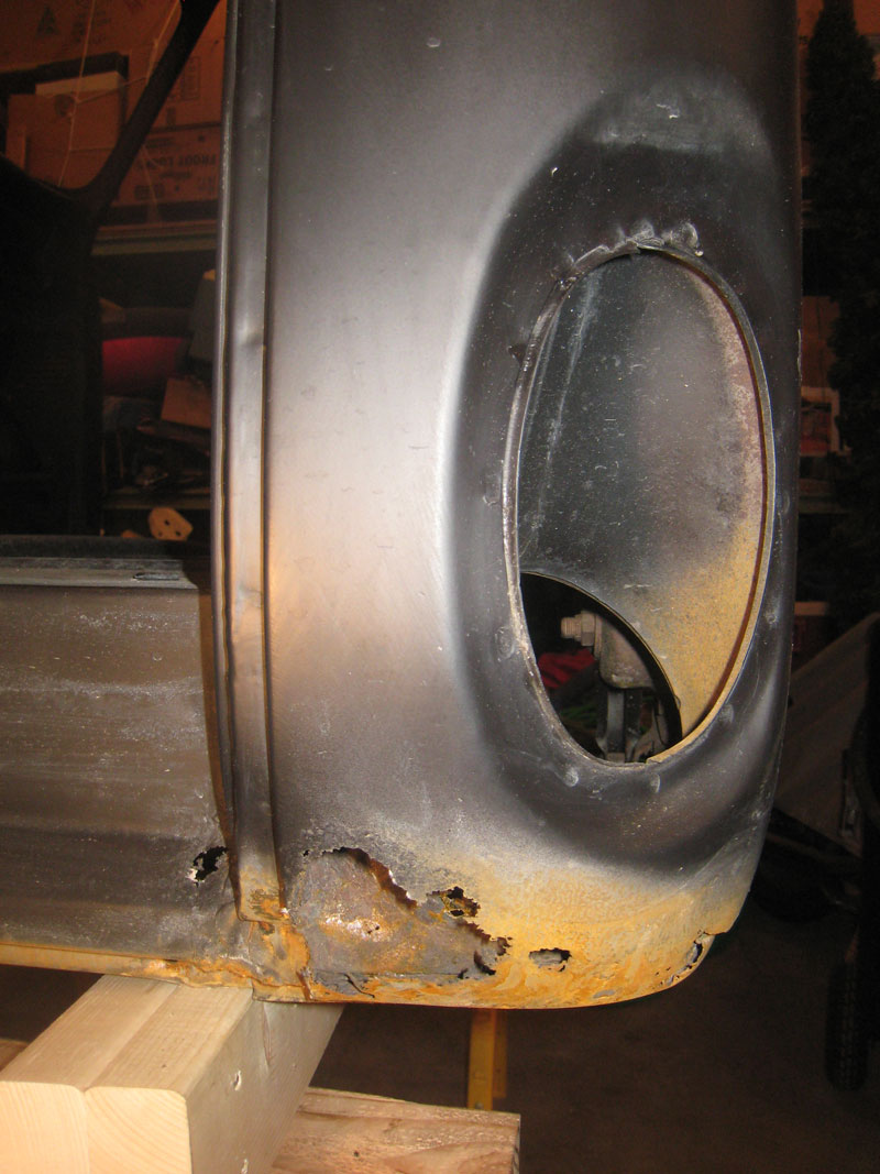

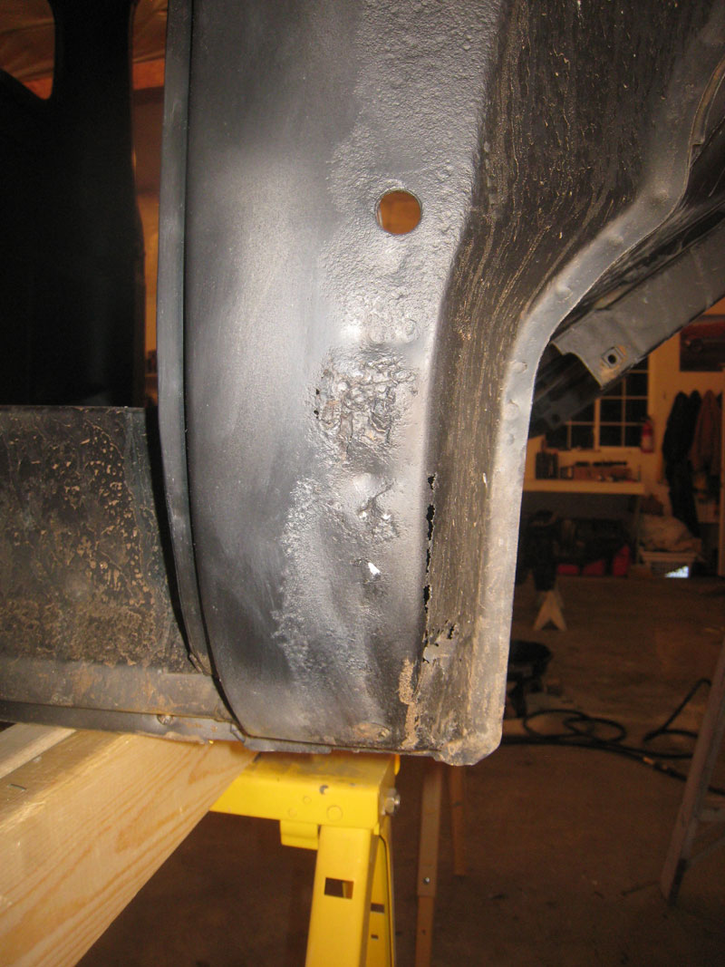

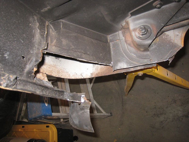

    Here are some pics of the cab corners. I've found a couple of places that sells replacement cab lowers. Sacramento Vintage has some good deals, along with LMC. Anyone purchase from either of the places? Better luck somewhere else?

    Looks like you are having fun. Always glad to see a young guy like me salvage an ol' effie. I rebuilt the entire bottom half of my cab, replaced the firewall (someone pushed it in about 8 inches to house a 454) with stock one. Let me know if you have any questions replacing those parts.

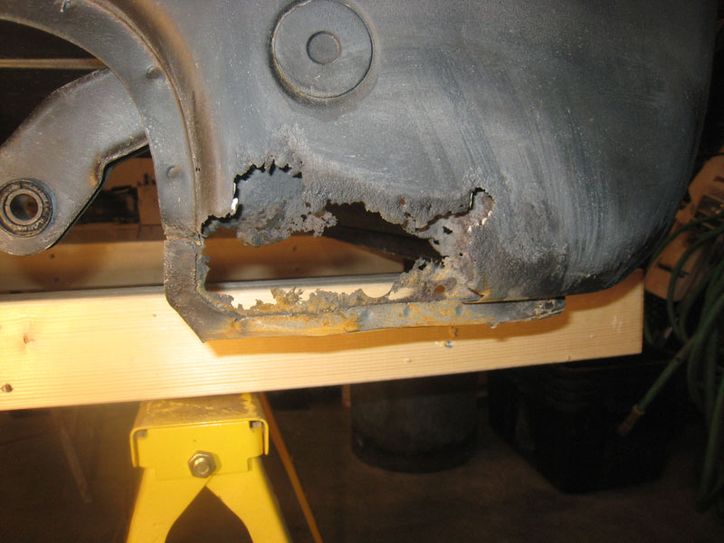

    Been on a little hiatus. I ordered my parts from Sacramento and they had the front cowl repair panels for both sides and only the left rear cab lower. So I ordered the right cab lower from LMC the same day. They both got to my place that week, but LMC was one day later. Good job from both teams. I'm so amped to get my cab ****oned up. I'll post some pics through the week as I cut and weld the ****** up.

    I'm patching up the front corners right now. One side I made the patch and the other side was a stamping from Sac Vintage. The stamped part was not as sharp a bend going into the door jamb as the original is. Looks like I'll need to weld a strip piece on top to get the same door gaps.
    I've got a 54 and have most of the front end ready for final prime. Luckily not much rust. I was originally the same dark green as yours. The previous owner took out a lot of leafs on the front spring so I'm thinking of replacing them with some lower monoleafs. Anybody else want to chime in or spring conversions?

    Here is a couple of shots of the patch panels. The left side I fabbed and the right (black) is the stamped replacement. I still have some fine fitting to do before I weld. Hope this helps.

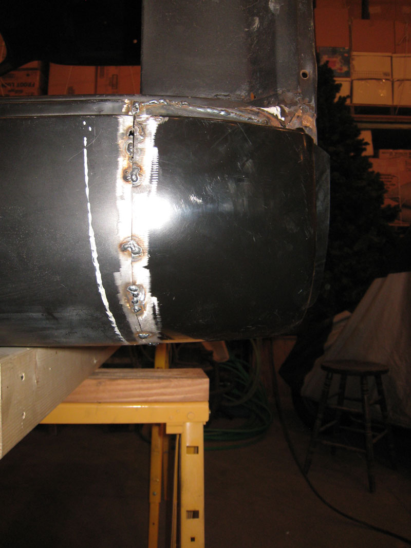

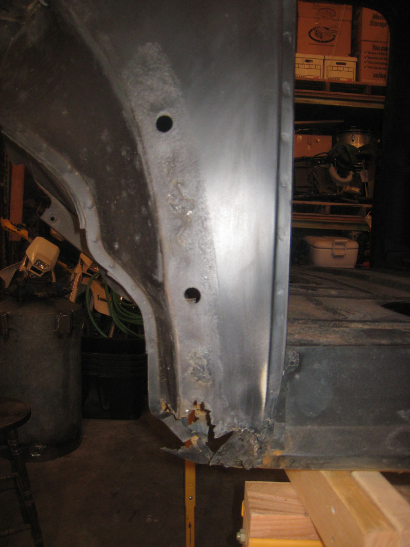

    Cab Corner number 1? Ha ha ha! I love that I have no experience with anything, other than motorcycle engines and the balls (or lack of brains) to try anything. I literally am learning how to weld on this cab!!!! :) It's a mig - get it close to the metal and pull the trigger right? Easy enough....
    Well, so I've got some pics of the progress on the p***enger side cab. I figured it was the one part that I'd see least, as it on the wrong side, and is partially covered by the truck box too!
    I got everything cut out. Confucious say, he who cut first ask question latter end up with something.... or other, that really wouldn't fit into a chineese saying about wisdom anyway!!!! But, patience was the key. Then I started welding. They weren't kiddin when they say to let it cool. ALOT. between welds. So here are the pics.
    Let the newb beatings begin. ;)
  24. grovedawg
    Joined: Oct 20, 2009
    Posts: 451
    grovedawg
    from Heber, UT

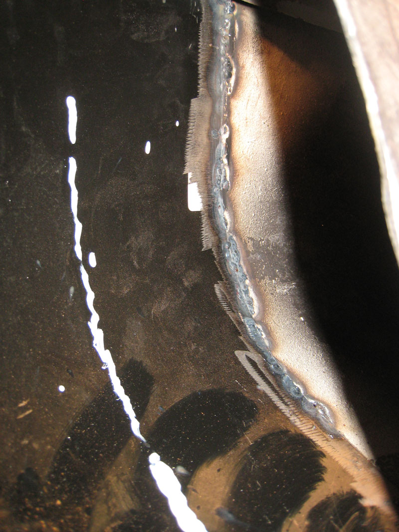

    So, my question is about the weld now. I've got it on super low heat, and a good speed. I really can't do anything other than shoot for a second or two before it punches a hole in the metal. So, I've basically been doing this little modified spot welding technique, where I zap it and create a good puddle, hope there's penetration, and shut her down before she kicks a little whole around the puddle.
    You can see from the pic, the backside still has a seem where it's **** welded. I don't know if I've got enough penetration on the thin sheet metal to really do the job right. But, I'm getting it hot enough that it's warped in at the seam. I figure I can use a little filler and smudge that warping a little. Or, be more patient and weld a little hotter. Check out the pics above, and this one again and let me know what you fellars think.

    Any help on the weld? Should I have left a little bit of a larger gap between the ****?
  27. uc4me
    Joined: Feb 3, 2006
    Posts: 516
    uc4me
    I am no welding expert by any means but it looks to me like you might want to try slowing the wire speed and hold the tip of the gun a little closer to the piece you are welding.
    I wish I took some pics of the work I am doing now, I just welded over the stake holes in the box of my 55, I could have shown you the technique that works well for me.
    I have a lincoln SP135 mig (110V), with shielding gas and am using .032 wire. I have the current set at "d" (the highest setting) and my wire speed somewhere just north of 3.
    I do the same thing that you mentioned as far as spotting a small weld as opposed to running a bead, then move to another area of the repair and spot there, then alternate between them to keep the warpage down.
    hope this is helpful
    also... try to avoid having 90 degree angles on the corners of your patch pieces meet, the heat on both sides can really warp the metal, I always try to round the corners before I weld 'em up

    I find it best to have my cuts as close as possible on most situations. That being said I have been known to overlap the panels in some situations too. I always weld the panel with a few small spot welds and test the fit, If it looks, good i'll continue making small spots until i have a solid attachment starting at one end then the other, back and forth until it's solid, to keep the heat down. But i've also been known to weld it like a mad man and warp the hell out of it too.
