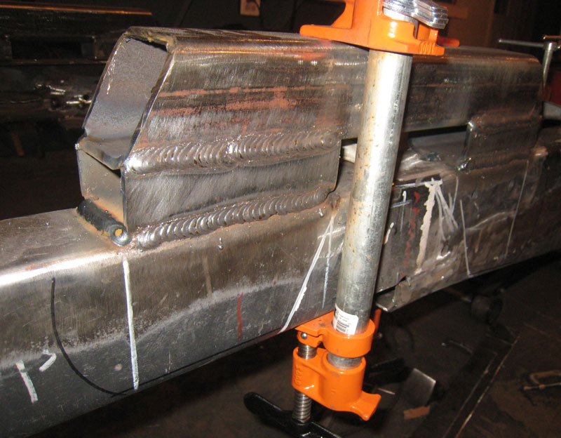

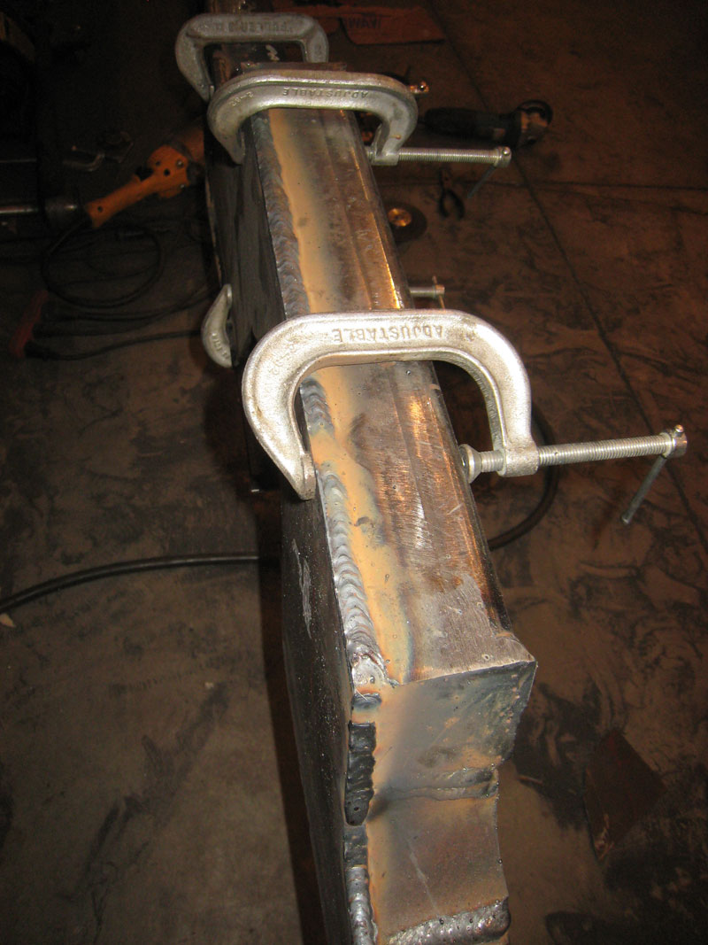

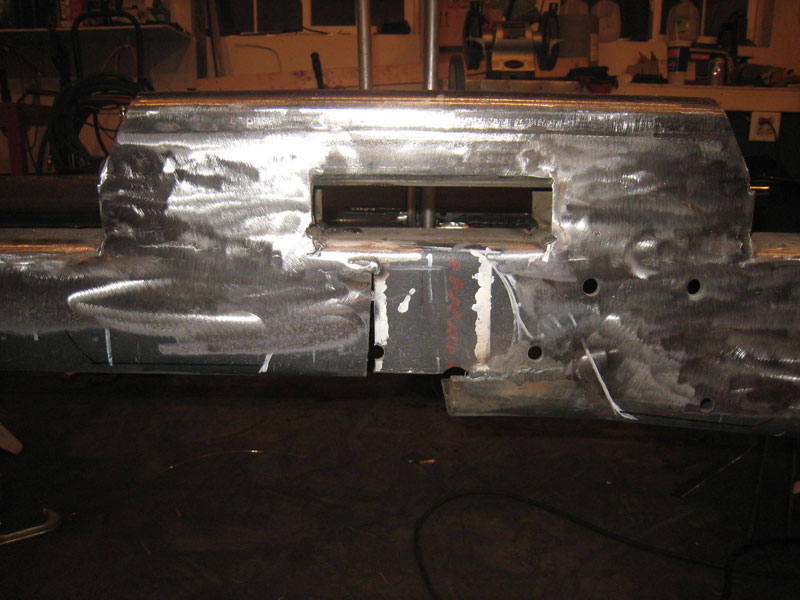

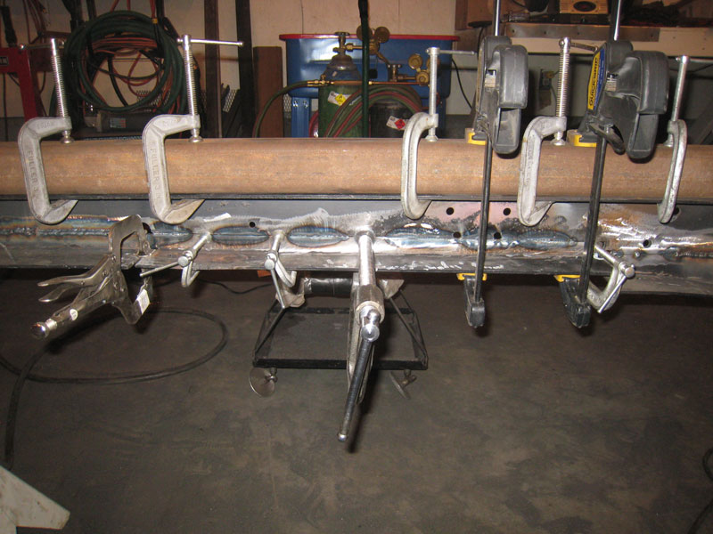

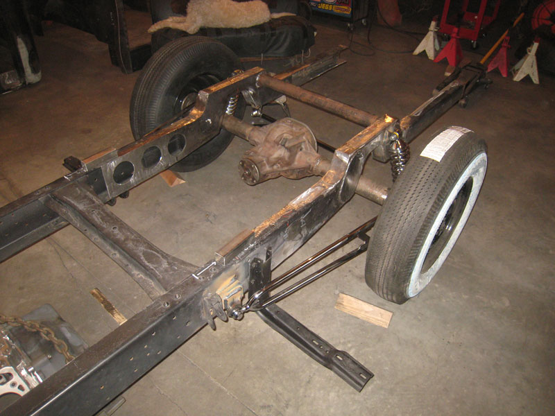

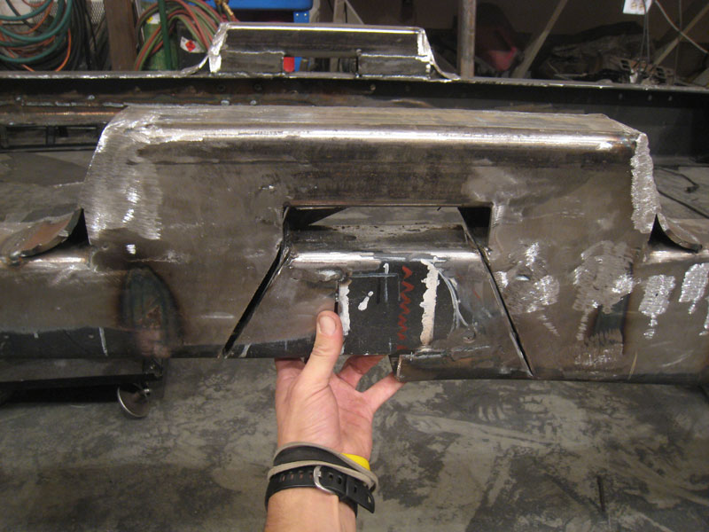

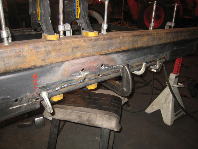

    Here's the latest that I've completed on the C Notch for the rear axle. I've got one side, and with all the work that I've done I think I could write a book on HOW NOT TO MAKE A C NOTCH IN YOUR FRAME. Learned alot, cut a lot, ground A LOT of welds. But I love the way it looks now. Now all I have to do is finish the other side. Ha ha ha!

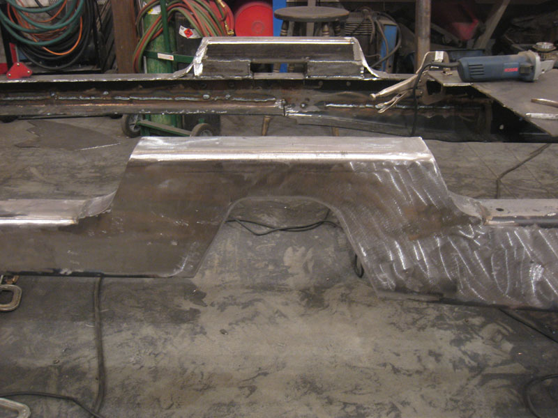

    Here are some more pics:

    And some even more:

    I love your learn as you go attitude! You can watch someone perform a task but you don't LEARN until you do it yourself.

    looks great thats pretty much how i c-notched mine

    Thanks. If I could go back again I would have probably just carefully cut out four plates, and welded them into the frame, and welded in a top and bottom. But oh well. :)

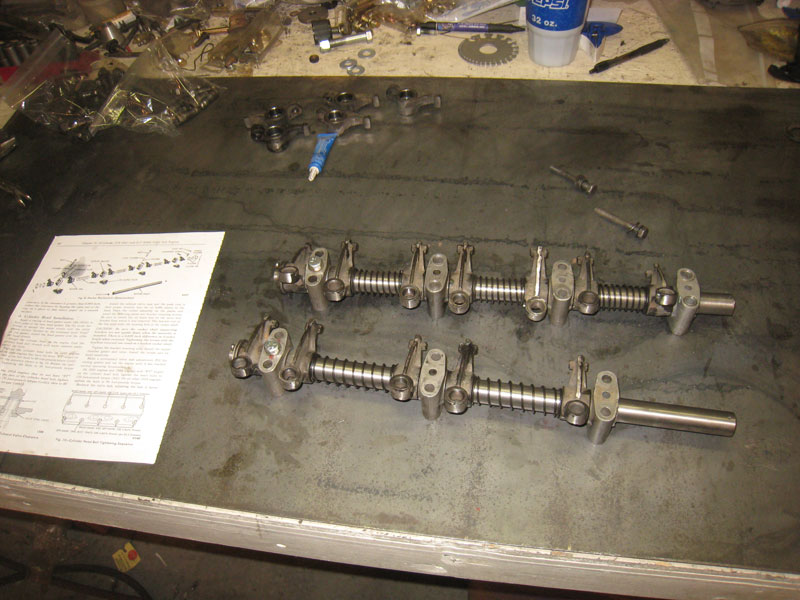

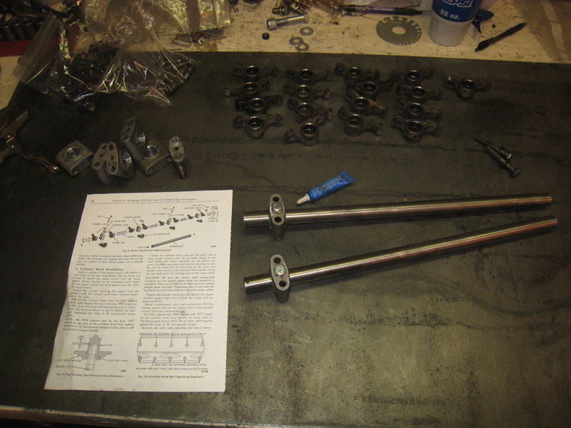

    So I rebuilt my rocker arms, following Tim McMaster's description of blocking off the rocker arm shaft to pressurize the system. Pretty slick little way to get higher pressure, and force oil through the bottom of the system. Check it out here Tim's Y Block Rocker Arm Video
    I also was able to check the piston to valve clearance one last time and I had plenty of clearance. So I pulled everything apart, and because I'm a stickler for detail I took a hand ream and reamed the oil galley's through the crank to get out the 50+ years of rust and "uneven-ness". They look pretty now. Took everything down to my machinist two days ago. Hopefully he'll have everything balanced by Wednesday of next week. That should make for a happy Turkey Day. Putting it all back together.

    I was able to measure a little more out on my rear axle. It just takes time to get everything just right. So, now I've got pretty much everything measured, twice, three times, and now tack welded into place. I'm going to pull the cab off and quadruple check everything before I burn it all in tonight. :)
  12. grovedawg
    Joined: Oct 20, 2009
    Posts: 451
    grovedawg
    from Heber, UT

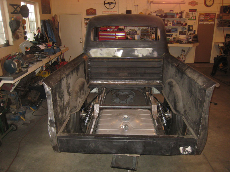

    Pulled the cab off, and turns out my rear axle center line was off about 3/8ths of an inch. It took a skosh to figure out where it went wrong, but now everything is dead on. So, it's all burned in and mocked up. I also threw a beffy rear cross member in the back to hang a reciever off of. Now I've got to figure out how to use two gas tanks. Switch? Two fuel pumps? or link 'em up?

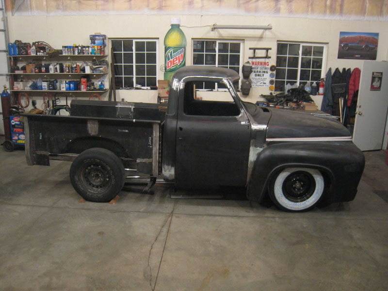

    Less talk. More pictures.
  15. grovedawg
    Posts: 451
    grovedawg
    from Heber, UT
    Minus the drip rail.
  16. 'bout time you posted these!

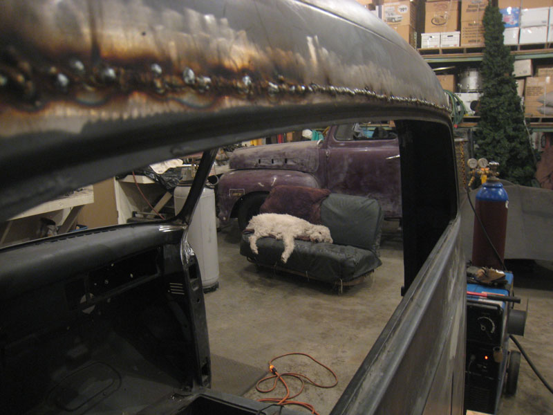

    Looking really good!!! how mutch did you chop? or did you just bring the peak down? heres a pic of mine chopped and drip rails removed

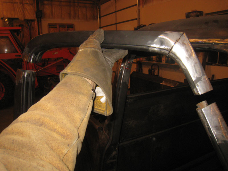

    Nice chop Charger. I just pulled the peak down. Left the front window frame intact and cut the inch under the drip rail in front. I cut an inch out of the back of the a pillars and slide it down over the window frame rails. Kinda like sliding the two puzzle pieces together. Then I removed the drip rail. That was interesting.... :)

    Before and After.

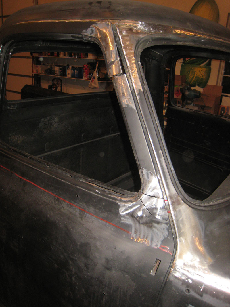

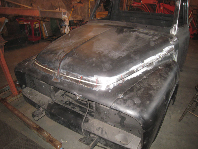

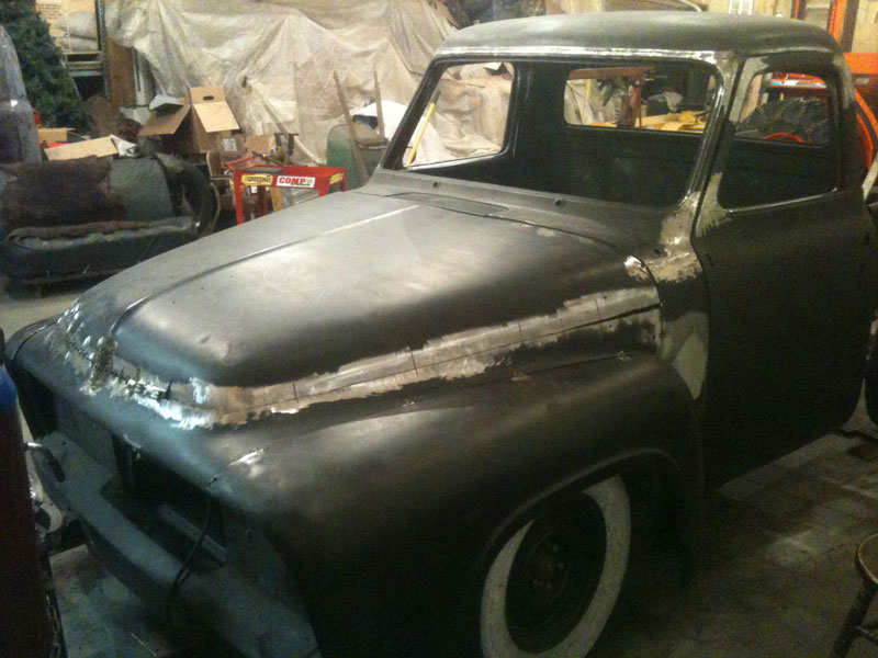

    More pics. Less talk. :) The doors are done. Mostly. I need to re-work the driver side a pillar on the door. I'm a perfectionist.
  22. grovedawg
    Posts: 451
    grovedawg
    from Heber, UT

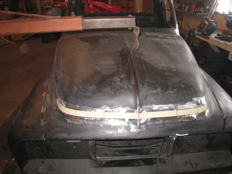

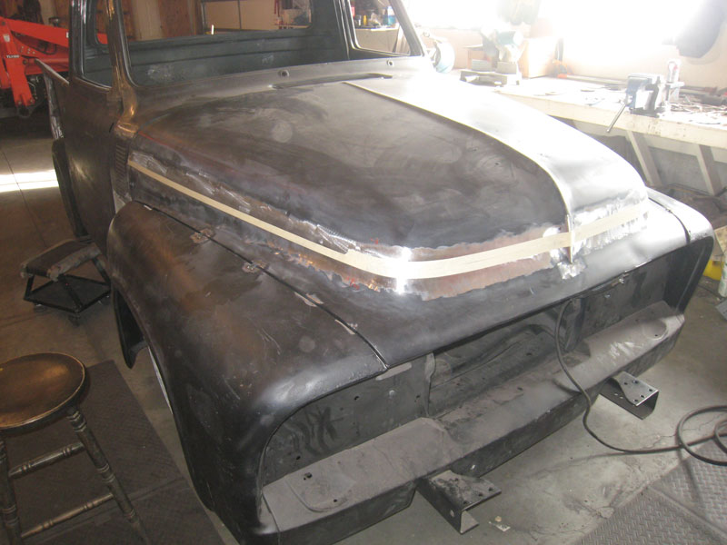

    Even more pics of the door. And now the pie cut the hood.
  23. grovedawg
    Posts: 451
    grovedawg
    from Heber, UT
    If I had to do it over again, I would probably only take out 1 inch, rather than the 1 1/2 inches. But, I still love it. Here are some profile pics.

    Looks awesome!!,I finished pie cutting my hood a few weekends ago,also took 1 1/2 out, makes a big difference in the look!

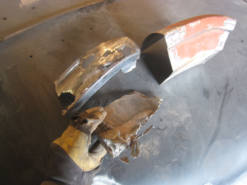

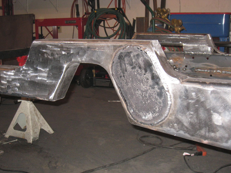

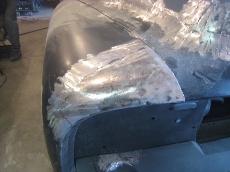

    The front fender corners were SHOT. And the previous owner just slopped in the bondo, rather than fixing them. So here's my repair form a couple of really bent up front fender donors.
  27. Tacson
    Joined: Jul 14, 2006
    Posts: 856
    Tacson
    Nice recovery of the fenders
