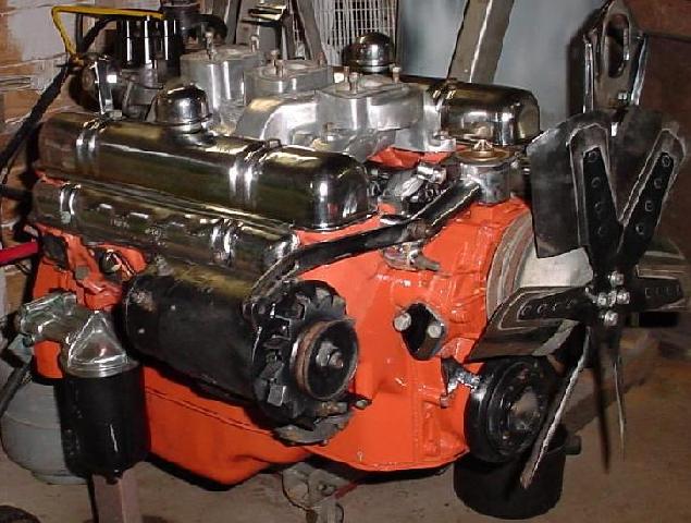

    Busy weekend. But i got a great deal accomplished, and it's almost time to start spending money.
    Last weekend i stopped during the engine disassembly after a main cap bolt outfought me and stayed tightened down. Well this friday, i borrowed some tools from my neighbor, and among them was a long 3/4" drive ratchet. Legitimately 2 minutes after getting it in my hands, that main cap bolt was undone. Thus, the rest of the engine disassembly went without a hitch. Crankshaft came out, pistons came out, then the camshaft and lifters came out as well. Surprisingly, for as grody as the block is, the internals are is pretty decent shape. The block is ready for the machine shop, and hopefully a quick cleaning & honing, plus some new freeze plugs and petcocks should be all i need. Let's hope.
    Got back into it on sunday, and finished up most of the suspension disassembly. Took the wheels off and took the drums & backing plates off, then compressed the passenger side spring and loosened up the lower control arm. The upper control arm had some nuts that were stuck, and turning with the bolts when i tried to undo them. But MAN, coil springs are kind of terrifying. I thought i had compressed the spring enough, but apparently i was not correct, because when i undid the lower control arm, the spring changed its position very rapidly. So then i took a break to get some water.
    I got my hands on an impact gun, and used it to snatch the stuck bolts holding the upper control arm in, and the whole assembly was off. I also got a pitman arm puller and got the center link the rest of the way off.
    So now all i need to do is figure out how the steering knuckle and shafts can be removed from those control arms. I have the shop manual, but i could use a few more diagrams to show exactly what i'm supposed to be doing. After that, it's time to start throwing some money around. I don't even know where to start. Machine shop? Transmission rebuild? Suspension rebuild kit? POR-15 to start painting the frame bits that i have exposed and the control arms?
    I've got a lot of options. But i gotta say, it feels pretty good to be 90% of the way through the hardcore tearing down that i planned to do on this build! And now, pictures ahoy!
    The block! Grimy, but ready for the shop.
    A few of the cylinders
    Here's a detail. Those spots are just some dirt that's fallen in during the teardown.
    Passenger side suspension bits are free!
    The brake hardware and drums look pretty good. Maybe i'll see if someone wants to take this stuff off my hands.
    Frame shots. Featuring the liquid wrench that i use by the cubic ton.
    Check out these gnarly motor mounts. These guys were chewed up something fierce.
