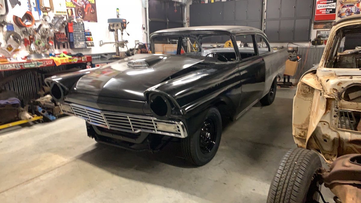

    Starting to wire(STILL WAITING ON SHIFTER PARTS!) hahahaha
    Opened up the kit and stared to separated the looms in the direction they will go(rear,Dash,Front,etc,etc)Should be very simple..... I am not using a bunch of accessories......Just using an E-Z kit... 7.JPG 8.JPG 9.JPG
    Deciding on where to place the fuse panel.... I am surprised how little room with all the vent/heater duct work that space is a premium.
    Needed to get the car on the ground and put on the new rubber and 15's.... happy with the oh so important stance.
    (note)... finding an early set of 15 inch Ford Steelies are getting harder to find.... Getting straight un-bent ones are now at a premium.
