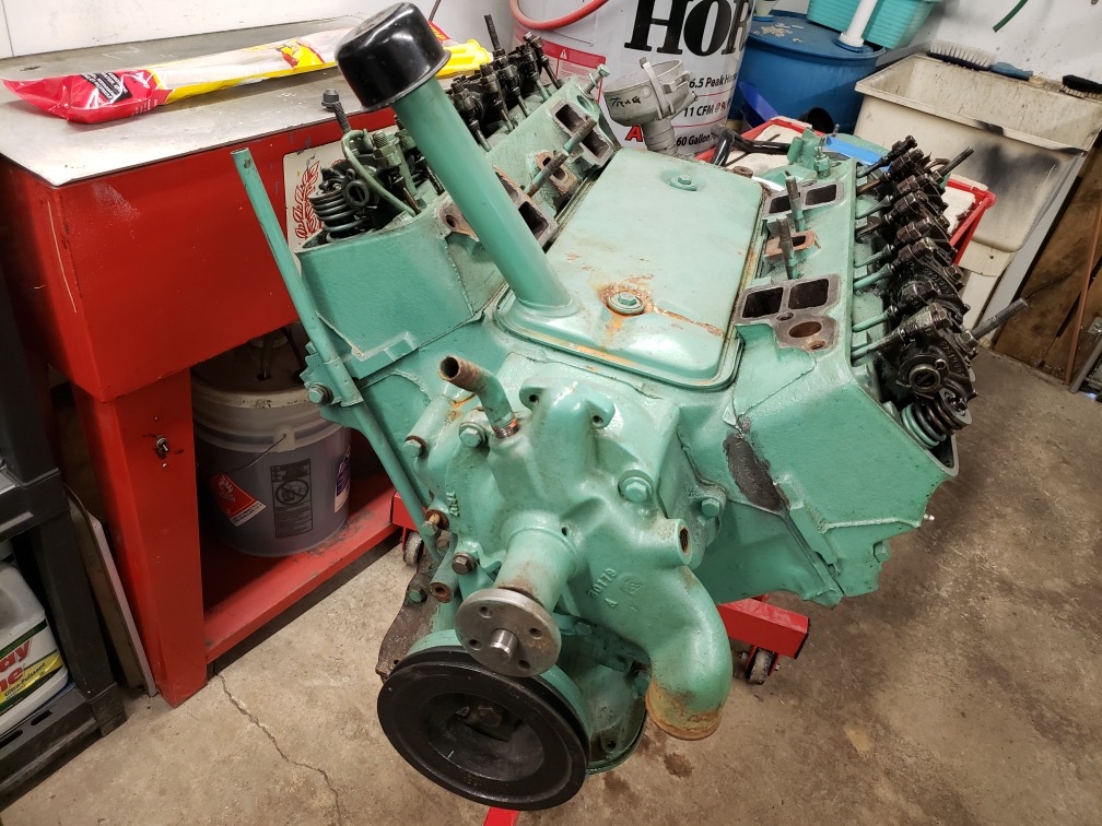

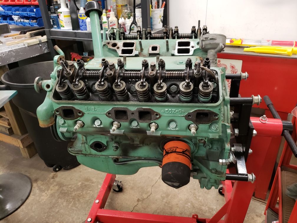

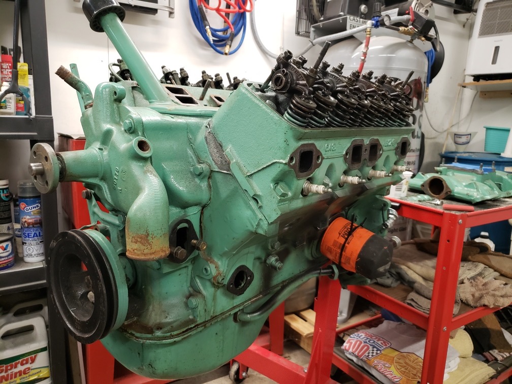

    Now.... completely turning the table... remember the "other" 57 from Texas?.. the original car I started the thread about?.... well, I made a firm decision on its power plant.I was planing on doing another FE.... but...... the more I thought about it... I am going to use a Y-Block.
    I recently bought 2 Y-Blocks..... one is a 292(pictured) and the other is supposed to be a 312.... but its still in the donor car and until i can pull the engine and examine the main caps and crank flange.... who knows....But I will mess with them and make a nice Y-Block.
    But that B/W 57 will be Y-Block powered..... and possibly a 3 speed OD trans... or (shudder) a later model OD 5 speed.... who knows.... I change my mind daily.
    Please IGNORE the Fram filter..... hahahahaha
