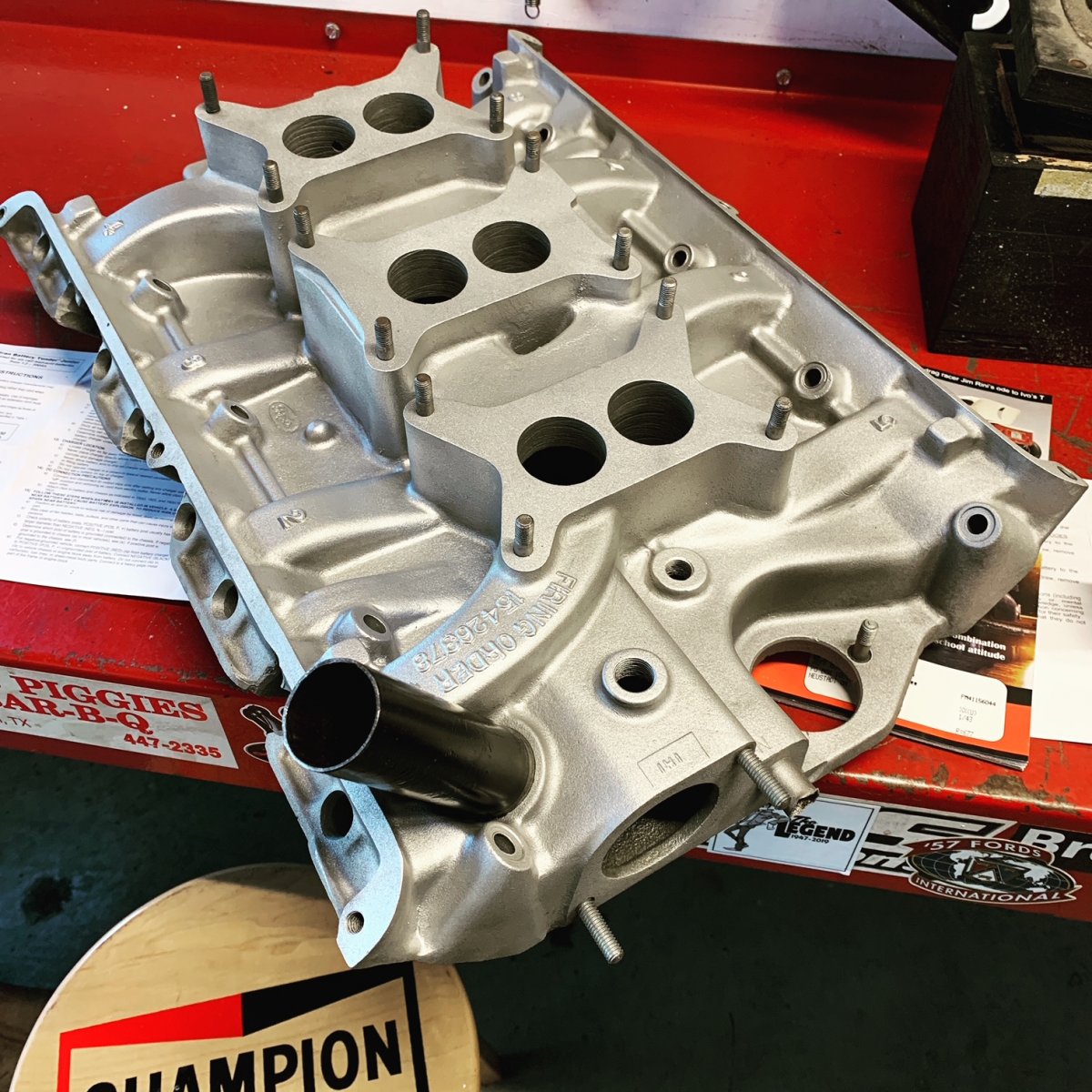

    Well, the battle continues.....
    .....about 3 weeks ago... I was all set to hit the exhaust shop then to the bodyshop.....
    And of course.. a m***ive hiccup..... no.. a mule kick right in the B***s.
    I notice a slight amount of coolant leaking just under the thermostat housing... not a drip... just a wetness.....I figured it just needed a 1/8 turn of tightening and paid no attention.A very good Ford Pal dropped by to double check my wiring and other progress....(I believe in have a fresh set of eyes roll over prior work... just to make sure)
    ....Mentioned the coolant"wetness" and he said.. I should use a flat water instead of a lock washer around the thermostat housing.... because a split washer tends to seep and leak.
    Ok... no problem.... I put it on the "to do" list... which never seems to decline.
    Drained the coolant, removed the housing,...cleaned,new gasket and applied the "Right Stuff" RTV(I love that product)
    Let it cure for 24hours(which I do with anything)
    Next day... fill the system with coolant and..... I have a m***ive leak coming from the housing and intake underside.
    Great.. now what.....?
    Drain the coolant again(of what left) Slowly und to 2 fasteners,.. and as I remove the top bolt ...I feel a "pop"... a big chunk of my NOS intake snaps off.
    Well.... now what?
    I have 3 options..... buy a new intake,repair the unit or find a ****py boring 4 barrel unit.
    You must understand this intake has NEVER been on a car.It was a service replacement unit and date coded.
    To say I was heartbroken was a understatement.
    Back to my options.....I looked up and searched what the cost of buying a new intake was..... 900 USD - 2000 USD..... and combine that with present exchange and shipping.... I was looking anywhere from 1500-2500 bucks ...And with no re***urances a new intake would not be square..shaved ,... already welded upon,...etc.etc.Too big of a risk.
    I need to repair what I have..... so,...I have another acquaintance .. who is an EXTREMELY talented welder... who after I presented the problem...said he could fix it.
    So.... I then removed the fuel system.. and all linkage,etc.etc, removed the upper valve train. the shafts and such.... pulled the intake very very gently.
    After doing some research..... I found that this was a very common occurrence with these factory intakes....didn't make me feel better.
    So.. off it went...... he told me he was so busy and it would be a month.....
    ugh.
    Wait wait wait.
    Then..I got the call and I was down at his shop and got it.
    Absolutely...PERFECT.
    I wasted no time this weekend with the help of my friend Terry and got it all back together.....
    NOW..... I am going to the exhaust shop.
    So.. thats my sad story.... hahahah
    And thanks guys for the kind words in the previous posts..... The war continues and we will persevere.

    Yes Dan,..... and it was better to happen in the shop than some 500 mile tour....(oh god!)
    We studded it and I feel confident......
    Not sure how or when it got Helicoiled.... or by who... but we have resolved the issue.

  8. Super nice fix.... What happened? Well, it either wasn't as 'NOS' as thought, or may had been damaged during manufacturing/installation and discarded by Ford. Somebody pulled it off the s**** pile and took it home for repair. Wouldn't be the first time a 'second' has showed up...
    Could this have been a 390 tri-power intake? Those weren't installed at the factory, maybe the dealer mechanic spotted (or caused) the problem and the intake was replaced rather than repaired for the customer.

    Really clean repair, would have never noticed it. Did they have factory threaded inserts in them? Seems odd that hole would have been repaired having never been on a car. Either way though, looks good now.

    I was curious about the Helicoil as well. That repair is freaking fantastic! Can't even detect in any way it isn't original...

    Thanks guys...Grant Schwartz did the repair. Uber talented local and I am very thankful for his work.
    I have know idea to any of the above questions... but i can tell you it has never been on an engine.. no marks or gasket stains ,.. no coolant disintegration around those ports or burns on the blocked off heat crossover areas.....whatsoever.... Super clean as far as I can see internally and the bottom splash pan looks brand new. Took that off too to inspect and nothing but ever so slight condensation rust.... 2 tiny spots.
    ....... strange indeed.. but.. we are a go.....
