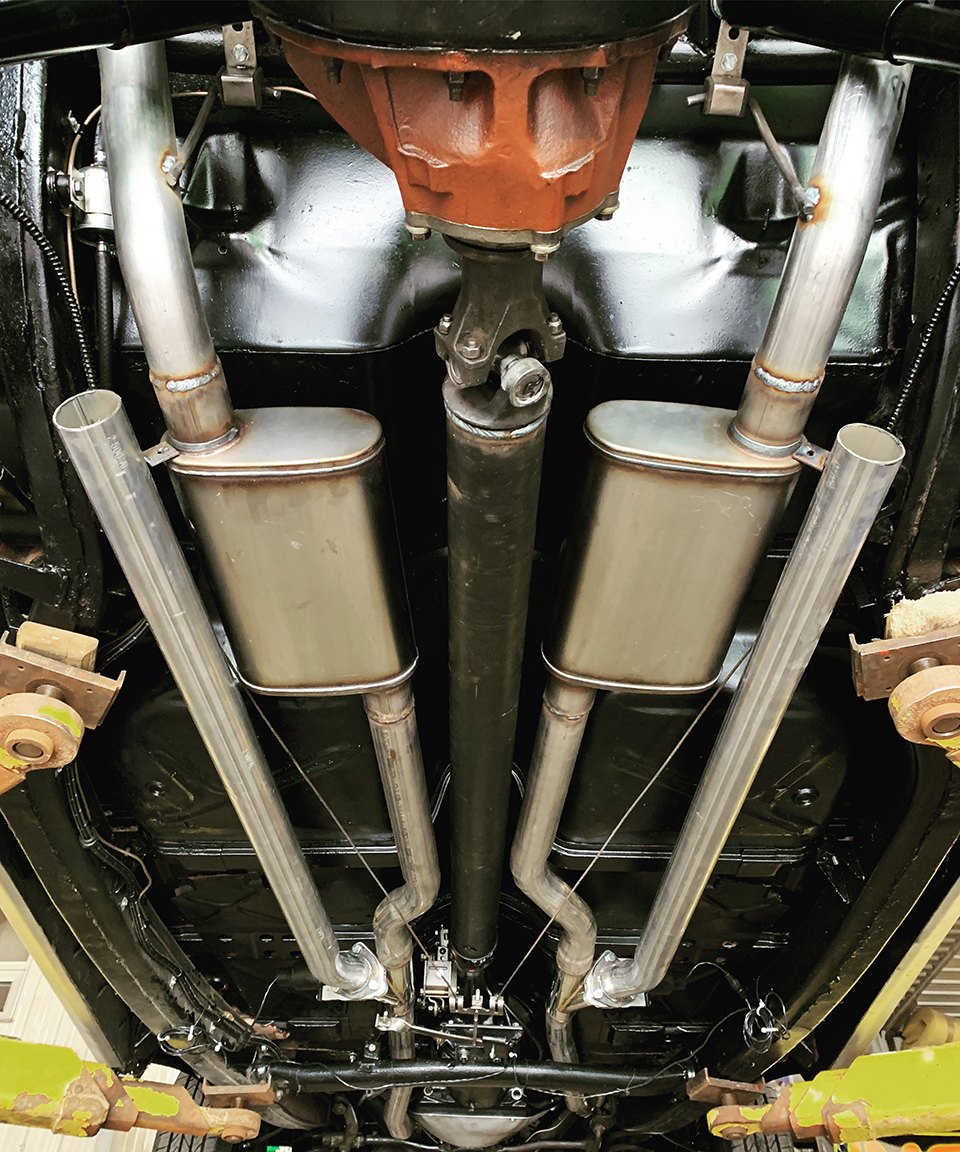

    I like noise.
    Exhaust done and dialled in.
    53 effie, alfin32, bchctybob and 28 others like this.

    Are you going to do some kind of turnout to aim it out from under the car?
    I was just curious.

    @enloe
    Nope.. straight cut as is....

    My guess would be that when the car reaches speeds that Jeff likes, the exhaust disperses pretty damn quickly.;)

    Correct Dan!
    I just like the look of a early hot rod roadster with straight pipes under the rails..... and I like a long scavenger pipe look as well.(Not sure if that is the right term.....but whatever)
    Rich Simmons built the exhaust system and is noted around these parts for doing excellent work.He asked if I wanted the scavengers to be turned down or out....No. I said.... makes to much of a mess on rural roads.....They stop about 7-8 inches from the rear shocks.....And all noise is behind me.
    The mufflers are Xlerators, all stainless, and provide a mellow rumble on idle.... I used the XS1236 on the attachment shown.I never heard of these before..... but the cost was great.... I strayed away from a gl*** pack only because they were cheaper and available at the moment.I did have a set of Cherry Bombs in my truck.... but the bodies were 20 inch long and a total length of 24.... with only a 2 inch in and outlet....I decided to p***.
    The system is all welded and super tight.... and there is no profile view of exhaust hanging below the frame.(hate that)The whole system is very symmetrical. 2.50 all the way,... and after some research..... that is the very least size for an FE to breath.
    Streetwise,... probably a hill of beans.... But Lucas Doolan would argue that with me.
    Anyhow... I am happy.... and now the car finally is heading to the paint shop this Friday.
    Thanks all.
