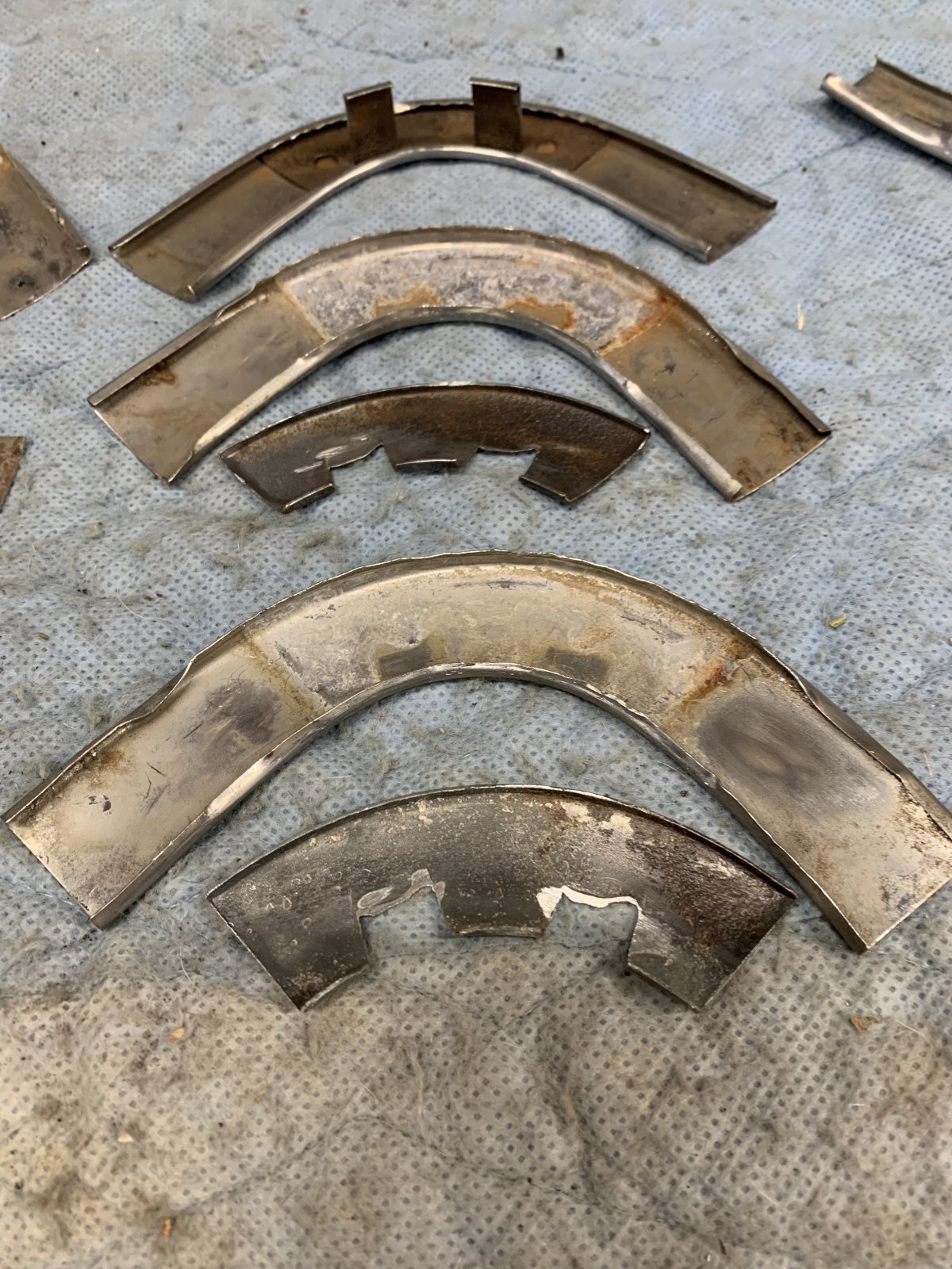

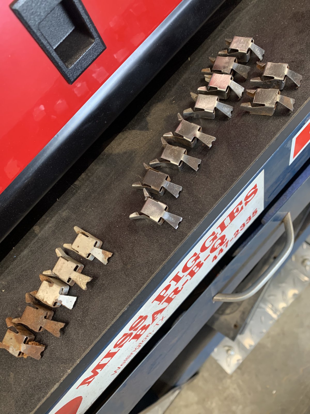

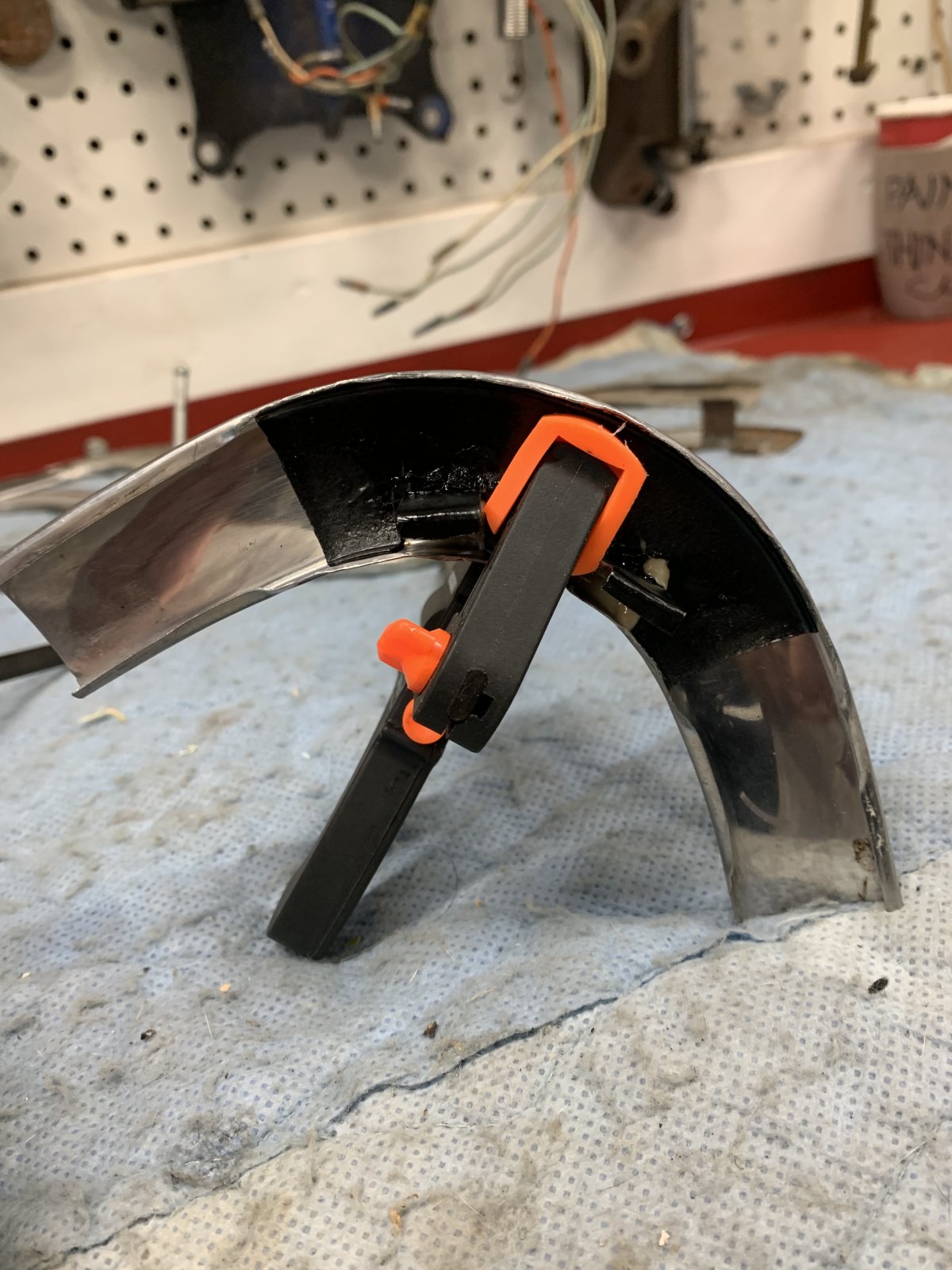

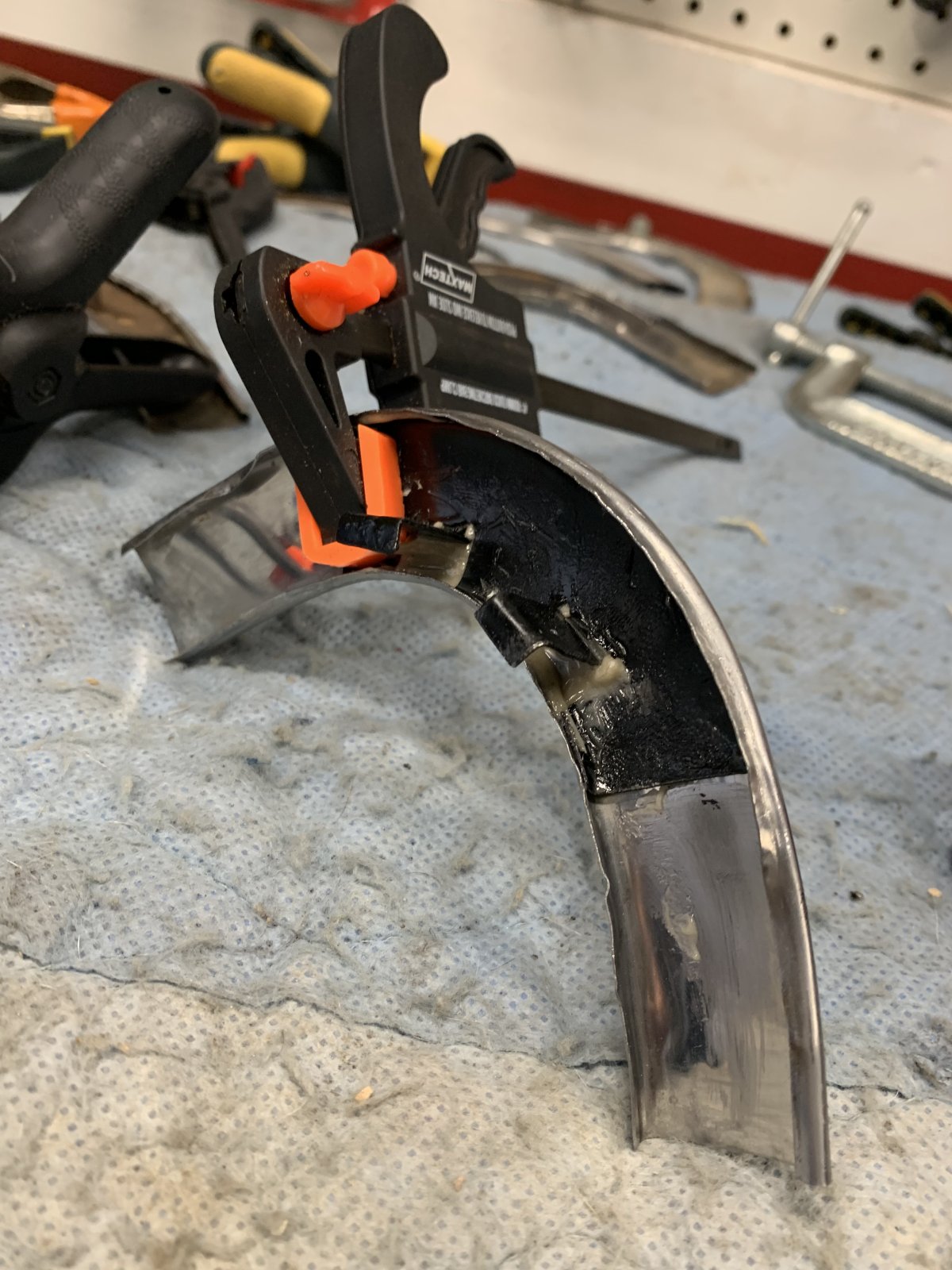

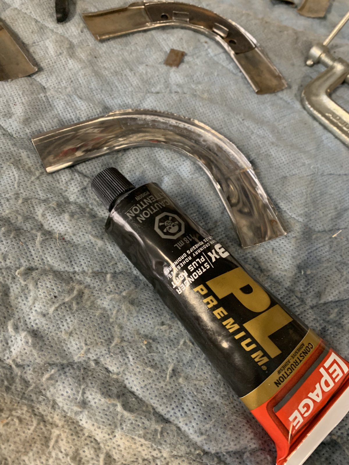

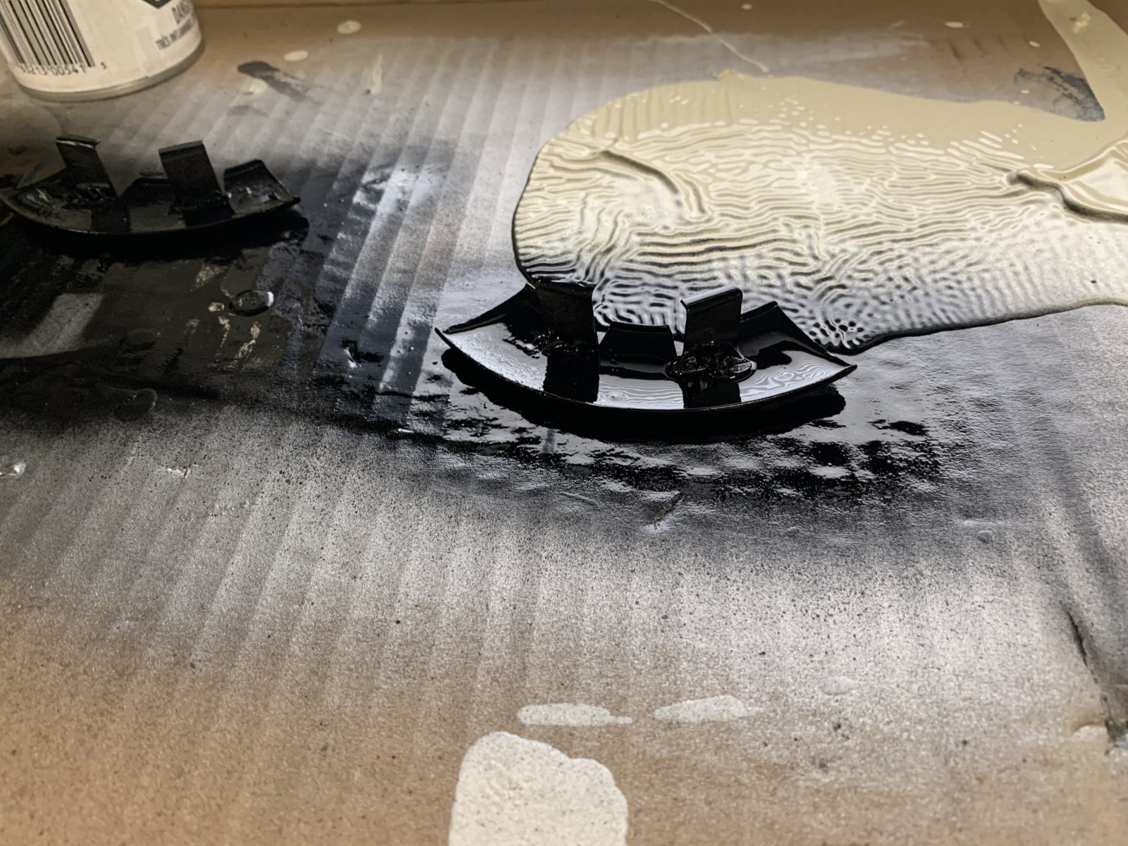

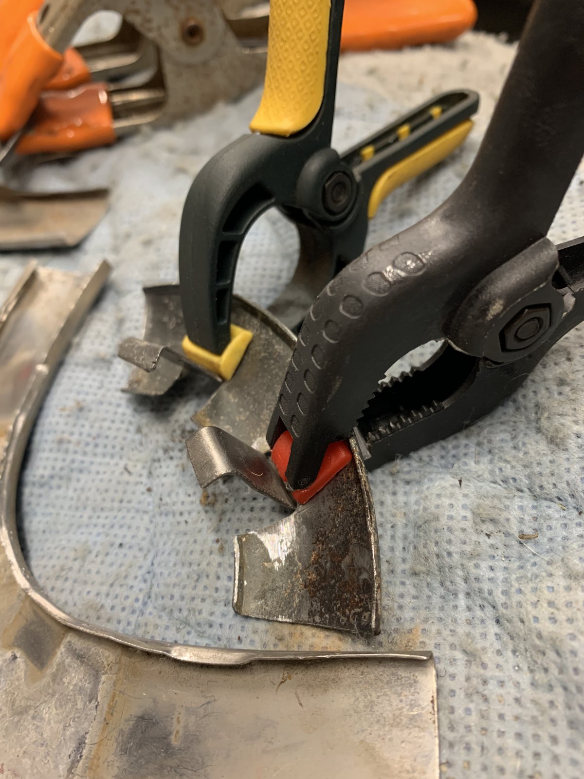

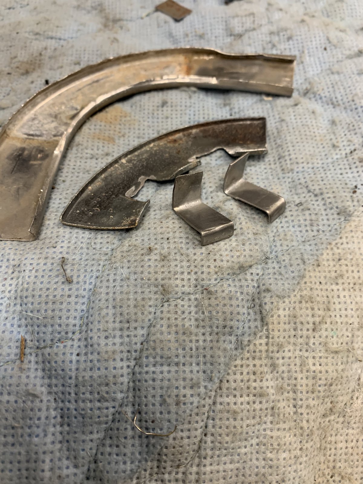

    So..I have to repair the windshield and rear window stainless..... I have a ton of it. but 50% is heavily damaged or dented bad..... I did managed to get 2 full sets out of my stock pile...BUT.....The brainiacs that took these off of other 57's.. tore, or completely damaged the small mounting tabs on each end of stainless.
    So.. I have been repairing....
    The "J" corner stainless pieces ALL have rotten or torn interior tabs.... this pieces were made of reg. spring steel and simply rotted away over time.
    I had to carefully dis***emble.... make "J" tabs, bond them.... then insert them into the stainless J Corners.... again... I had about 16 pairs and Only one was ok to use....
    this job is incredibly tedious.........
    Nearly complete now.. but I have to carefully re-crimp.. what a PIA.

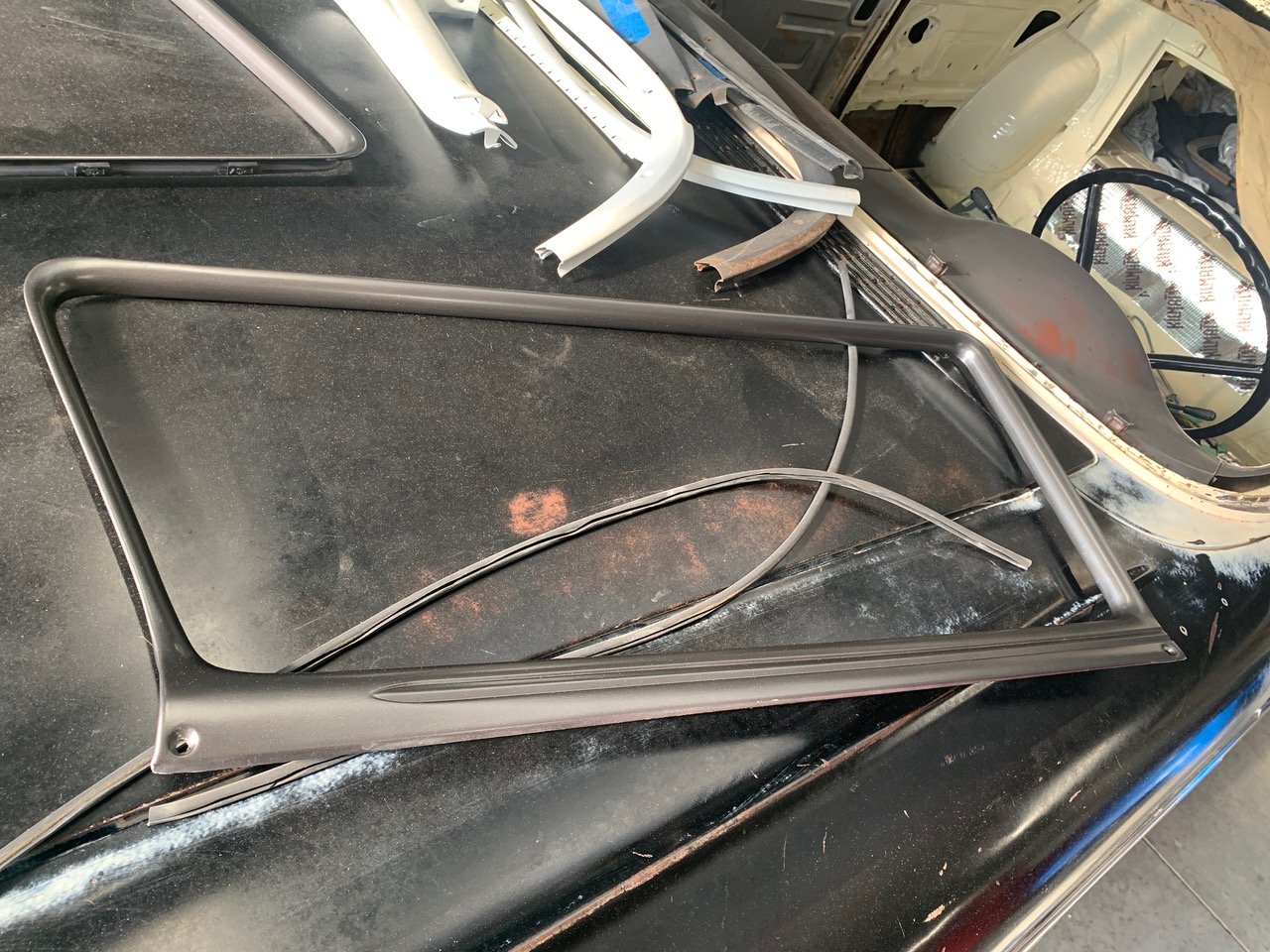

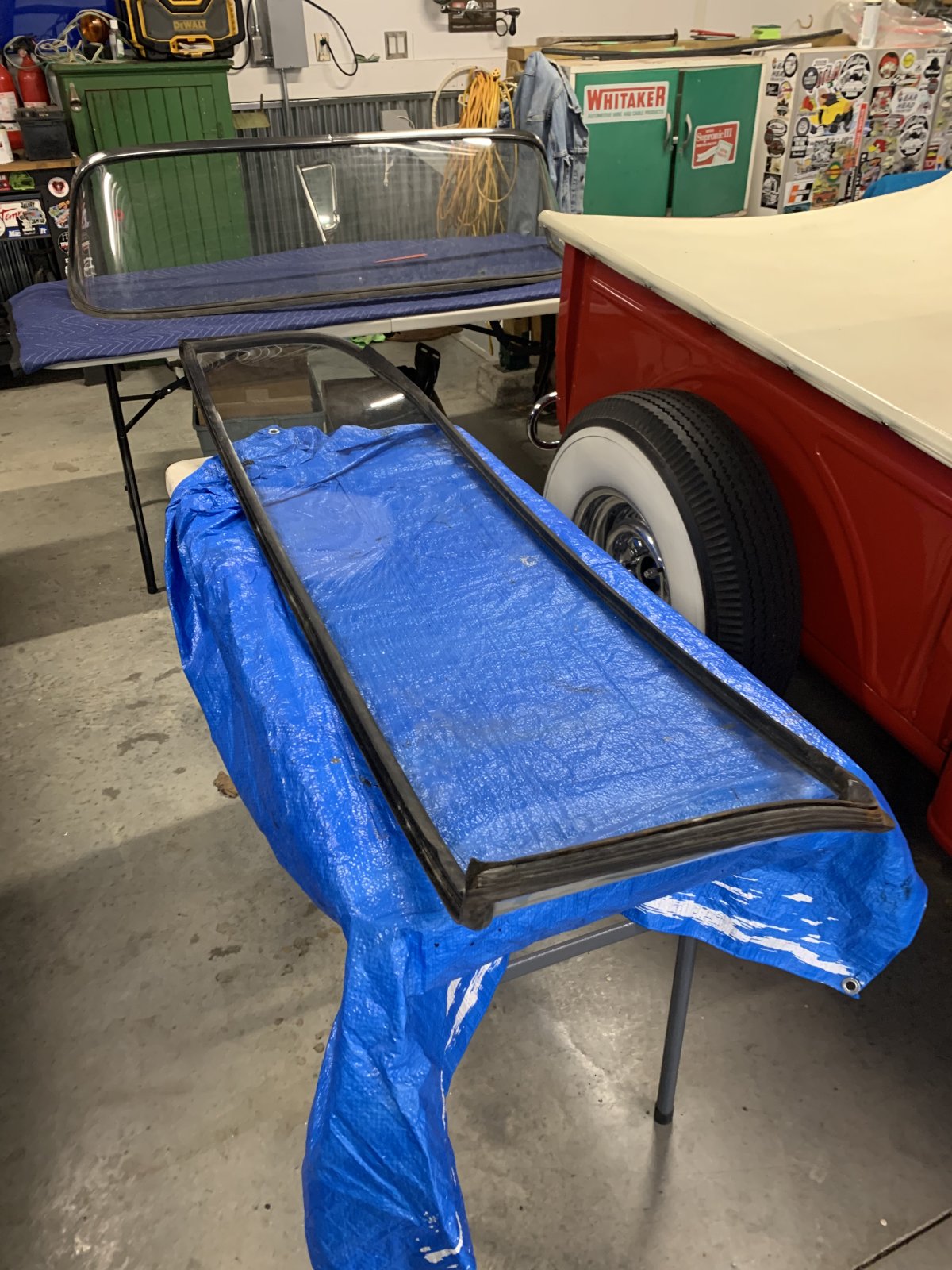

    And Onto the front n rear gl***......
    this makes me EXTREMELY nervous... front gl*** now is about $500-700 and the rear is a little less.... so getting Fairlane gl*** is a bit easier than Custom Gl***..... Of course. I got 2 custom based cars....
    So.... I have had my gl*** stored safely away for a while.. and to do these cars. all the stainless must be attached to the rubber on the gl***... so. hence.. the above posts.... and the gl*** CANNOT go in until the Headliner is installed.
    I will not attempt the installation of the headliner.... I have a hard time putting a T shirt , let alone a m***ive headliner.(I have all the correct bows and they are numbered BTW)
    So.. as mentioned... I have my stainless and I am still repairing. but I have attached the rubber and tested the stainless..... so far so good.
    Oh yea. I had to gather all those terrible Wind lace fasteners ,clean and paint....
    I know NONE of this is cool Hotrod Stuff...... but is really really important to get the gl*** and stuff ready.....

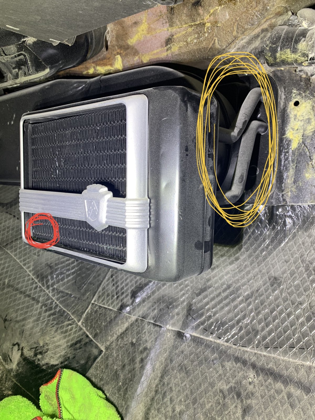

    And ....Of course.... my Heater core took a dive..... great..... just great..... leaking on the red circled area.
    Its not a big issue. just another roadblock.... and with the rise of material and labor costs these day...
    The cost of a rad shop has almost tripled in the last 3 years....... FML. IMG_5498.jpeg
