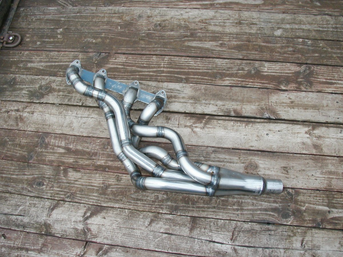

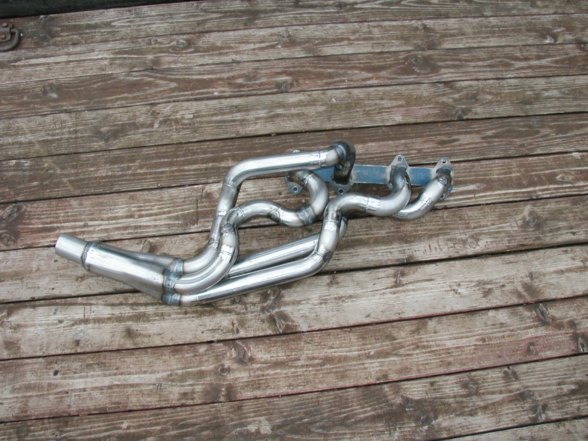

  8. I remember seeing them listed and thought long and hard then p***ed. I had already built the Headers for the FE in my 57 and decided to stay the course. Then the project went on the Shelf. Been "resting" for few years now. Here's a photo of what I built.
    Ready to coat Headers 002.jpg Ready to coat Headers 003.jpg My next move is to cut the collector off and install merge collectors on them. Krazzy Stuff! Keep up the good work on yours.

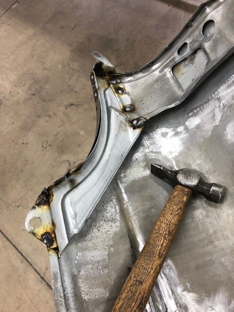

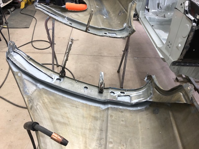

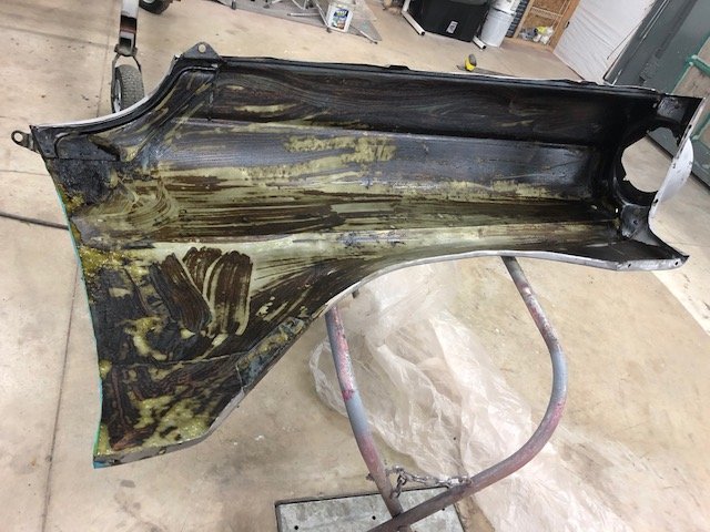

    IMG_2684.jpg IMG_2552.JPG IMG_1515.jpg image29.jpeg image39.jpeg image47.jpeg IMG_1417.jpg

  23. Wow, love seeing progress. Lucky for me I only had to do both lower fender corners. I have however done all that on different Customers cars. Glad to say it's all behind me now. Maybe you'll get me inspired. My 57 is in paint but died on the Jack Stands several years ago. Retirement isn't what I had planed as of yet.

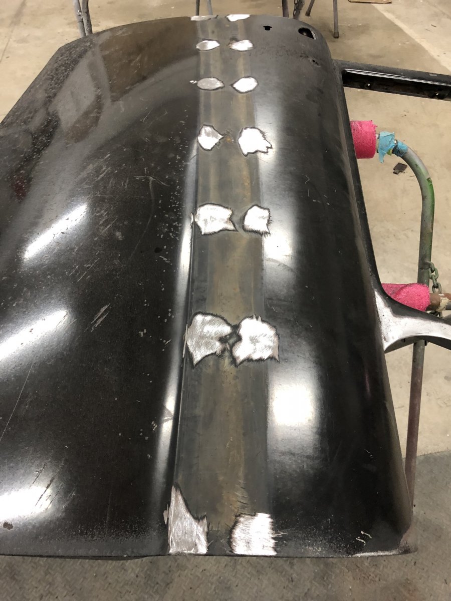

    Small update....
    These are older pics.. doors are already in primer,ready for paint.. but the 300 custom holes are all welded up here... they are in good shape.... just a bit of 60 year grudge...
    One thing i did notice.. maybe you all know the answer. the regulator holes on the p***. and drivers side are different.... I just noticed at at the time.

    I used an Edsel door for the driver-side door guts on my '59 Custom 300 and parts from an unknown '59 on the p***enger-side. The handle release rod was different on the Edsel door, the regulators themselves should be the same from '57 to '59.
