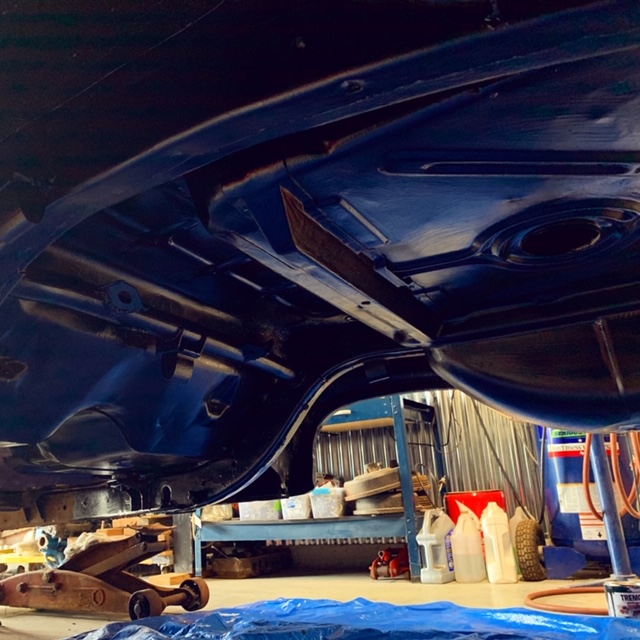

    Well.. summer is over and not much work has progressed.... too busy having fun with my coupe and truck.But we are now back on it.....
    All the sheetmetal is near completed and very close to wiring the car......Dash is painted and in.... Gone way overboard as I initially wanted too.. but... there was a ton of hidden rot that needed to be addressed.
    EVERY damn piece of sheet metal has been addressed.

  11. 57JoeFoMoPar
    Joined: Sep 14, 2004
    Posts: 6,503
    57JoeFoMoPar
    Do it now or do it later. You'll also be much happier with the car done the right way rather than cobbled together from cutting corners. Looking great man, this is a KILLER build.

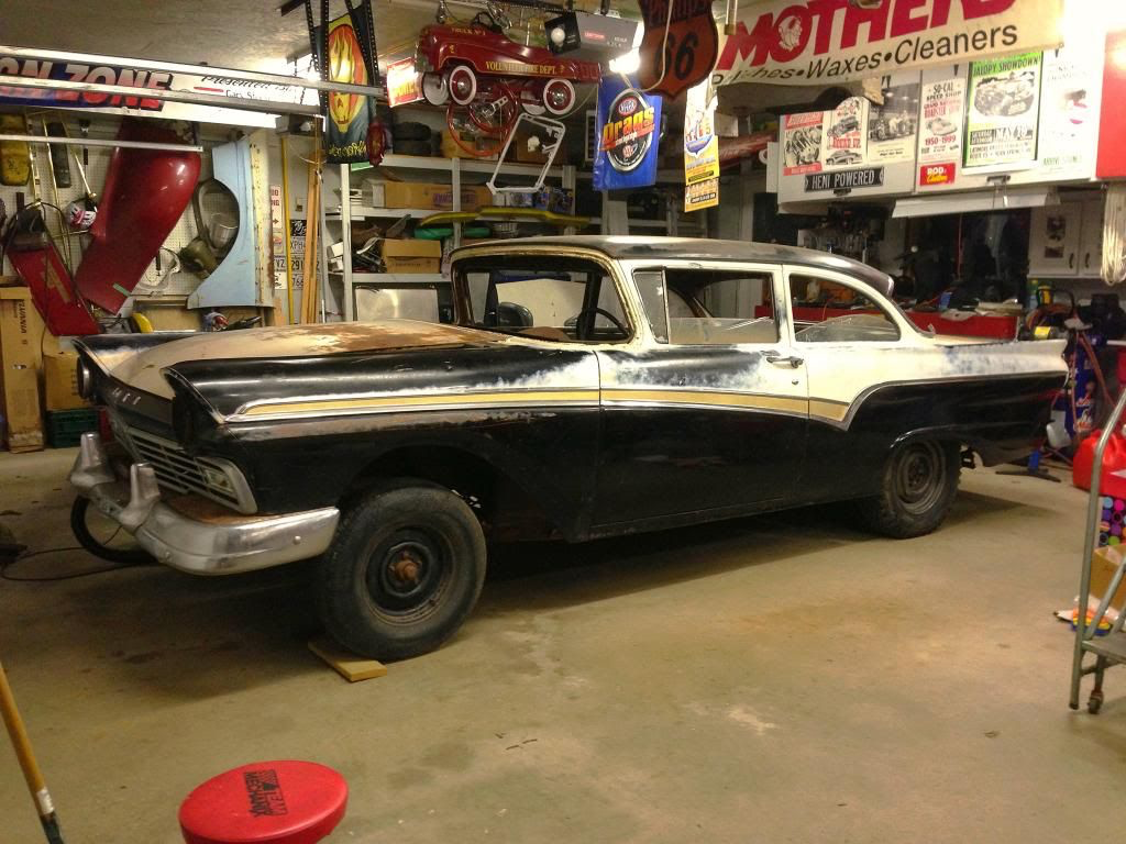

    Well.... the original post was about the 57 I brought home from the Panhandle.... and its been languishing in the corner for a while.

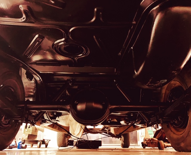

    After a long time thinking....I am leaving this car alone.(body wise)I have begun to replace,fix,repair the rolling ch***is..... gonna go with another FE..... I have all the parts I need.....So.. in the last month I began.... pulled the rear and rebuilt it....
    Bearings,seals...brakes ,etc ,etc.....New HD shocks, New HD spring pack,new insulators and hangers with all rubber replaced.
    This car came home with enough red dirt from the panhandle to fill a sandbox.
    I call this car the "Texas Sunburn".... the sheet metal is extremely good.. a little rot here and there but 90% sunburnt.

    I replaced the One Wheel Peel with a full posi Chunk... 3.50 gear..... the factory was a 3.00.... Not sure of the trans yet... but I'm leaning to a C-6 ...(I have most of what I need for that.)
    I'm swapping out the steering for a 58 or 59 unit.... gotta make a decision on front springs.. Moog aerostar or Stockers.....Need to replace all bushings.. which I have A full NOS kit.

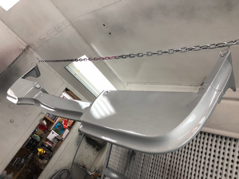

    Well.. got a nice surprise from my Pal Tom the Painter....(now back on the Dirty Bird)
    He has painted the front Gravel pan....
    Awesome.

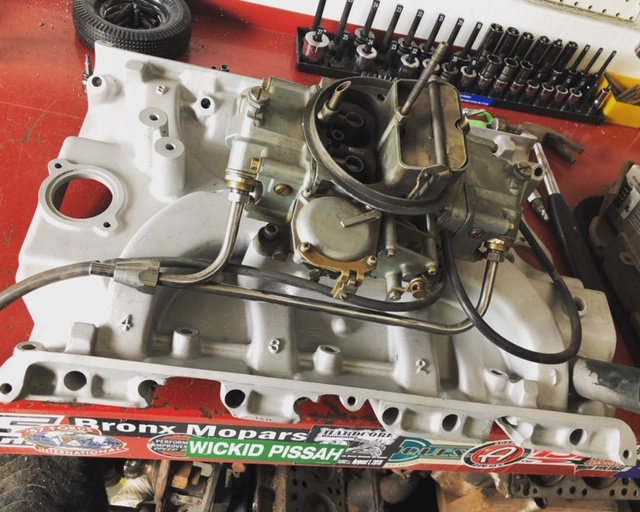

  27. rob-redm
    Joined: Nov 15, 2005
    Posts: 6,557
    rob-redm
    sleeper with dual quad 427 FE would be killer.. I borrowed this picture.. Ford_FE_engine.jpg

  28. Stogy
    Joined: Feb 10, 2007
    Posts: 27,207
    Stogy
    :rolleyes:...:D...I was wondering about the Support for the Manifold thinking it was a Pizza Box and thought Pizza's going wild...heck even for Car Parts having that is interesting packaging...
