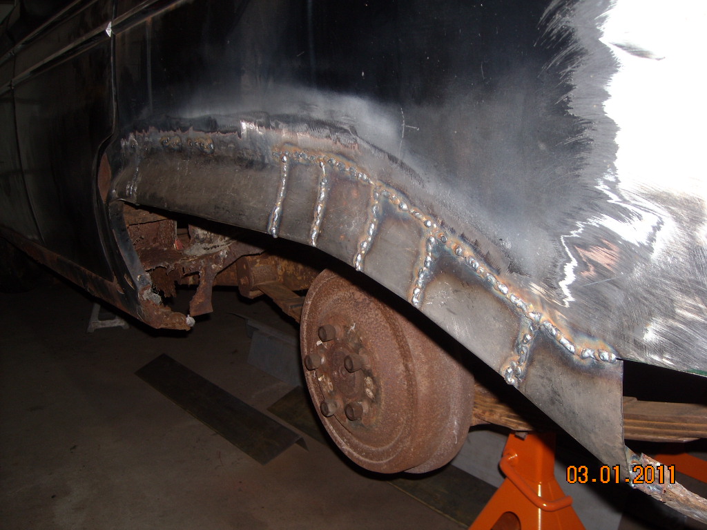

    Copy of DSCN2652.JPG I decided to repair the drivers rear wheel well lip that was rusty, since I had the inner panel cut out, so it would be easier to form.

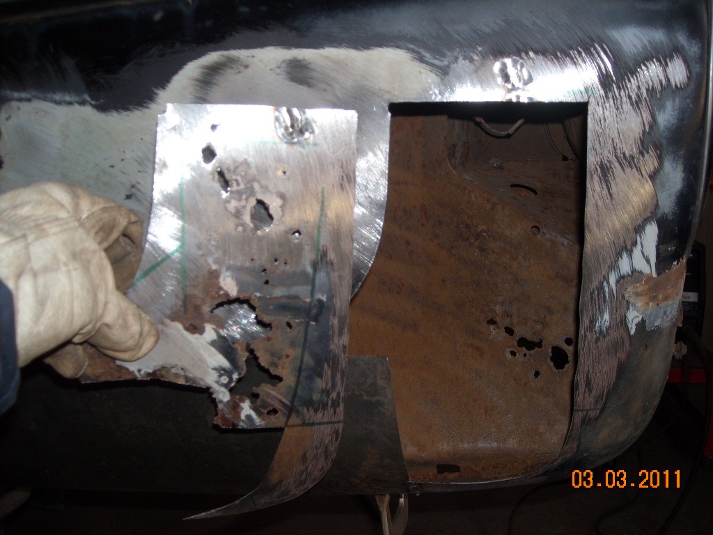

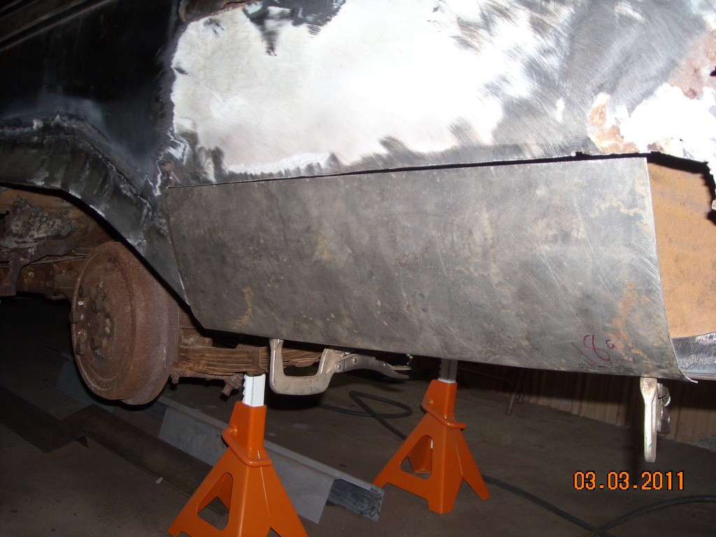

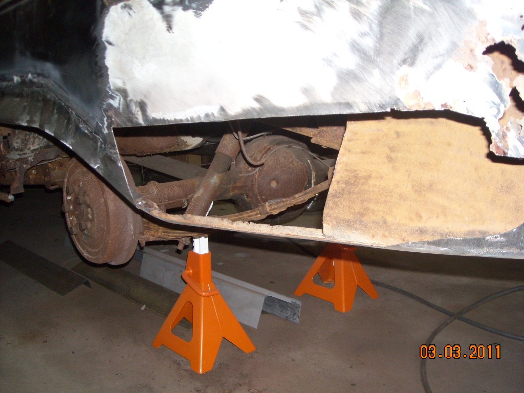

    Copy of DSCN2651.JPG This is the area behind rear wheel.
    Copy of DSCN2654.JPG I cut out the bad stuff.

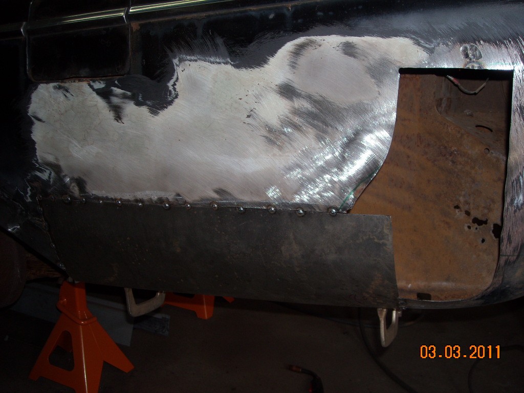

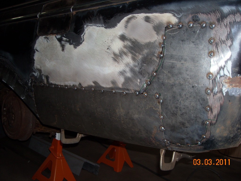

    Copy of DSCN2655.JPG The new panel being fit up.
    Copy of DSCN2658.JPG New panel tacked in.

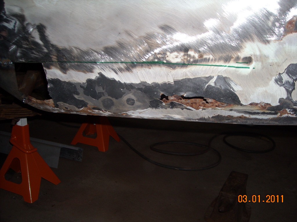

    Copy of DSCN2656.JPG THis area was also rusted. It went a little higher in the panel.
    Copy of DSCN2659.JPG Here is the whole area tacked in. I impressed myself with this one.:D

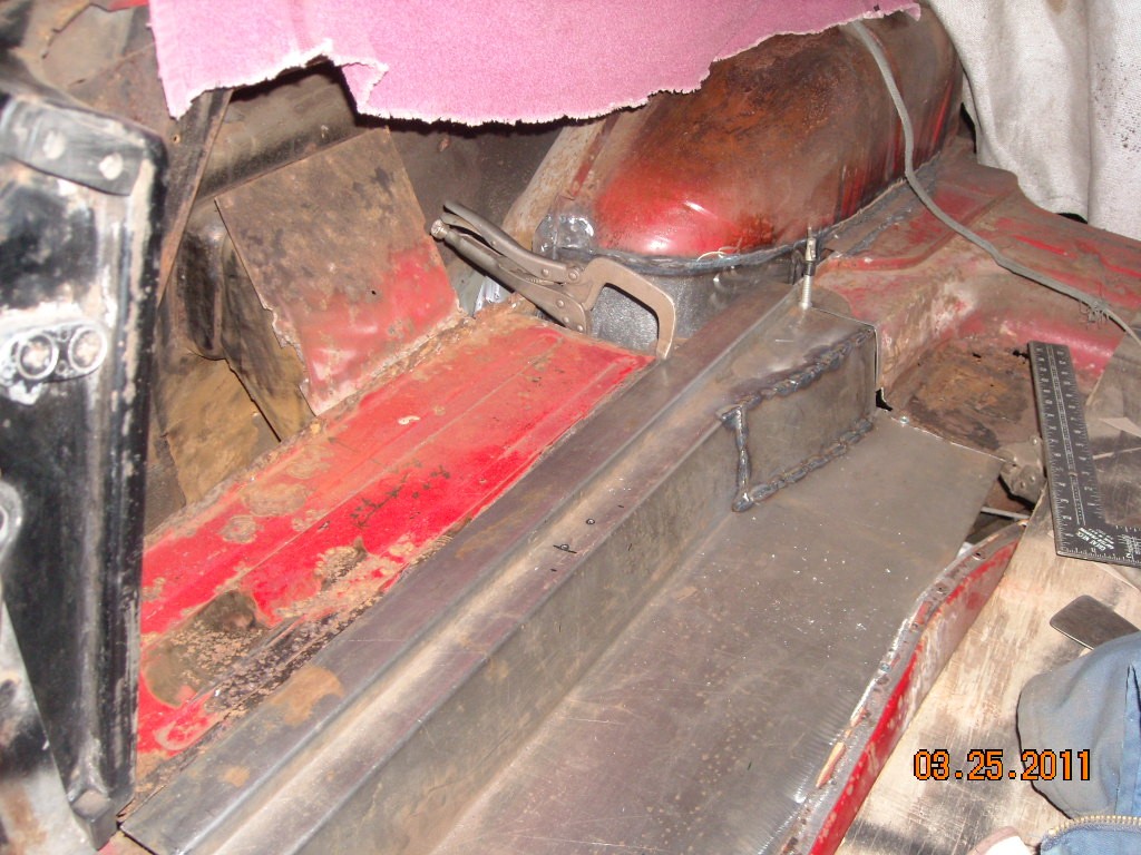

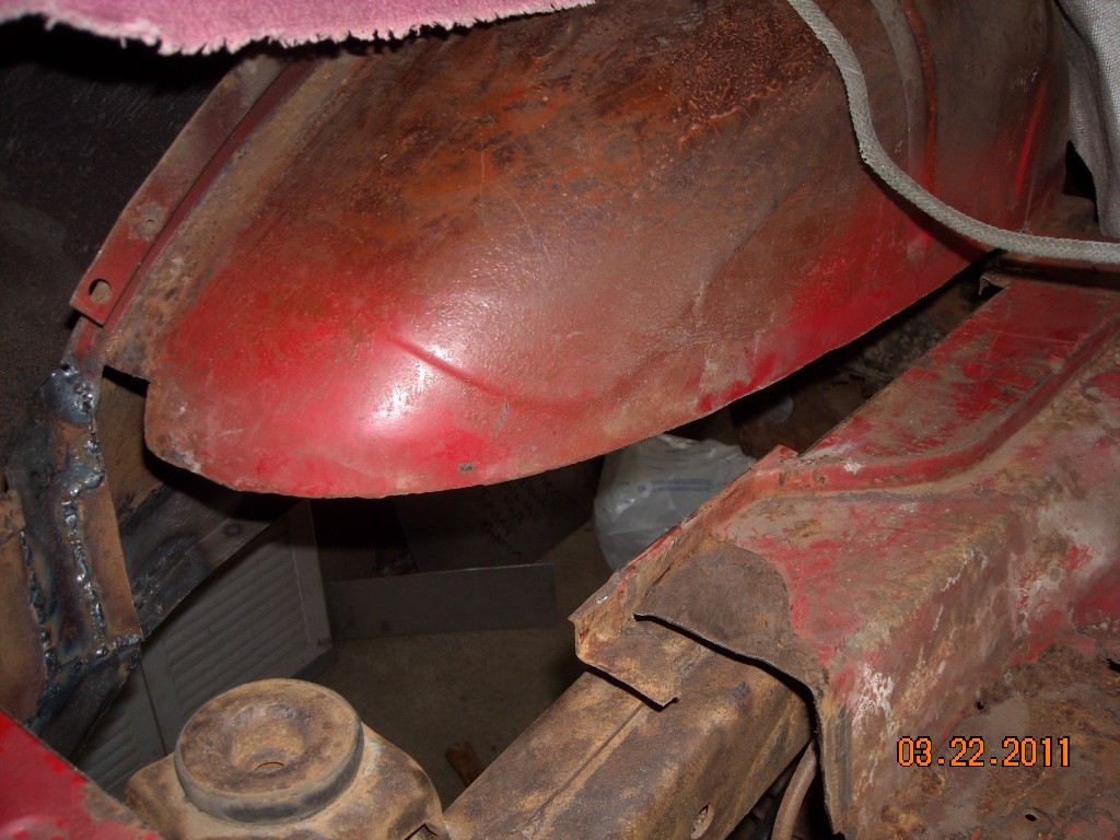

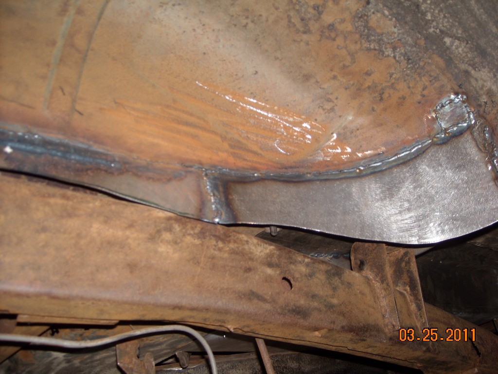

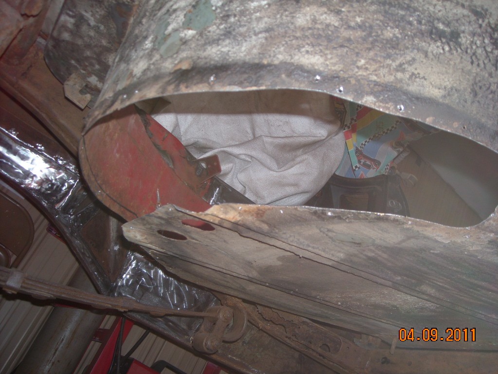

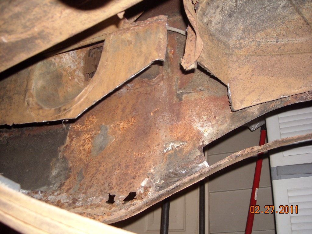

    no.1.this is the rust area cut out around the LR wheelwell.

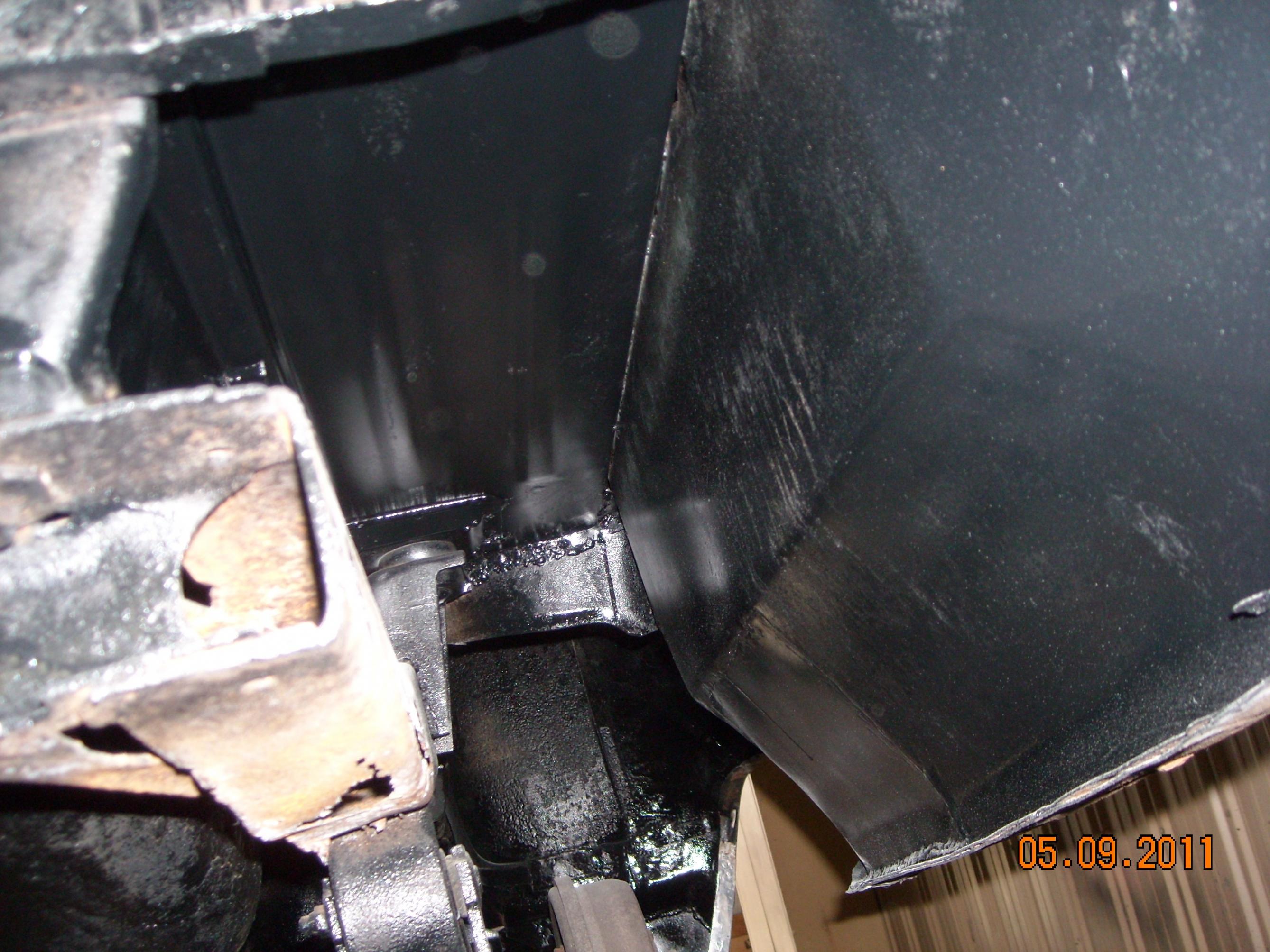

    no.2.Here is the inner fender well with new metal welded in, from the inside.
    no.3.The 3rd picture is the rear floor area in its early stages getting fit up.

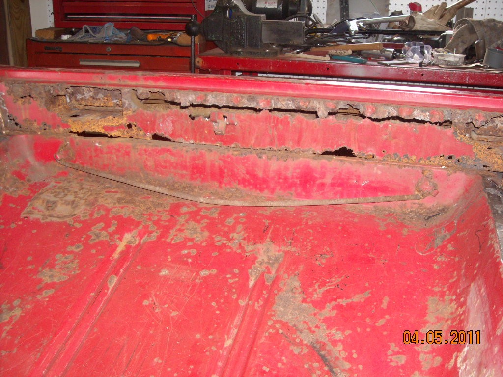

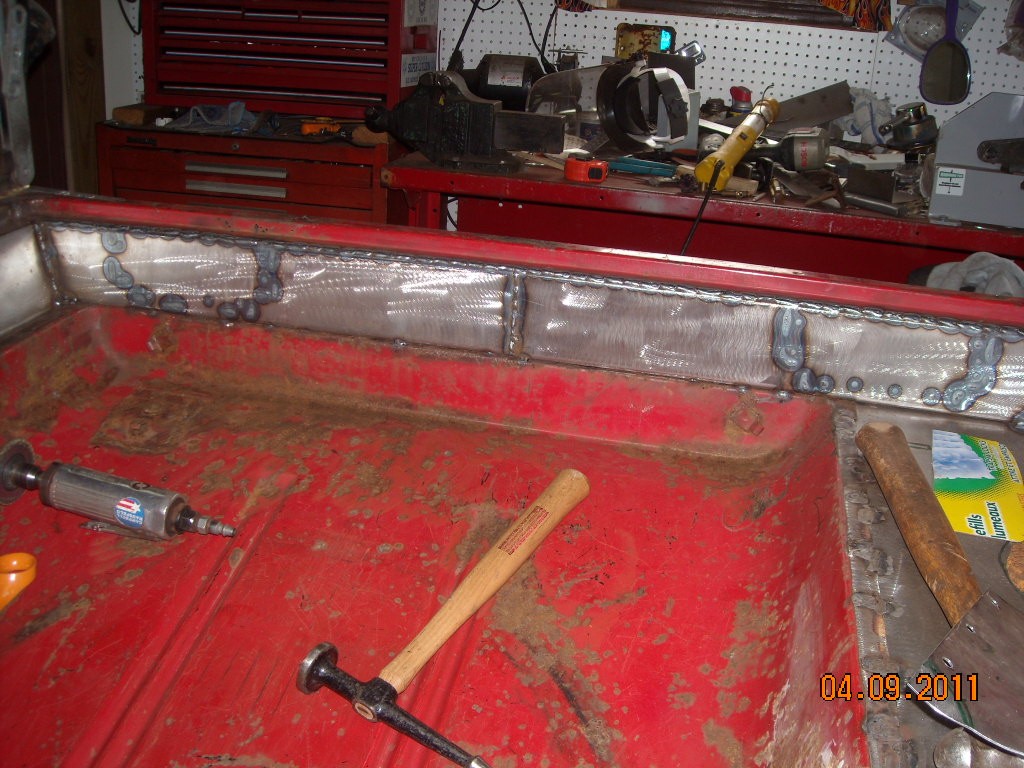

    Here is the next area of attack. Its the inside panel in front of the tailgate.
    This is the same area with the rust cut out.
    Here is the new metal welded in. I havent ground down the welds yet in this photo.

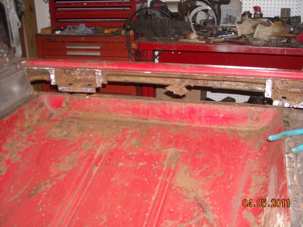

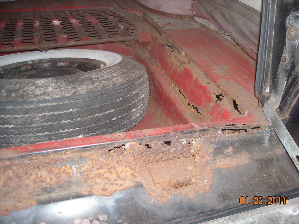

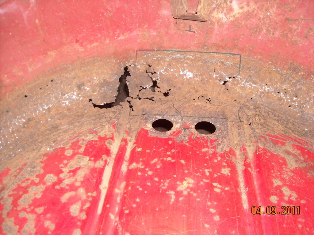

    This is the spare tire well. In an earlier post I said this area was in good shape.:eek: As you can see, after cleaning it up I found yet another rust hole that needs fixed. Cool, lets get cutting and welding!!!

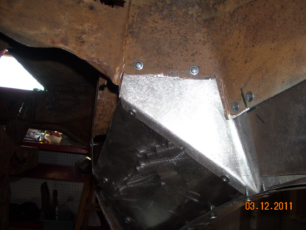

    Its cut out!

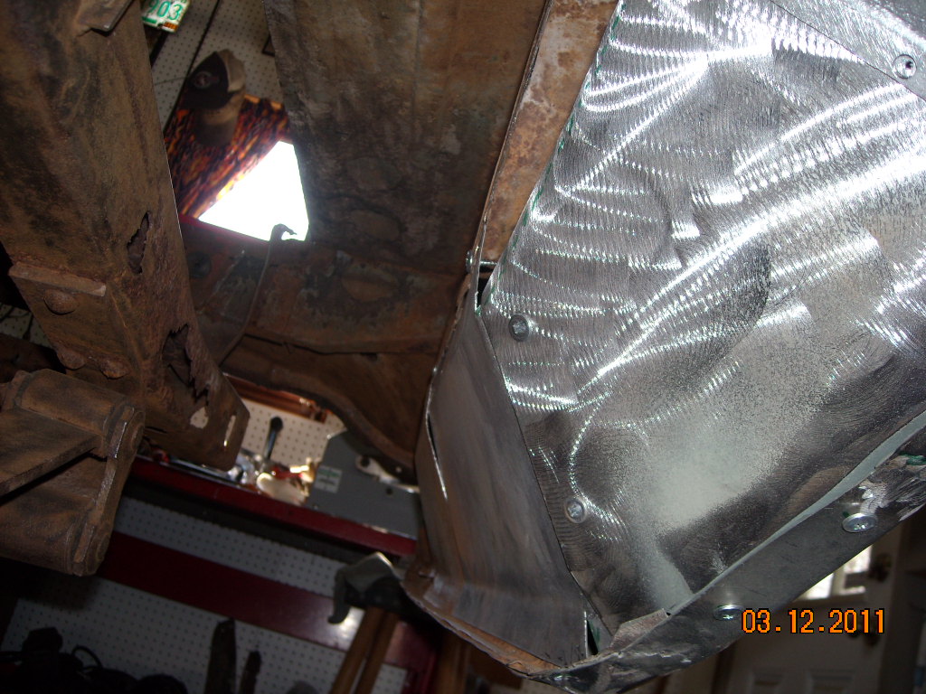

    Here is a view from the bottom side.

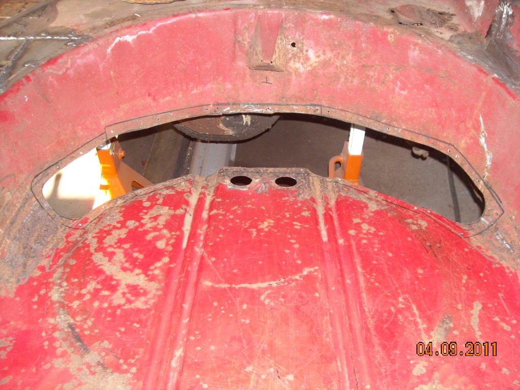

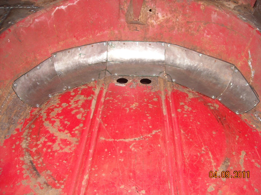

    Here is the patch panels screwed in waiting for welding.
    I am overlaping the panels for strength since it will be under the spare tire and it needs to be strong.
    All I have is a sandbag and round plastic mallet so I built it in sections and had to slice some areas to get the form I needed.

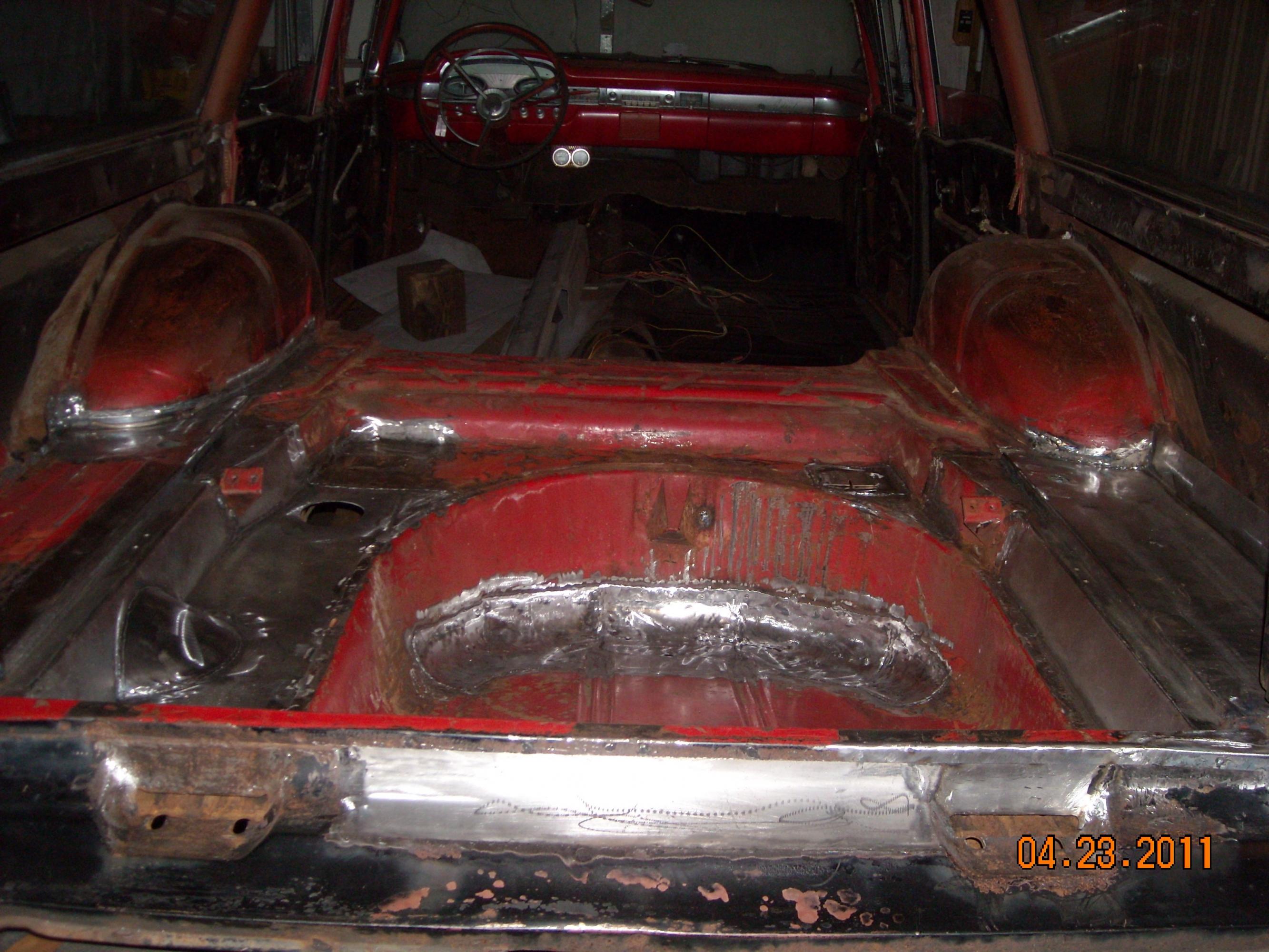

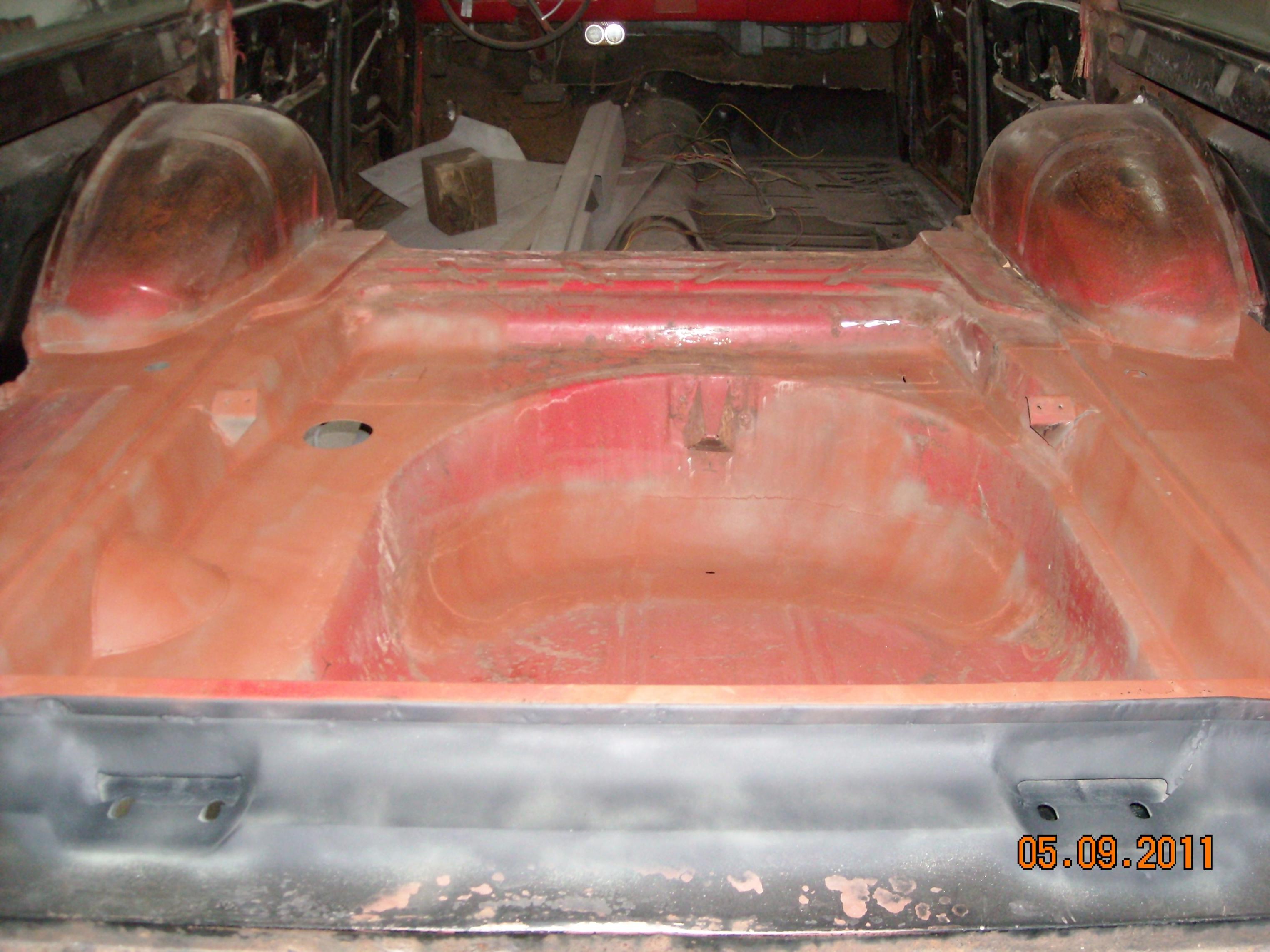

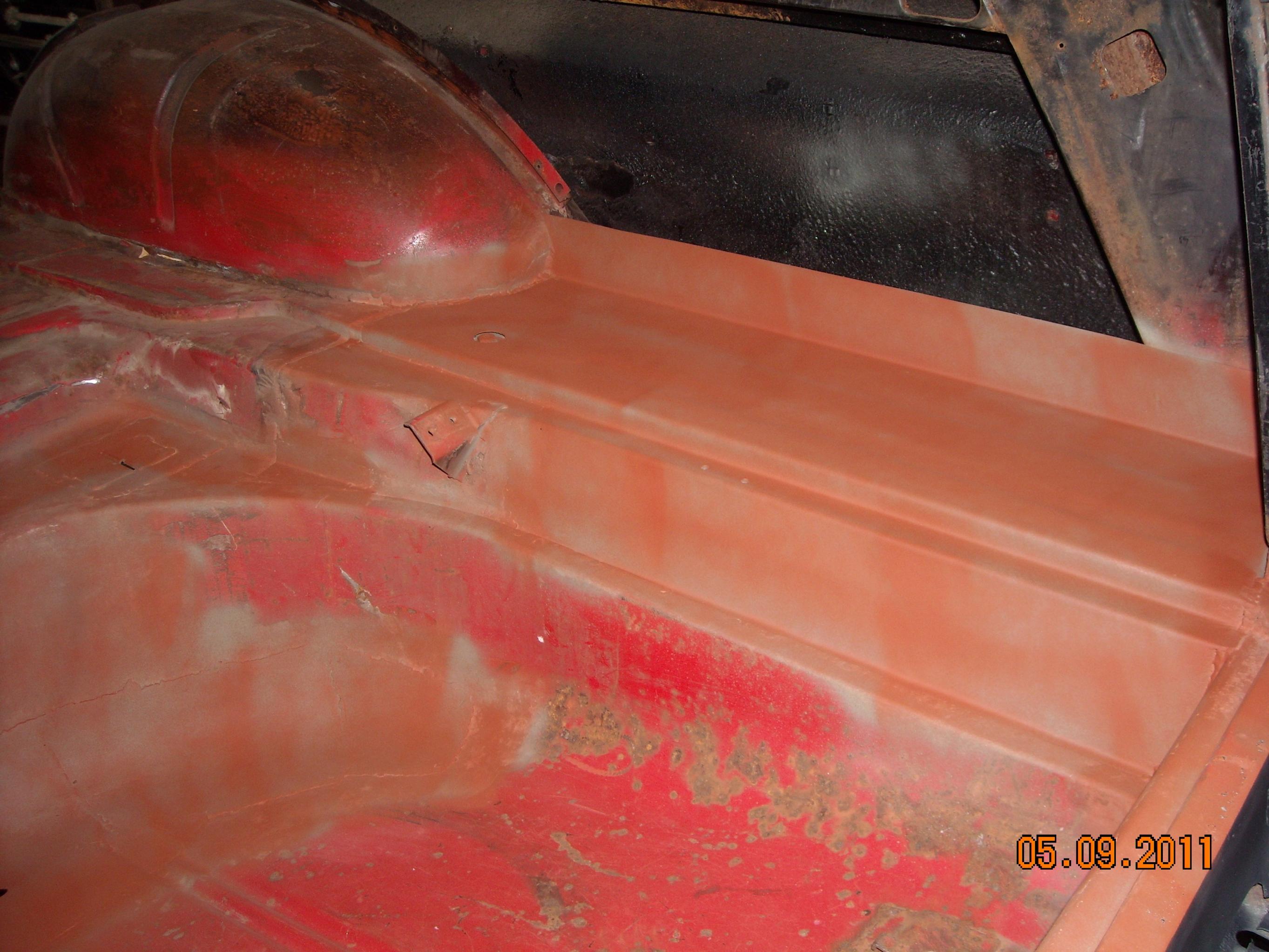

    Its been slow going but here is the latest.

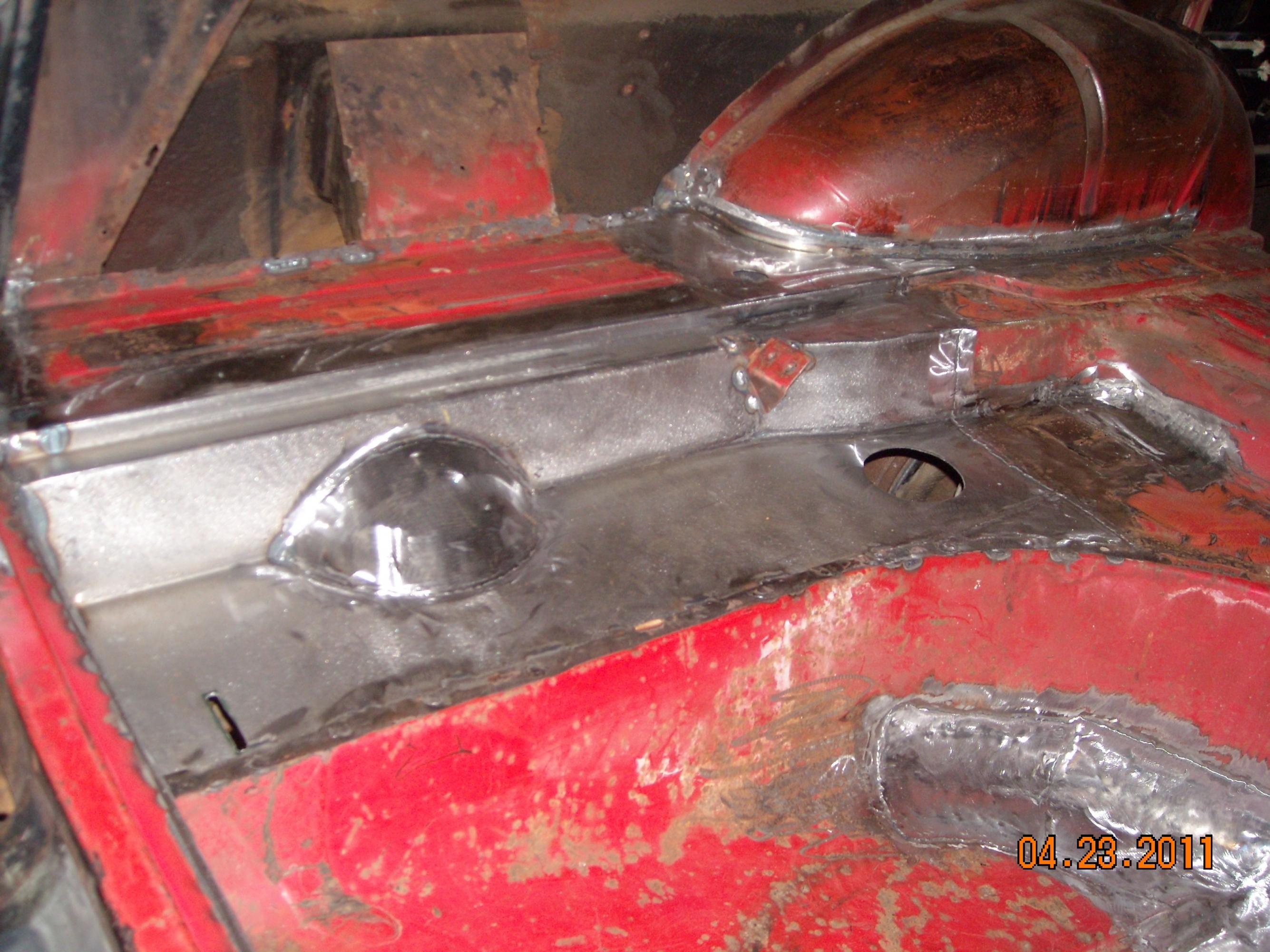

    Here are some shots of the inside rear with all the metal welded in.

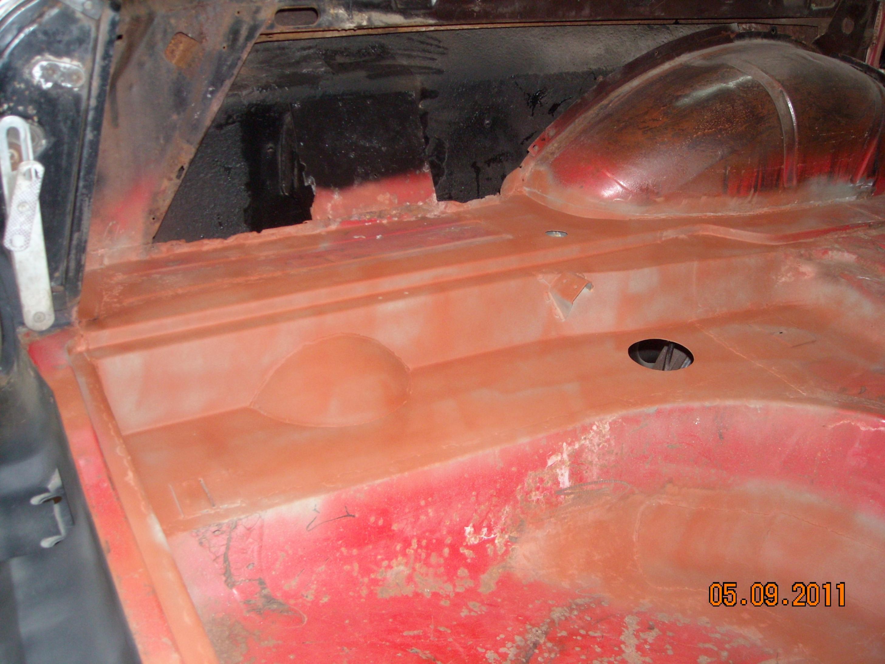

    This is the same area primered up so it doesnt rust up.

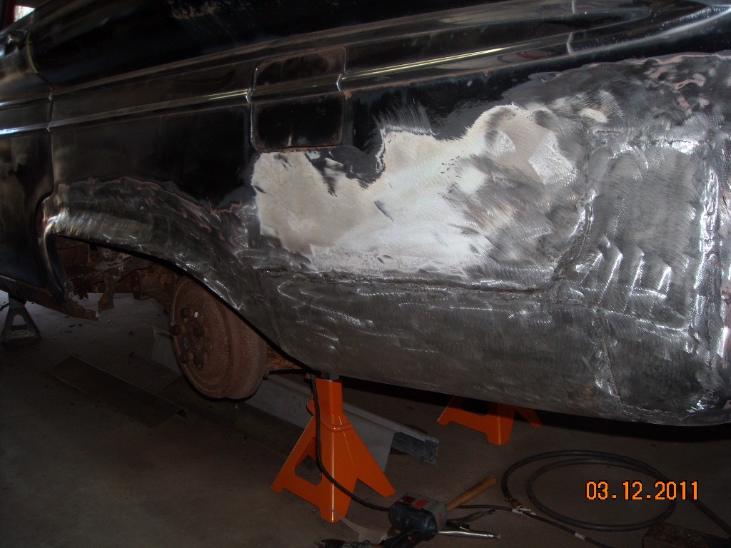

    This is the rear wheelwell painted and finished.

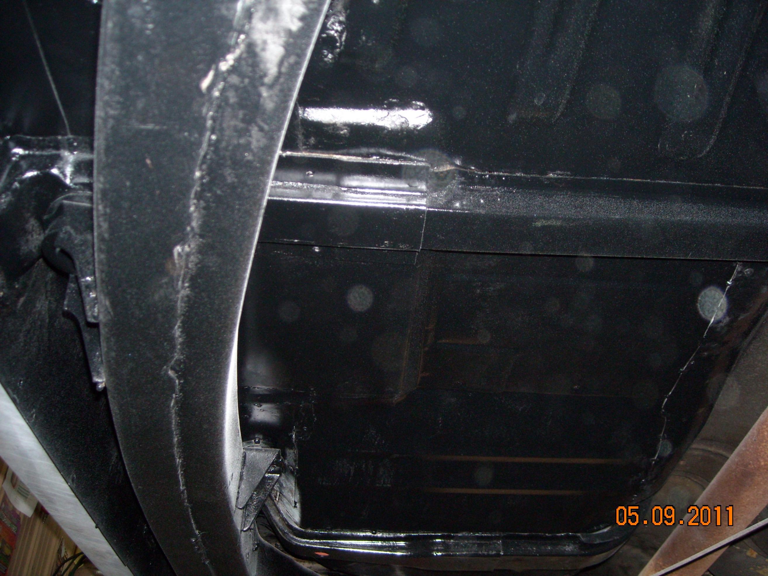

    This is the underside of the p***enger side floor.

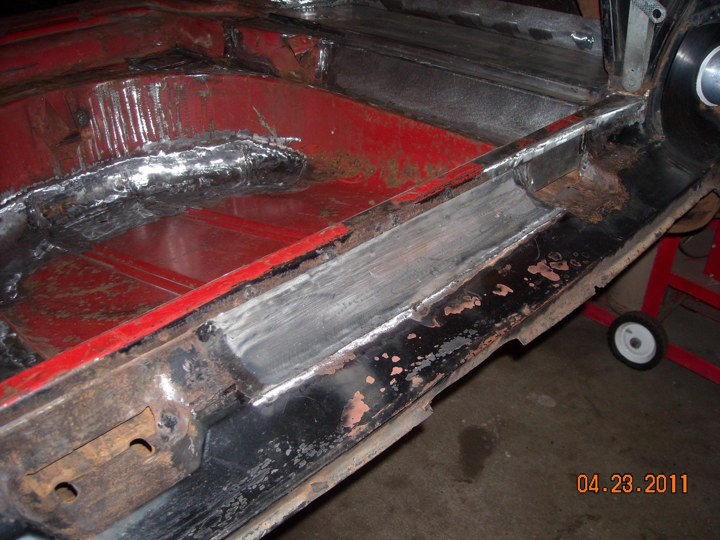

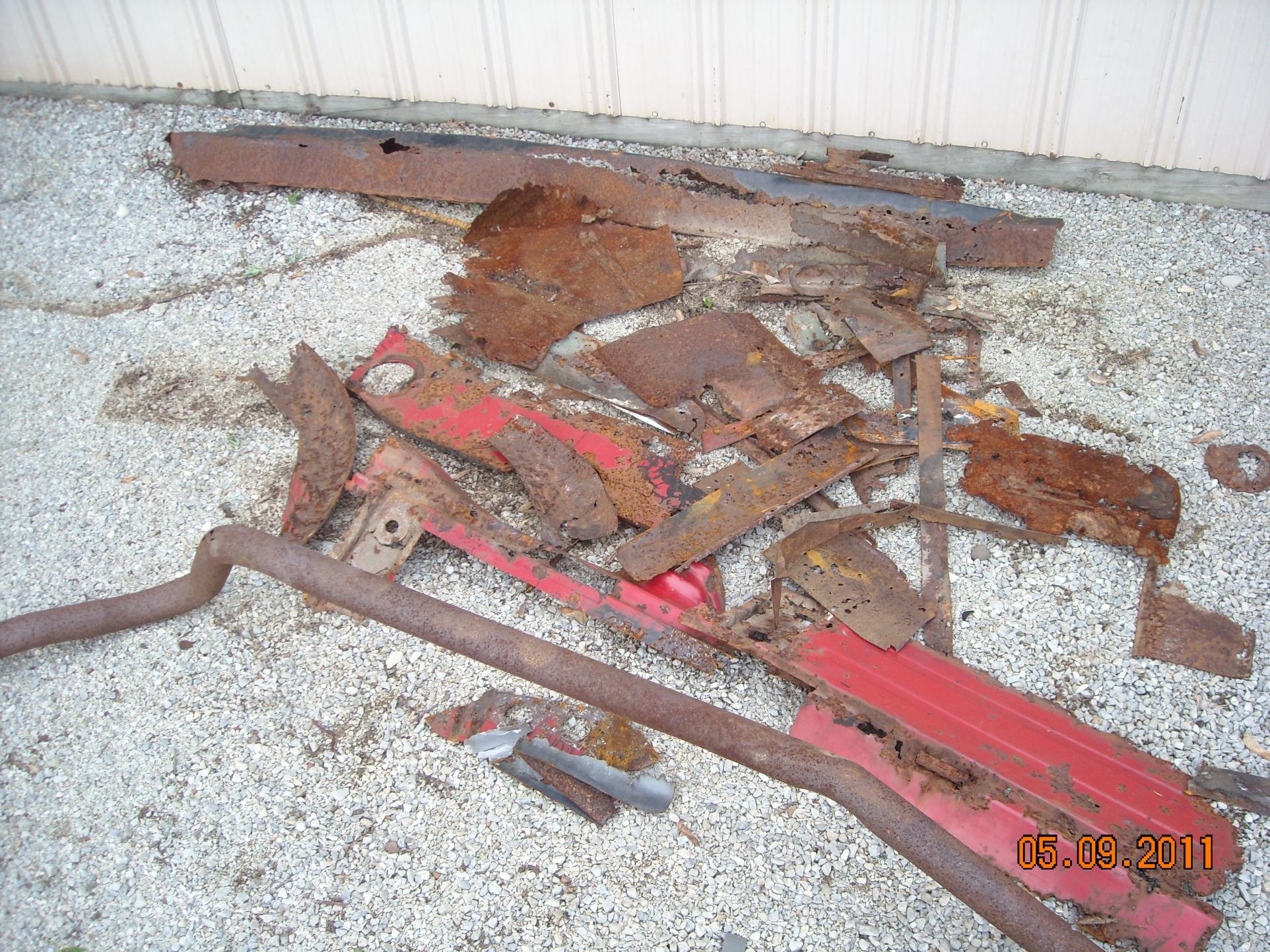

    This is my last post on my Edsel build until later this fall.
    I moved it behind the garage for now. I need the garage space for my 39. I am sooo ready to hit the road in my 39 ford.
    Its been a long winter cutting and welding on the old edsel, but I am making progress. I need to let it set for a few months and get caught up around the house, and do some cruising in my "driver" hot rods.
    The Edsel has been setting since last fall, but a little gas in the carb and a fuel line stuck in an oil bottle full of gas, and it pulled itself around back.
    The last picture is all the big chunks of what I have cut out of the car this winter. I still have to tackle the drivers side floor and rocker.
