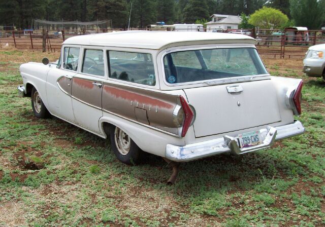

    One of my 2 Edsel Wagons.
    I had a 3rd, a 58 Roundup 2 door wagon, but sold it to someone who could do it justice.
    As found:
    Cleaned up:
    Next: 100% straight and rust free but needs engine:
    Sold, and getting a full restoration:

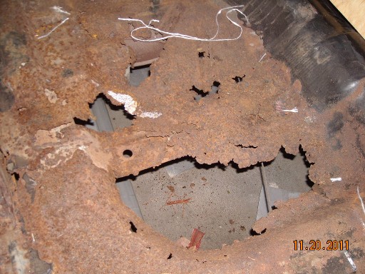

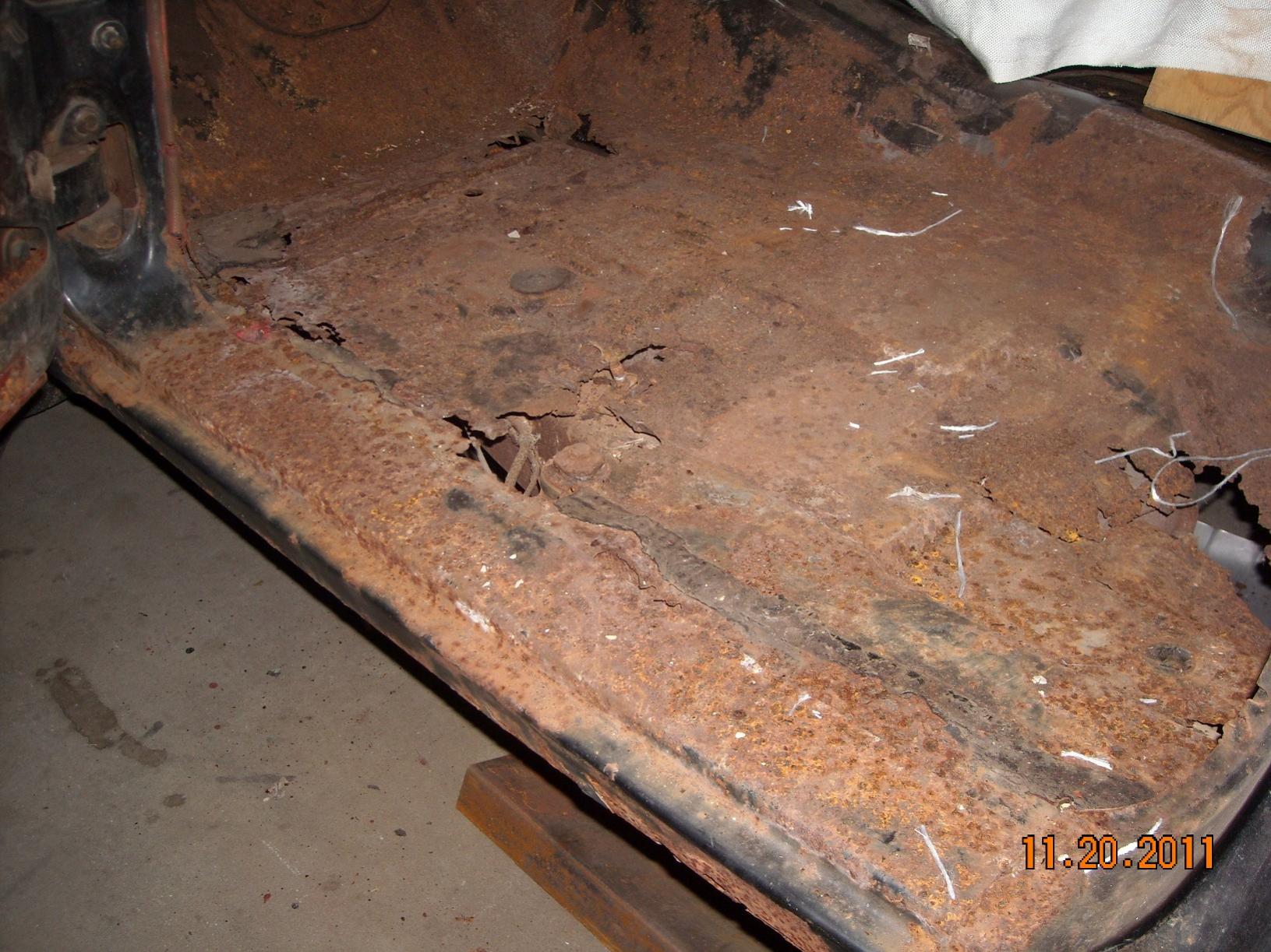

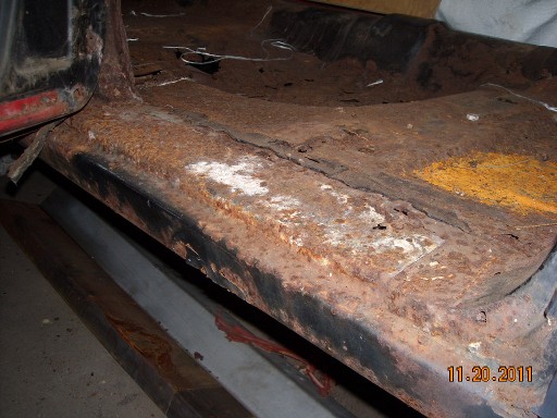

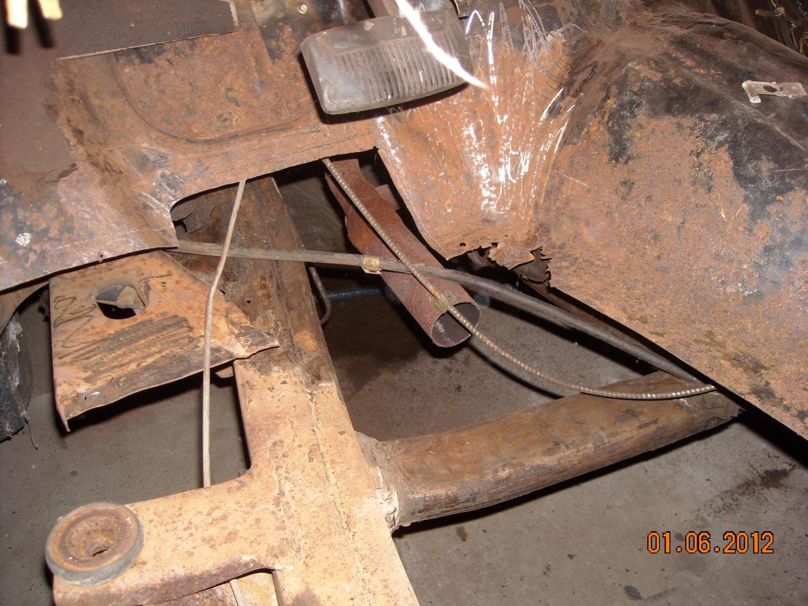

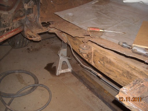

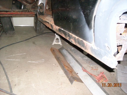

    This time I am doing the drivers floor and rockers.
    Here is what I have to work with. I post these pictures to give other people with rust buckets:eek: hope. Its a lot of work but I will get all this fixed. It may not be a real professional job, but it will be good enough for me.:)

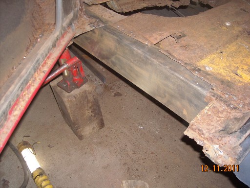

    This is the drivers rocker. Its actually a skin that someone screwed on to "fix" them before:eek:
    Here are the early stages of cutting out rust.

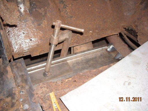

    This is where im having to build a frame to body floor support, or something like that.:rolleyes:
    I just keep cutting a little at a time and found a part of the toe board needs patched.
    This is the point to where there isnt much structure left and I am thinking,"OH ****".:confused:

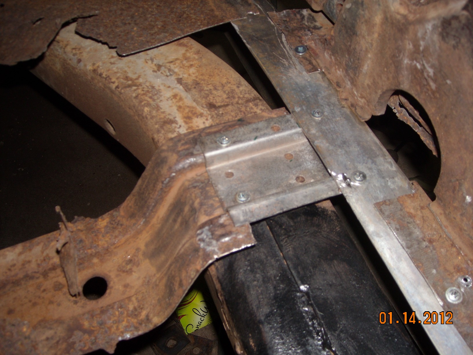

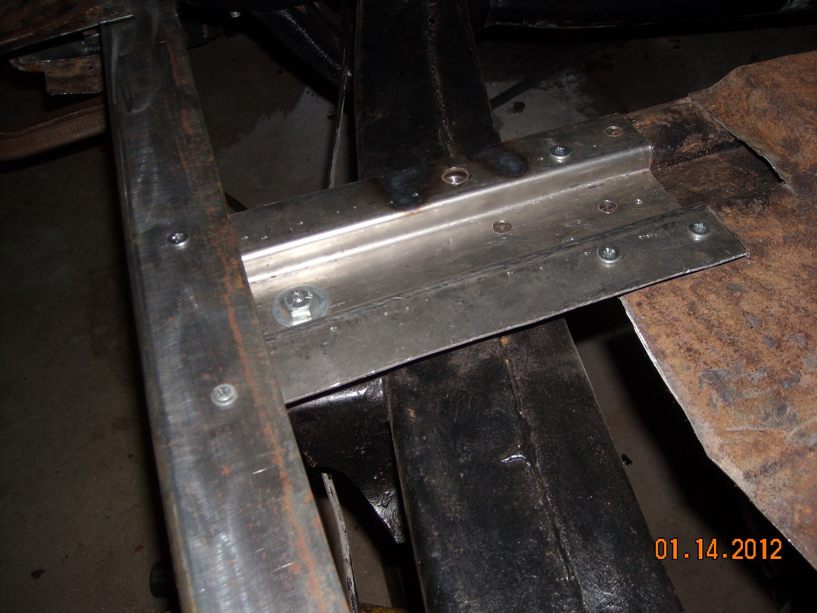

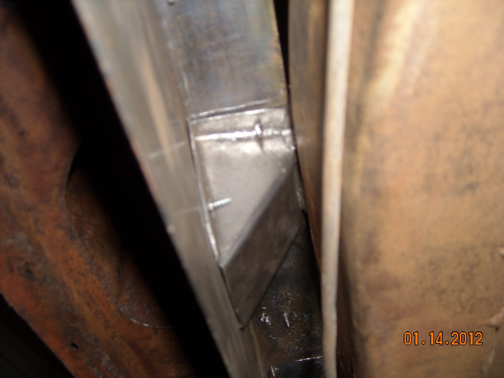

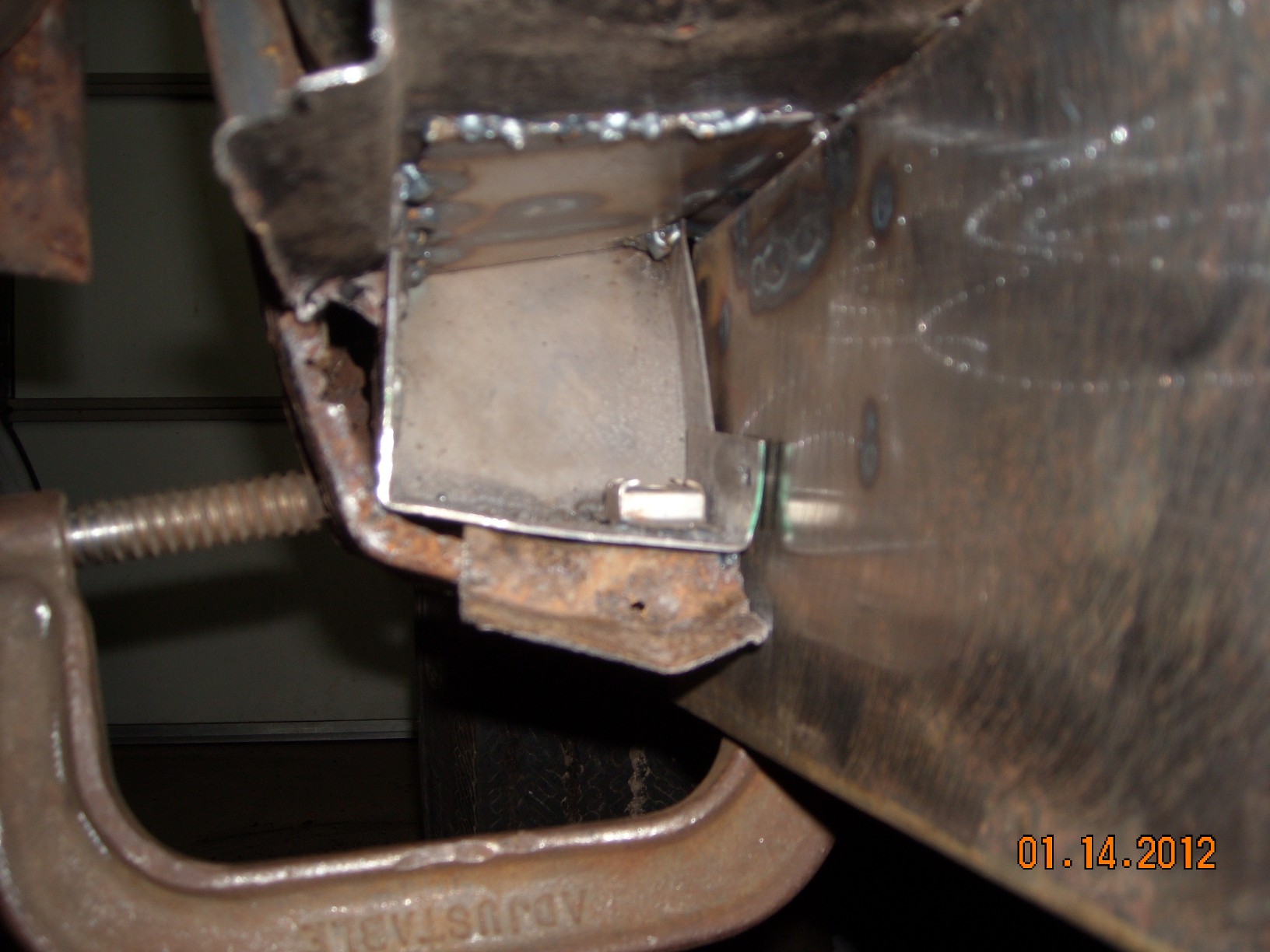

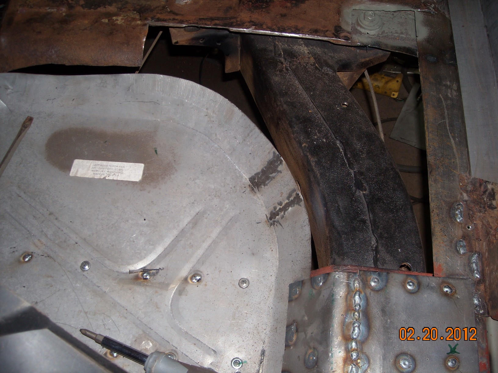

    Here are some shots of the structure around the A pillar. So far everything is held with sheet metal screws until everything is lined up. very little welding at this point.
    I have worked all day, and some previous days, trying to get the doors to line up. But I believe I have it.:D
    This is the floor brace between A and B pillar.
    And this is the B pillar floor brace. you can see where I need to rebuild the bracing on the outside lower of the B pillar.

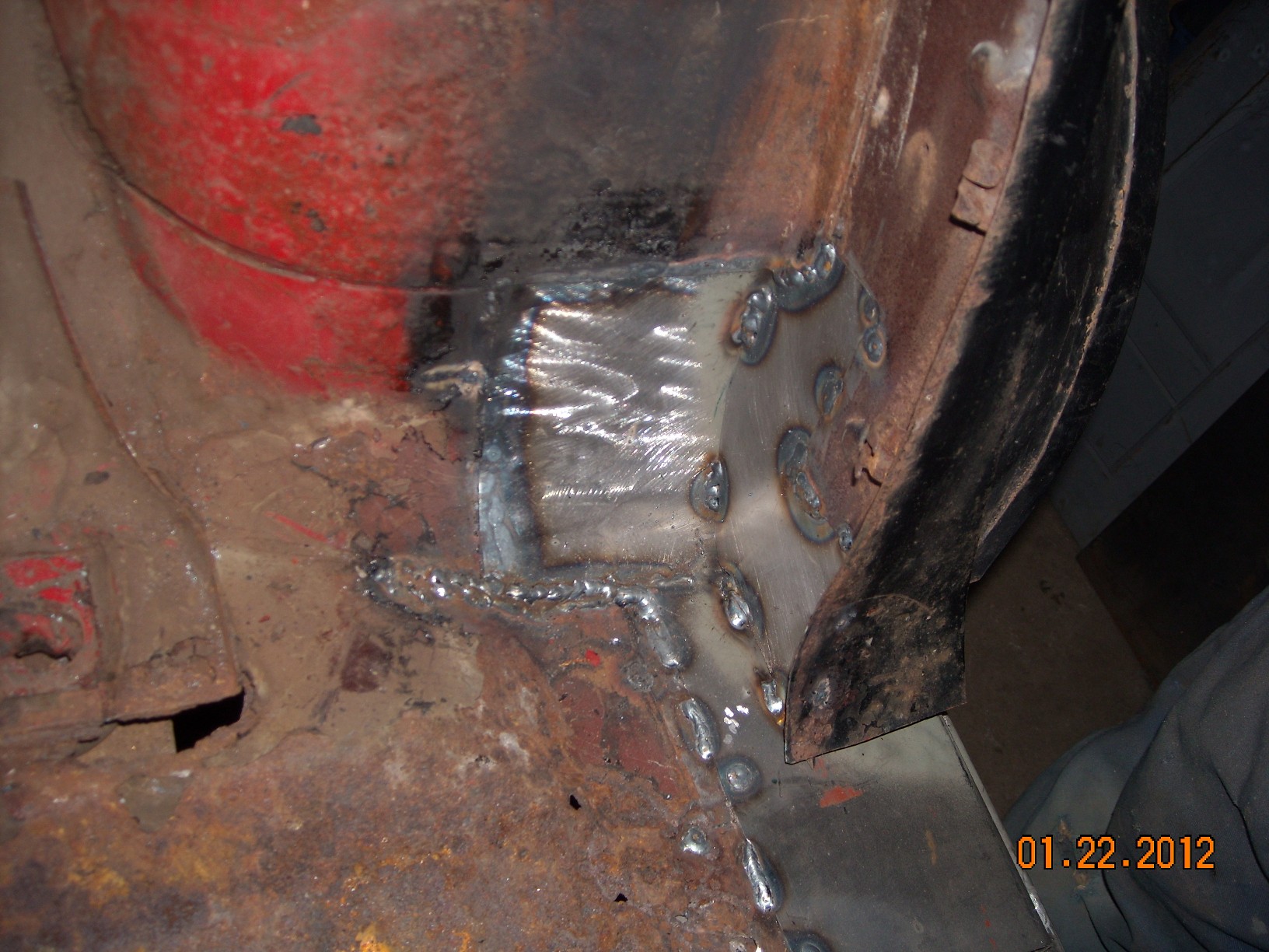

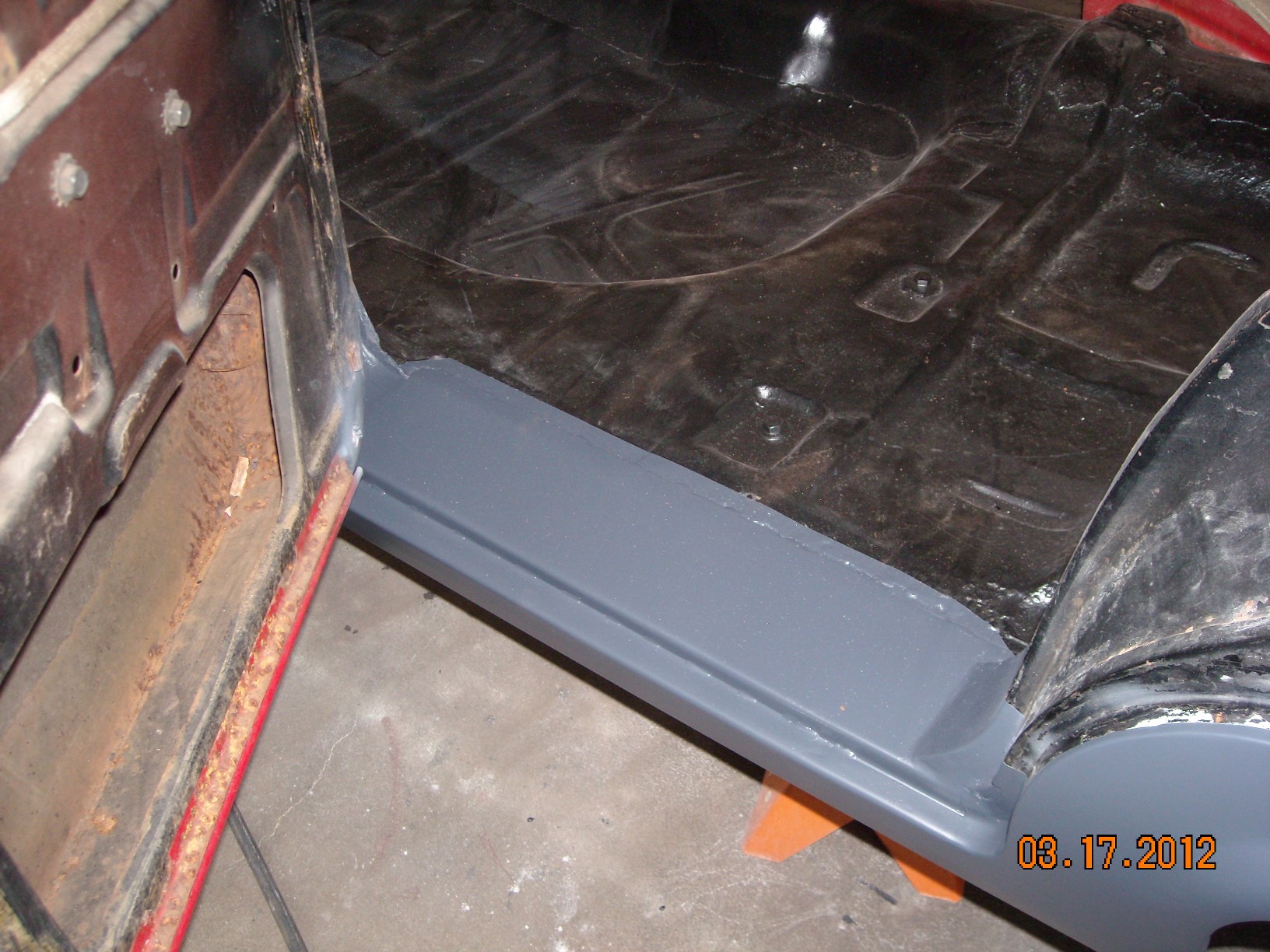

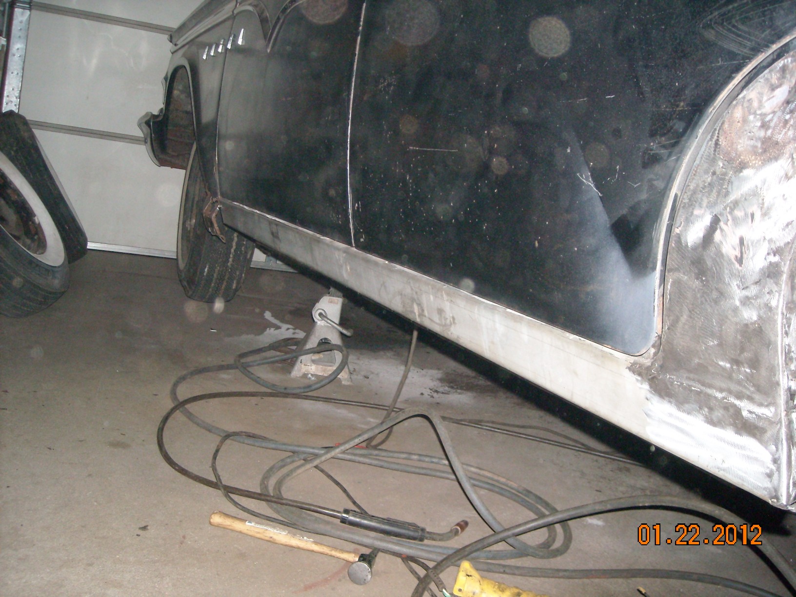

    I got to spend a lot of time in the garage this weekend.

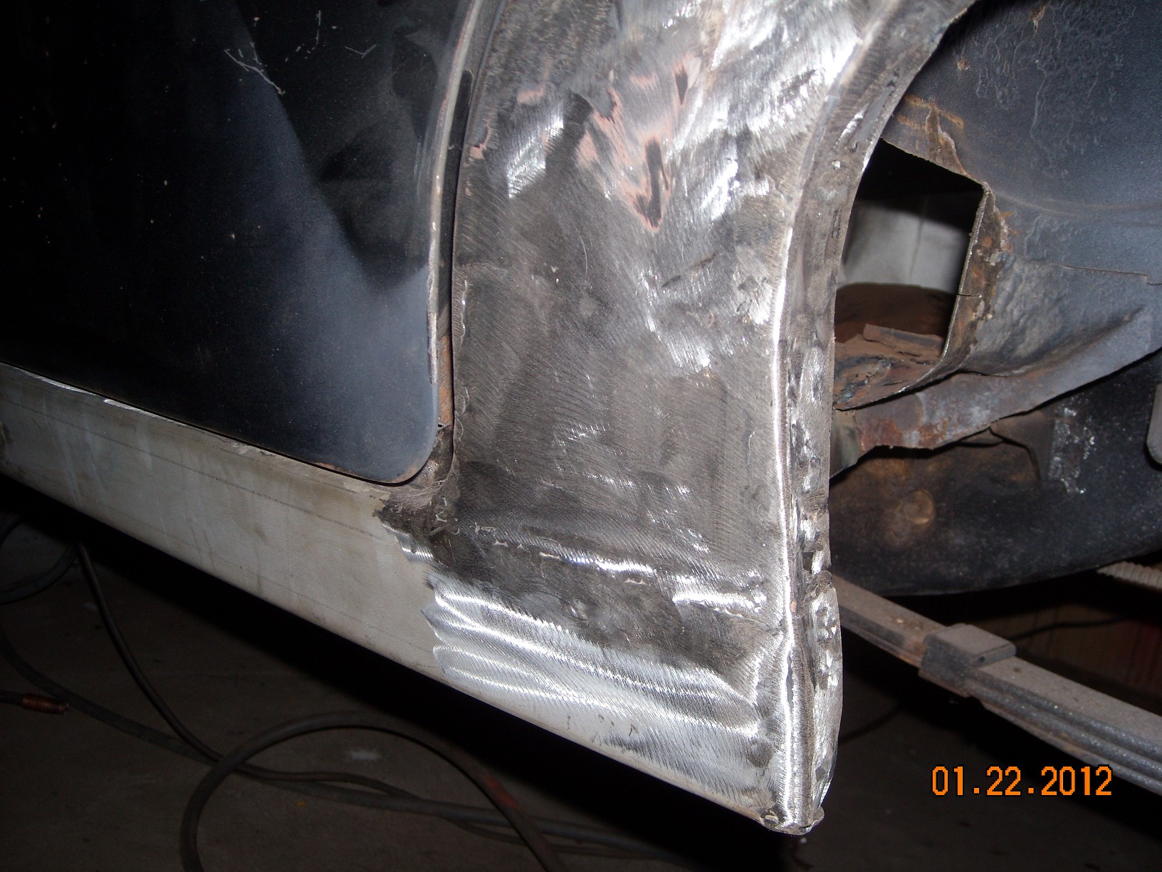

    I got the drivers rocker panel welded in.:D:D
    Had to repair the area in front of the LR wheel.

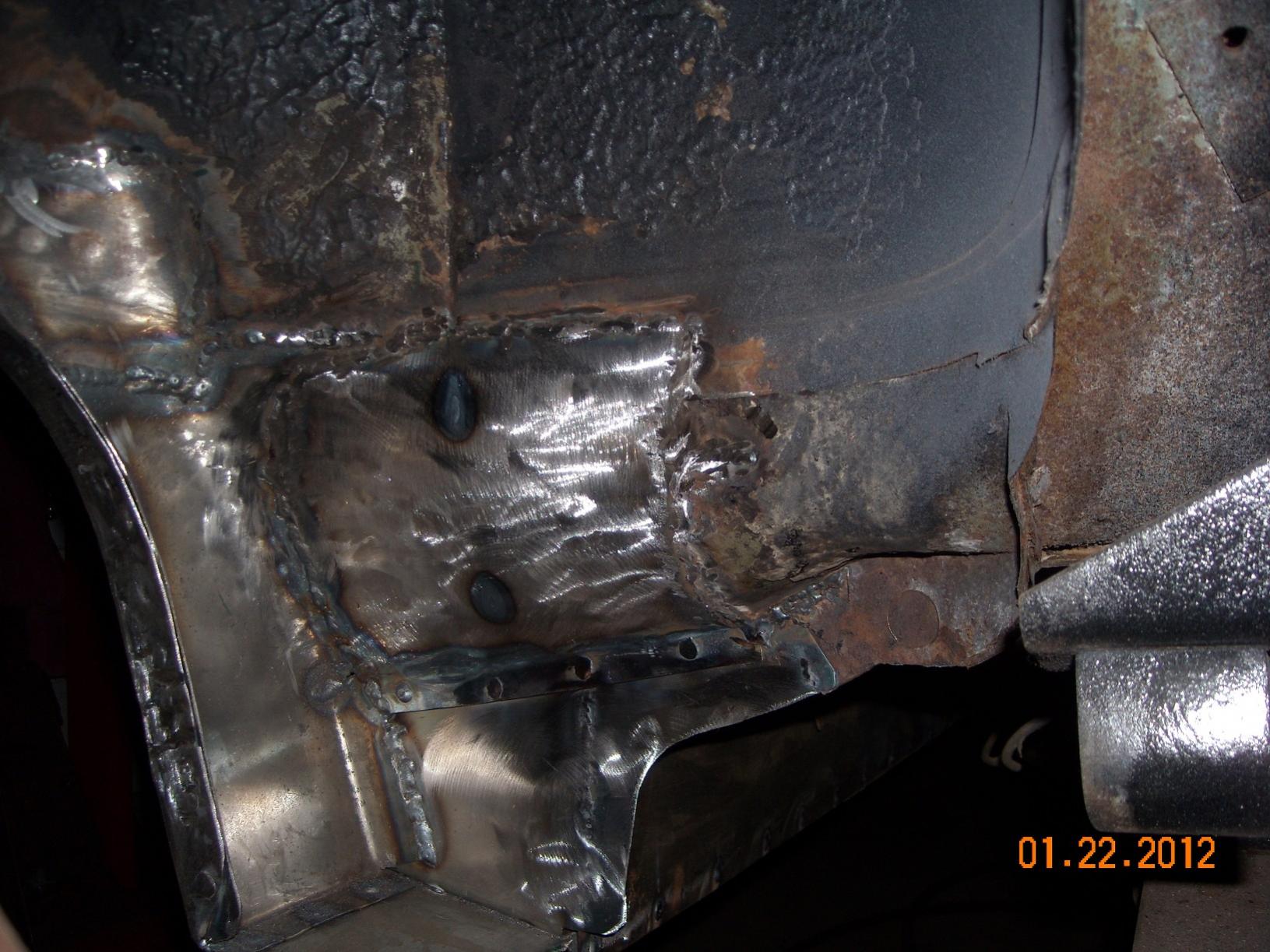

    A view from inside the wheelwell.

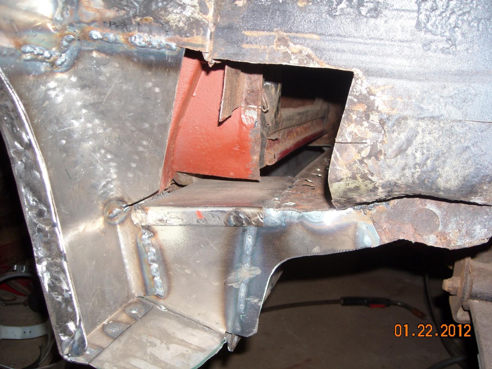

    and a view from inside the car.

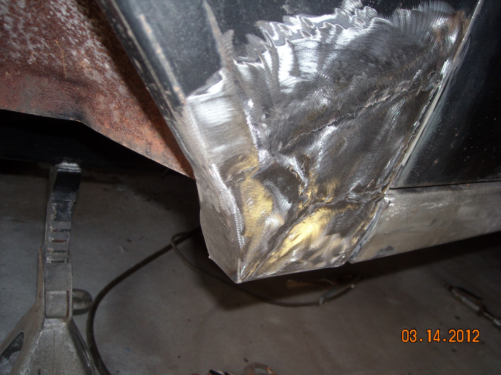

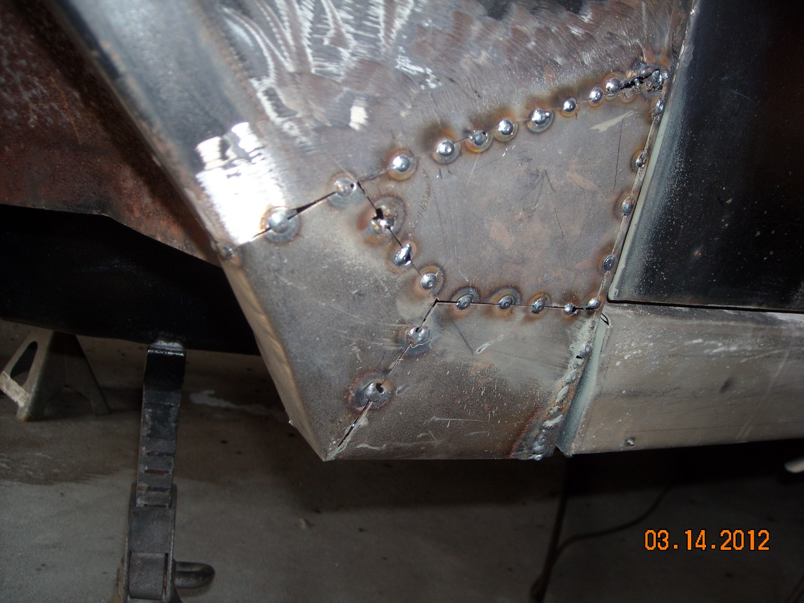

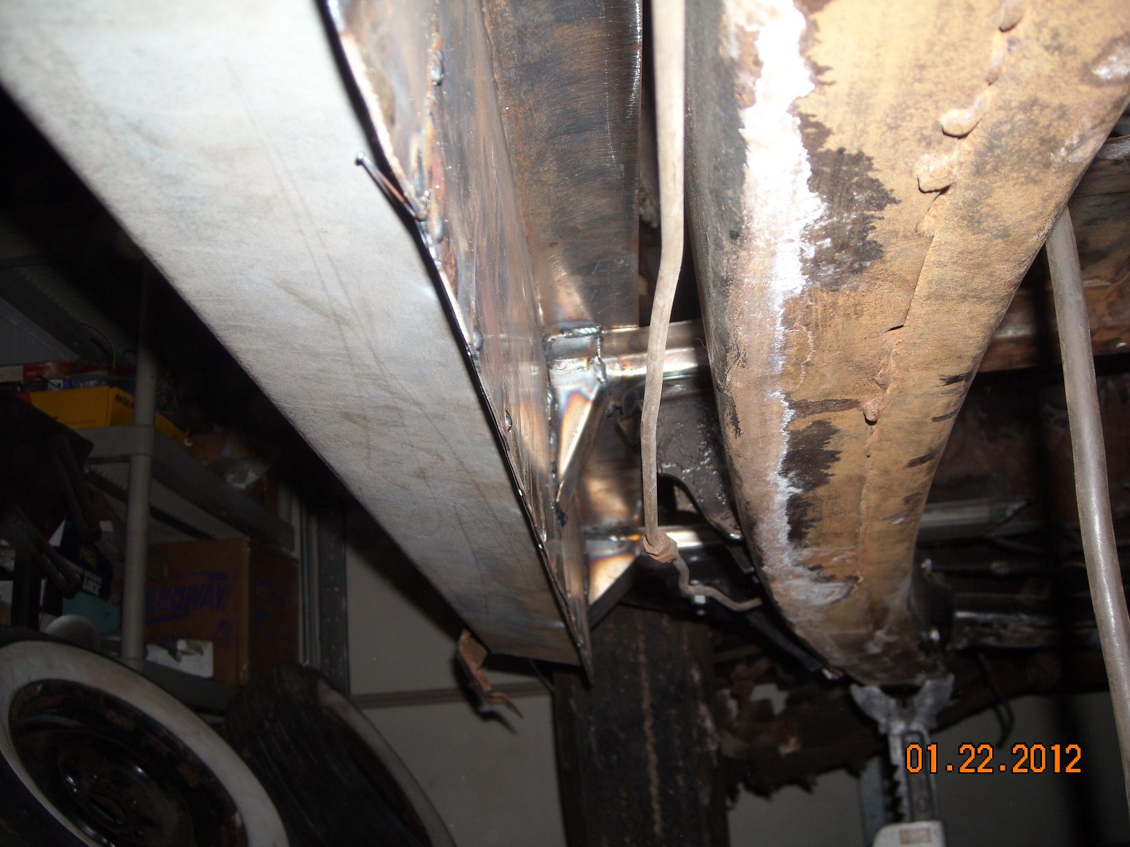

    and a couple views of the rocker panel.

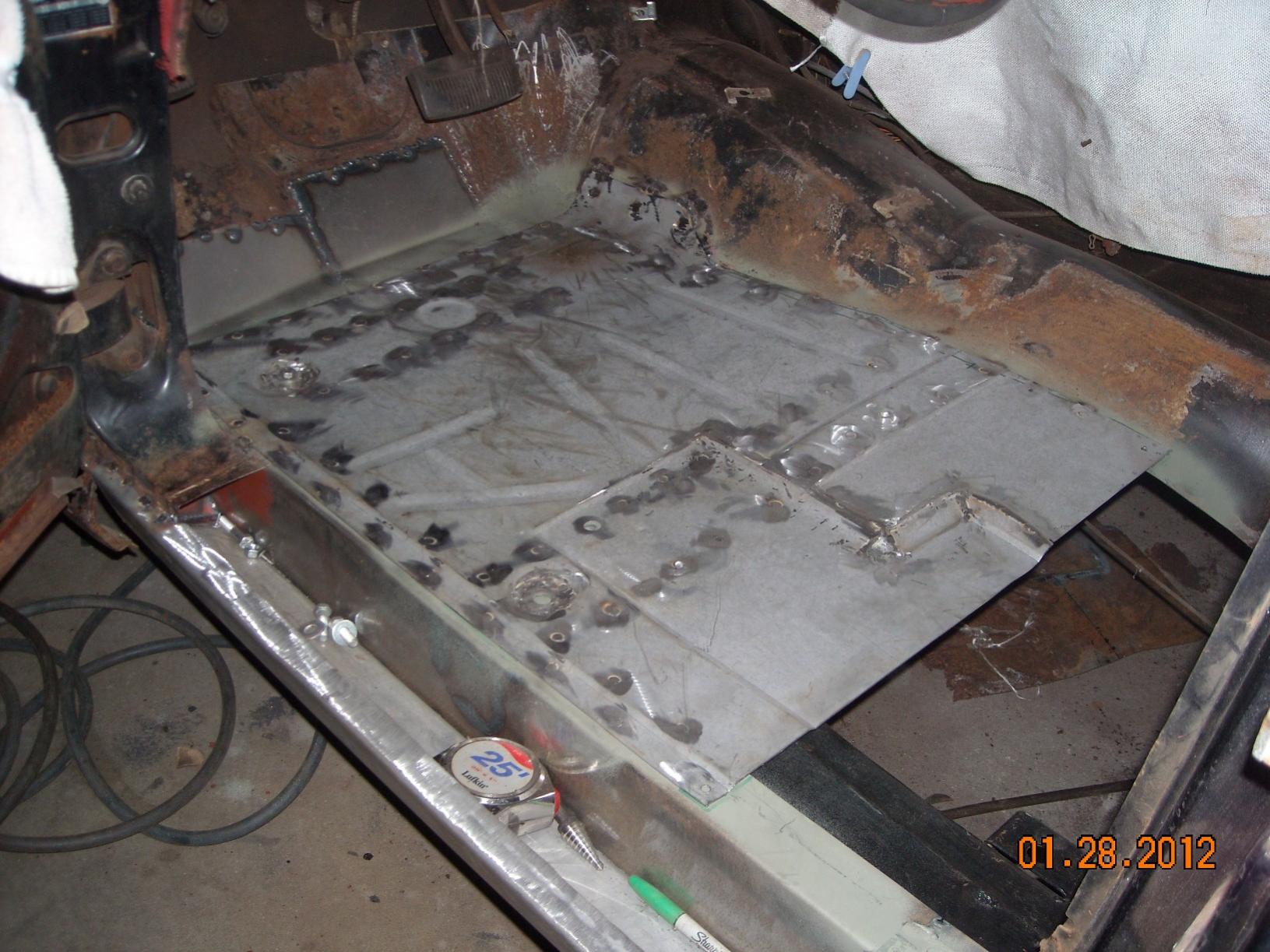

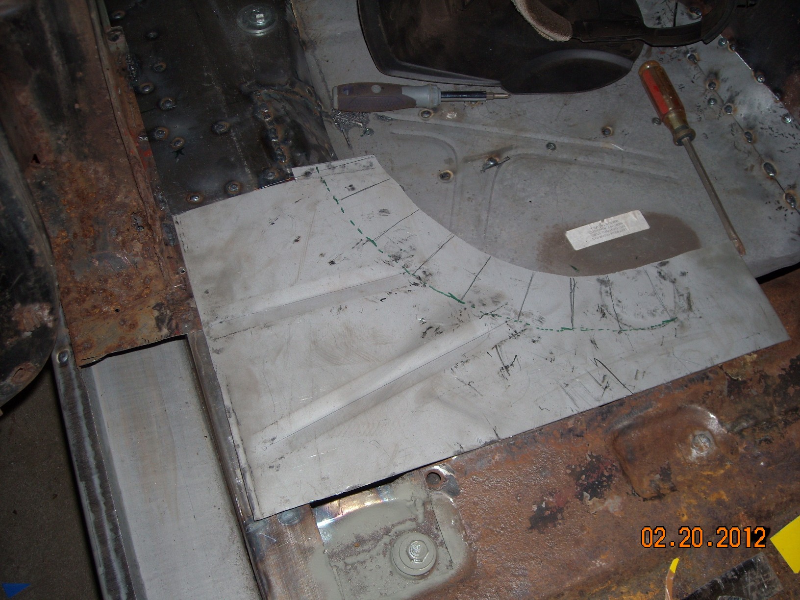

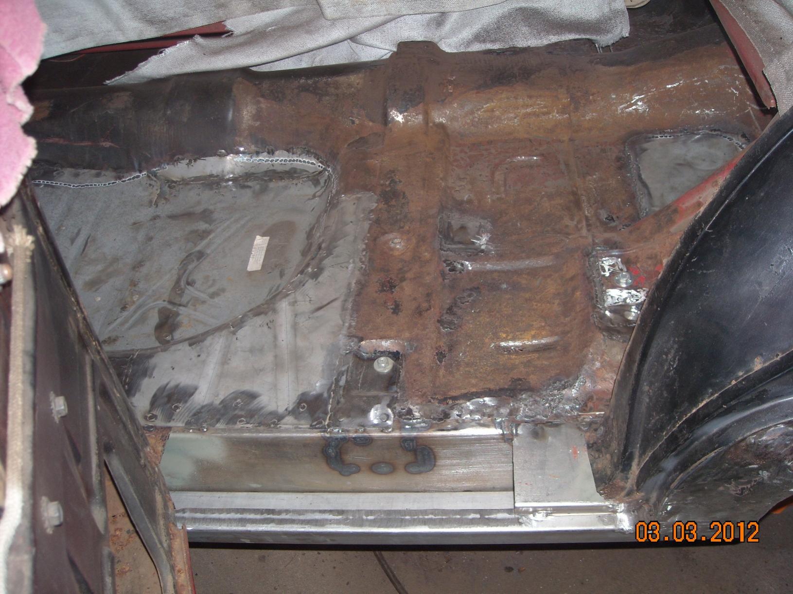

    Today I welded in the drivers front floor.
    This is the floor area ready for the new metal.

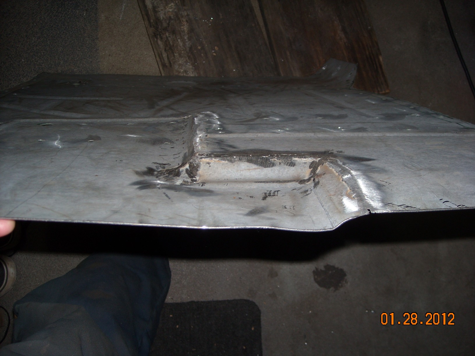

    The new patch panels are close. but thats about it.
    There needed to be more of a kick in one area. the patch panel had less than 1/4 inch in this area.
    I had to cut it then bend to match the original floor, then weld in some pieces in the gaps.
    The new front floor welded in.:D:D
    Next is the drivers rear floor.:eek::eek::eek: Will this never end!!!!
    I just couldn't stand any more today, so for today, thats it.

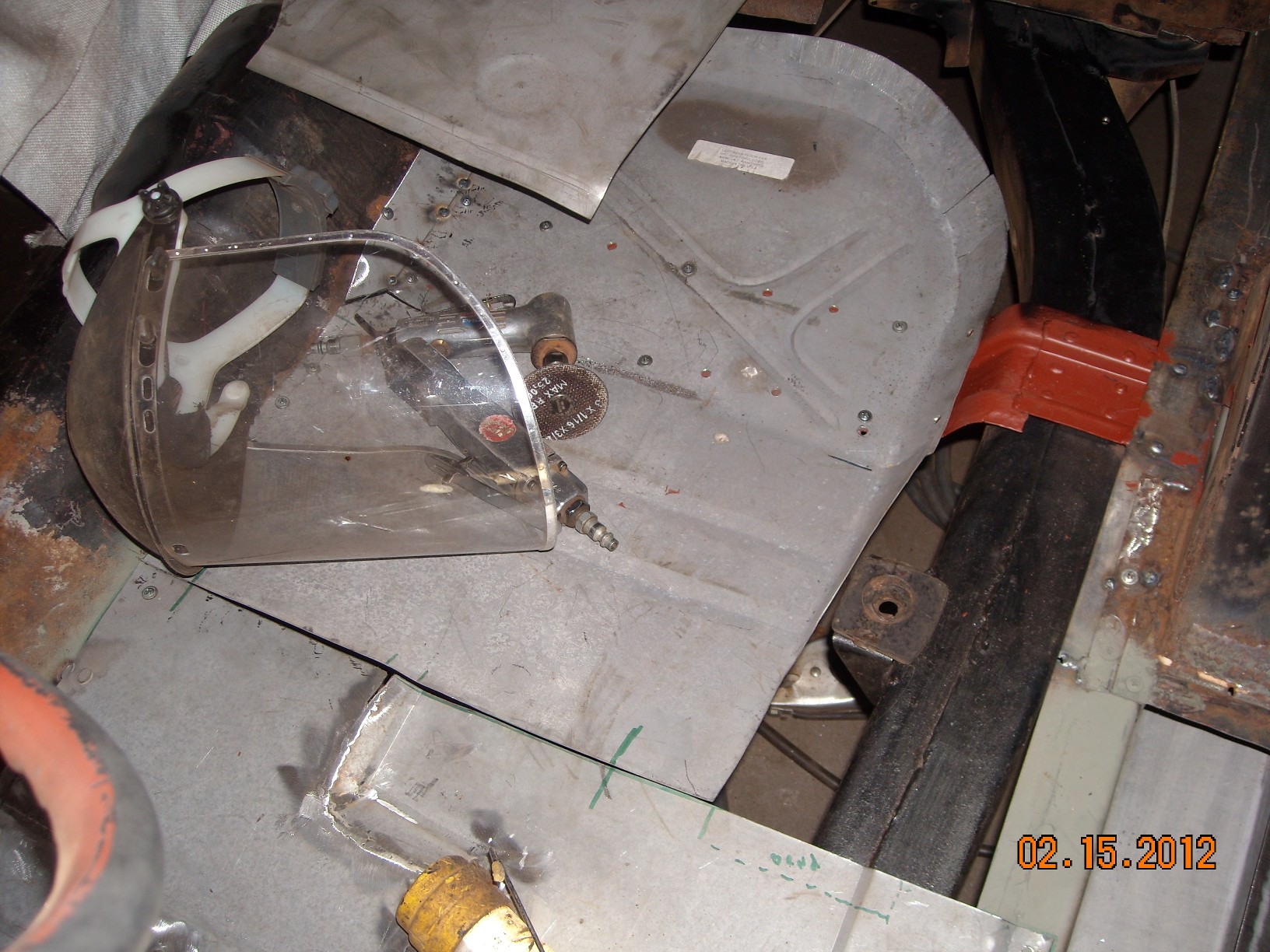

  24. greg
    Joined: Dec 5, 2006
    Posts: 537
    greg

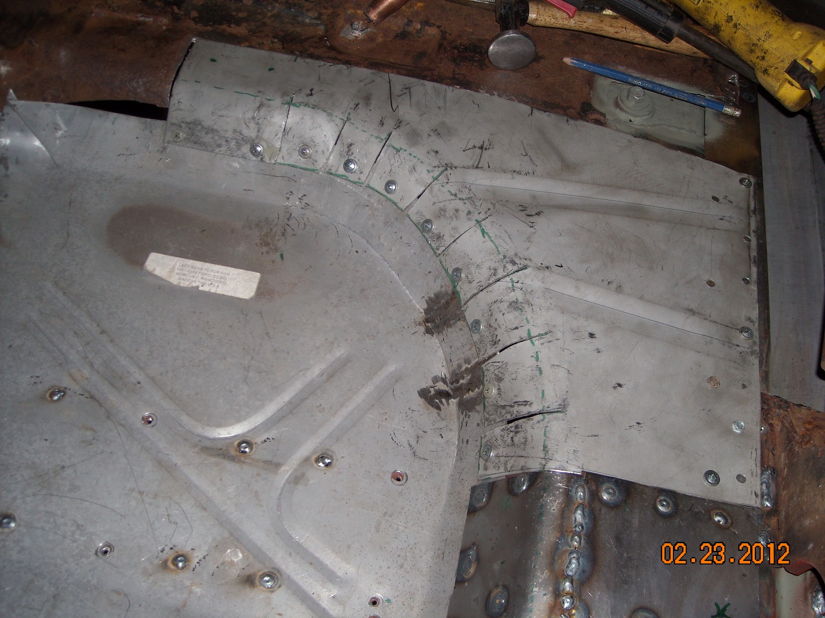

    Ive been pretty buisy on the ol Edsel.:)
    This is how much of the floor the replacement floor covers. as you can see Its not quite enough to cover the bad.

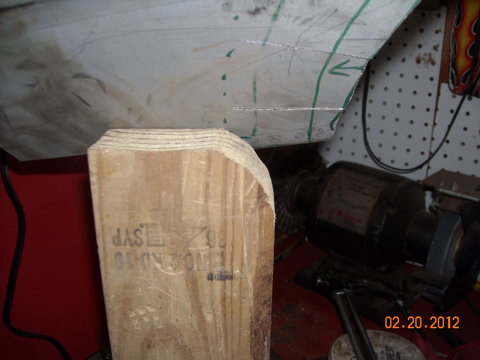

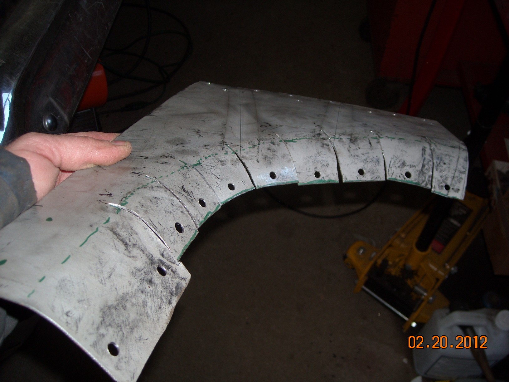

    I started making the rest of the floor from scratch. this one little part was a little tricky.

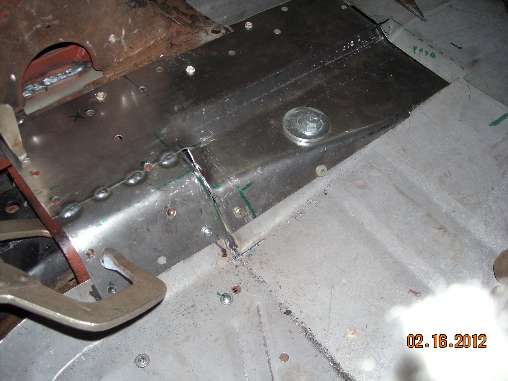

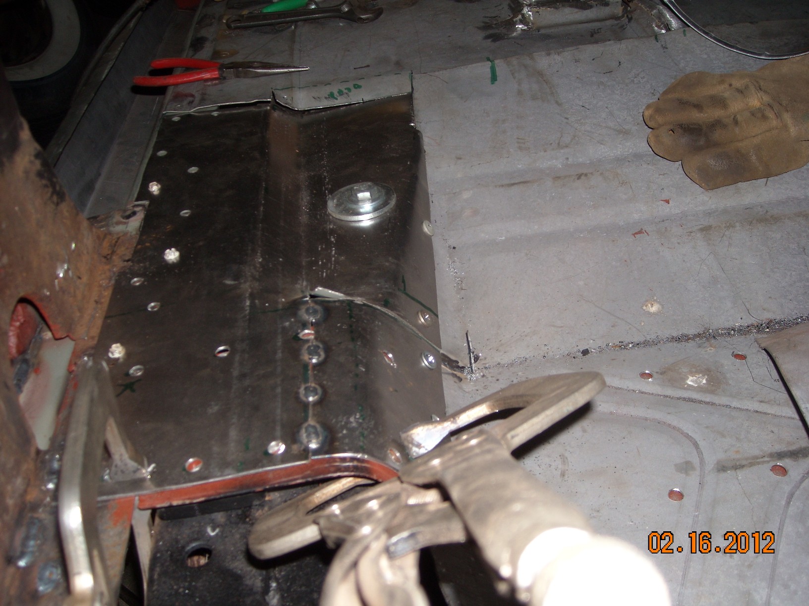

  25. greg
    Joined: Dec 5, 2006
    Posts: 537
    greg
    Here are the steps I took for the next area.

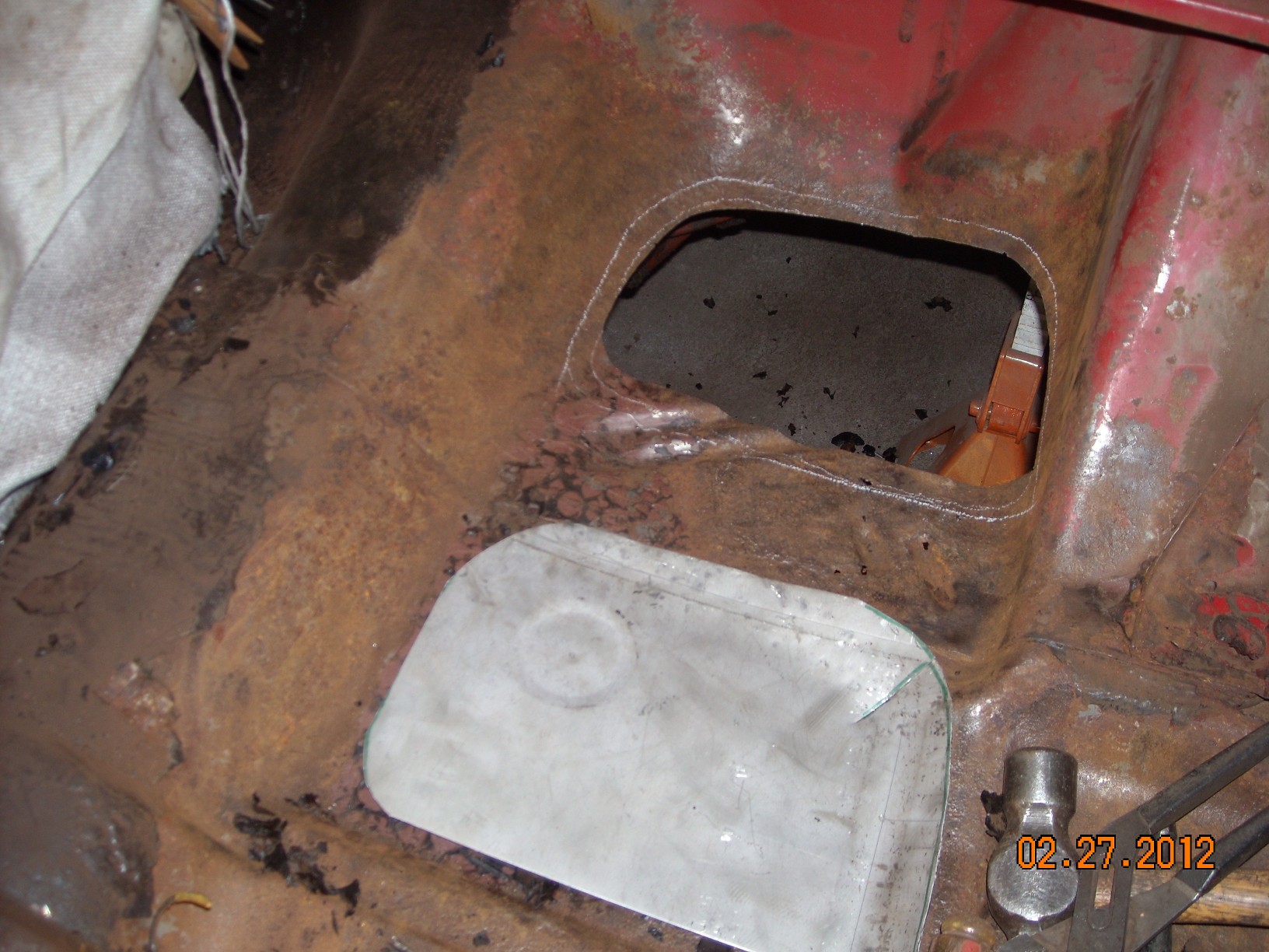

  29. greg
    Joined: Dec 5, 2006
    Posts: 537
    greg

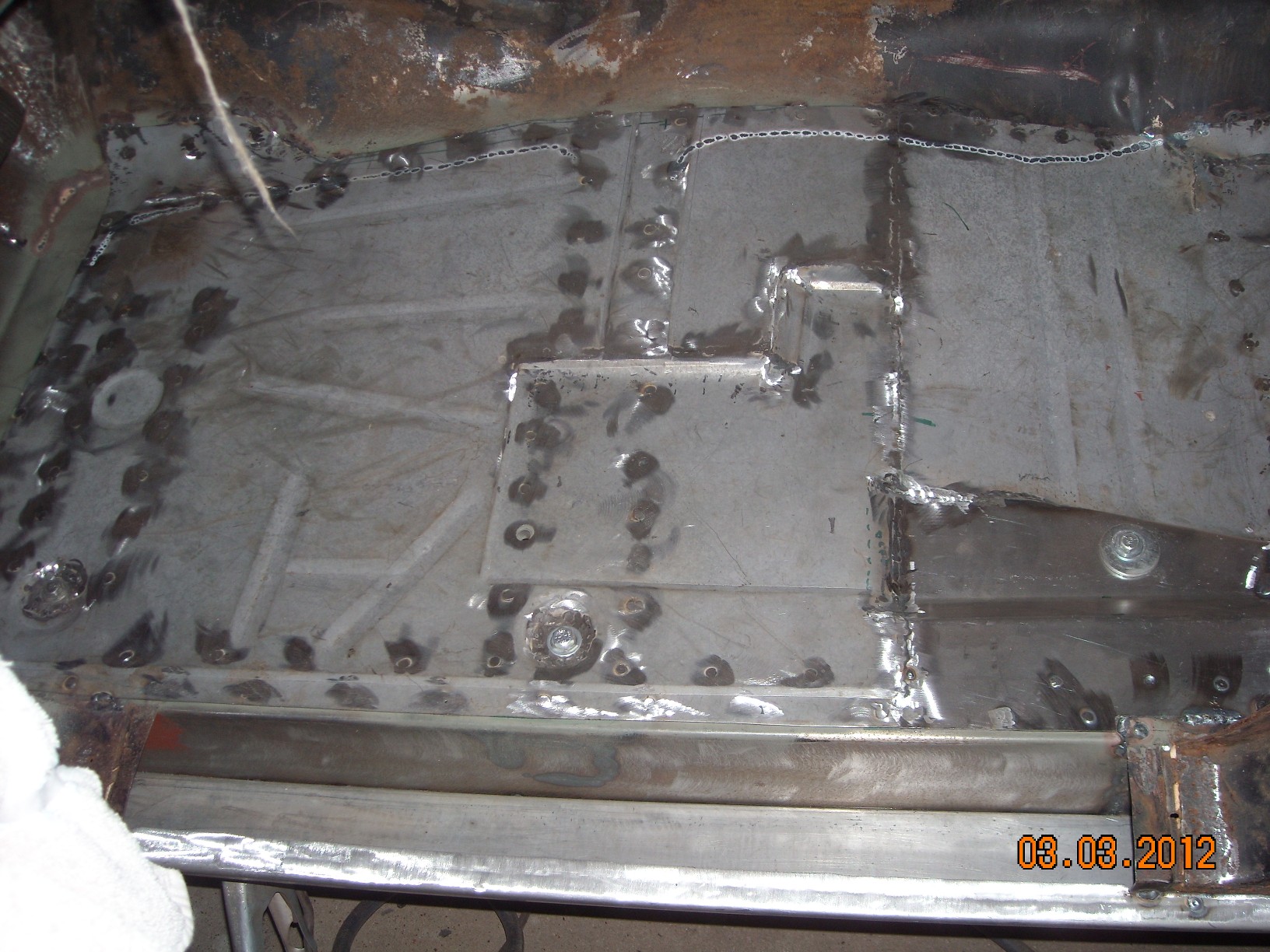

    This is a low lying area and the panel I plan to install. This area on the drivers side just had a couple of small holes that I welded up. This one needed more.
    Here is a view of the same area with ALL:D:D:D the holes welded up.
    A view from the door openings. I still have to finish sand the whole floor to prep for sealer, and make the door seal plates and weld them in after sealing inside the rockers.

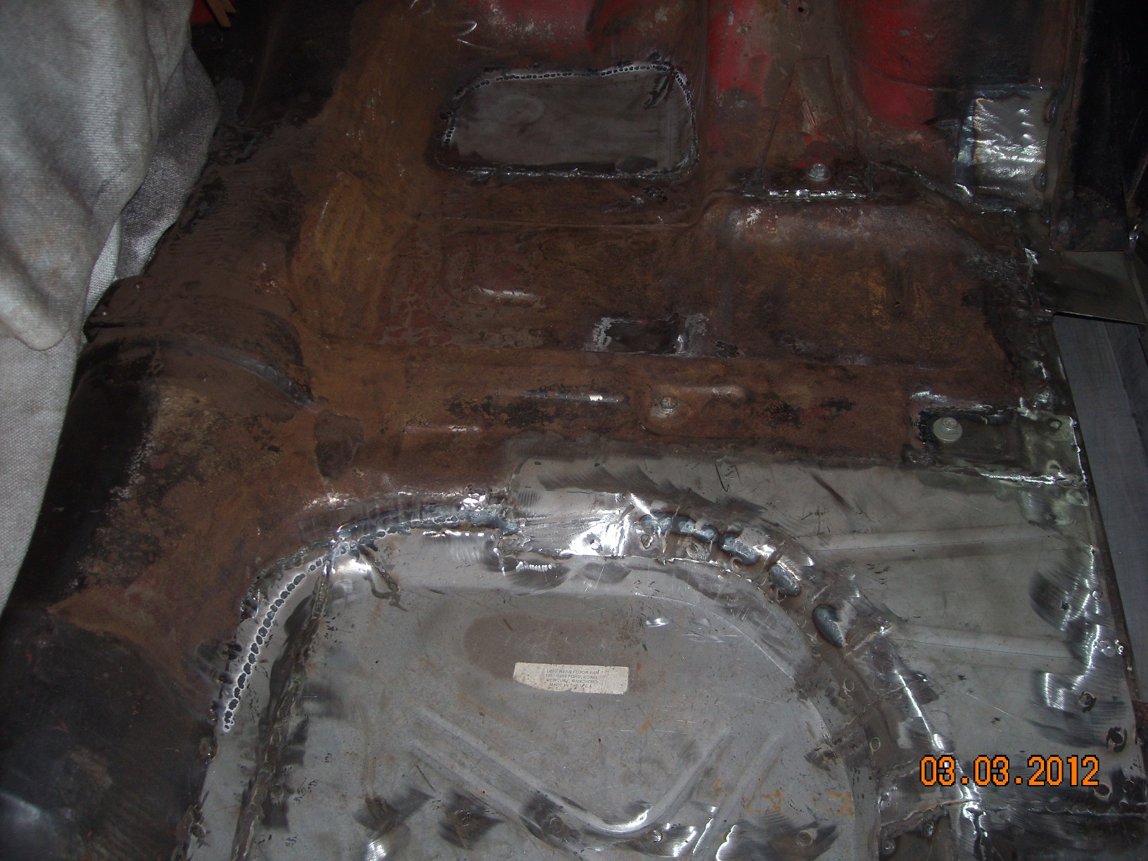

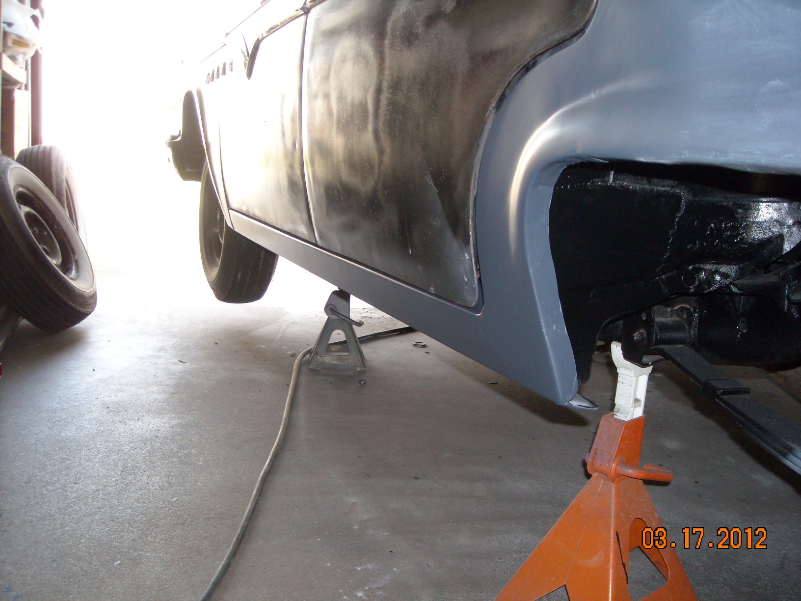

  30. greg
    Joined: Dec 5, 2006
    Posts: 537
    greg
    OK guys, I have made some great progress.:)
    The floor is done, done, done!!!!!!!!
    I hope this thread shows other people that anything can be fixed.
    I still have a loooong way to go. I guess if you buy a rust free car to start with, then that is where im at now after 2 winters of work.
    here are a few pics.
    I had to repair the rear of the front fender.
    there was screen door wire holding in the bondo.
    I made the patch in 3 pieces:eek:. why, i dont know, it just turned out that way.
