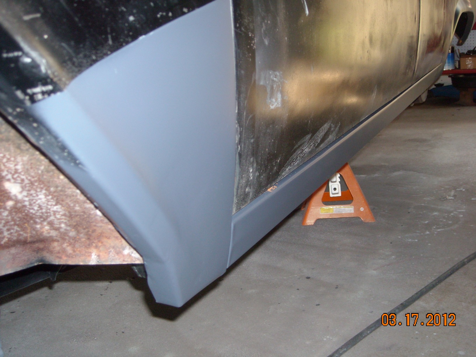

    Here is another shot of the rocker and fender.

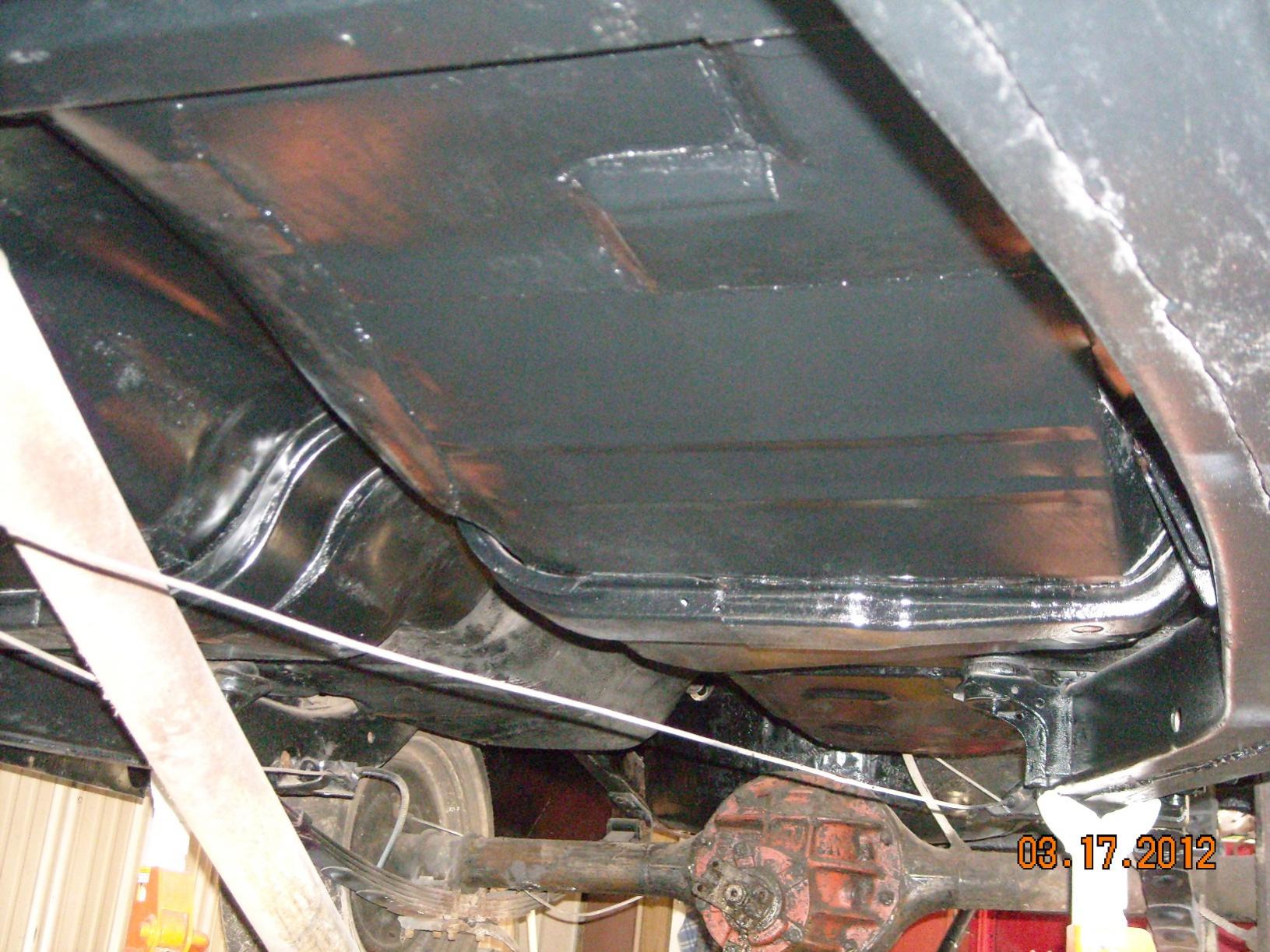

    greg

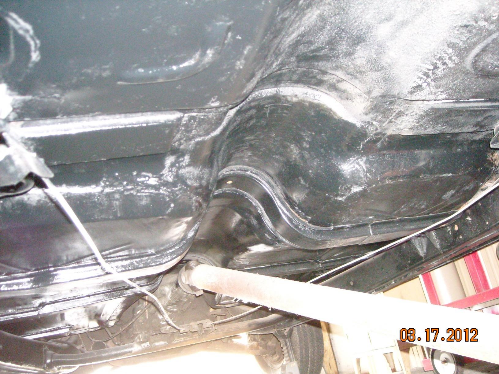

    And a couple of pics of the underside.
    Its all painted. not a show car, but no rust holes and coated with paint to prevent any more rust.

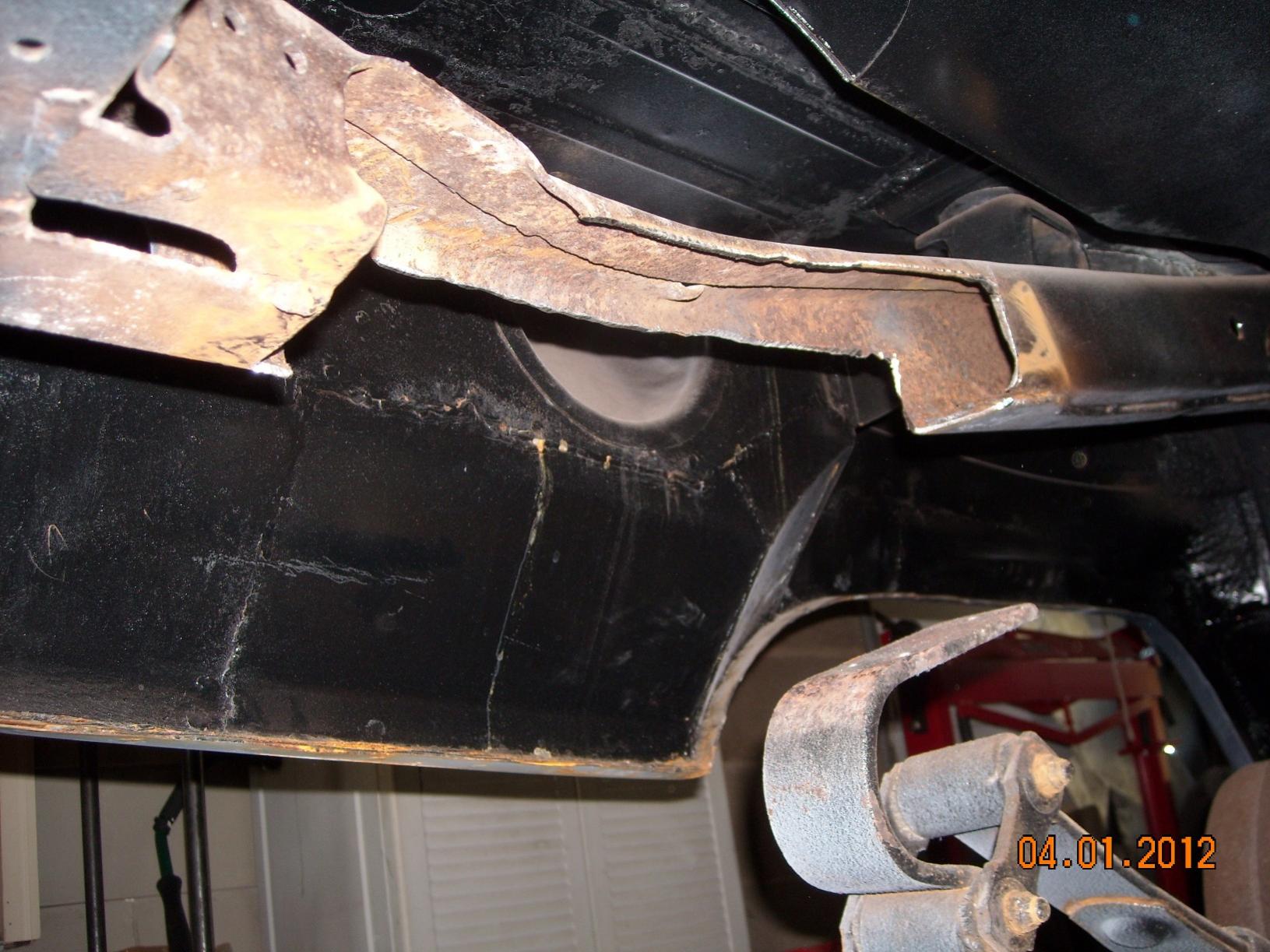

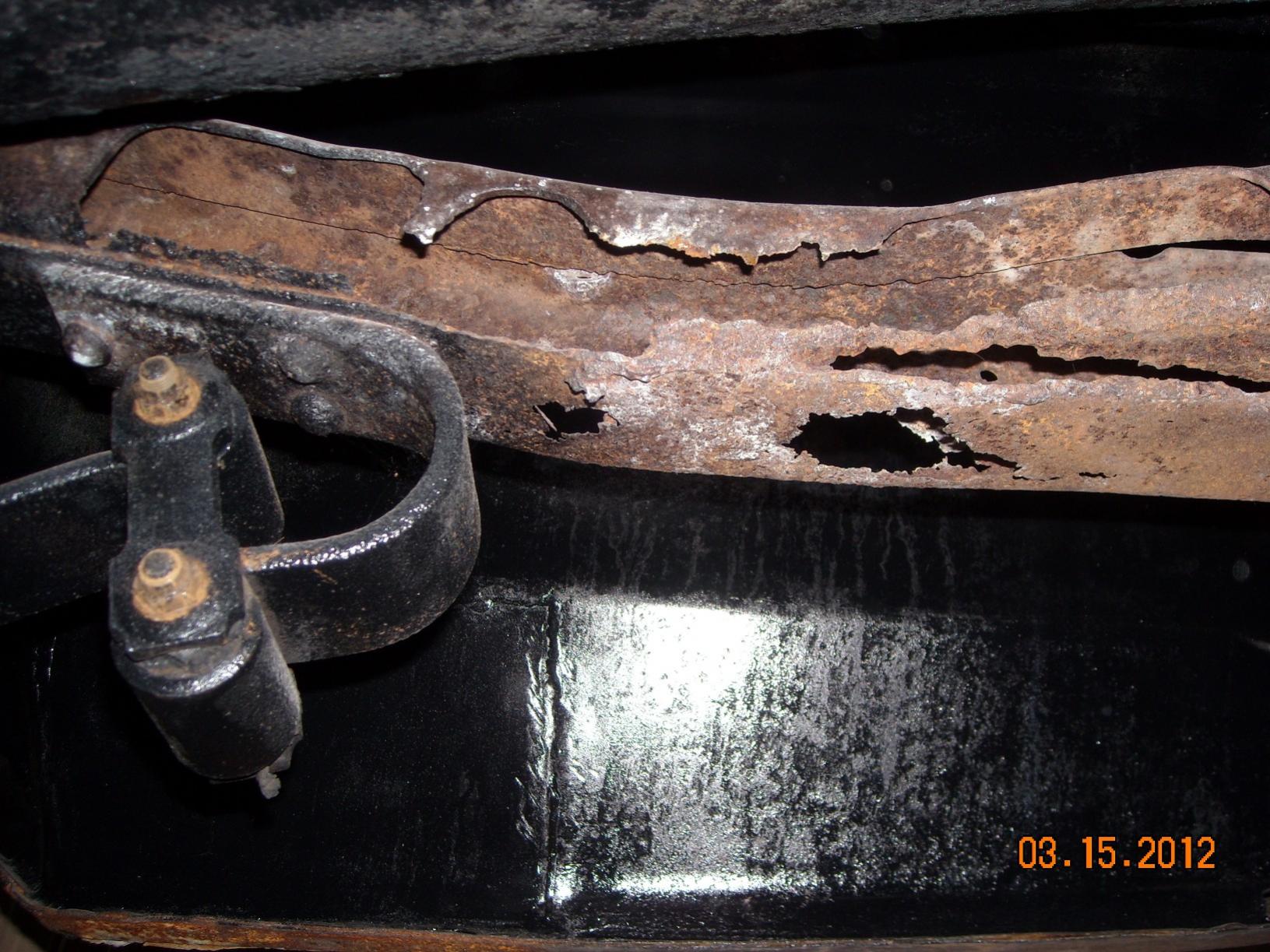

  6. greg
    Joined: Dec 5, 2006
    Posts: 537
    greg

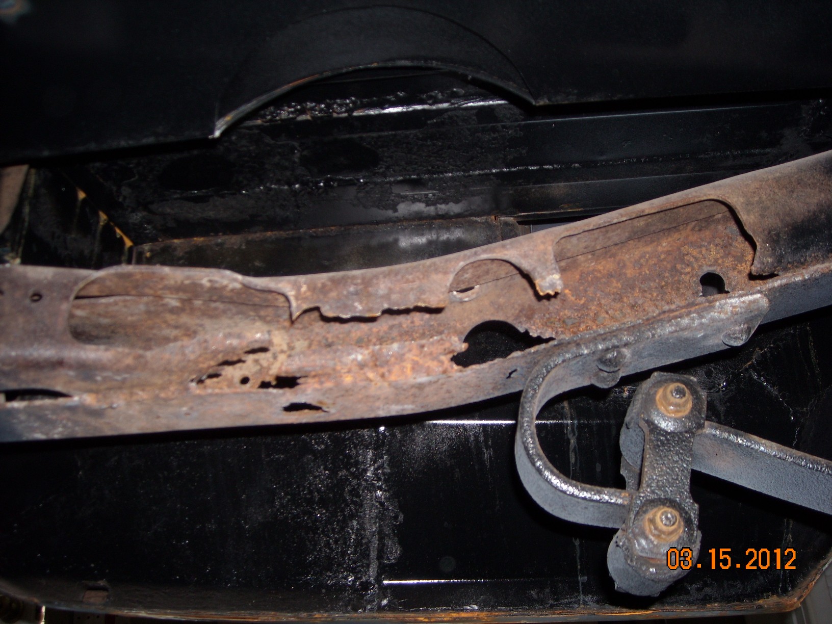

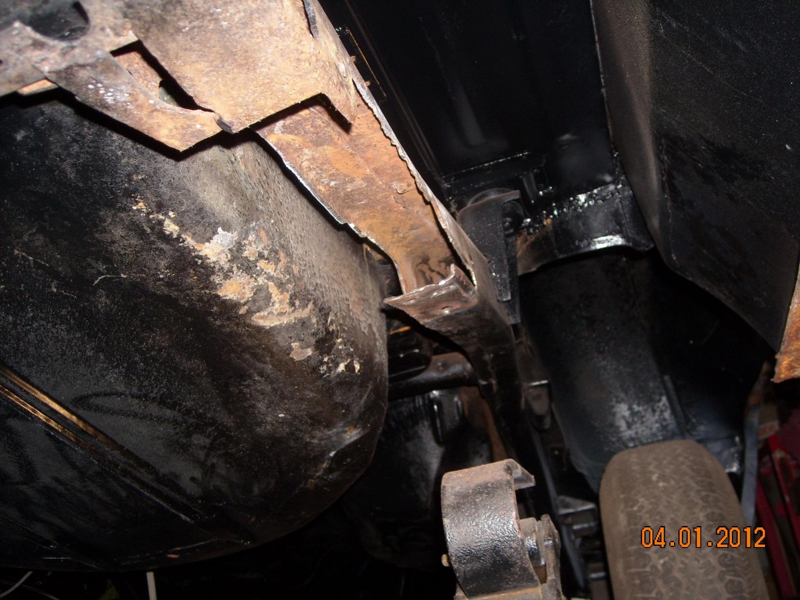

    This is the next area to get my attention.
    this is the only bad area of the frame.
  7. Mats W
    Joined: Feb 18, 2012
    Posts: 142
    Mats W
    Great work on your Villager so far :cool:
    That's an area a little tricky to fix when you don't have the body off...
    It looked excactly that way on my '62 Country Sedan, only also the rear crossmember (by the bumber) was pretty crusty too. I rember it was a real pain in the *ss to weld up in there lying on the garage floor :rolleyes:
    GOOD LUCK :)

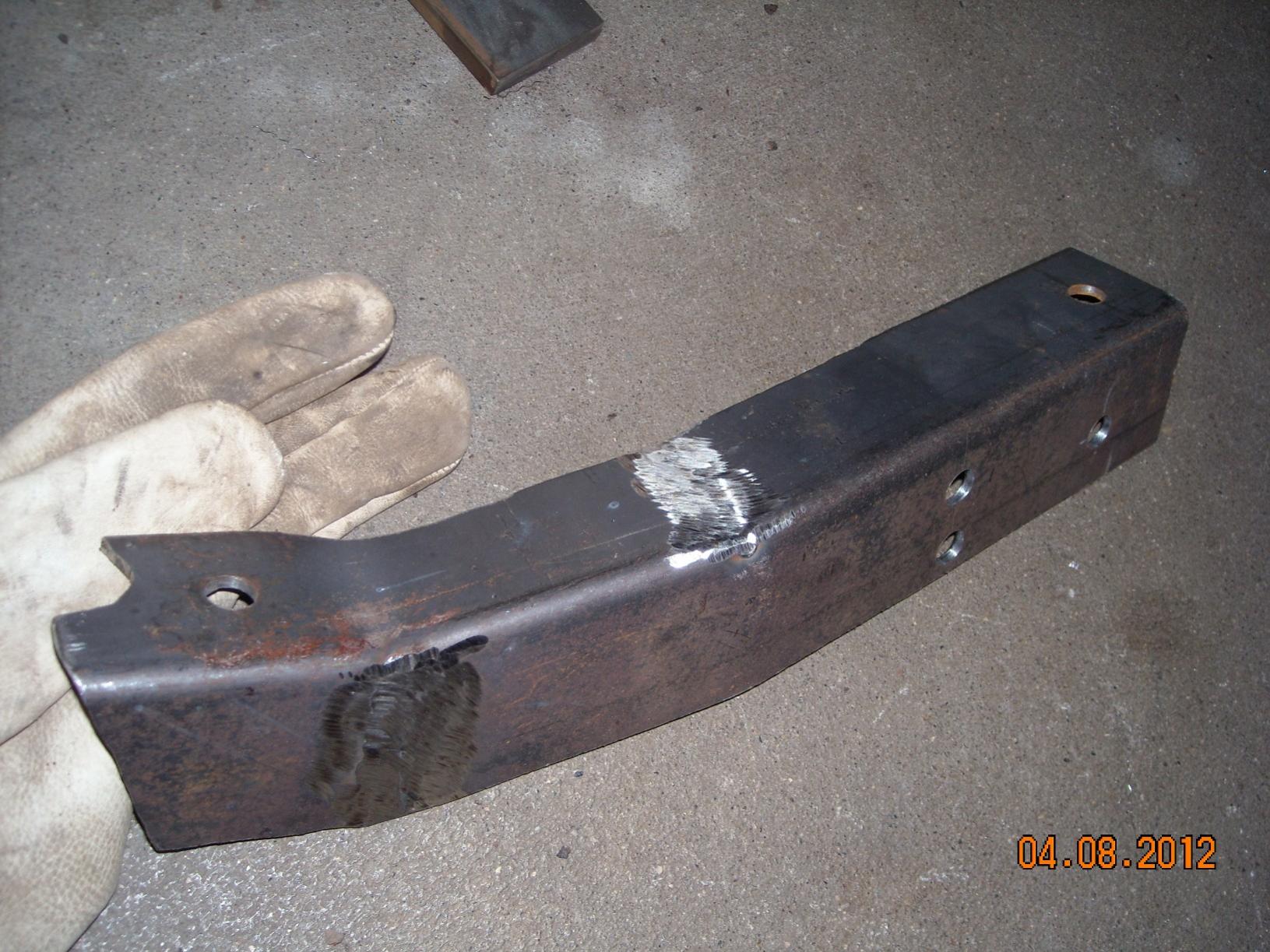

  9. greg
    Joined: Dec 5, 2006
    Posts: 537
    greg

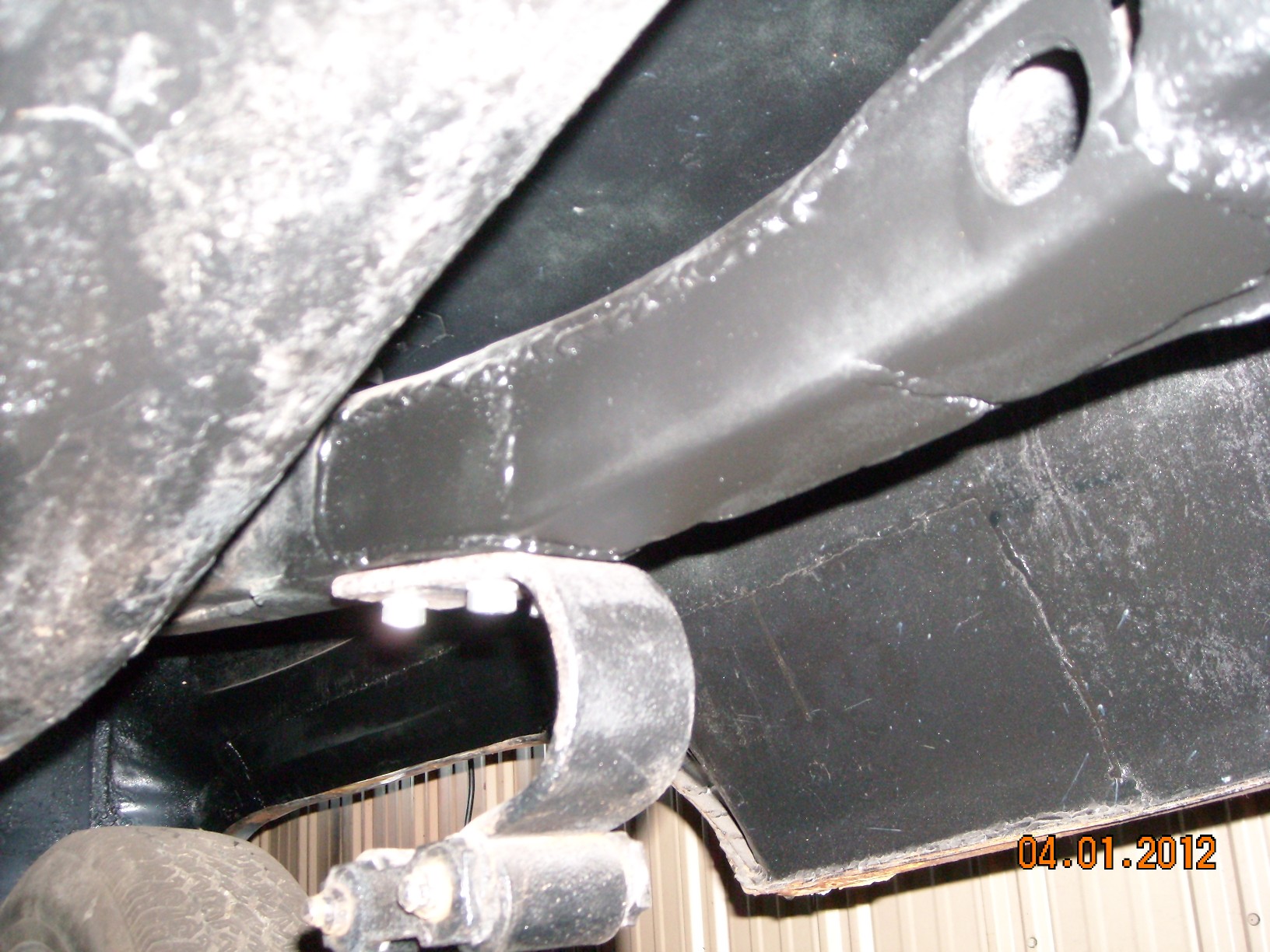

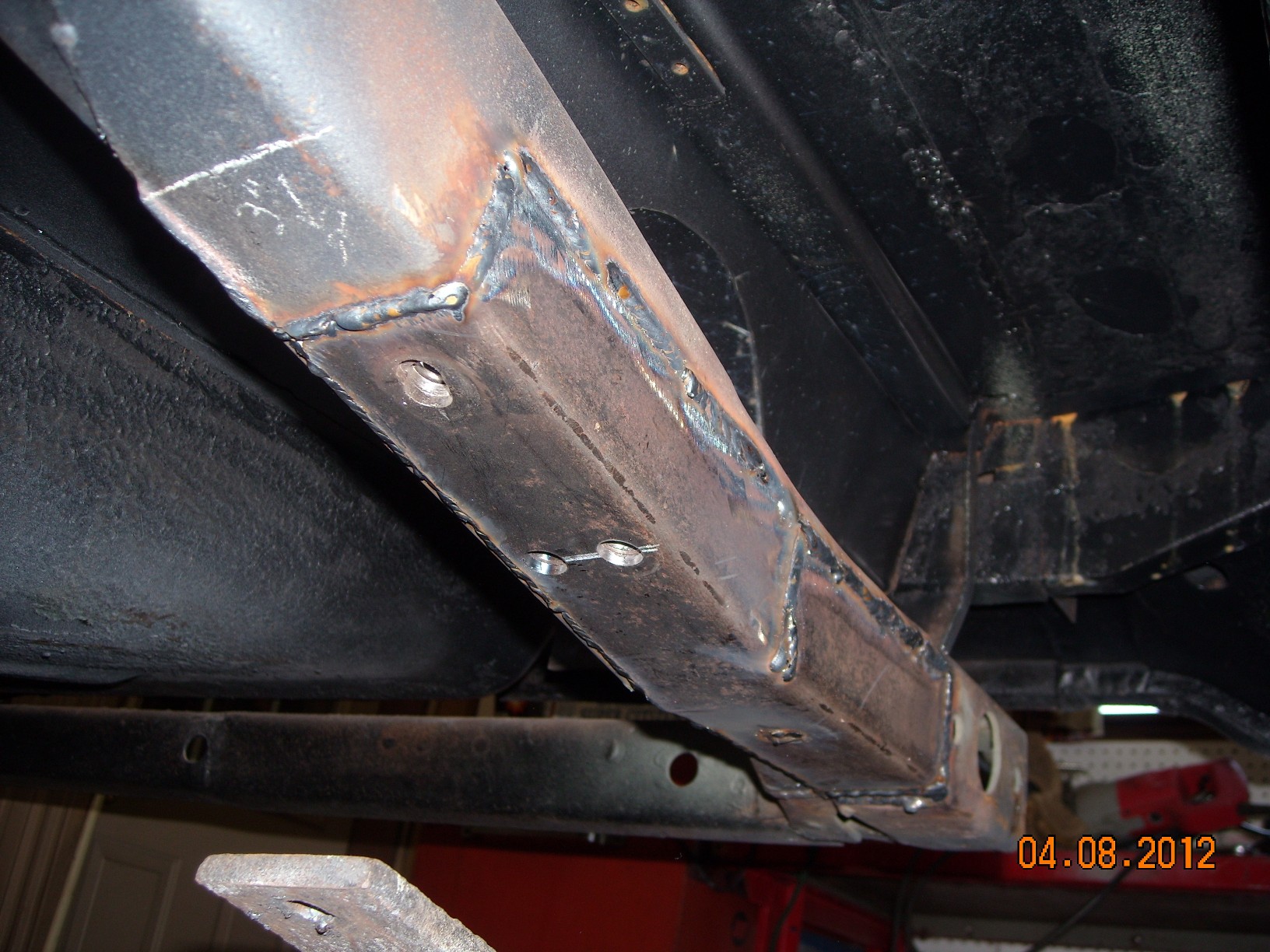

    This is the area of the frame with the rot cut out.
    I had some 10 ga. laying around that was bent up for bucket seat risers that i never used. I cut them up and they worked great.
    I put a 3/8 X 2 x 6 in plate drilled and tapped inside the frame rail to bolt the spring shackel plate to.
    It took some work to fit it up to the slight curvature of the frame, but it turned out pretty good.

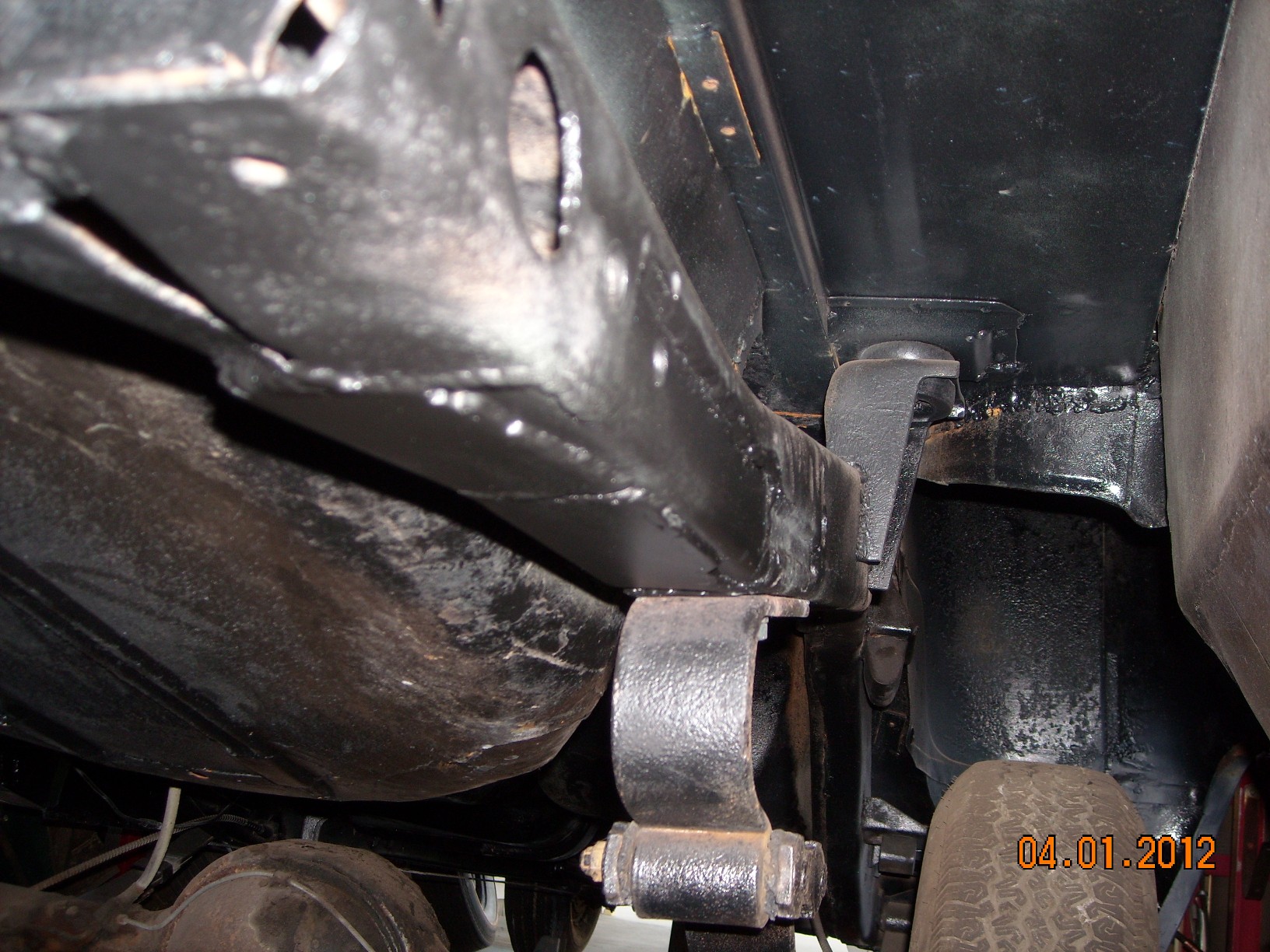

    This is the frame repair on the drivers side rear shackle mount.
    this is the new inner frame.
    same piece with the plate that i welded inside the frame.
    Here it is all welded in.

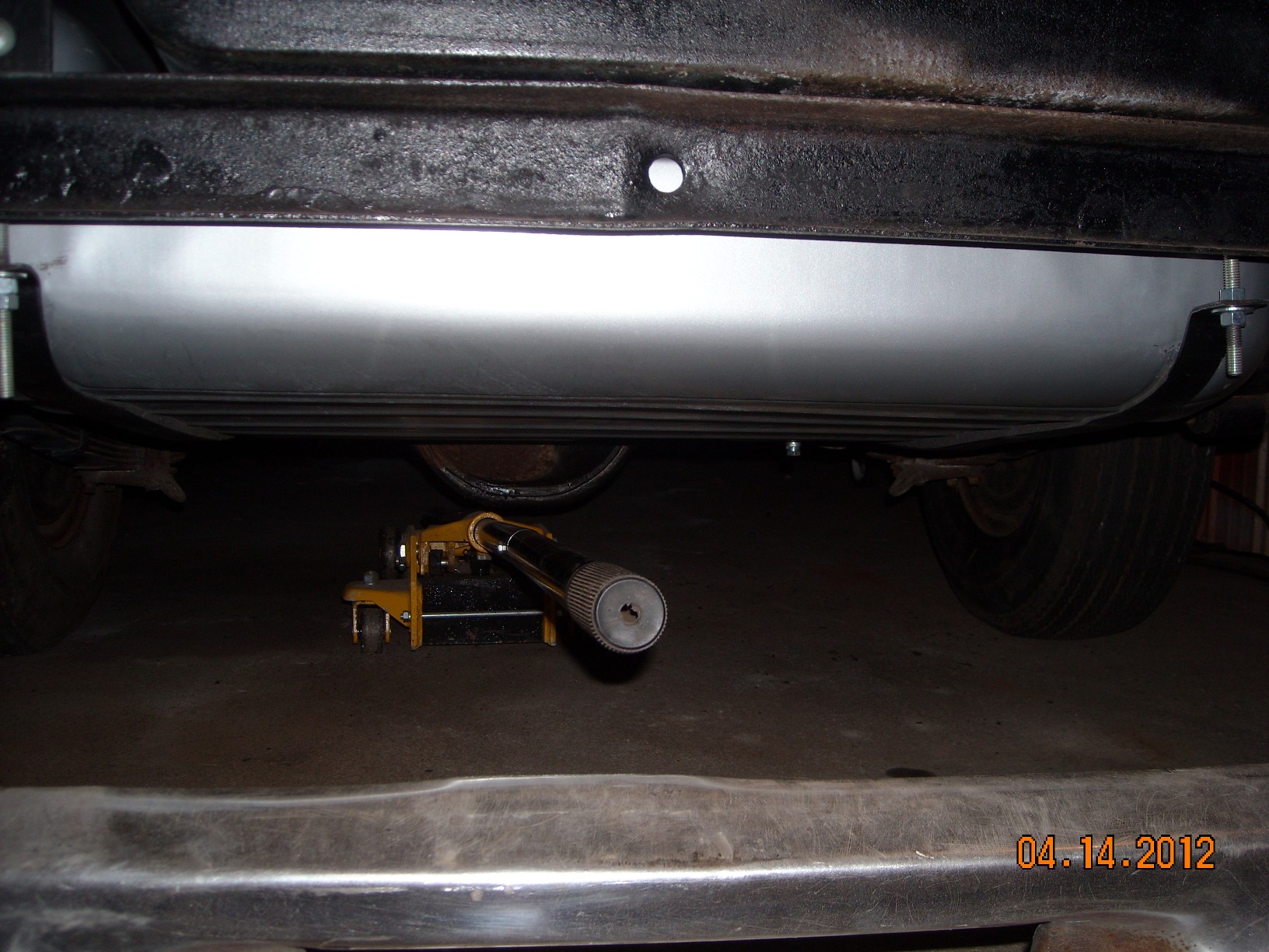

  11. greg
    Joined: Dec 5, 2006
    Posts: 537
    greg
    Today I got the gas tank bolted in.
    then I took it off the jack stands.
    It will need to go back on them before too long, but I just wanted to see it on all 4 wheels again,
    plus I havent heard it run since I cut the muffler off of it and I want to hear it with just a straight pipe about 2' long.:D

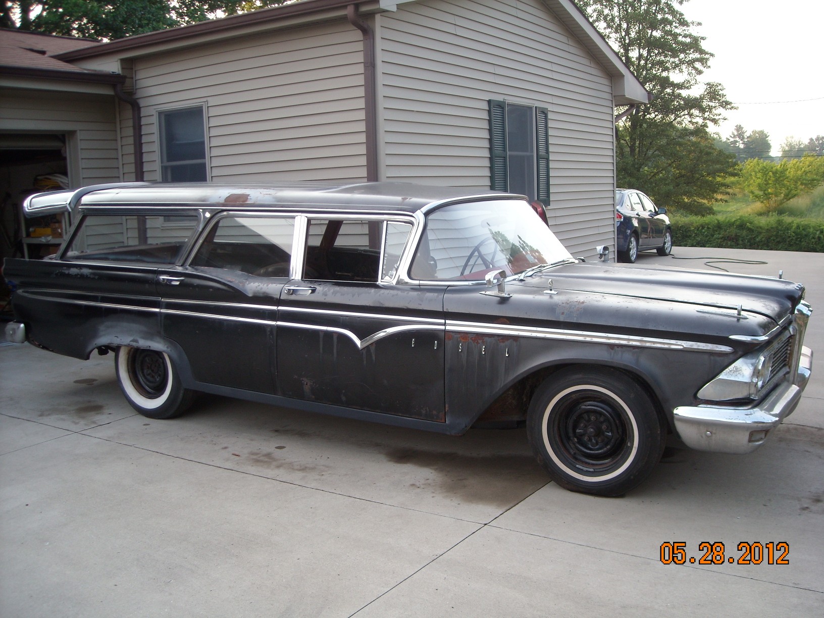

  27. greg
    Joined: Dec 5, 2006
    Posts: 537
    greg
    The Edsel project has really slowed down.
    Iv'e been on vacation this last week mostly working around the house.
    But I did get to the garage a couple of times.
    The lovely wife went out and helped me bleed the brakes one day so
    I got the edsel started and pulled it outside and washed the winters dirt off. Its the first daylight it has seen since last fall.:cool:
    I did manage to build a leantoo on the back of the garage so the edsel will have a home out of the rain.

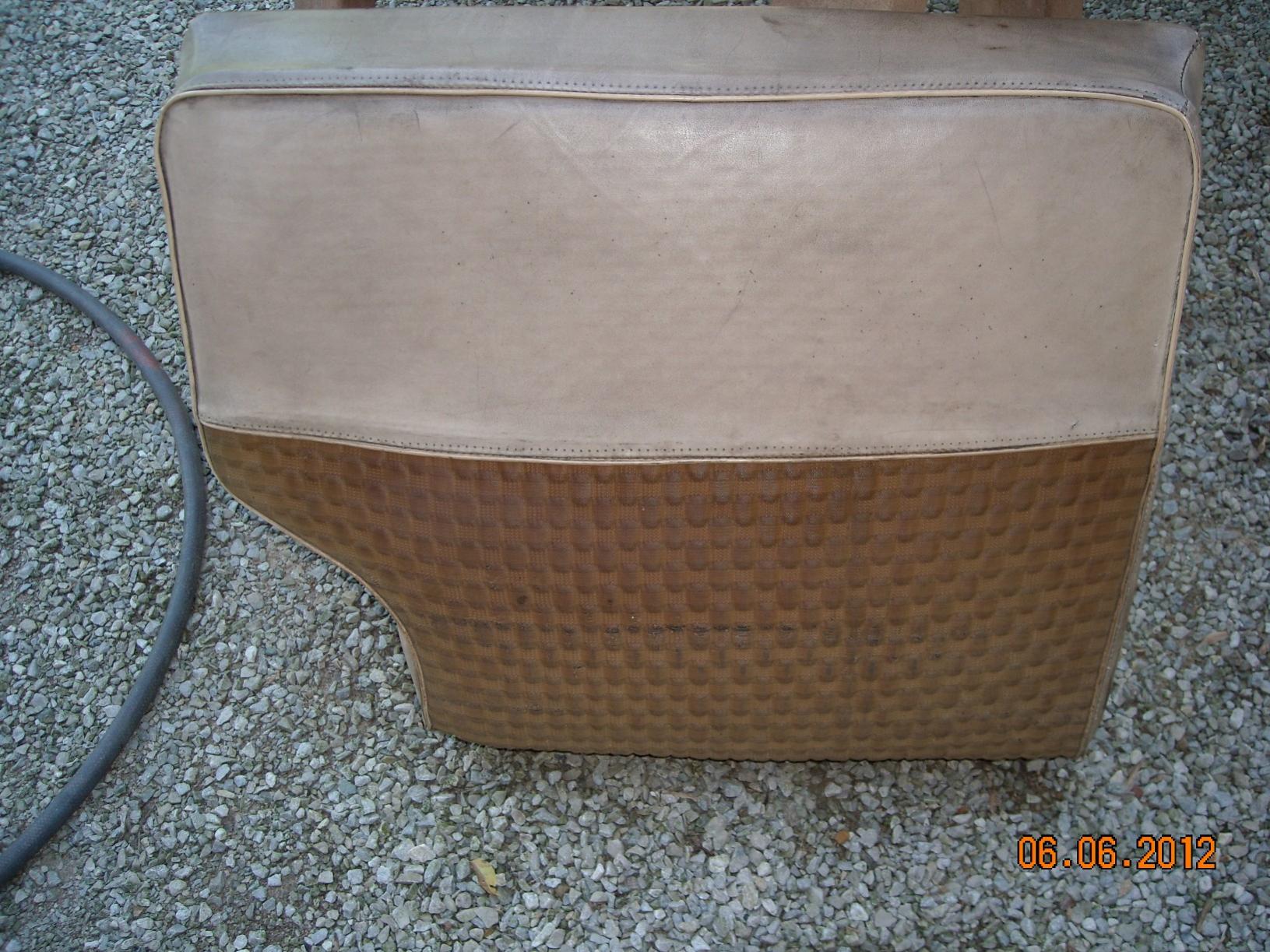

  30. greg
    Joined: Dec 5, 2006
    Posts: 537
    greg

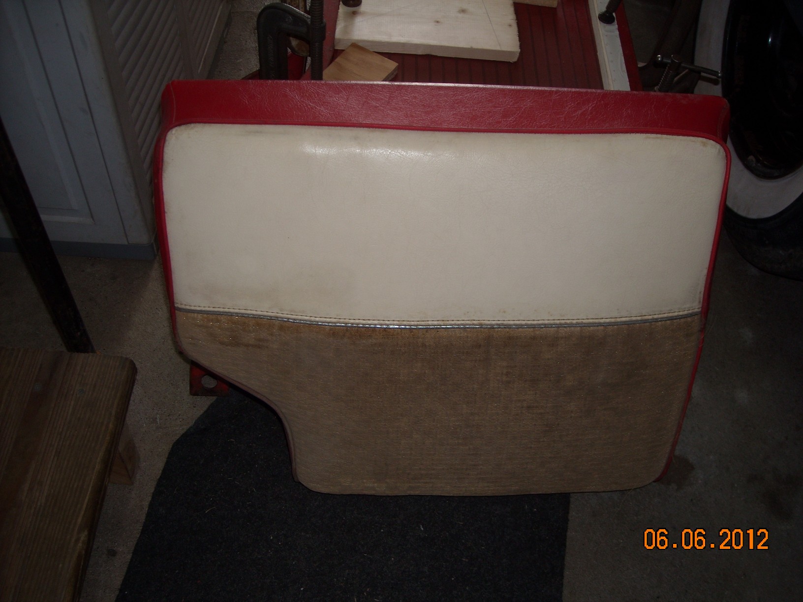

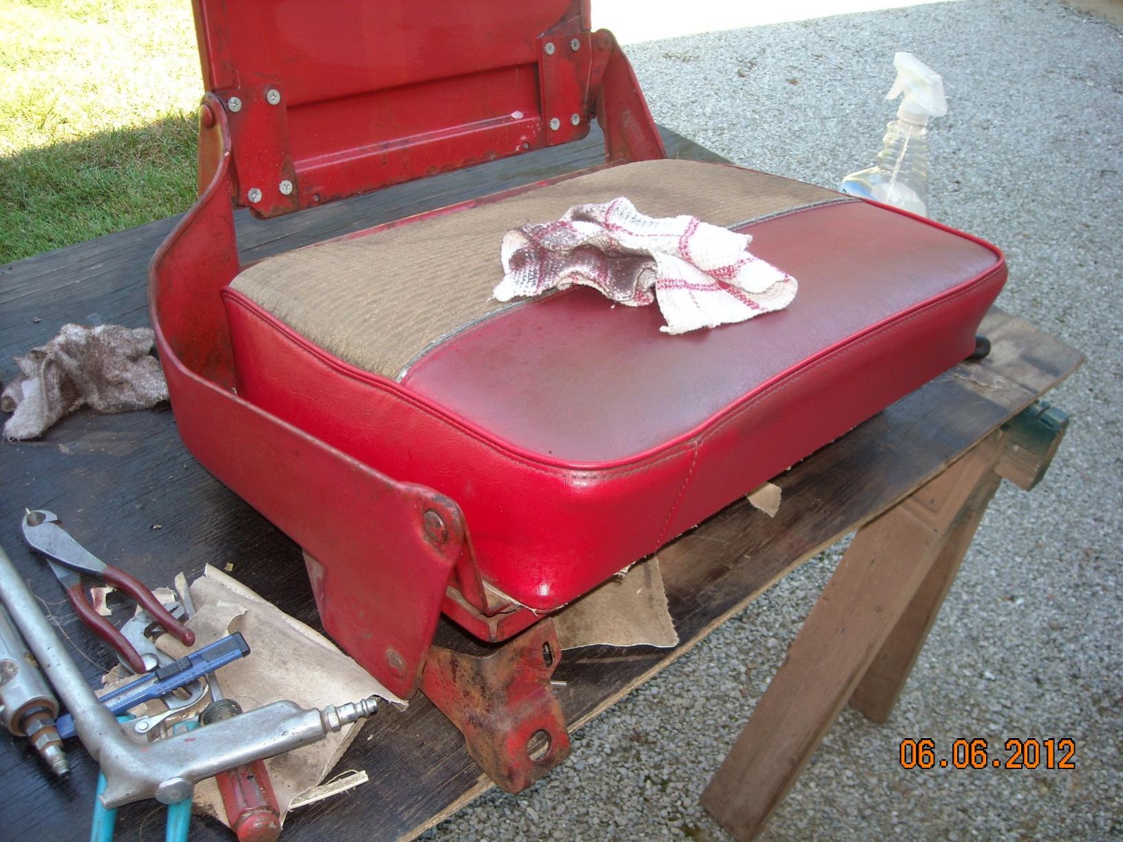

    Havent done a whole lot lately on the edsel.
    I dont want to get too involved so I have been cleaning the seats to stick back in.
    There was something living here at one time.:confused:
    There was a cover sewn on at one time s I took it off.
    The upolstery was pretty good under it.
    The tan color part is kinda rough, but its not tore.
    I am having a new piece made for the bottom of the front seat, and the rest I am just going to clean up for now.
    I will post pics ofthe front at a later date.
