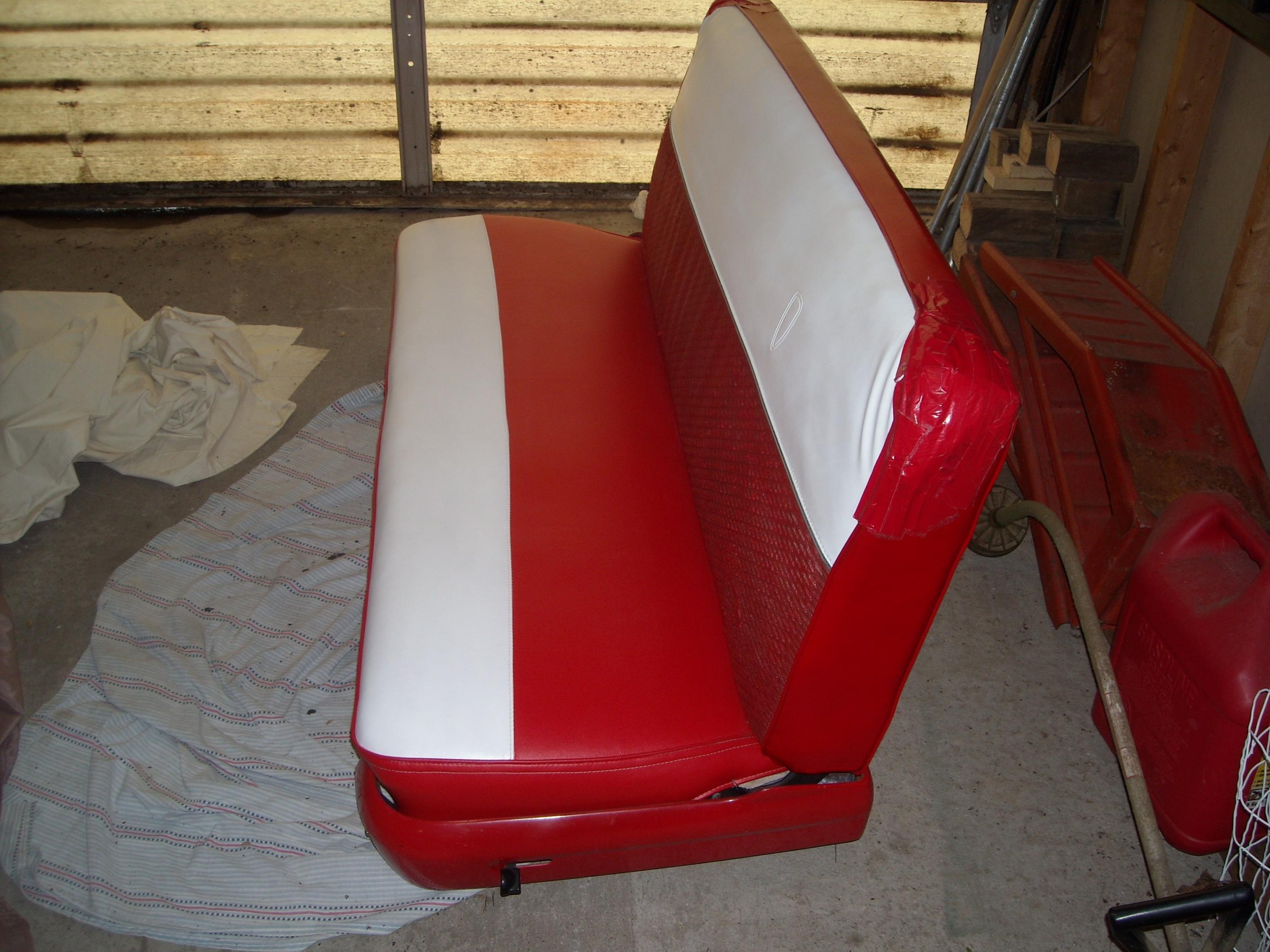

    I Haven't updated my post for a while. I moved the edsel under the leantoo I built behind my garage for the summer.
    I have been working on the seats, just cleaning them up.
    The bottom of the front seat was totally wasted. I took the seat apart and took the seat bottom fabric to a upolsterer friend and he made me some new. He also set me up with a piece of foam and the hog rings, so he just did the cover and I did all the teardown, cleaning and installing.
    I used fabric paint on the rest of the seat where it was so faded and discolored that cleaning wouldnt work.

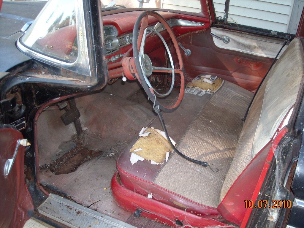

    Here is the only before picture I have.

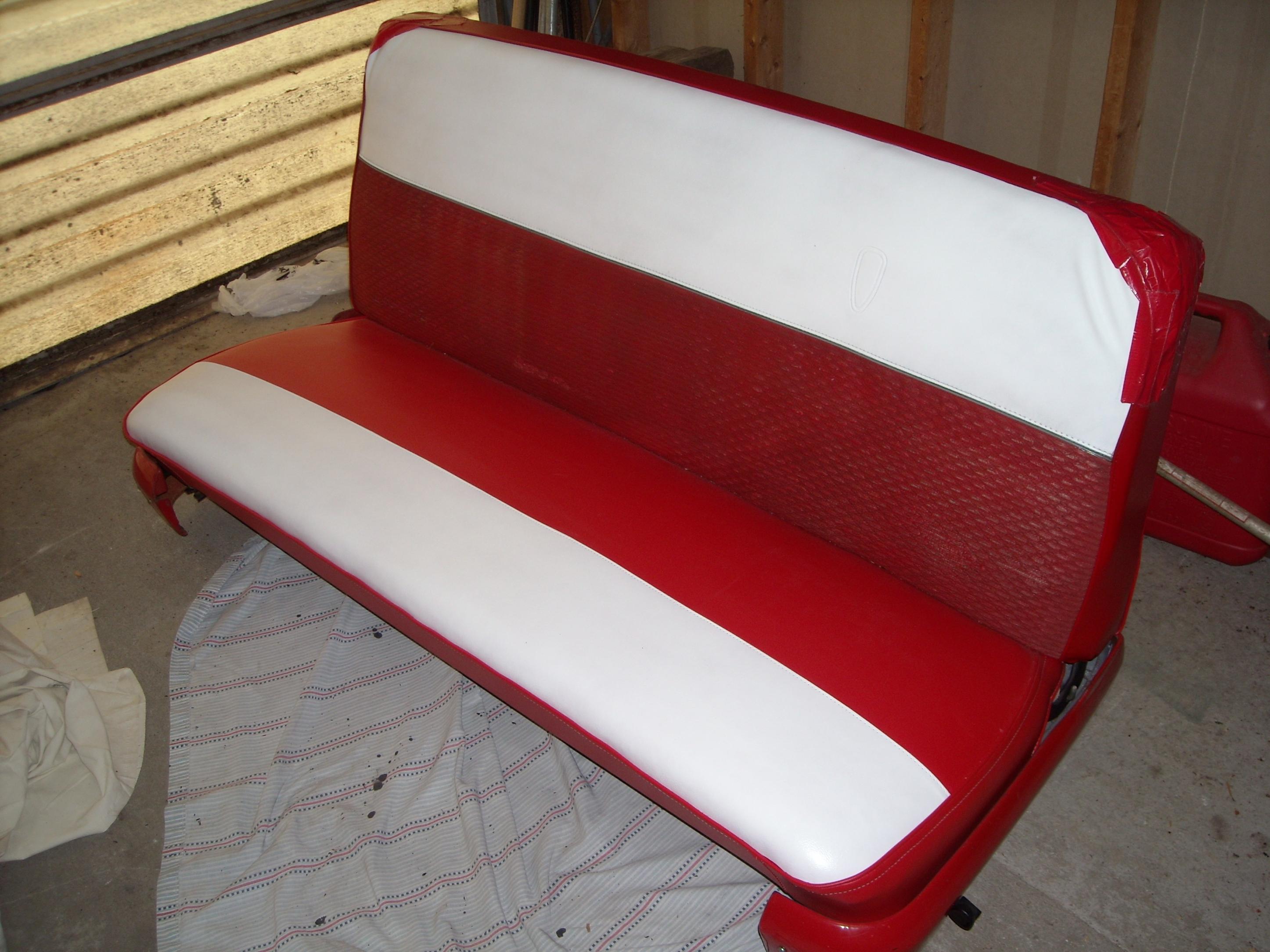

    And the after shots.
    I am changing the color where part of the seat was a tan color.
    The tan fabric paint just didnt cover good, so I went with the red and white. To me the tan looked like it didnt match anything else, and I think it looks better this way.
    I am goint to do some pinstriping on the rear of the front seat when I get up enough nerve to do it.:rolleyes:

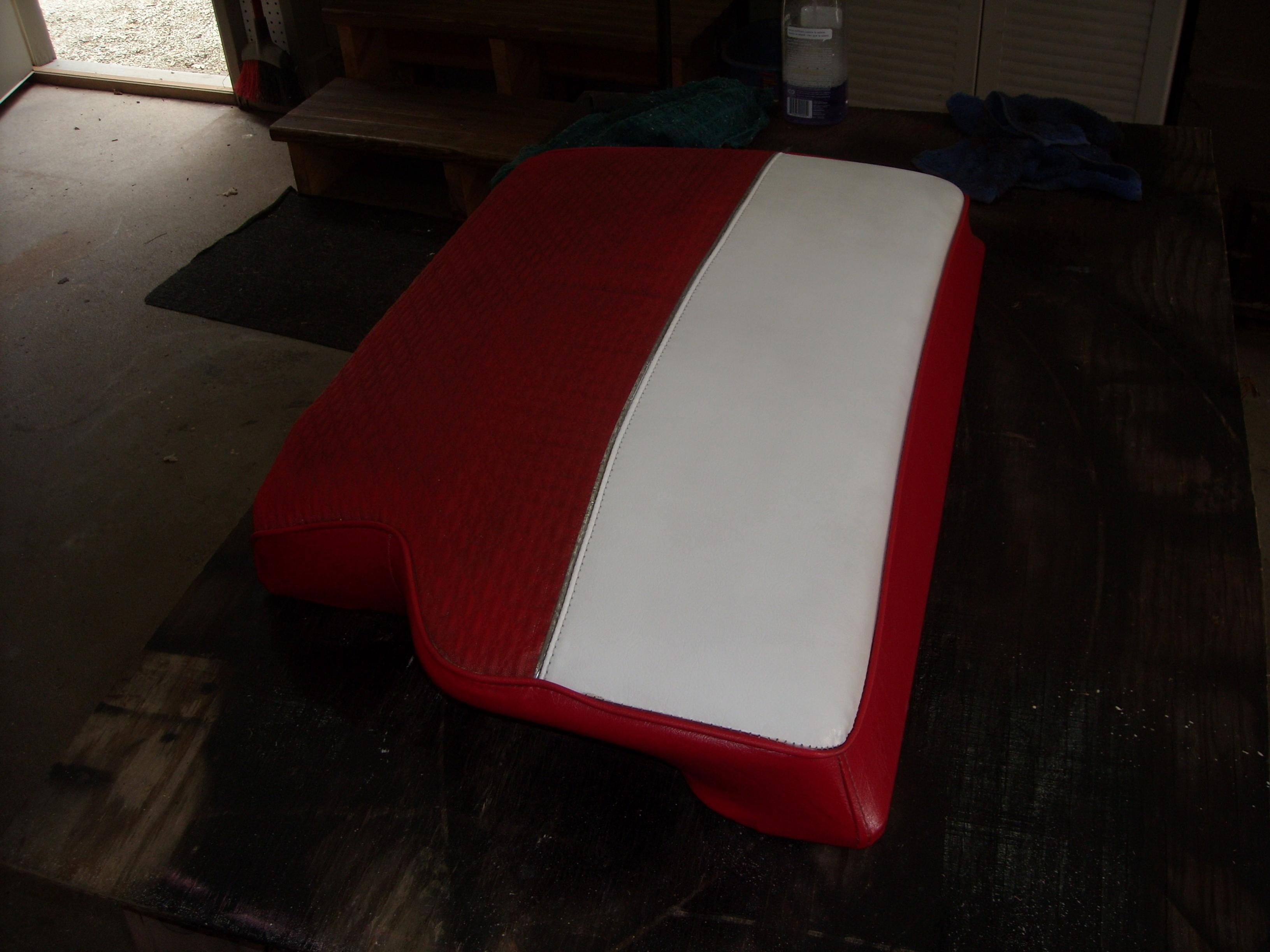

    Here is one of the middle seats that I cleaned and sprayed with fabric paint.
    This is the 1st time I have used the fabric paint, But I believe I am hooked.:)
    It may not be perfect, but a heck of a lot better than what I had, and will work for now.
    Here it is after I removed the cover it had on it,
    And after cleaning,
    And after painting.

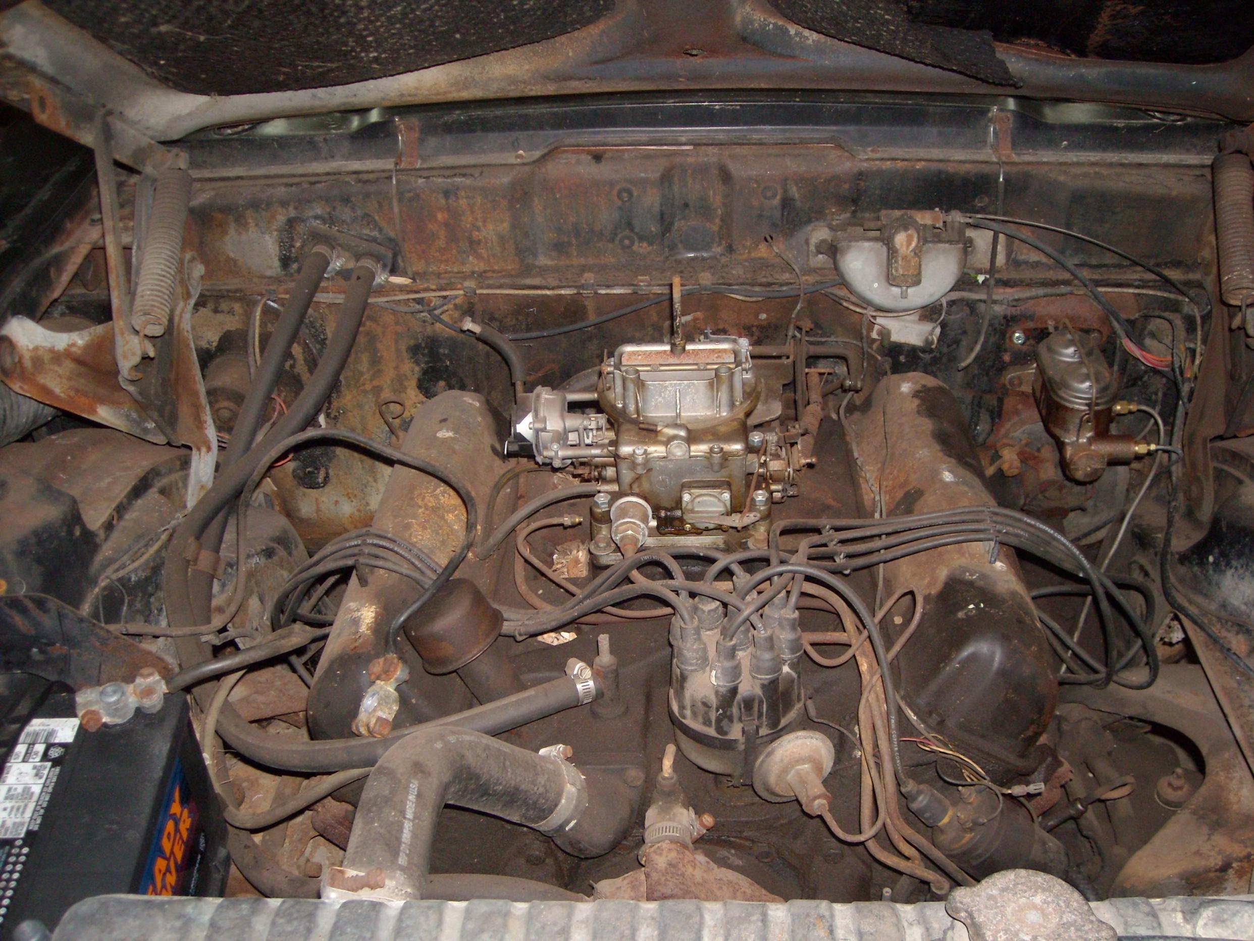

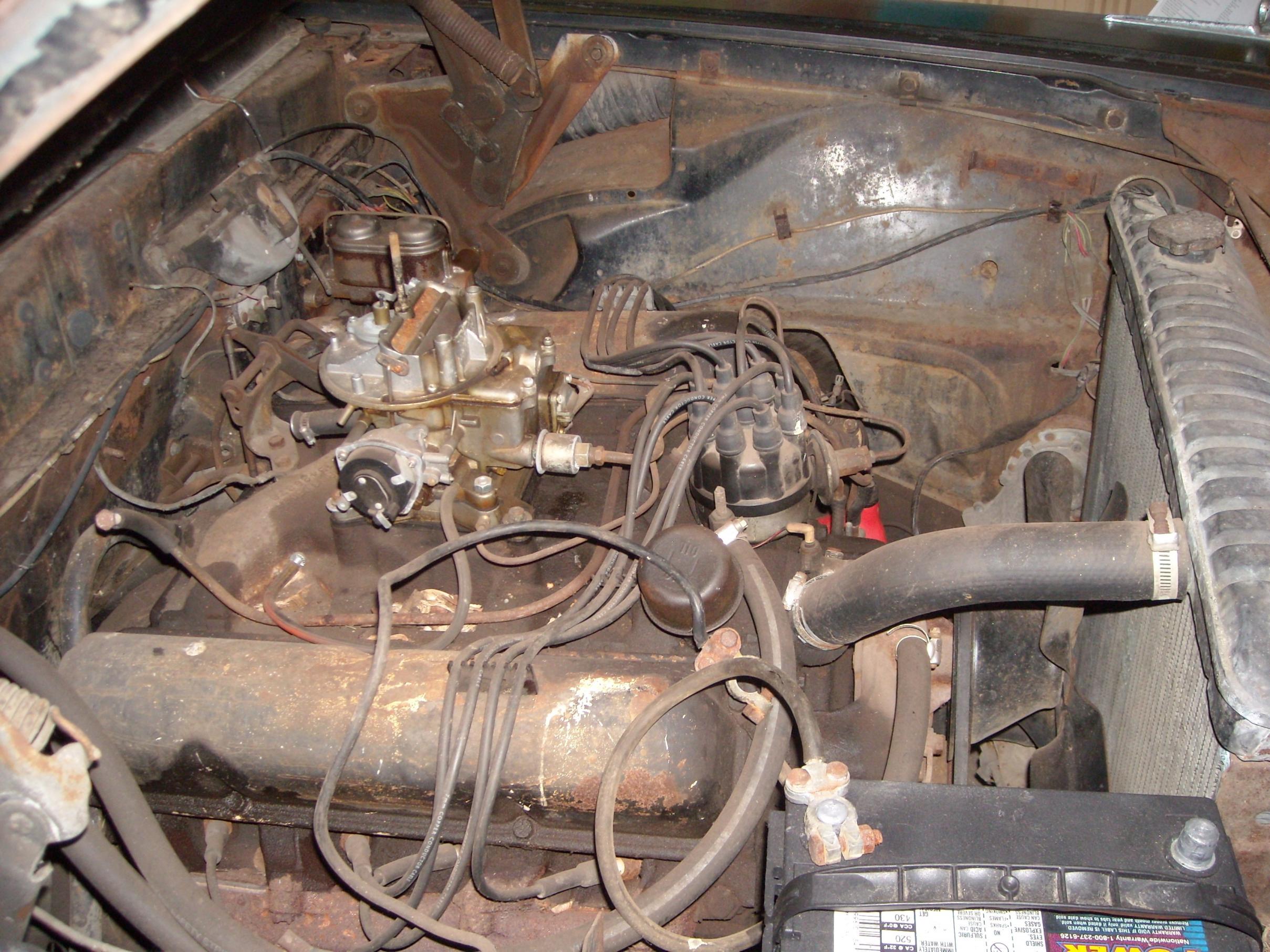

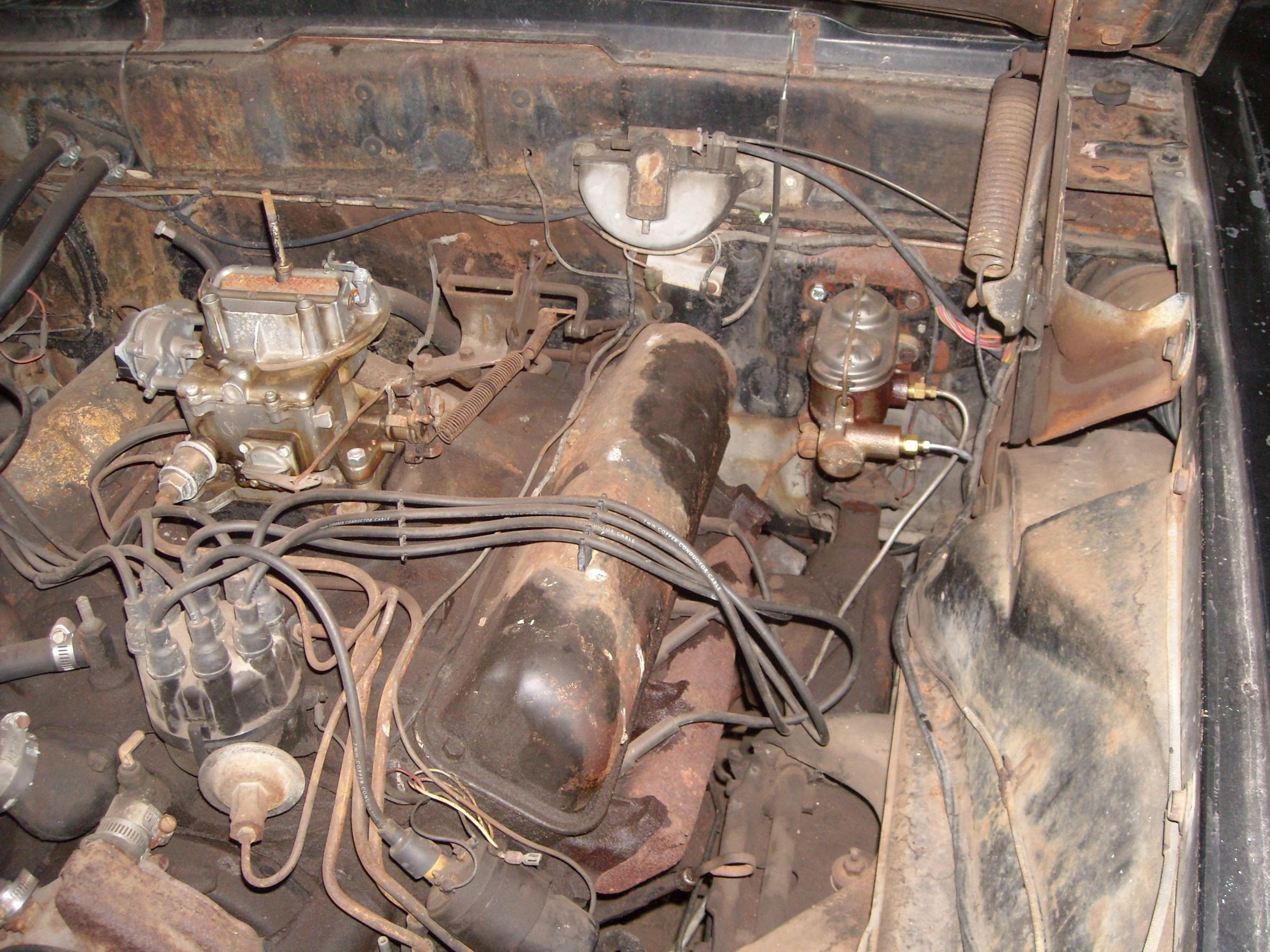

    Im gonna pull the motor first thing this year. There is a freeze plug leaking right behind the p***enger motor mount, so I will replace the water pump, oil pump,maybe timing chain, lifters, and all gaskets.
    I also plan on having the trans gone through while its all out.
    Actually all this stuff seems ok, but from the amount of gunk on everything it has never been apart. So being over 50 years old, I figure it needs going through.
    Here is the crusty engine bay.
  12. fireman 55

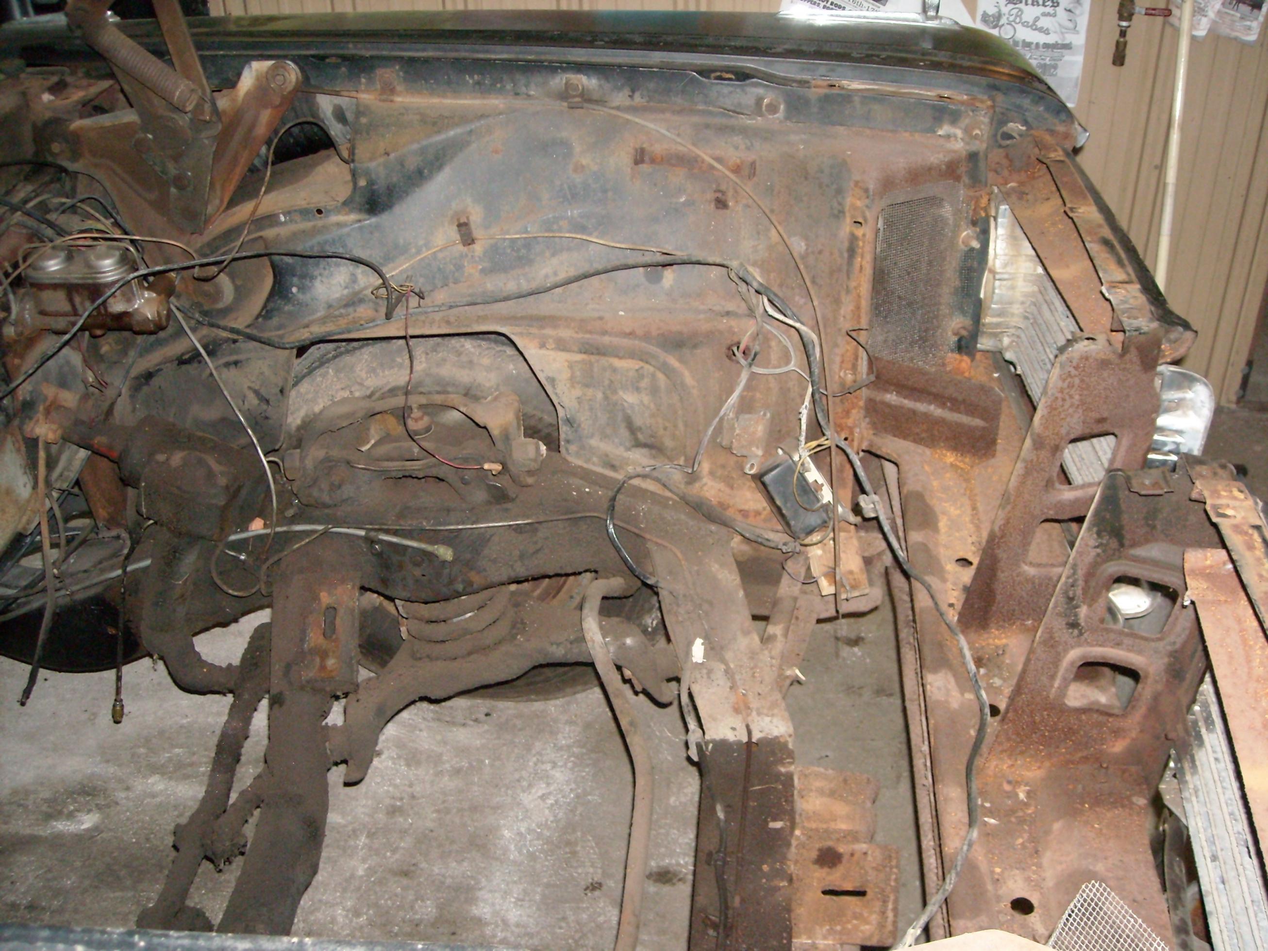

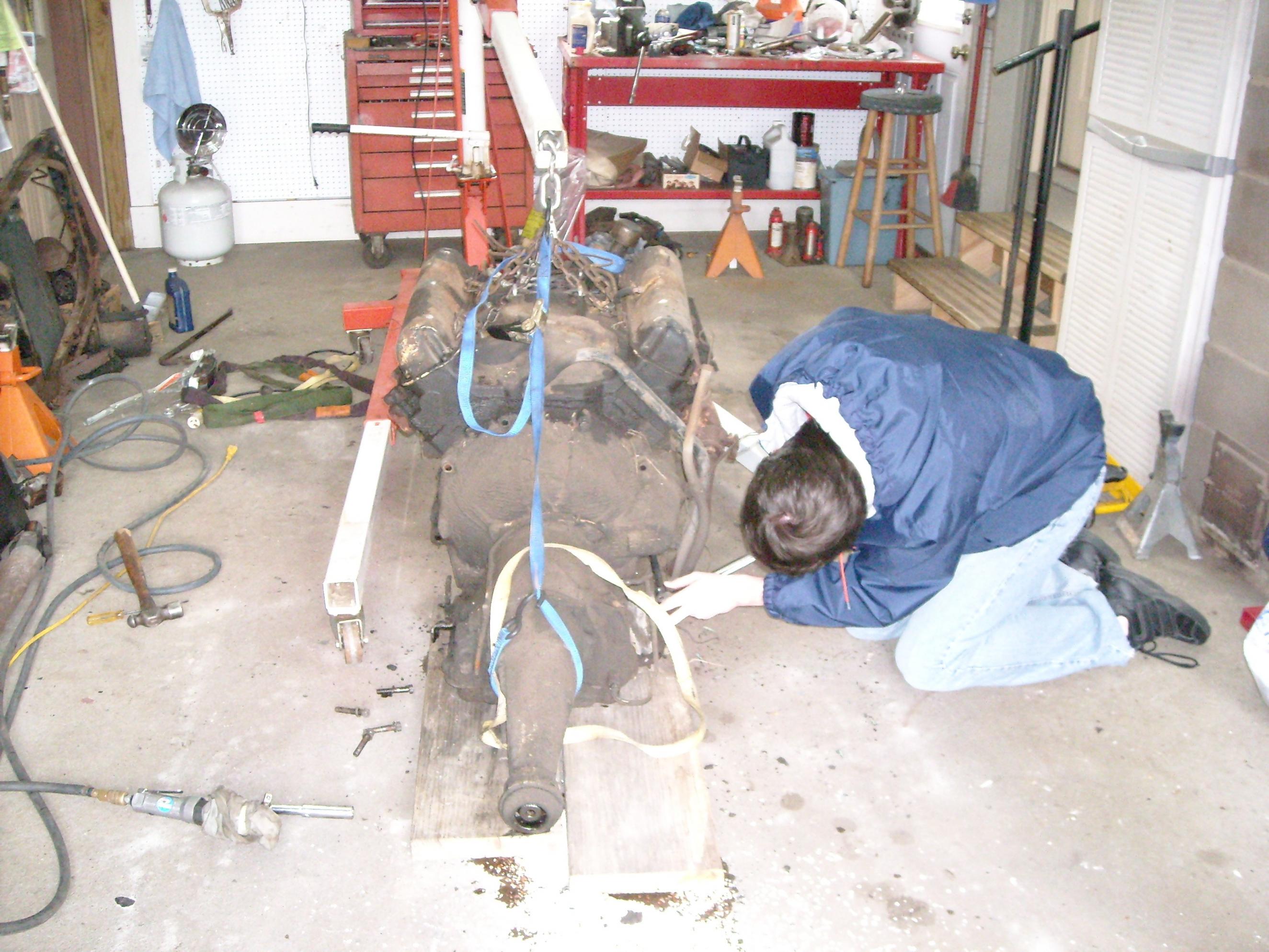

    Had a good weekend in the garage. I got the engine and trans pulled today.
    My son was home from college this weekend and dad stopped by about the time we needed to shove the car in and out of the garage.
    here he is working on seperating the trans from the block.
    Here is the gaping hole. I left the trans crossmember in when removing, but it will sure come out when it goes back.
    I also removed the core support. It needed repaired on the bottom anyway, and it gave me plenty of room to pull the motor and trans.

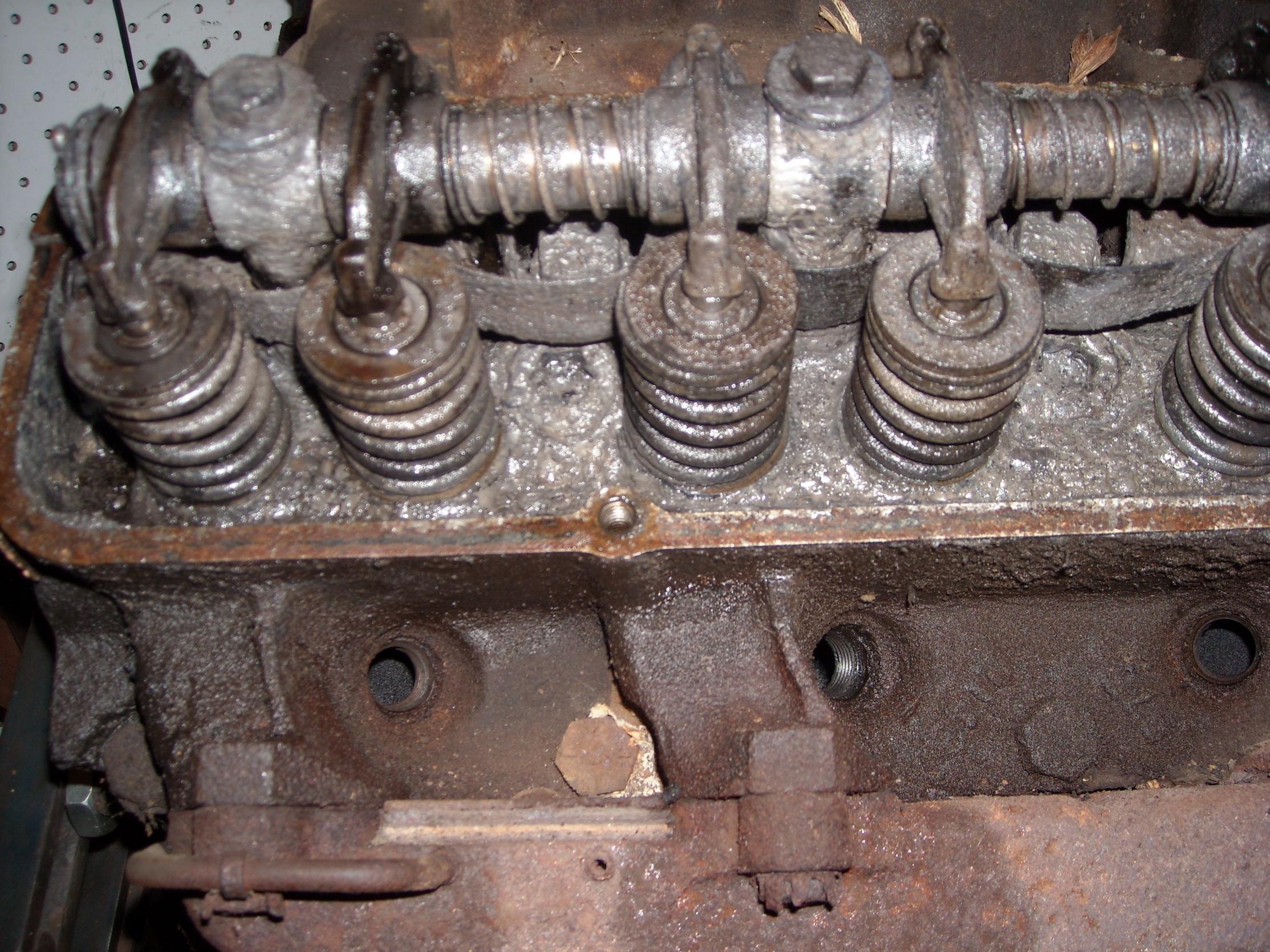

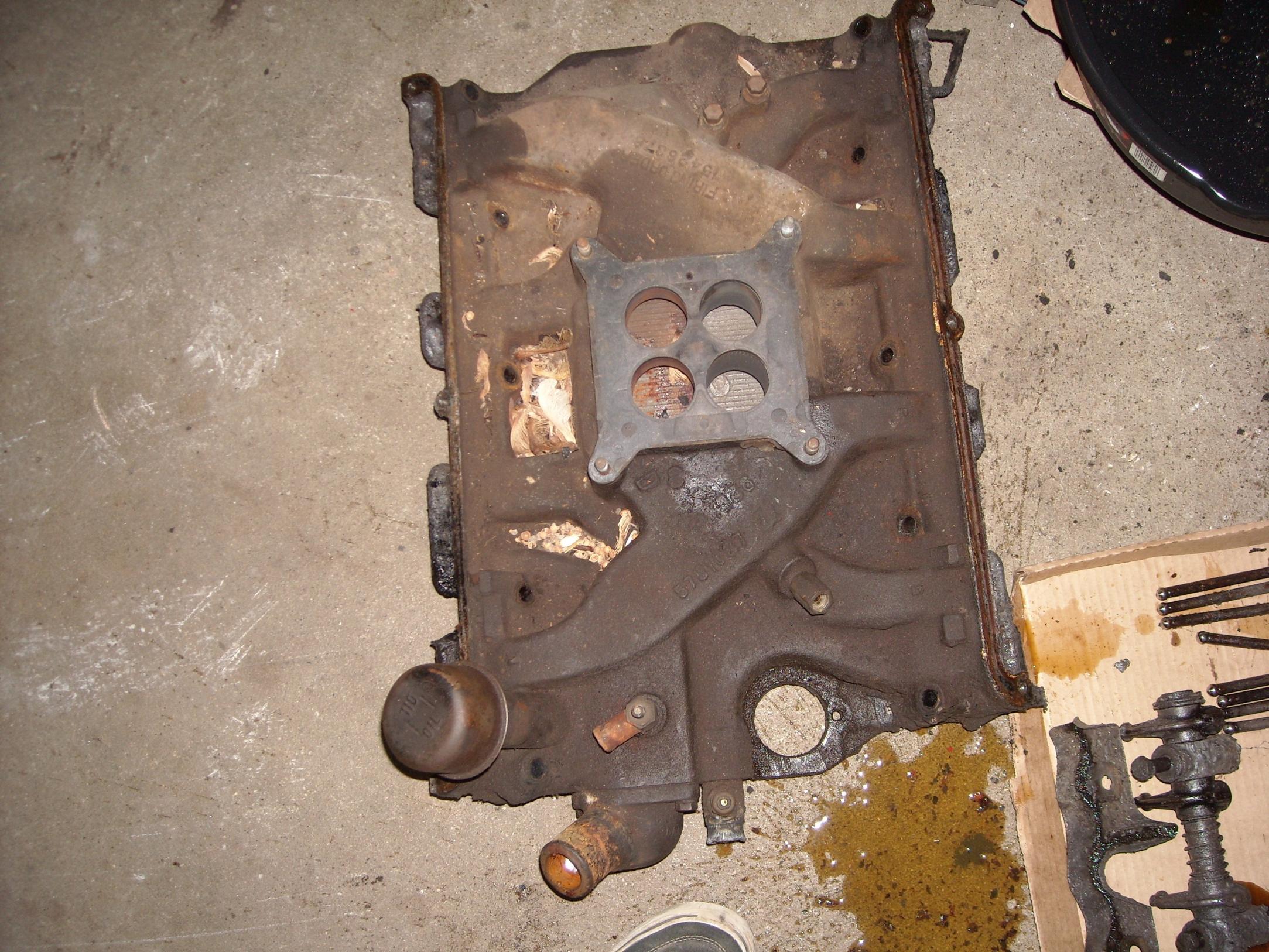

    I decided to go ahead and tear it down to see what ive got.
    Here is the dirty ol gal on the stand.
    It looks like 1959 gunk.
    I found 2 bent pushrods.
    They are laid out like they came out. I had one on each bank. I really didnt notice a miss when it was running, but really didnt get it much past idle in the driveway. The intake was really heavy. I remember someone saying that they used a engine crane to lift theirs.:D

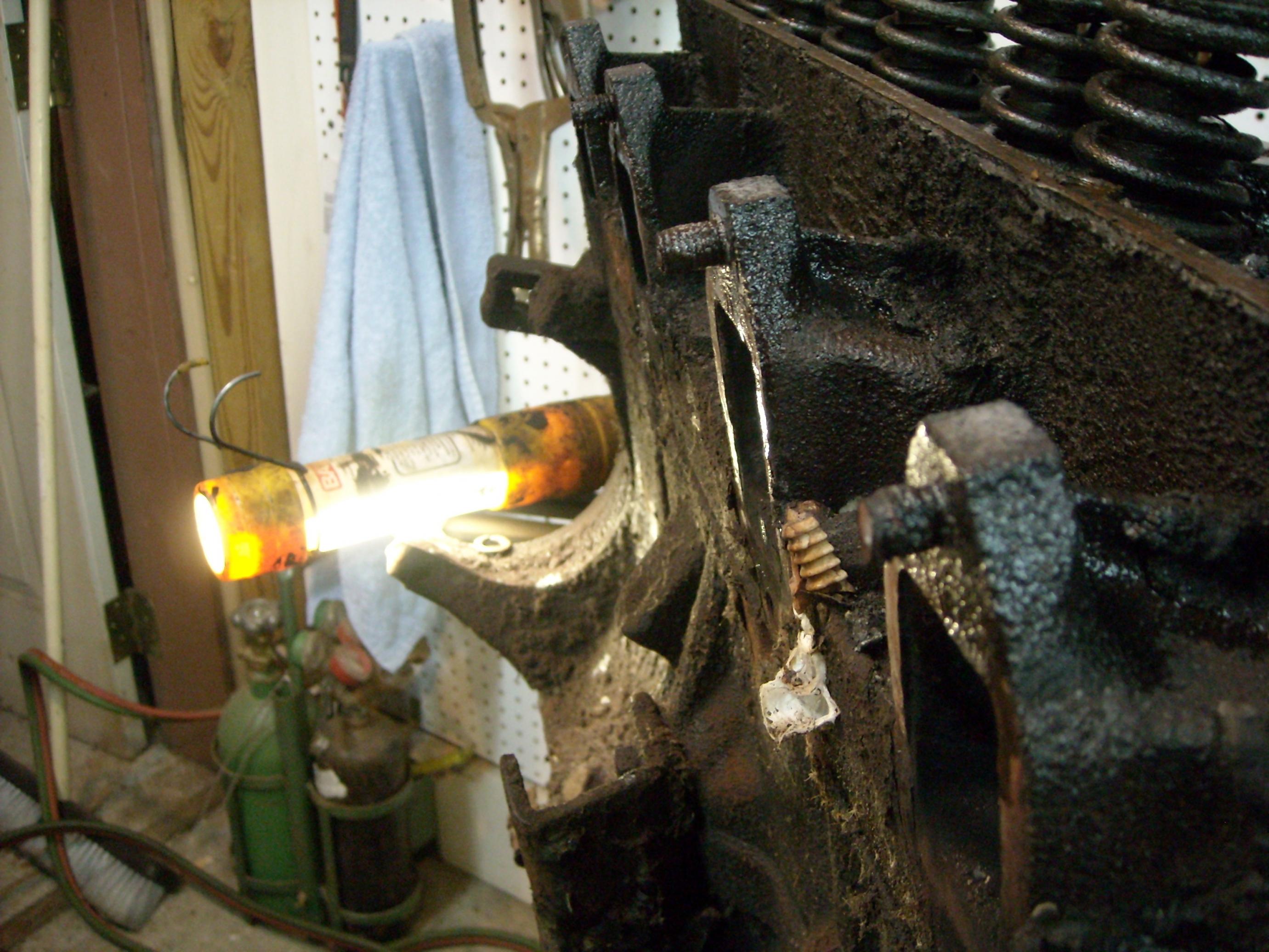

    Well here is the part i was dreading. I have 4 broke bolts in the upper side of the exhaust manifold.:eek:
    Tomorrow I will try and heat the head, and grab what is left of the stud with a pipe wrench and get them out. I sure hope it works.
    One stud is is broke flush, so i ***ume I will drill it out and re-tap it, unless someone has a better idea.:confused:
    also, this is 4 out of 4 broke. I still need to do the other side.

    On the bolts, try penatrating oil. I love KROIL. It creaps. Before you try wrenching, rap the heads of the bolts with a hammer like you are driving them in. Try to wrench. If no luck, use the blue wrench (torch) again along with more raps of the hammer. What you are doing is trying to slightly stretch the threads. On the flush broke offs, no other choice is to drill them out. Harbor Freight has left handed drill bits that gives you added help. I though have not had much luck with east outs. If you can put the head on a drill press that will really help in drilling a straight down hole. If you booger up the threads, no big deal. Thats what they make Heli-coil inserts for. Pricey but worth it. Good luck.

    Today didnt go any better. I tried to heat the head on the broken ones and back them out with a pipe wrench, but the studs just twisted off.:(
    I tried to change how I did the other head, and got 1 out ok, but the other 3 twisted off, and I had a bottom bolt break off in the head.:(:(
    But the motor is down to a short block. I believe I am taking the heads to a machine shop so they can drill it good and straight, then re-tap the holes. If i just had a couple to do I might drill it by hand myself, but I think its better to have a shop do it.
    I also read where its a good idea to have the exhaust side shaved for a good fit, so might have that done also.
