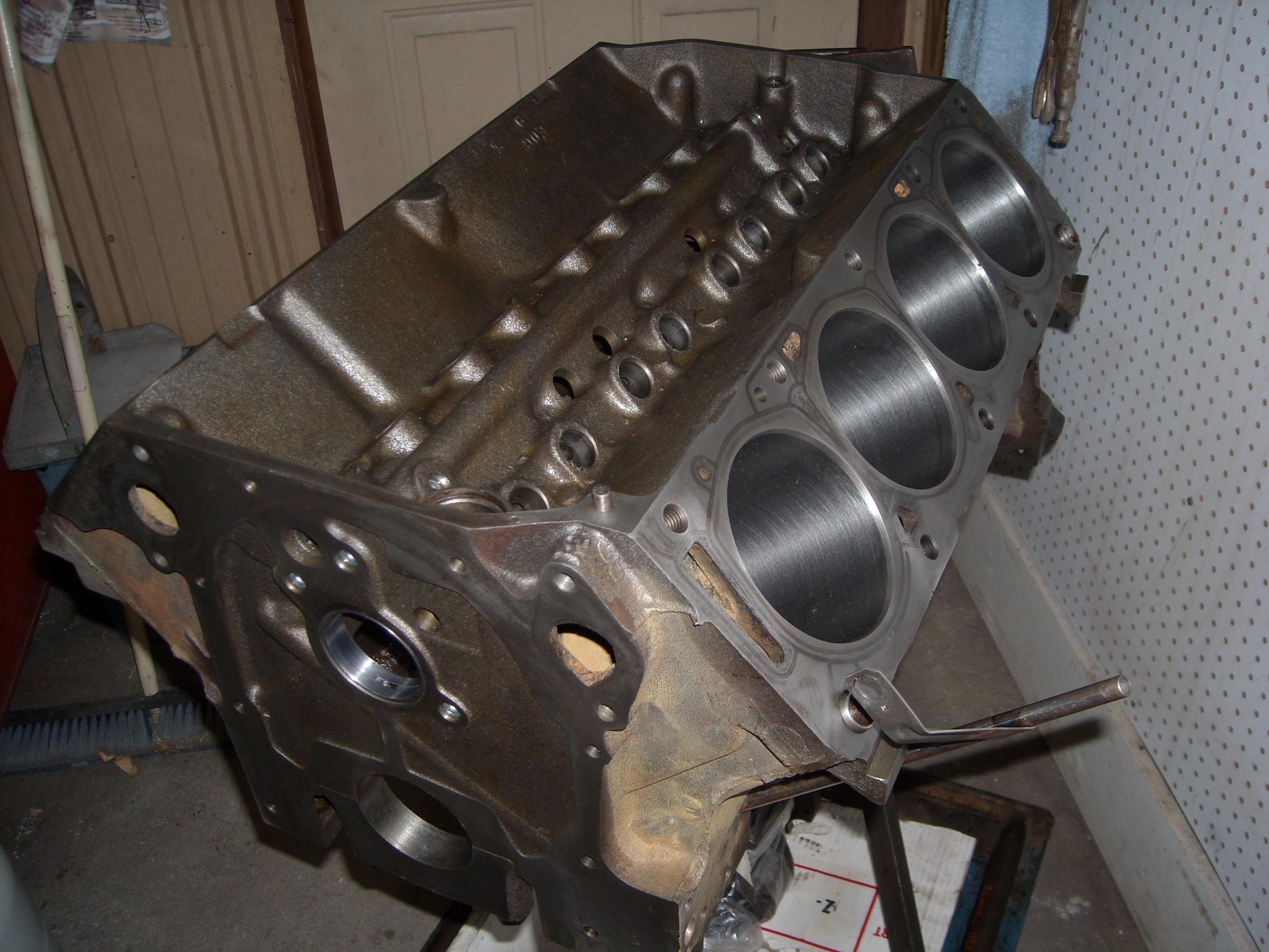

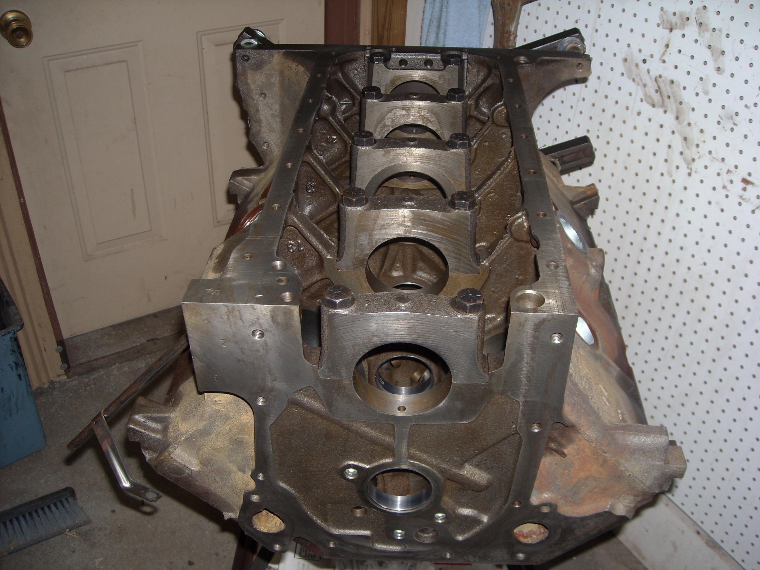

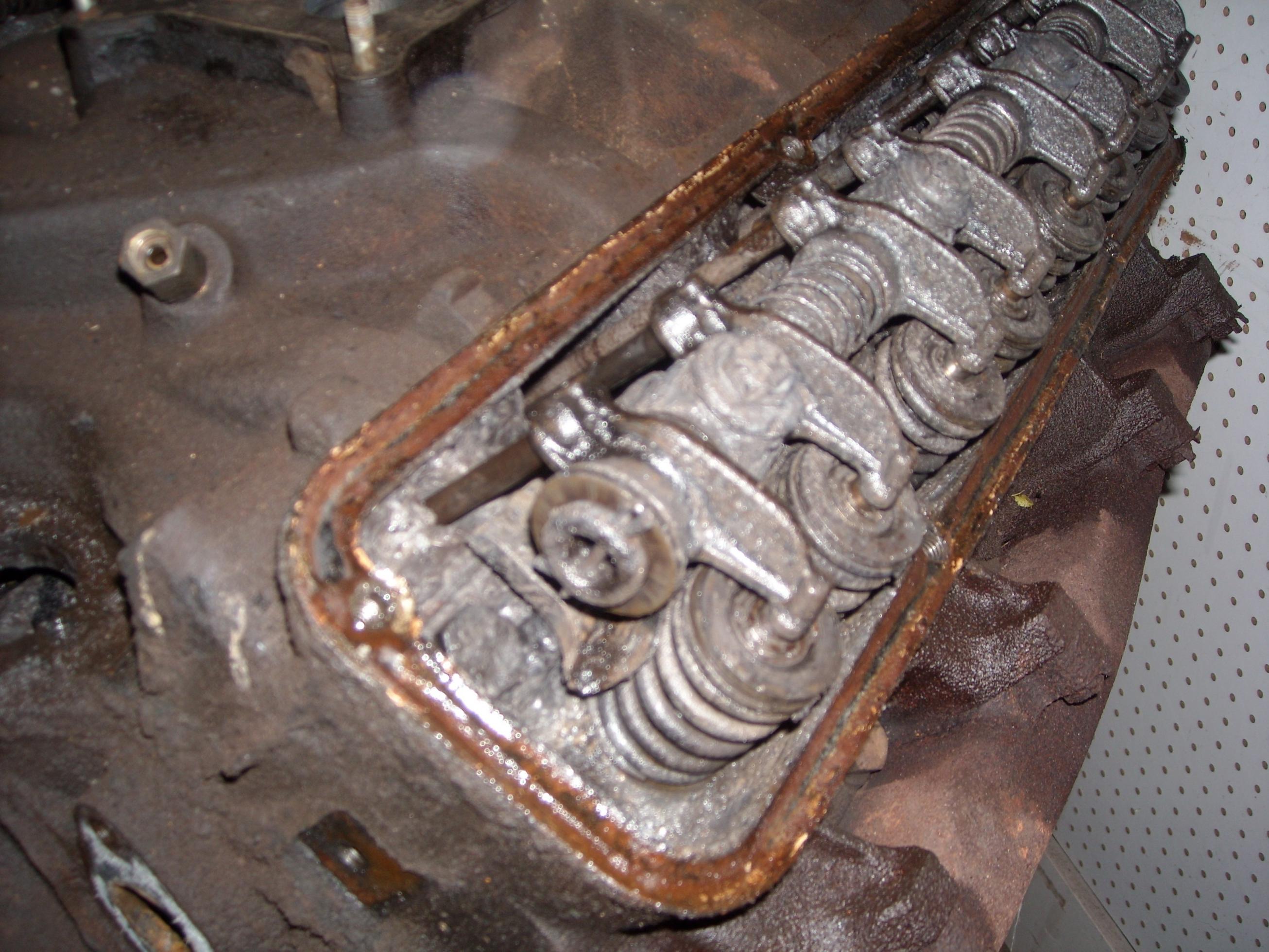

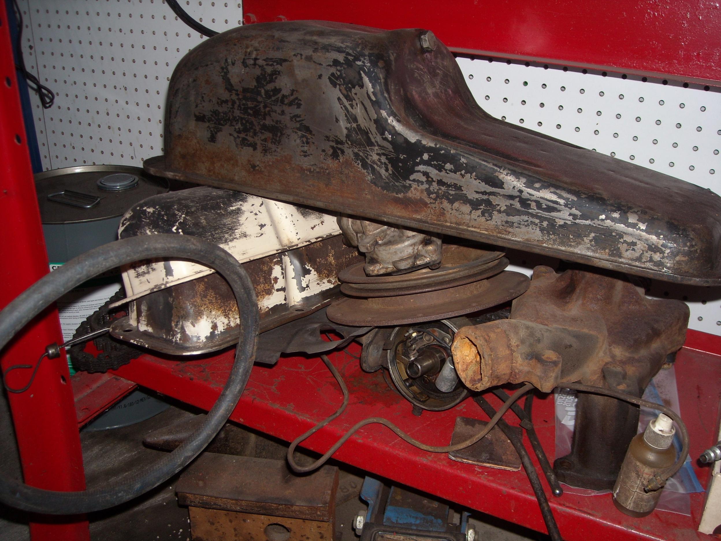

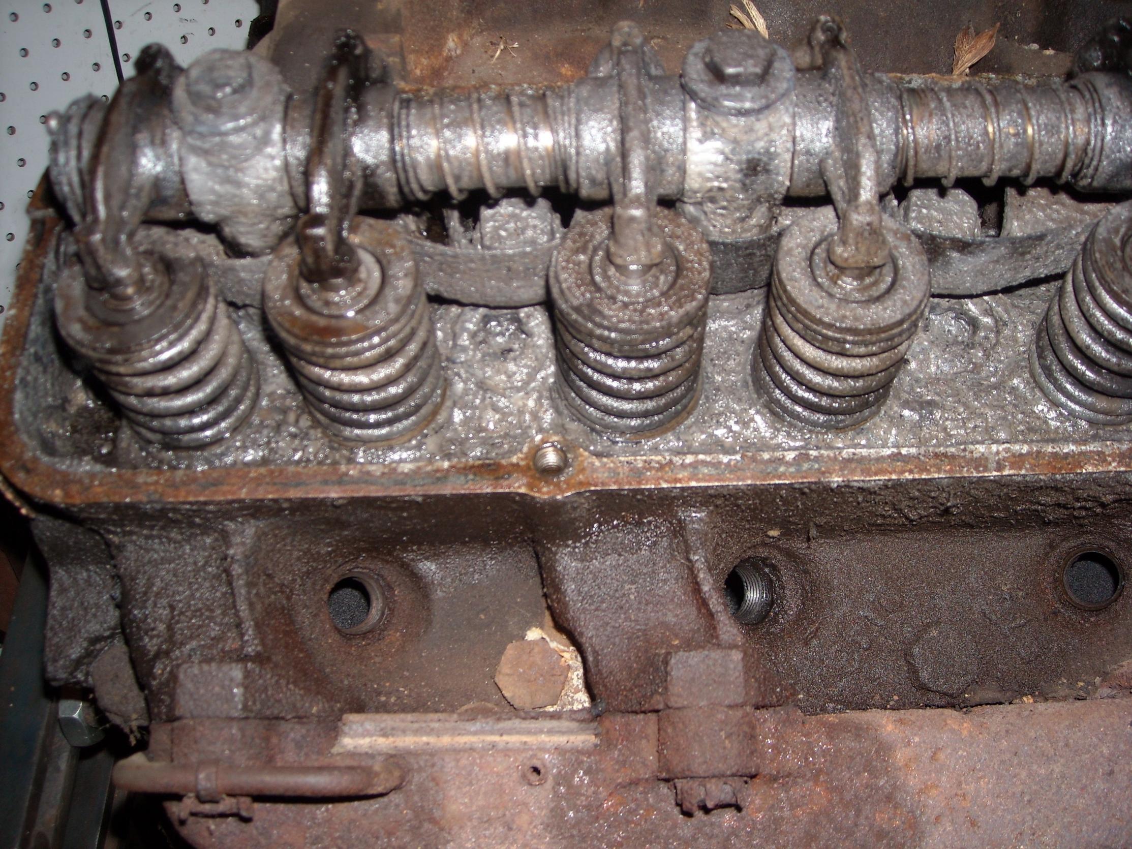

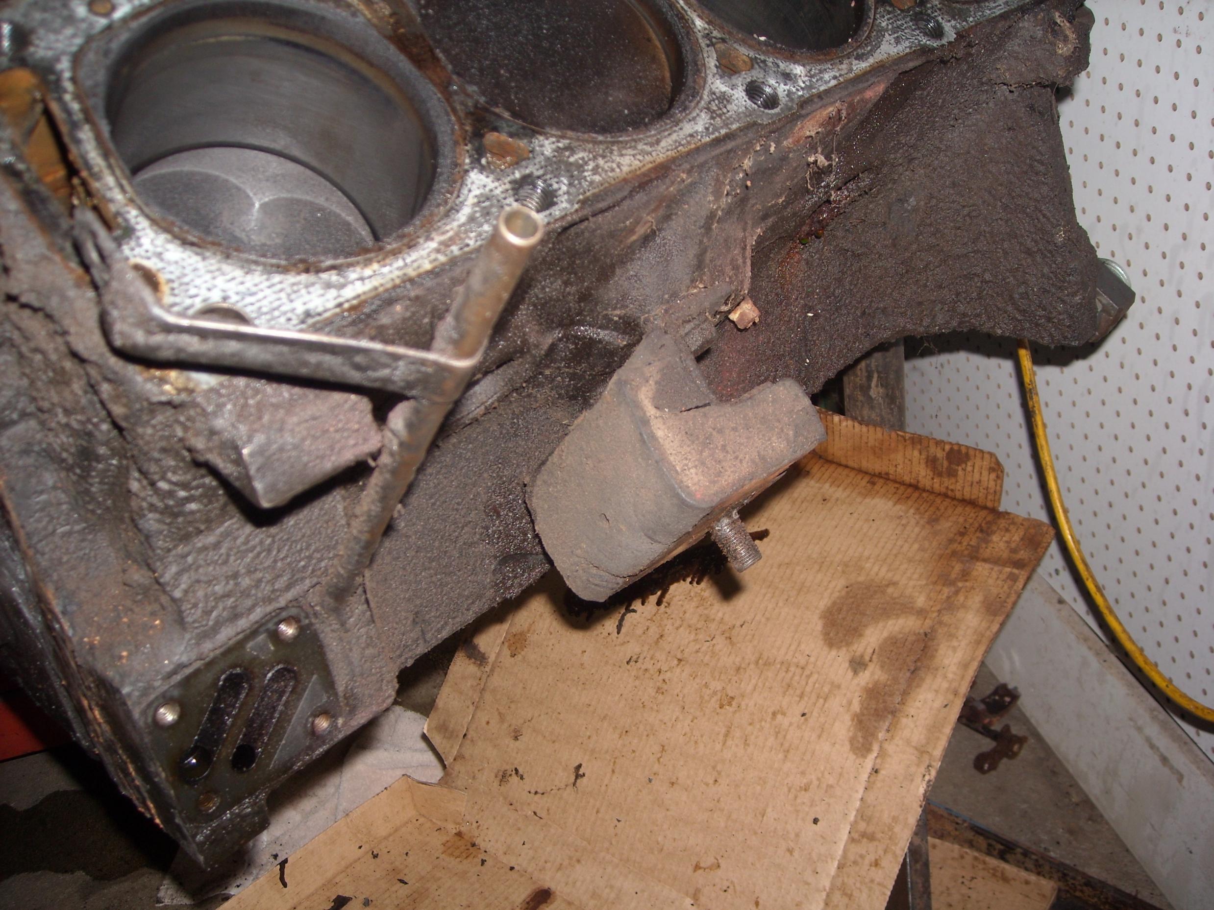

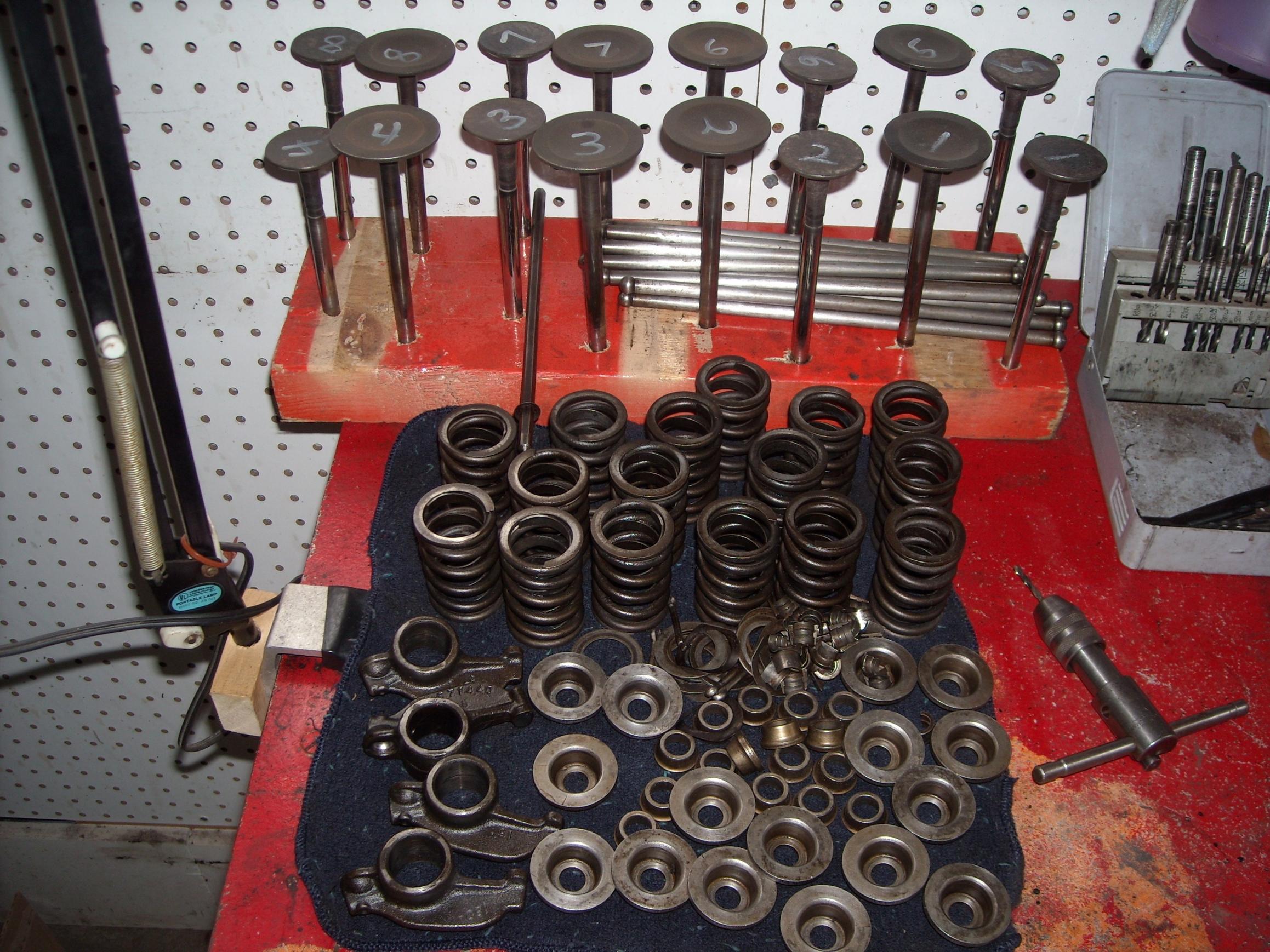

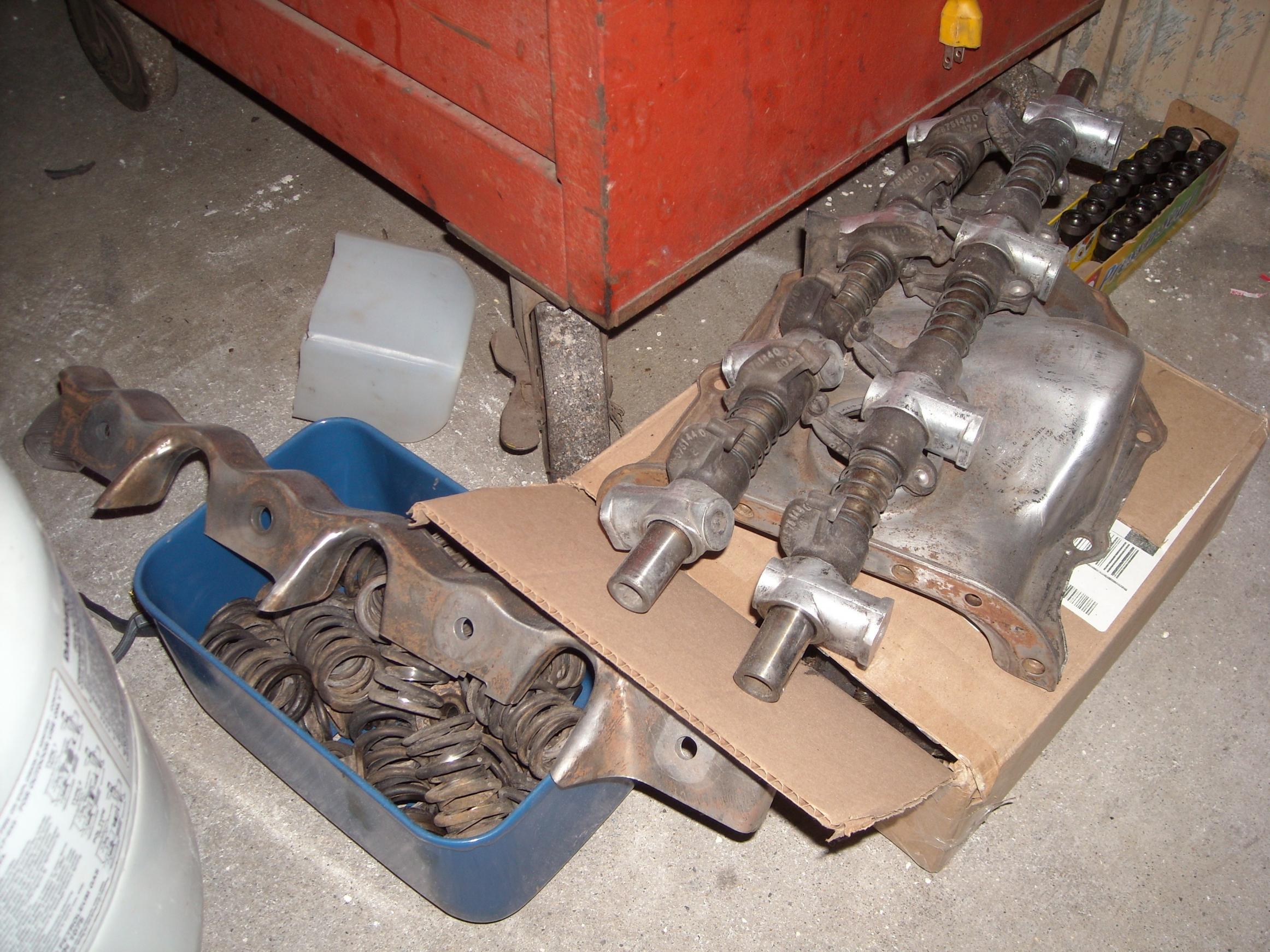

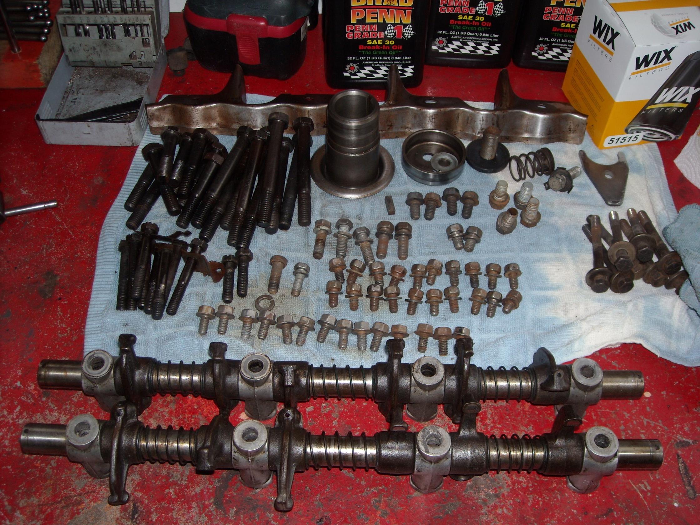

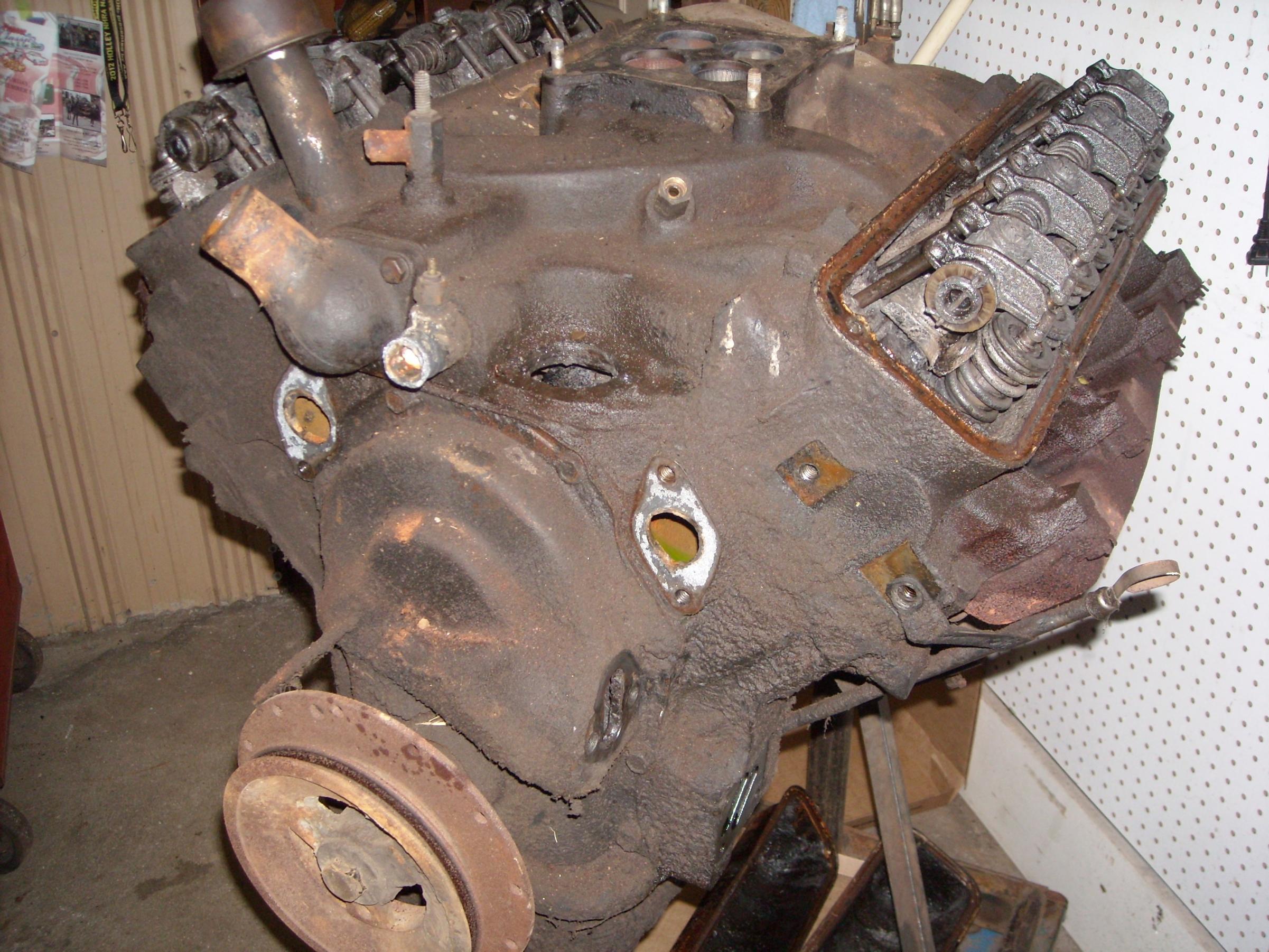

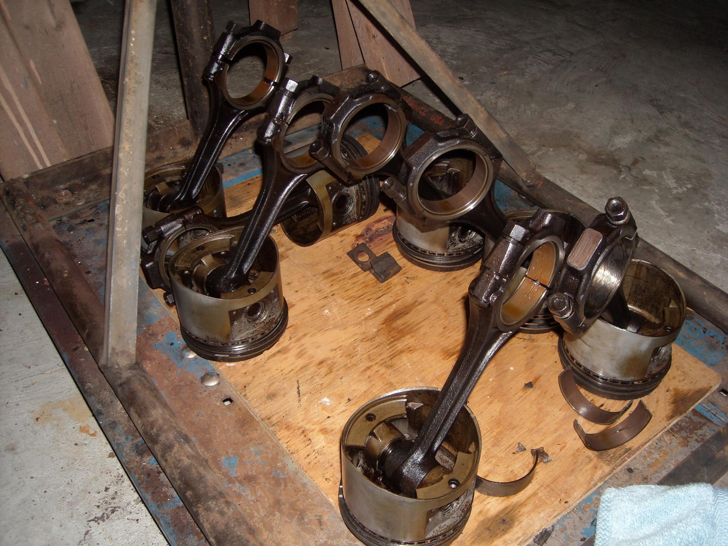

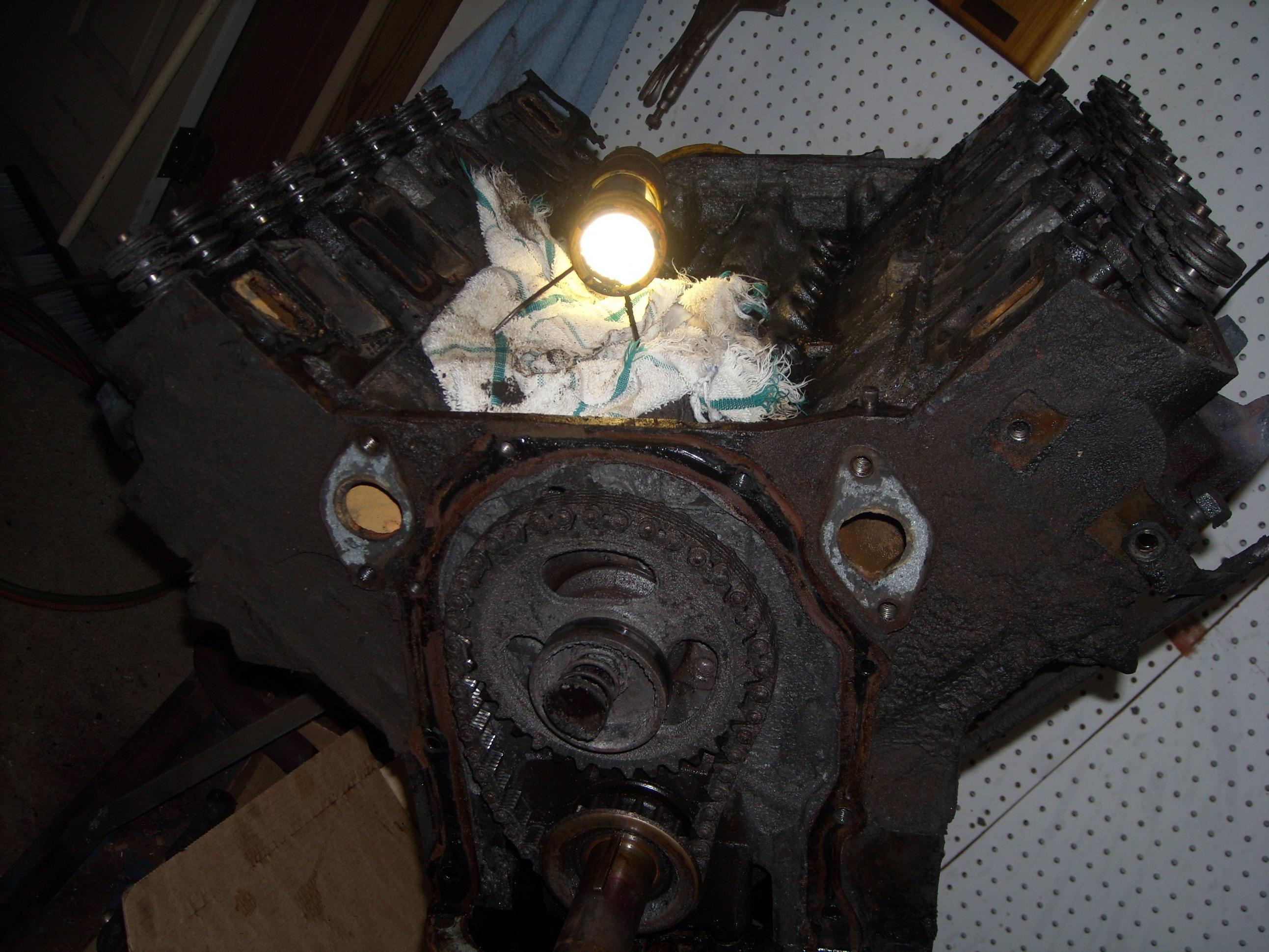

    The latest update.
    These are some pics during teardown.
    I have the block back, and most parts have been cleaned. I will update more as I start the re-***embly.

    First I want brag on my progress. Not on the motor, but this weekend I ran a 6" duct from the house furnace, out to the garage.:D
    With this cold weather it doesn't completely warm it, but it keeps it warm enough that my other heaters dont have to do much.
    My wife ask if it was going to heat all the time.
    I said no.:rolleyes:
    Thinking to myself, in the summer it will blow cool air.:D:D:D:D
    Here are all the parts ready for ***embly. I got the cam in today, and hopefully tomorrow get the crank, then start on the pistons.
