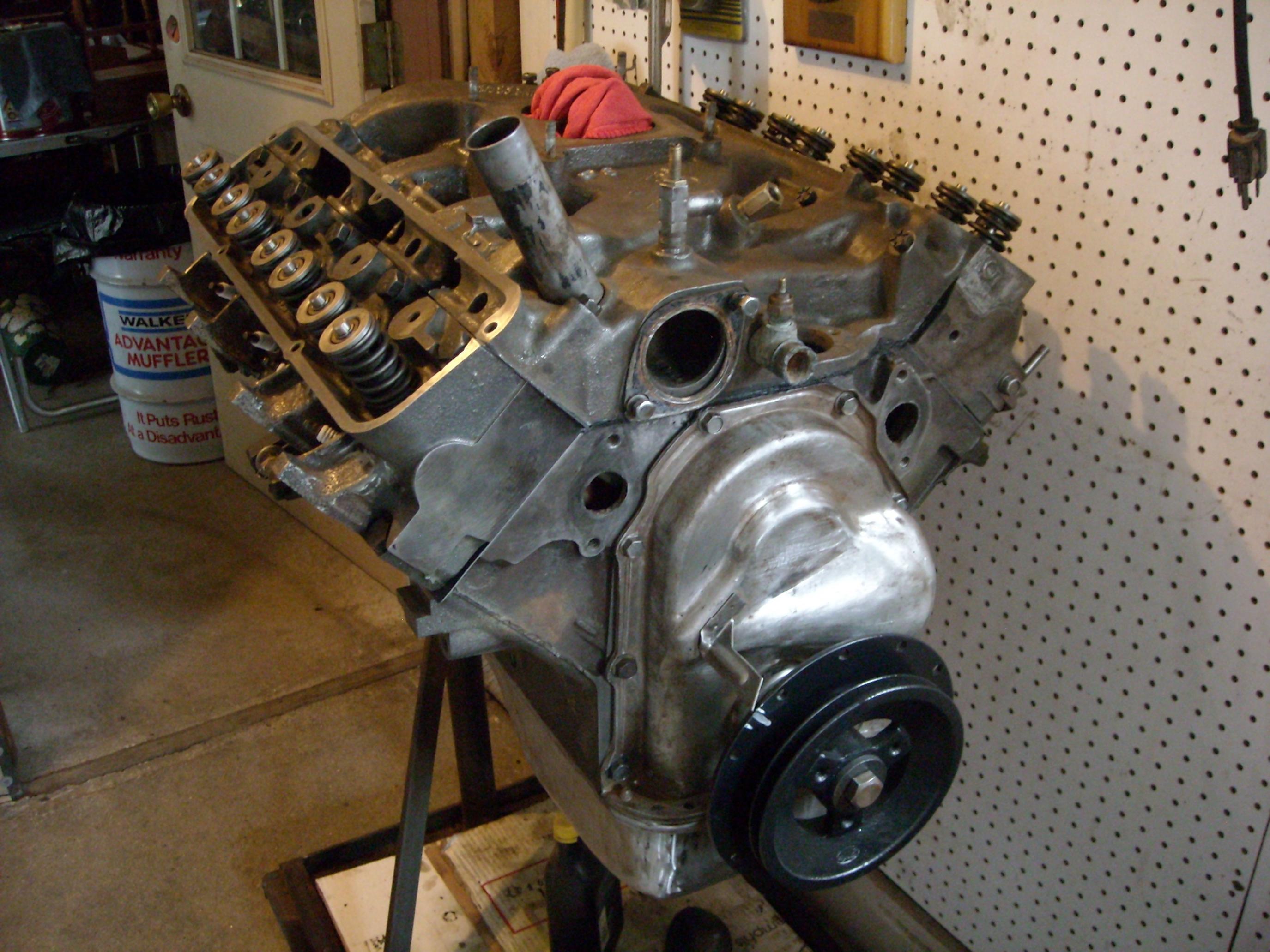

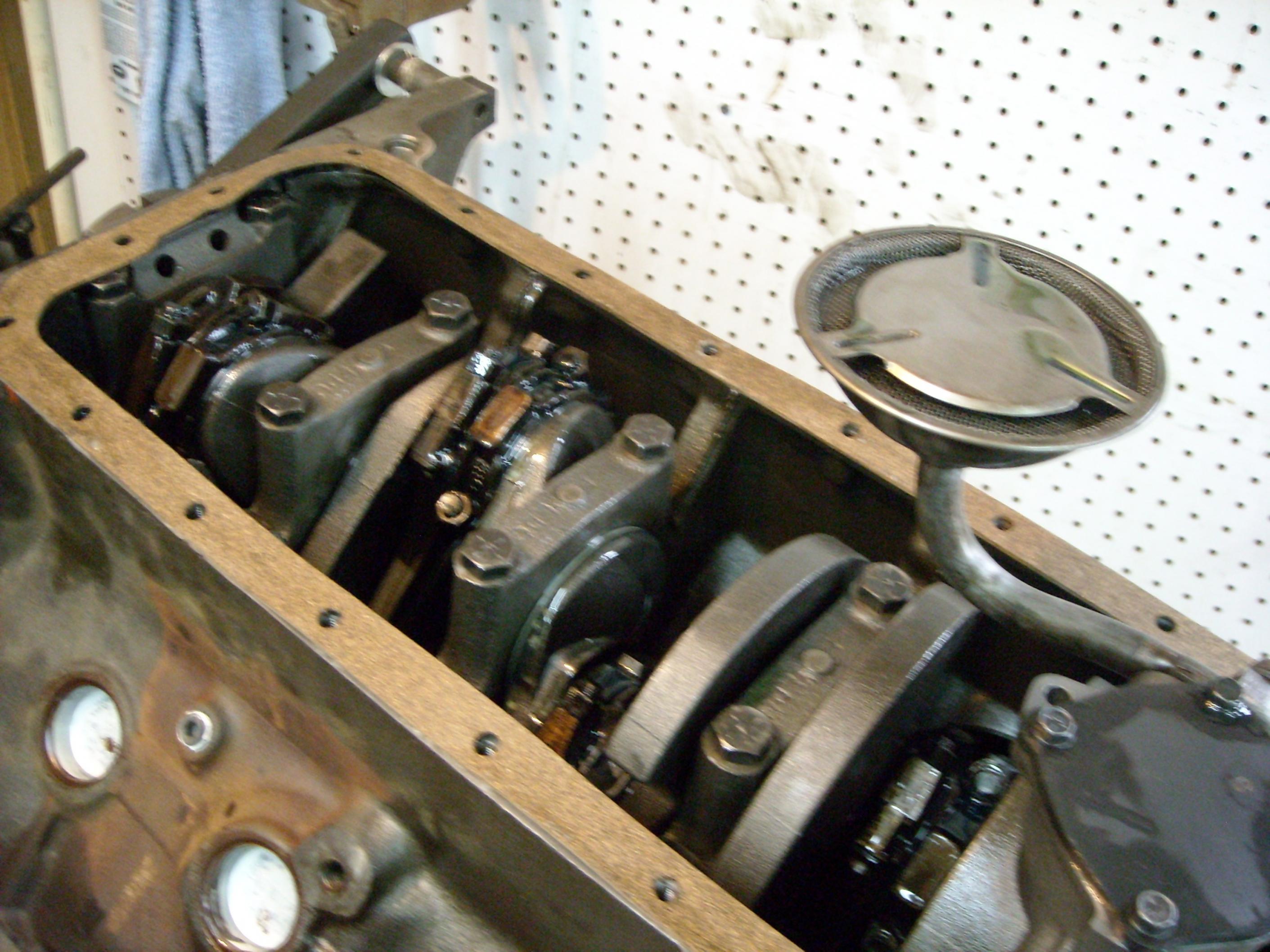

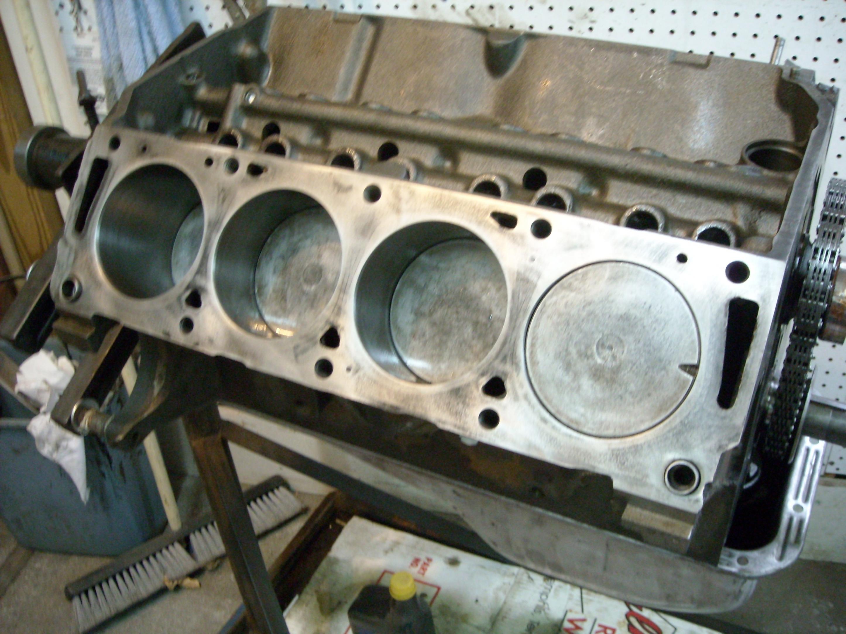

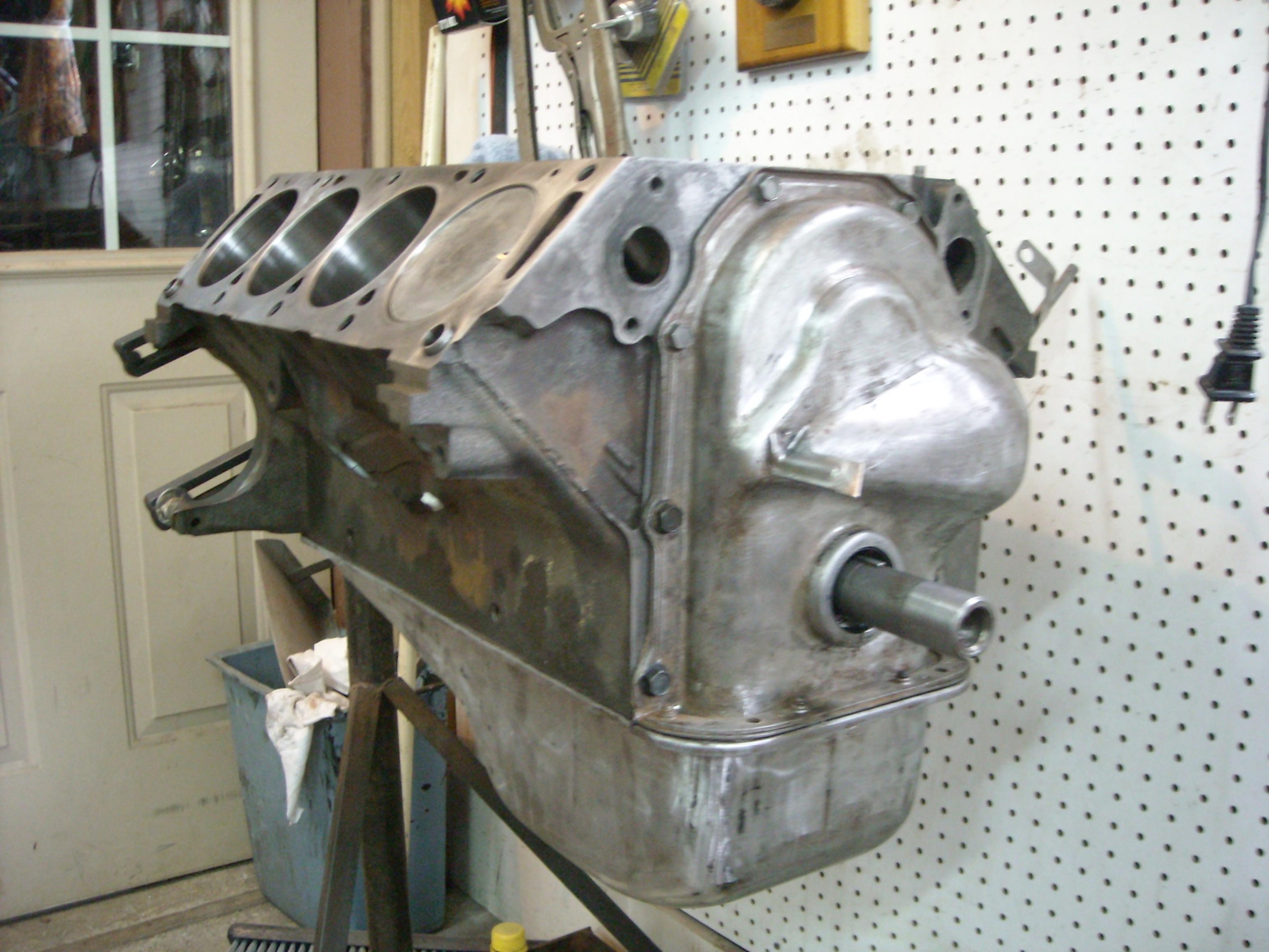

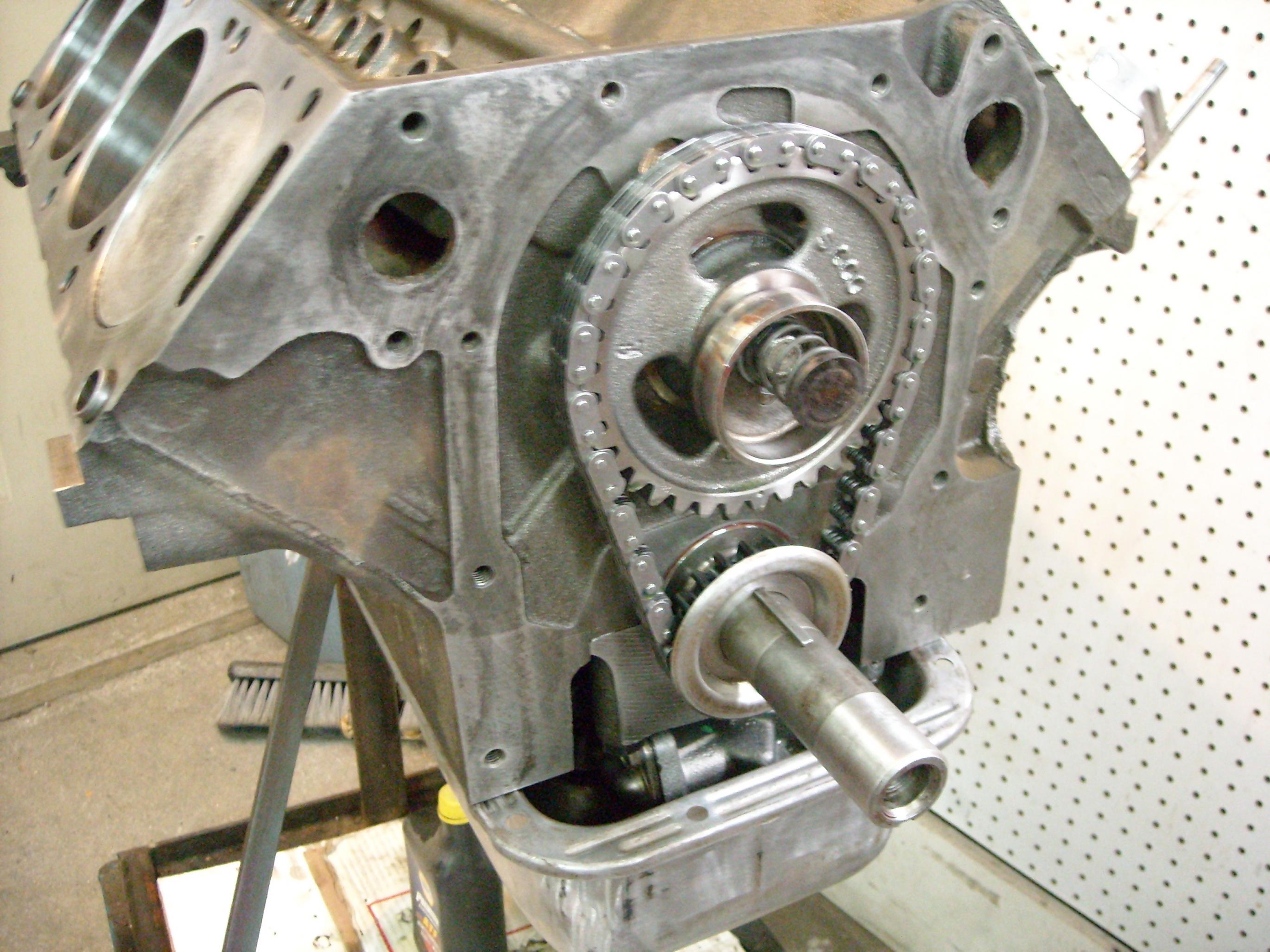

    I finally got the short block ***embled.:)
    I plasti-guaged all bearings, checked ring end gaps, and ring side gaps in pistons. Coated all bearings with ***embly lube, and coated the cylinder walls, and pistons with the break in oil from Brad Penn.
    The timing chain ,oil pump, are in, and the oil pan and timing cover are on.
    I put a repair sleeve on the snout that goes through the front timing seal because it had a groove in it where the seal rides.
    Now I am finishing the heads. I am lapping the valves and hoping that does ok. I know a complete head job would be better, but im thinking it will be fine.
    THings are getting a little pricey:eek:
    I am only posting this so other people might know what they are getting into with a simular project.
    Block cleaned and checked, crank turned 10-10, new cam, bearings, and rings, and exhaust surface milled on heads. $1000.00
    Transmission rebuilt. $1000.00
    New radiator. $500.00
    I am getting most all my other motor parts from my sister in laws parts store, and I get a good price;), and I have a tab going, so I really dont have a total yet on everything else.
    This project has been a major job, time wise, and money wise, but as you guys know, thats just part of it.:)

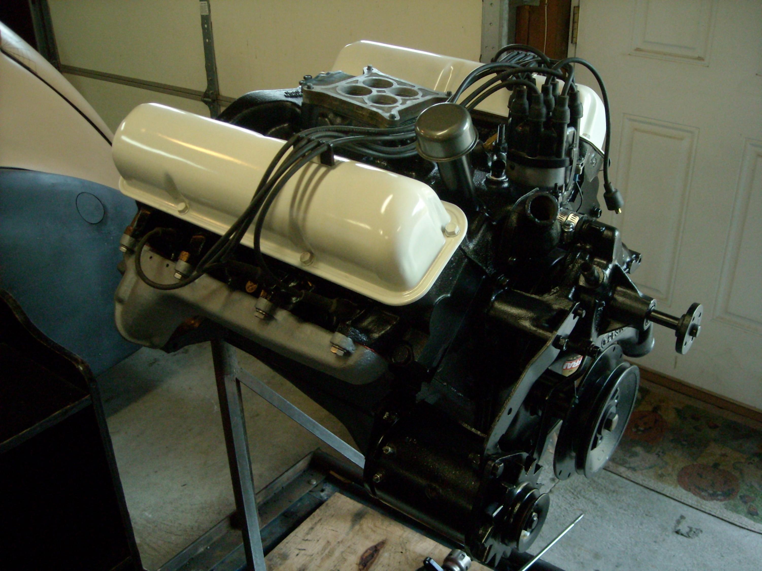

    I have the engine ***embled enough for paint.
    I want your opinions,:rolleyes::rolleyes:
    Im thinking black on the color. Thats what came factory and I cant come up with anything else that I think would look right.
    I was thinking maybe satin, or semi-gloss on the block, so the pulleys and fan and generator could be a gloss color for a little contrast.
    Or should I just paint the block gloss black also?
    Im thinking also the valve covers and air cleaner the cream color that came stock. Or maybe since some day I want to do the roof metal flake red, then I might paint the valve covers and air cleaner metal flake red.:rolleyes:
    Tell me your opinions. Thanks.

    I think black and satin are good, I would use glossy paint if you think you can keep it clean :)
    Make sure you use real engine paint, do a couple of coats..

    So is this an FE block? Looks like it with the intake manifold under the valve cover. I thought the 361 was an industrial version of the 360, with low compression for delivery trucks etc, no?

    Yes its an FE. I think its rated at 303 hp, and 9.6? compression from the factory in 59.
    Its a shorter stroke than the 390, with the same bore.

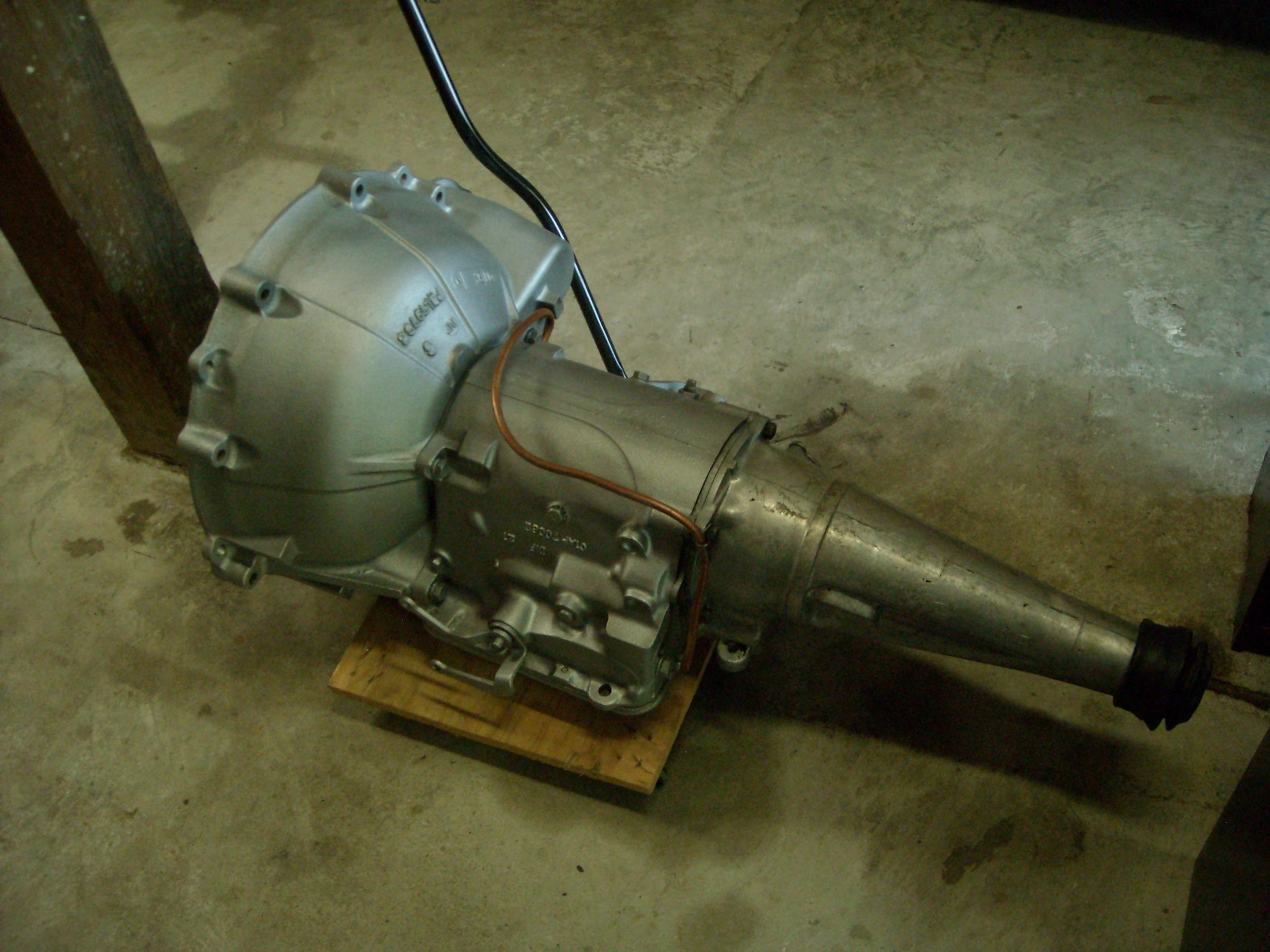

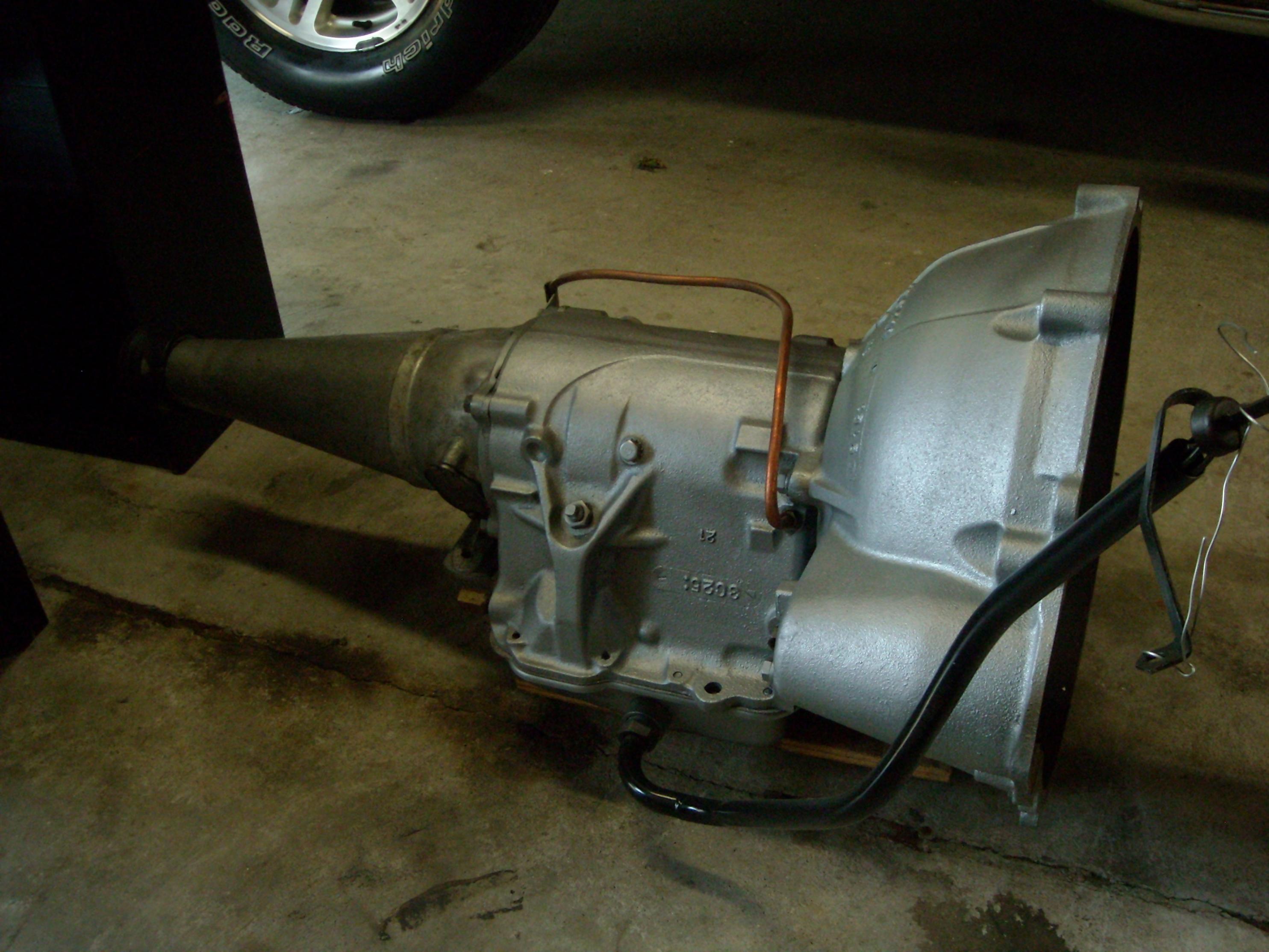

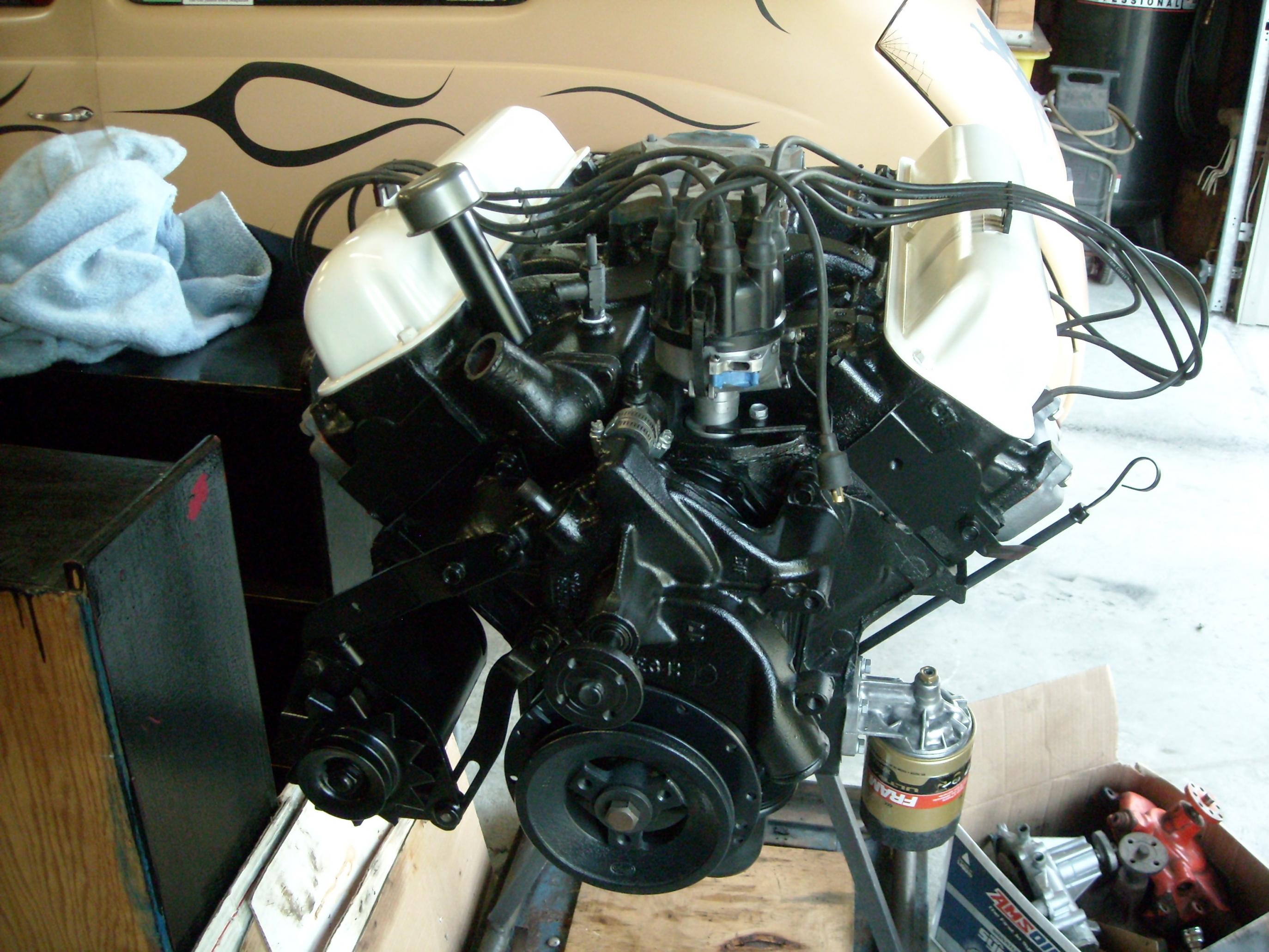

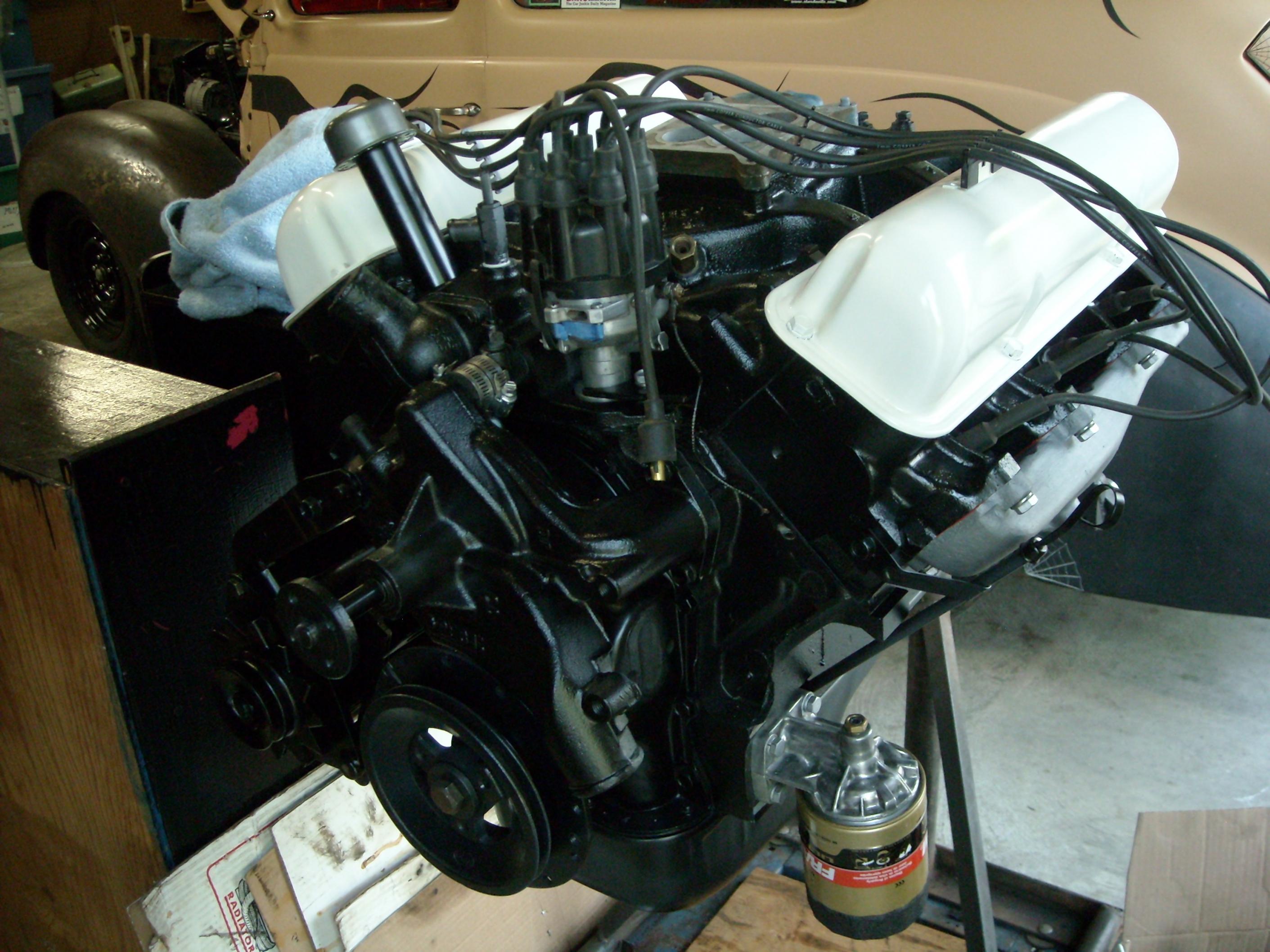

    Its been a little slow going, but here is my progress. The engine is pretty much finished. There are still a few small details, but there always are.:)
    The trans is also rebuilt and ready to go.
    Next on the list is the engine bay.:eek: But heck, after what ive done on this car, there isnt much to be scared of.:D

    I recognize that transmission! 100% sure that is a Dual Range Cruise-O-Matic. See my rebuild thread as to how you can tell. I have an identical one in my 63 Mercury Monterey.
    Do you know if it was good before rebuilt? Who rebuilt it? Any issues found on the rebuild? I've learned way more than I ever wanted to know about the Crusie-O-Matic. Interesting design for sure. Interested in hearing how the rebuild worked out for you!

    rprice, The trans seemed fine before the rebuild. I drove it aroung the driveway only, so i never had it through the gears. It never slipped that i could tell, but from the condition of the engine and every piece of rubber on the car, I think it was a good move to have it gone through.
    I want to use this car for some of those road trips.
    The shop that rebuilt it is right here in town. He has been in buisness for over 30 years. I trust his work fully.
    He told me what all he did, but I dont know transmissions, so i was in the dark.
    I will be more than happy to go ask him details if you want.
    There is a "sungear/shaft" and a "rear plantary fmx", and "low roller clutch" , on the invoice. He said something about he had to find a shaft for it?

    Thanks for the info. If it needed a shaft it was well worn from what I can read. Sometimes the bearing surfaces if worn too much can score the shaft requiring it to be turned down. If you do that you need a custom bushing made. A lot of folks try to find new. Nice to know there are other COMs out there...

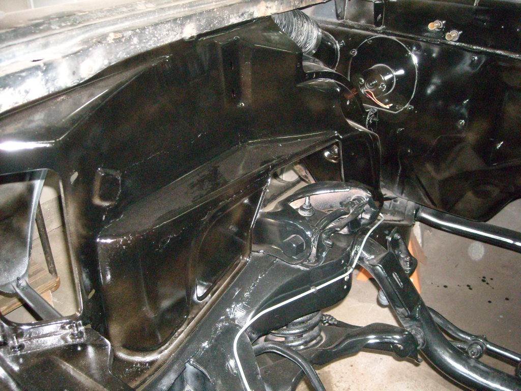

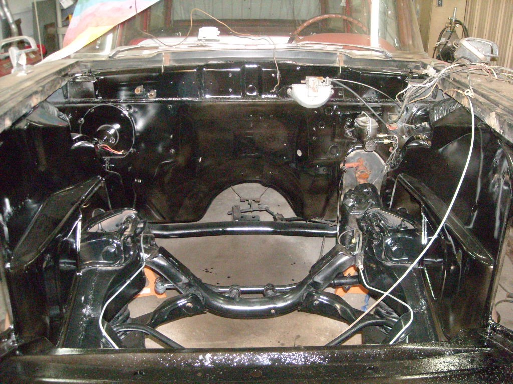

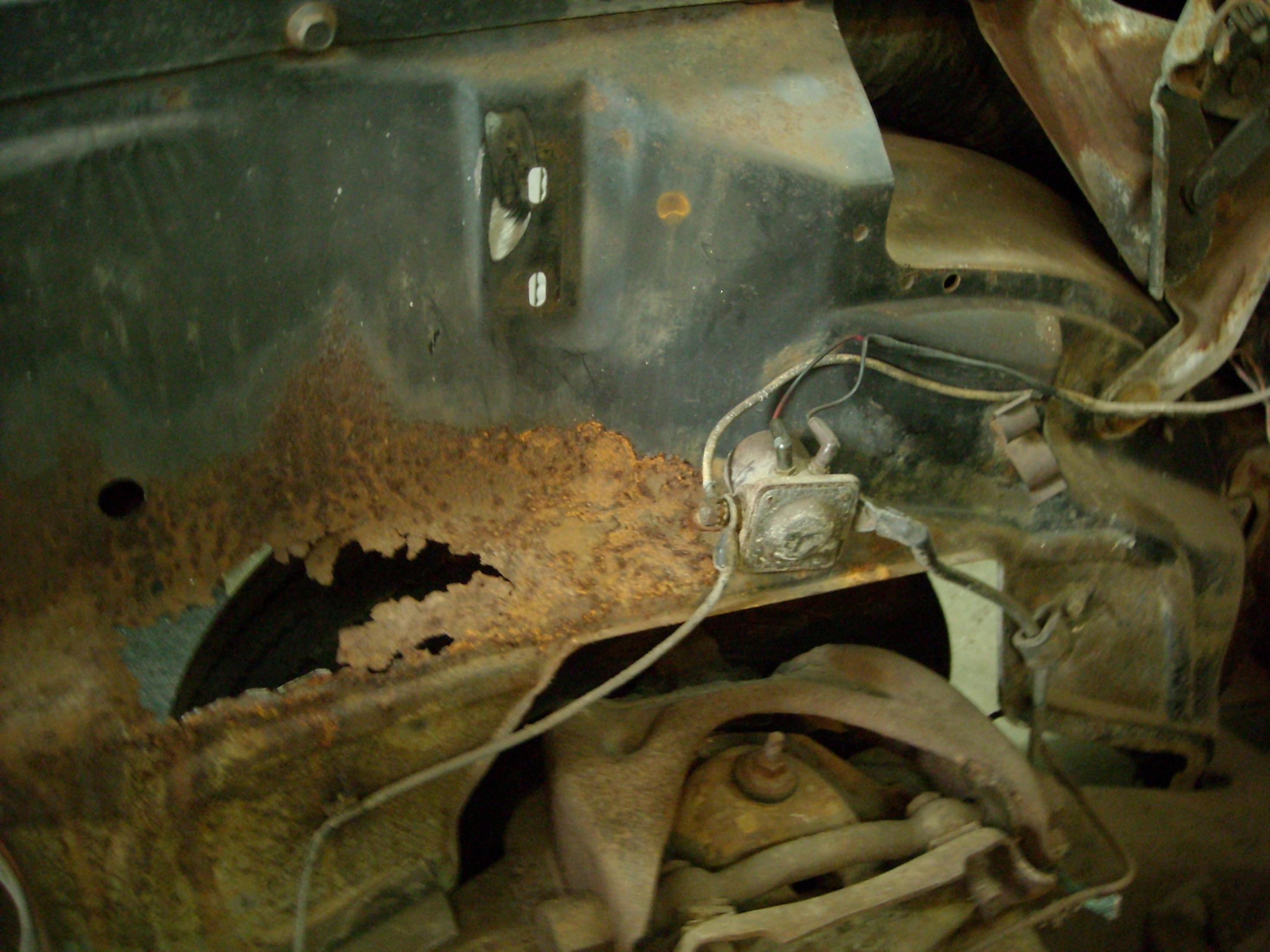

    I have got a little done this fall already, so here is the latest.
    1st winter I had her, I rebuilt the p***enger floor and rockers, plus the rear floor area.
    2nd winter I rebuilt the drivers floor and rocker.
    3rd winter I pulled the motor and trans, and rebuilt, or had them rebuilt.

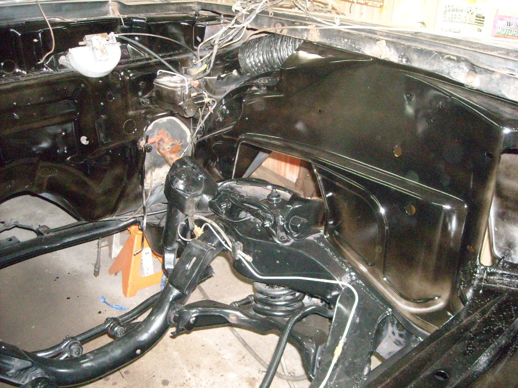

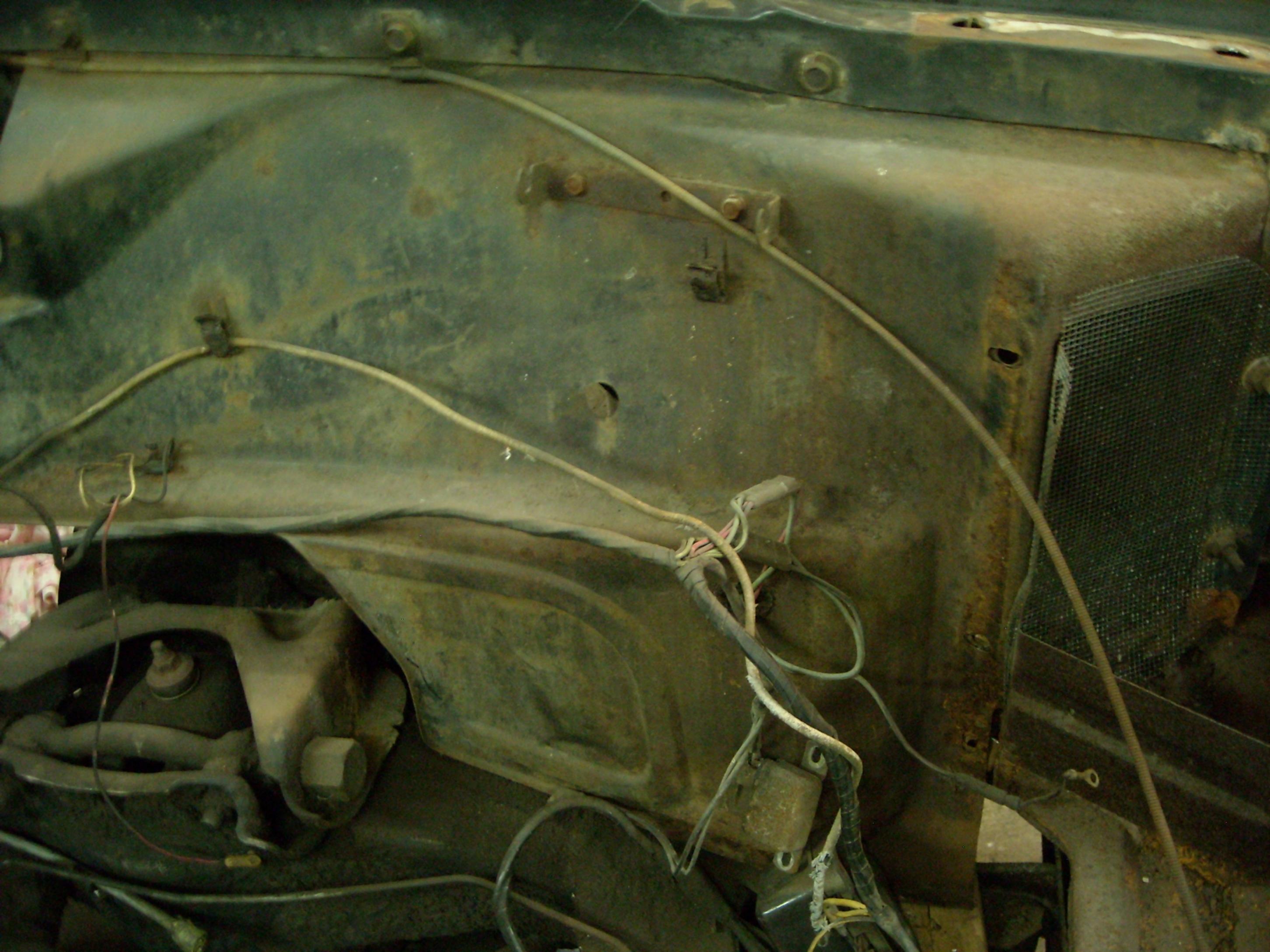

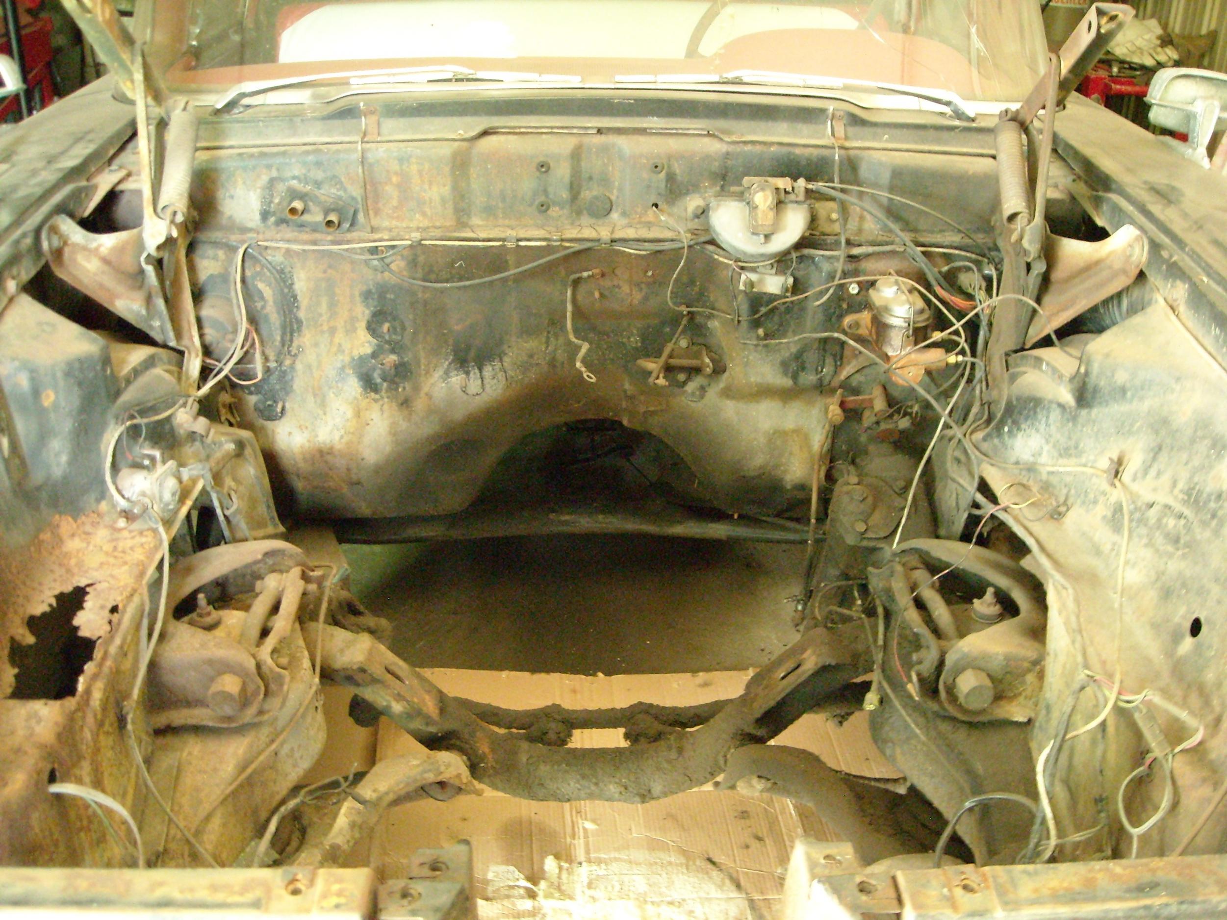

    This fall I have cleaned and painted under the hood, and the front clip and inner fenders. I ended up removing all the front grill support for cleaning and re-painting.
    I like the looks of an all original car that hasnt been touched, but this one was just too greasy and dirty to leave it like it was. I could have just cleaned it up, but then it needed coated so it wouldnt rust back.
    Here are some before and after pics.
