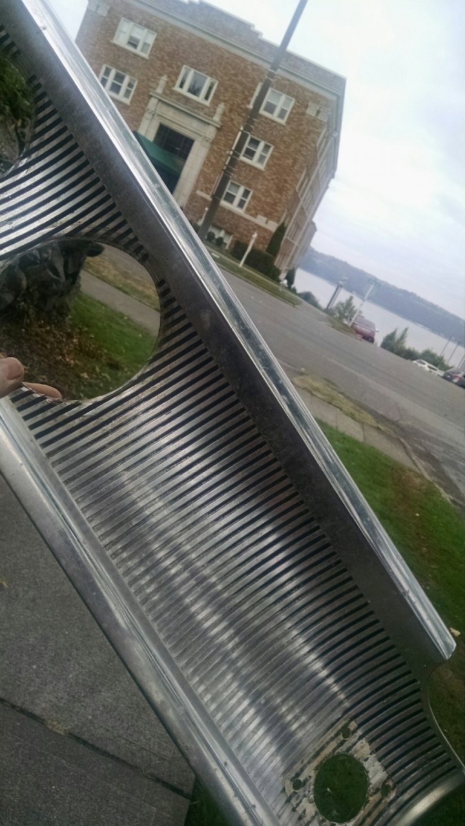

  4. so the Sedan Delivery at one time had all the 60 Nomad/Kingswood rear taillight trim and tailgate moldings.. missing the center tailgate part. its a hard trim part to find... Lucky Craiglist inquiry the other night... I have to buy a complete tailgate for the molding... the only draw back is this trim isn't made for a SD... it's notched for the hinges on the bottom... I will figure some out to make it look right...it's off for a 85 mile drive to fetch it !

    well removed the panel from the El Camino tailgate... that's what I was after for my Sedan Delivery... free 60 El Camino tailgate come get it... it's rusty but there are few good parts on it hinges, and release handle and lock cover... chrome Chevy chevron..

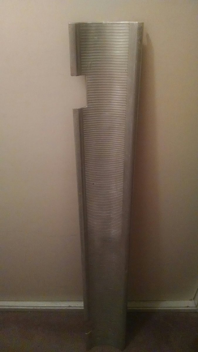

    going to cut this damaged Impala panel to make my patches in the Nomad wagon tail gate trim panel... Thank you Austin & your Dad for the panel... nice guys..

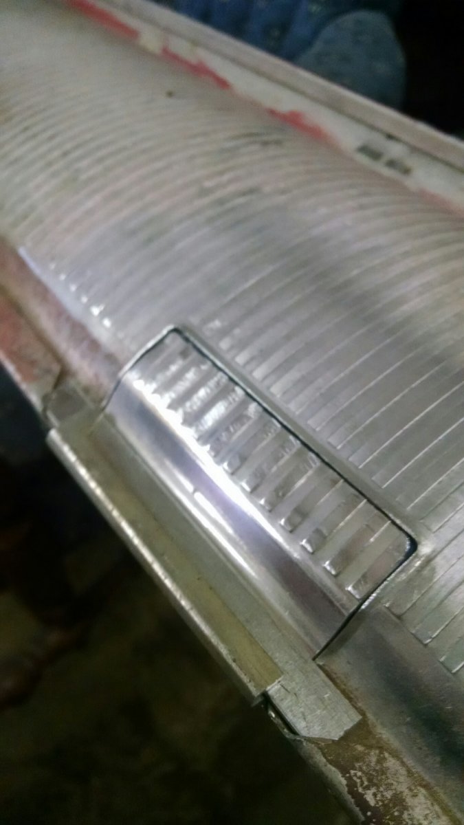

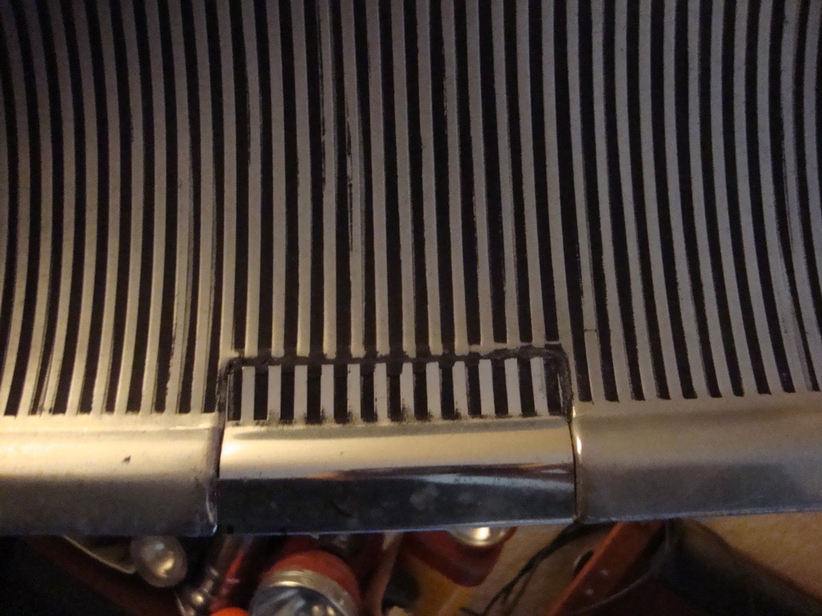

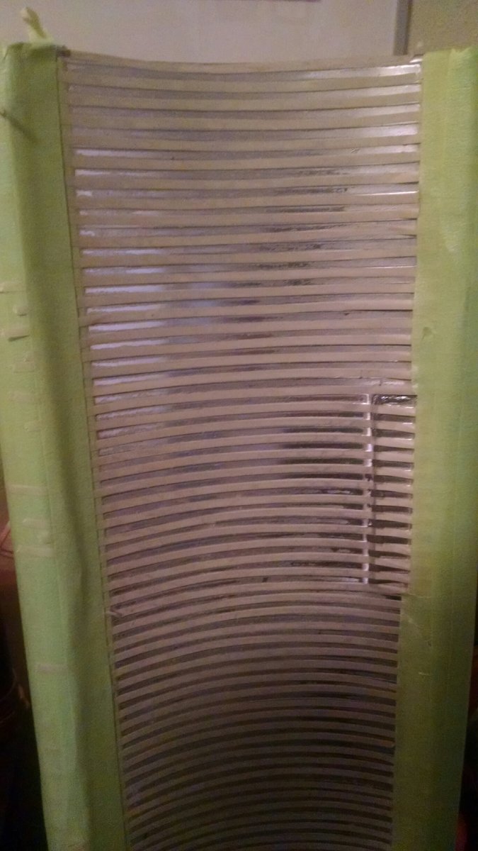

  16. well patched the hinge openings on the Nomad wagon trim panel .. so that I can put it on the Sedan Delivery... Little black paint this evening on the vertical lines in the panel... and pop it on when I get the SD back from windshield install... 3M panel bond works great !
    well finished patching the 60 Nomad tailgate panel , fine line tape and painted... DSC02142.JPG PANEL 4.jpg PANEL 3.jpg

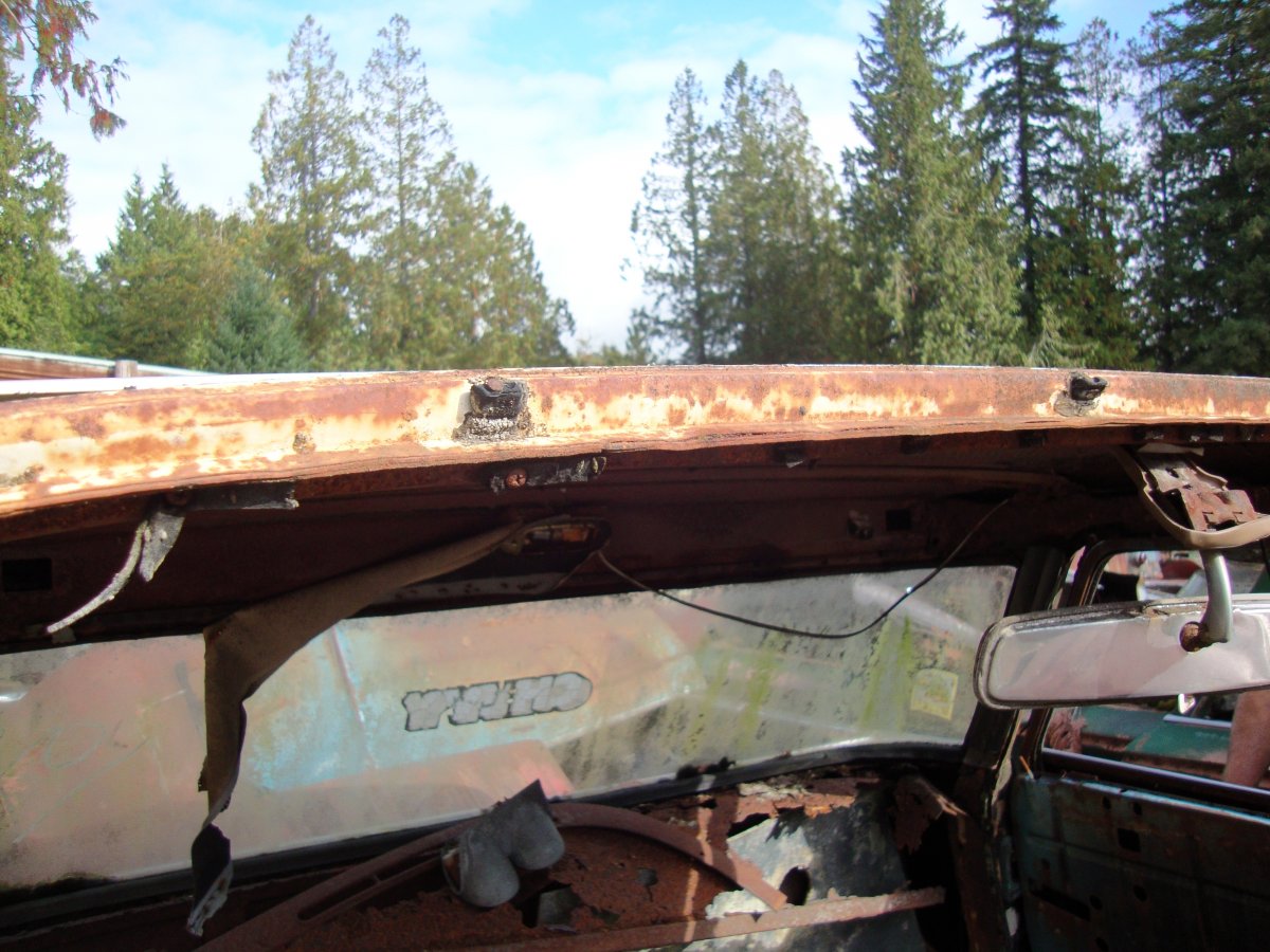

    I believe all 59 and 60 full size cars used the same windshield. So, I would guess you need the rubber for an Impala in order to accomodate the bright work.
  19. so looks like I will be changing the stainless windshield trim over to wider clip in style ... I did find one company in North Carolina... That is the only one that makes the correct weatherstrip for a Biscayne Wagon( grooved weatherstrip for T style stainless) They had some fitment issues, and just now have fixed the issue.. bad news they are 4 weeks out... and my car is taking up space in my buddy's garage.. So I hate to change the stainless,but can't wait...need to get the windshield done..

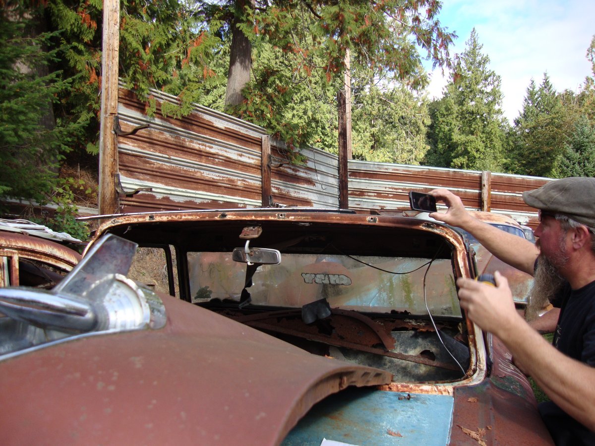

  20. so my buddy Dave, installed the windshield today... We had to take a short trip to Ron's Auto Wrecking... Since Dave was going to have to retro-fit the upper line style Impala, Bel-Air windshield stainless... So he had to get the measurements for the upper windshield stainless trim holes on the leading header of the roof ... Measures distance between the hole, and drilled... lucky the inner structure had the access holes there already.... just need to do some sealing ... reinstall trim... Next the seat is coming out, and I have carpet and new sill plate cover to install... send the seat out for recover...

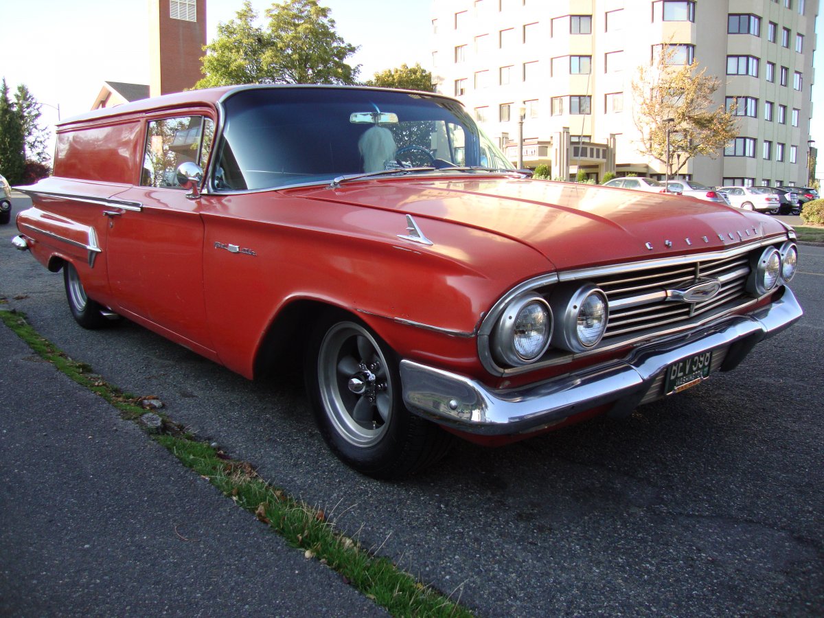

    Ah, can you post some fresh pix of the delivery? I am Jones-ing bad for a fix.
  22. will post some pix when I get the SD home.... with a new windshield and the changed stainless...

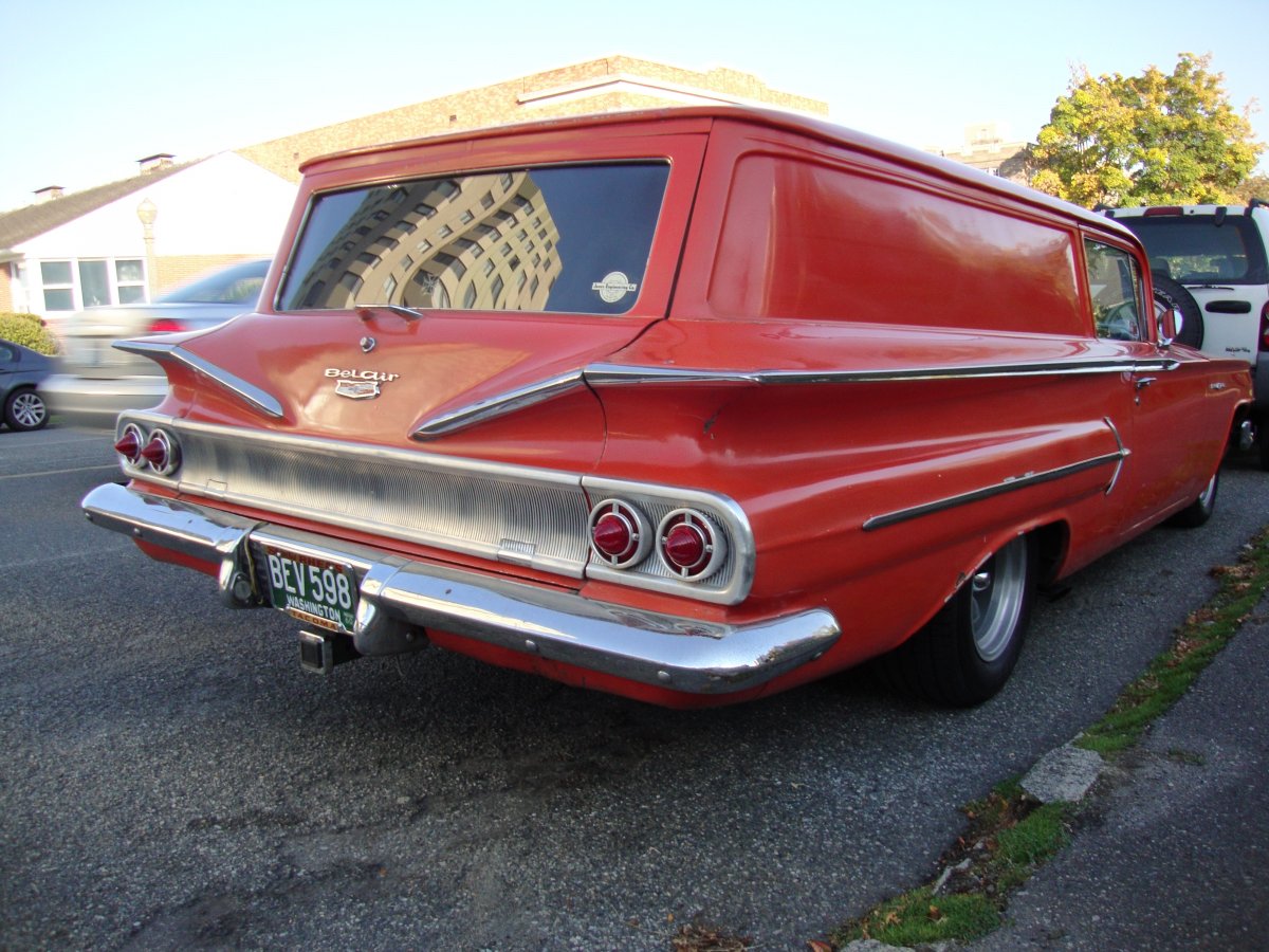

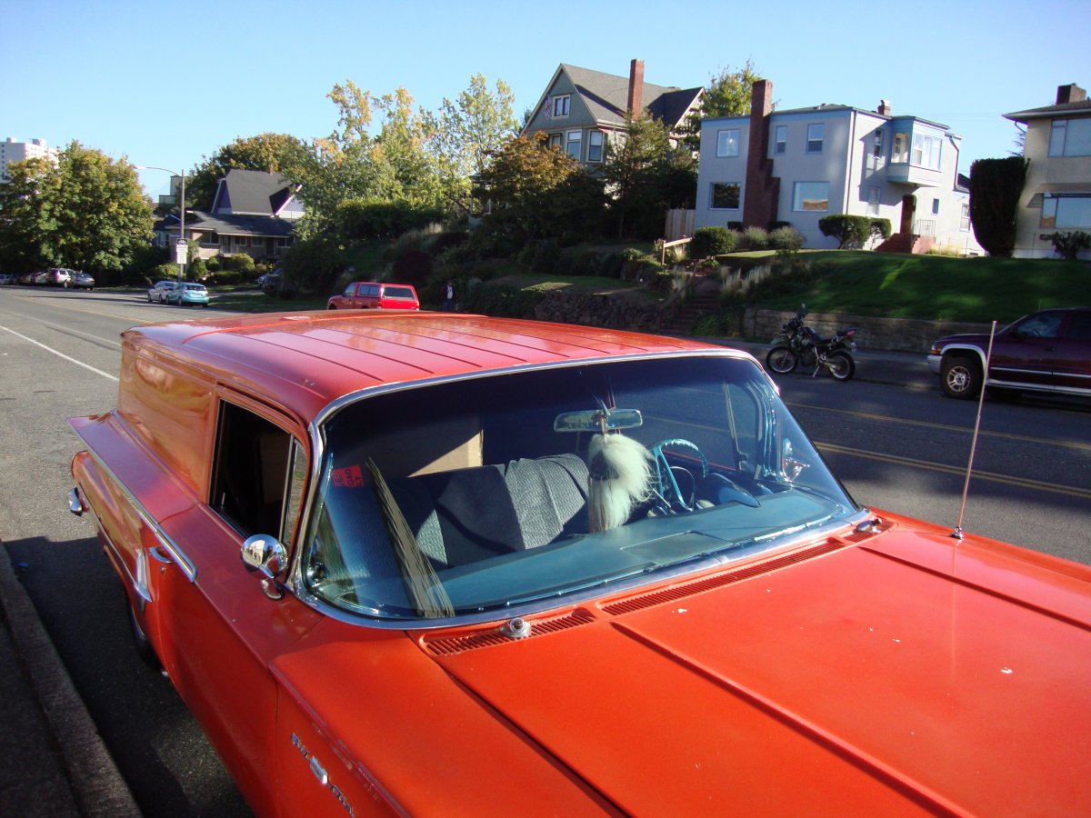

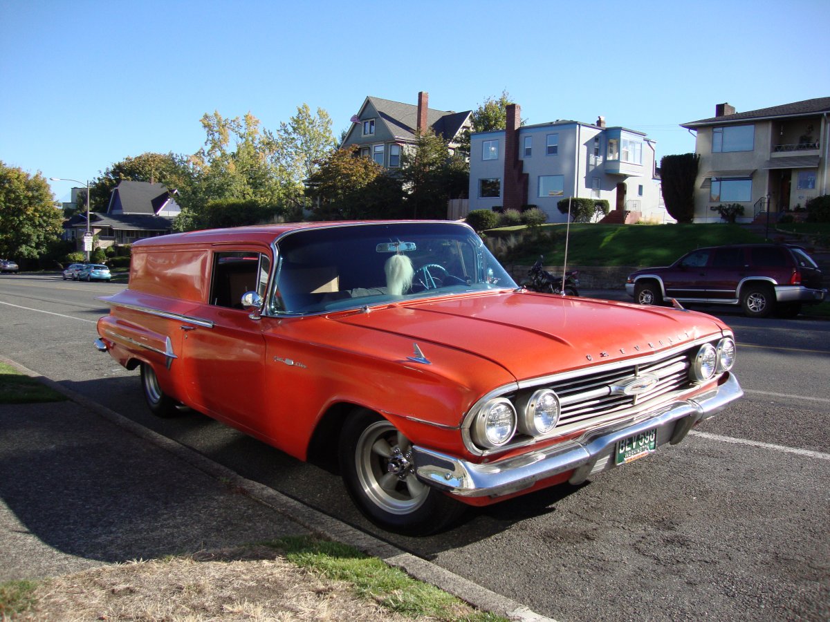

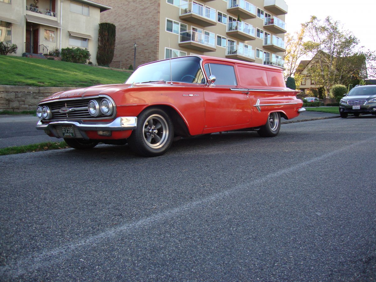

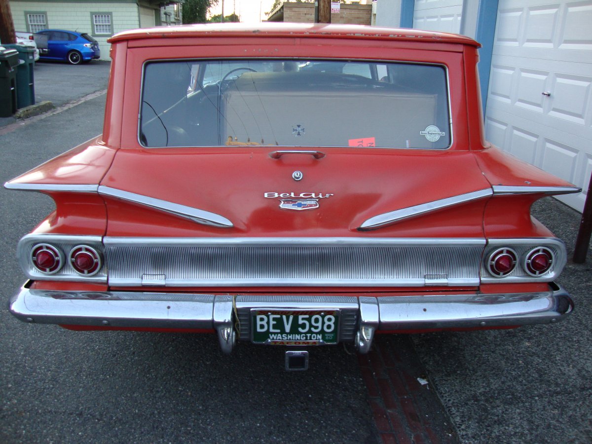

  23. so my buddy Dave(many thank you's !) , just dropped off the SD after the windshield install... Looks great, like the update to the upper line clip in style windshield stainless... now to start the install of the carpet and rear Nomad tailgate trim panel. DSC02145.JPG DSC02144.JPG View attachment 3015159 View attachment 3015159 DSC02148.JPG

  26. so this was my project this evening, installing the 60 Nomad rear trim panel I modified( well just patched the hinge openings...I was on another Web site (C**** T****) one blogger said this panel wouldn't work on SD.. after I explained what I had planned to do with it... I'm happy with the end result. DSC02149.JPG DSC02150.JPG
