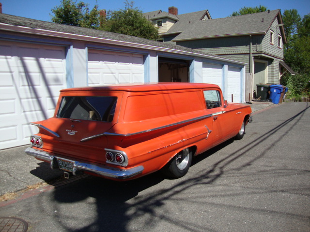

Projects My 60 Chevy Sedan Delivery ! Back on the road !
Discussion in 'The Hokey Ass Message Board' started by rob-redm, May 29, 2015.

    Very cool looking ride there Rob ... is the Woody gone?
  2. The Elcos and delieveries shared most of the low end stuff. It's been awhile since I've seen a delivery, always liked them less common then the Elco (which I have) and even better that it's a '60.
  3. rob-redm
    Joined: Nov 15, 2005
    Posts: 6,552
    rob-redm
    Nope , still have the Wood box... its sitting idle ...

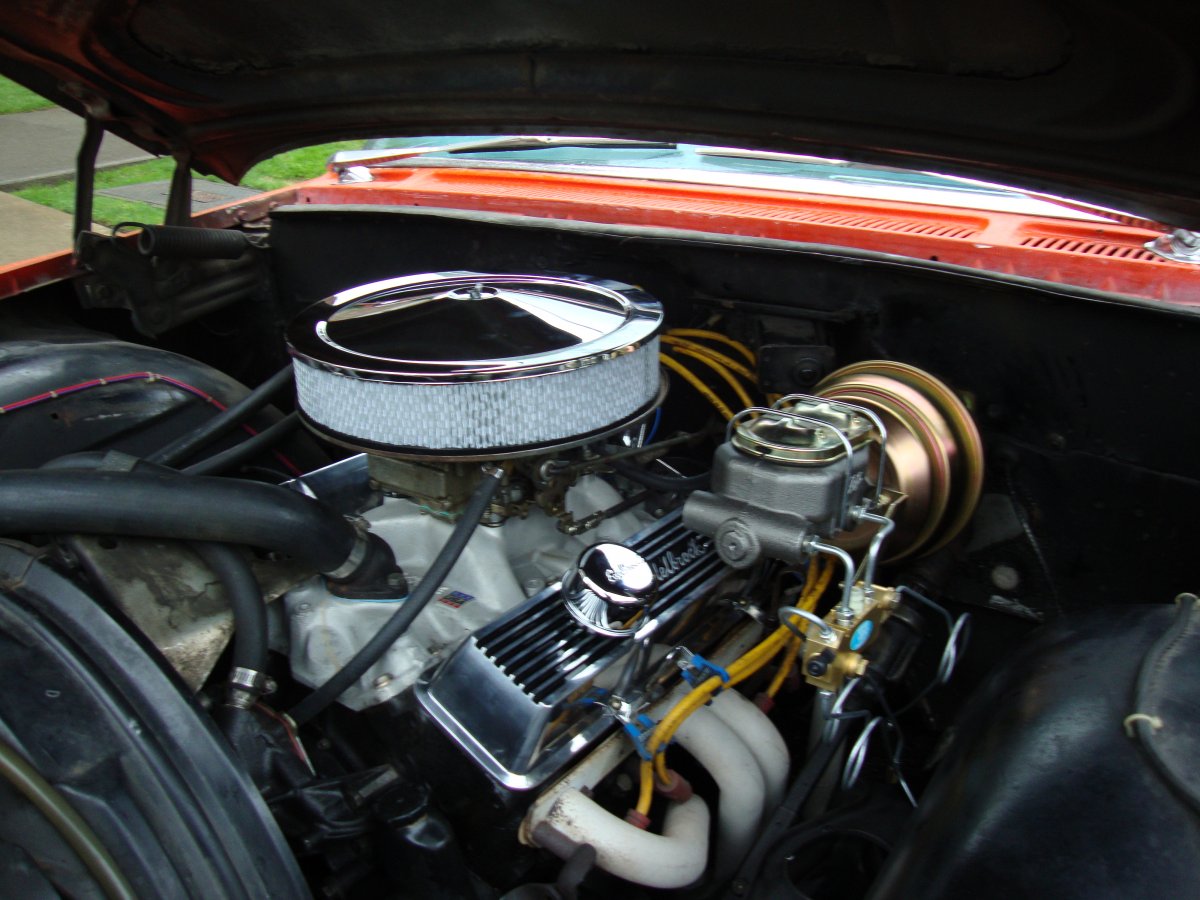

    round three, time to make the SD stop a bit better... brakes just ****... Having local Hot Rod shop look into converting the 60 to power brakes if to see what modification needs to be done.... Going to have some measurements taken for booster and master cyl... it already has a 79 Camaro clip... dual circuit master and front discs... New KYB gas shocks... complete brakes.. (way overboard) but I want it all new front to back... Lokar kick down for the auto trans( not hooked up now ) .... new interior threads on the back burner... want the mechanicals right.

    power booster and mc off 75-75 nova or 70-81 camaro will work.

    , The wiper motor may be the problem... Will see what the shop has to say if it's not a lot if work. I'll due the power brake up grade... it really could use it...It's one Heavy Chevy for sure.. with just a manual dual circuit master and front discs and rear drums ... the brakes aren't great..

    Lokar Autotrans Kick down it hooked up... Think I might go with the CCP , booster kit that they sell ... moves the power brake ***y over 2" and up 1" pending on how it drives.... hmm big block ? ( just kidding) Happy Thanksgiving to the HAMB !

    Well the ole 60 SD is getting a CPP power brake booster upgrade... pulled the trigger this afternoon... Brake pedal just doesn't feel correct... stay tuned

    nice service from CPP on the booster... had it sent 2nd day air... dropped it off at the shop today... so it will need some new brake lines bent up front... adding some Edelbrock valve covers to brighten up the engine bay some

    so the CPP power booster and new brakes front to rear is done, man this thing now stops and will put you thru the windshield, added new air cleaner and Edelbrock Elite series valve covers to brighten things up ... maybe need to find some more chrome do-dads( chrome voltage reg. cover , etc) Many thank you's go out to Thunfield Rod & Custom for all the hard work (Marshall & Gary thank you again !) really happy this big tank whoa's a lot better ...
