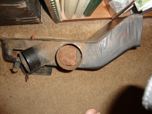

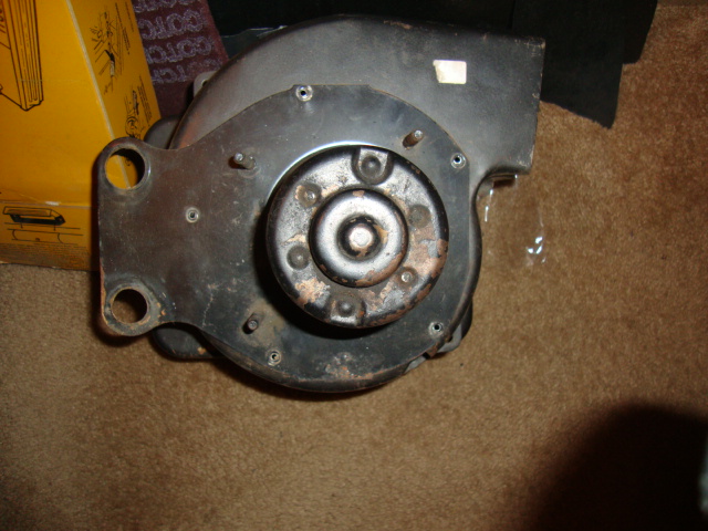

    Got the heater core rebuilt ( Corvette Core was used) trial fitted it to back into the my spare heater box... fits really nice... may need to bent the pipe a bit... The blower doesn't slide over one of the pipes very well... just need to be careful and I think it will be ok... My Saturday project !
