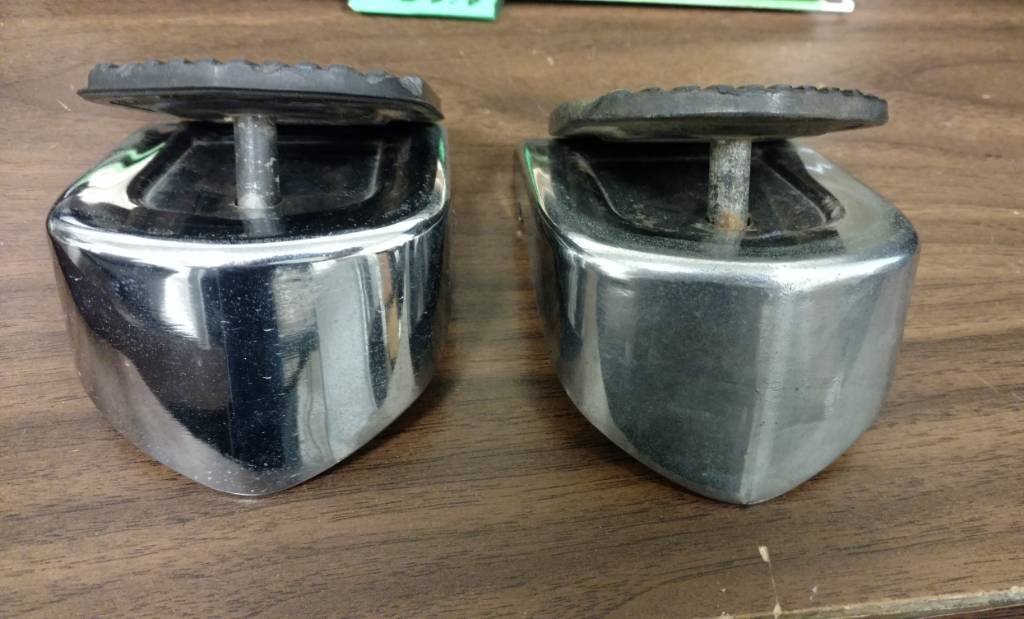

    I don't know how i missed this thread. But i need more info on the rubber fore the steps. Those things are super rare. i have 2 for my el camino and need the rubber part of it.Great car by the way.

  4. PM sent to you with Info !

  19. I had some PM's regarding the Bumper Steps... sorry those aren't for sale... There is a source for reproduction rubber step pads.. I have a E*** link from the other night from the same guy I bought my pads from... Very nice repops... ty
