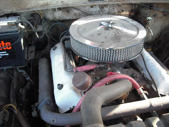

    Found this cheap and I needed a truck a 62 F100 Runs and drives...and sometimes stops. The carb needed a rebuild so I took it to a buddies house, the idle circuit is plugged up, so it is getting a full rebuild. I replaced the master cylinder due to it being full of sludge and used the pressure bleeder from the shop to remove all the old brake fluid. After that I adjusted the star adjusters on each wheel and the brakes where done. I started to clay bar the hood to see what it would look like, turns out the paint still shines underneath. I will be getting rid of those old tires for some wide whites.

    Thanks, I will tell you this, it was scary as hell driving the thing home. I had to two foot drive it to keep it running. It would die when you come to a stop, and the brakes where way out of adjustment. I also found out it has a broken engine mount. Those will be in on Monday. The way I found out the mount was broken is when I put it in drive the engine would torque over to the right pulling the throttle linkage down. This made the Carb go WOT and it dug a nice hole in my driveway.
