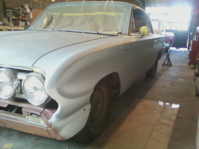

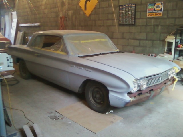

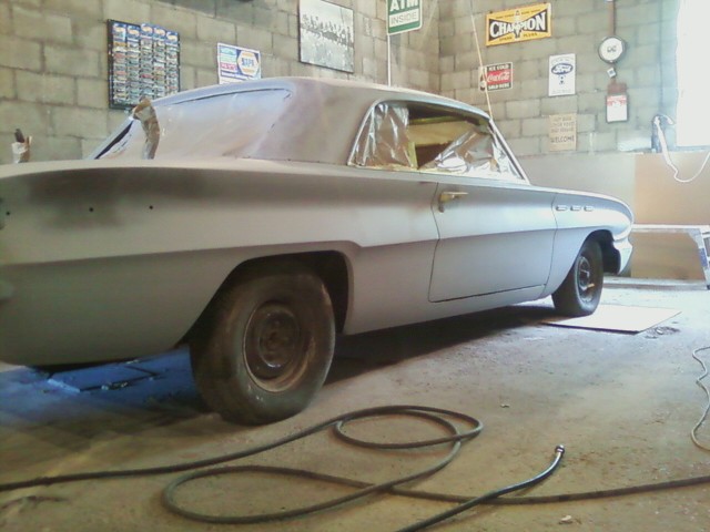

    Its been a while but I finally have primer on the old girl... glad as hell to done with the bodywork.

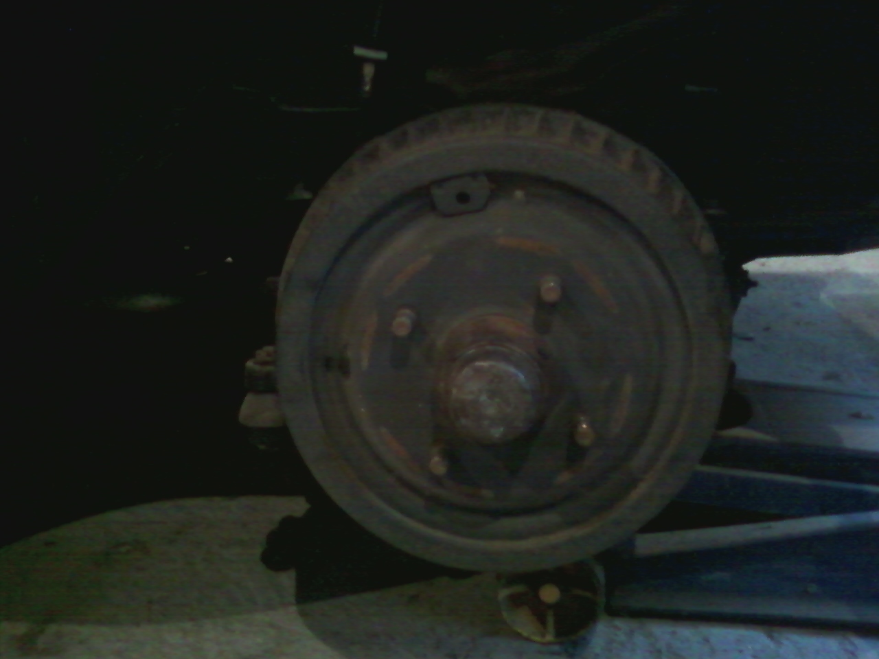

    I was lucky enough to locate a set of corvair front hubs and drums just a few miles from my house... turned out to be an easy swap.. need some ideas for changing the bolt pattern on the rear axle.. is this something I can do myself?.. or is this something for a machine shop?.. just want it to be safe. any input is appreciated. Anyone in upstate NY that does it?

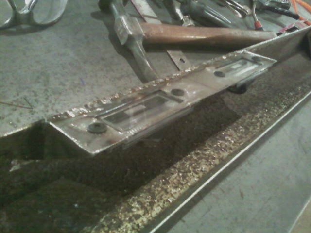

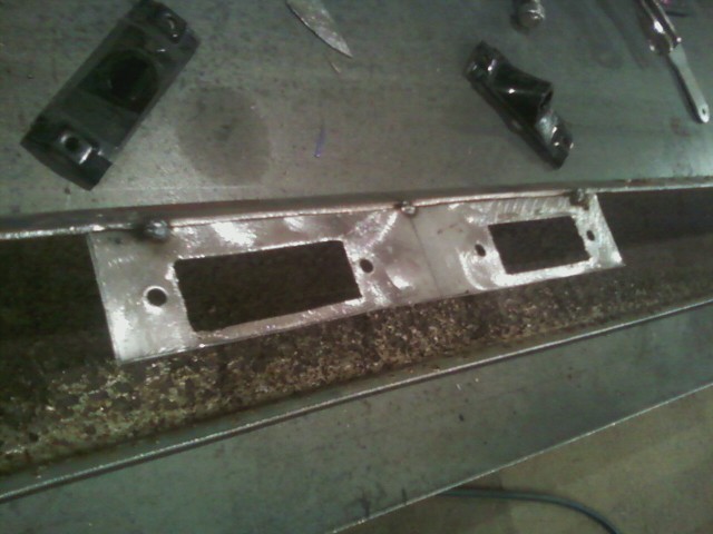

    My liscence plate lights were rotted away so I salvaged some from a caravan and built a bracket to hide them inside the bumper.

    Nice work! I have been told you can return your axles to one of the major manufacturers and they will weld and redrill them for you. Not sure what one. Sorry! I think I read that on the skylark616263 yahoo group. Check around.

    Cool build. I have a 62 special, it came with the long skylark tailight trim you have, luckily in the trunk were the little "special" pieces you want. Google the Buick farm junk yard in Sacramento,Ca. for parts and pieces. There was a guy on Ebay selling disc brake kits for these cars a few years back. You could always buy or make wheel adapters for the rear lug conversion. If at some point you put a 300 v8 in your car you will need to keep your left side exhaust manifold from the 215, just port match it first, and fit it to the engine too. Grinding the block in the car was a bitch, ask me how I know. Plan on driveshaft tunnel mods too as well as the tranny hump. Keep up the good work.

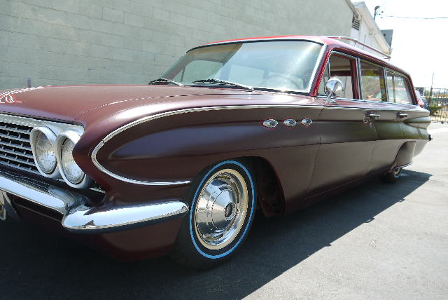

    Here are some pics of my wagon...before i removed the blue coating.

    Anyways, 61Special, the wagon looks great. Nice and smooth, and love the caps.
