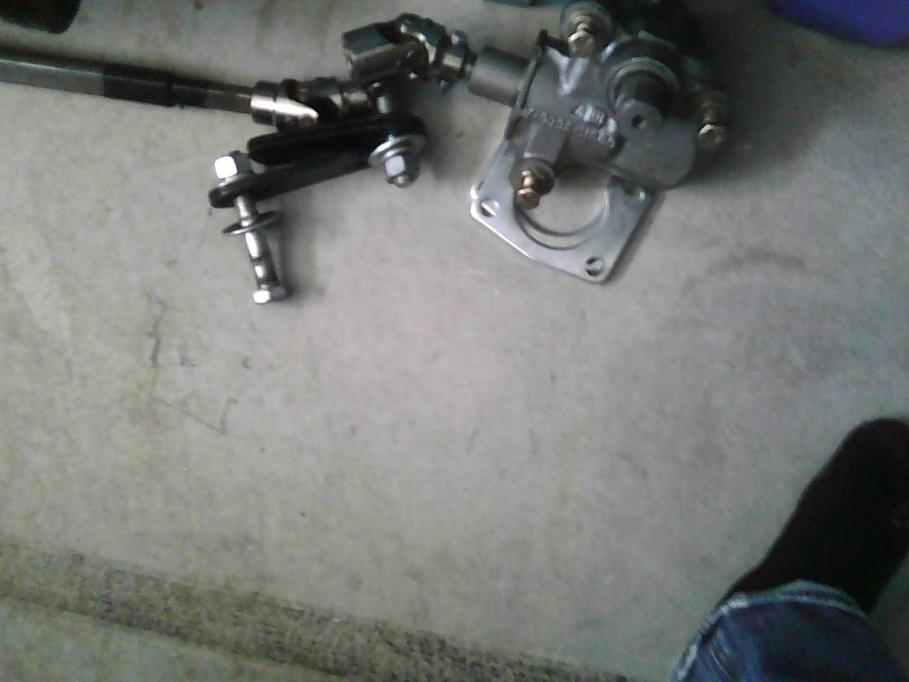

    well a little up date for you guys i got a picture of my c-4 trans and i hit the jack pot today at the pomona swap meet i got a straight axle with new bushings, tie rods, king pin joints, new wheel cylinders, new brake lining, new wheel bearings, new wheel bearing caps, new wheel studs, a steering box, new shackles, engine member, brake proportioning valve, and new brake lining for $140.00 (ill take some better pictures when my camera recharges in the morning)[​IMG]

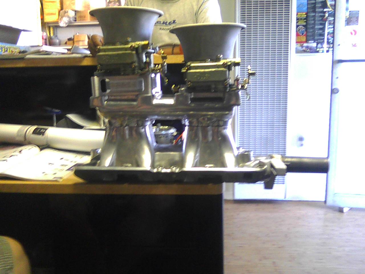

  15. I'd swing away from the tunnel ram-too 70s-80s, and probably way too much carb for a 260(unless you ment 460? Which is late 60s anyway, are you going for a period correct build?).

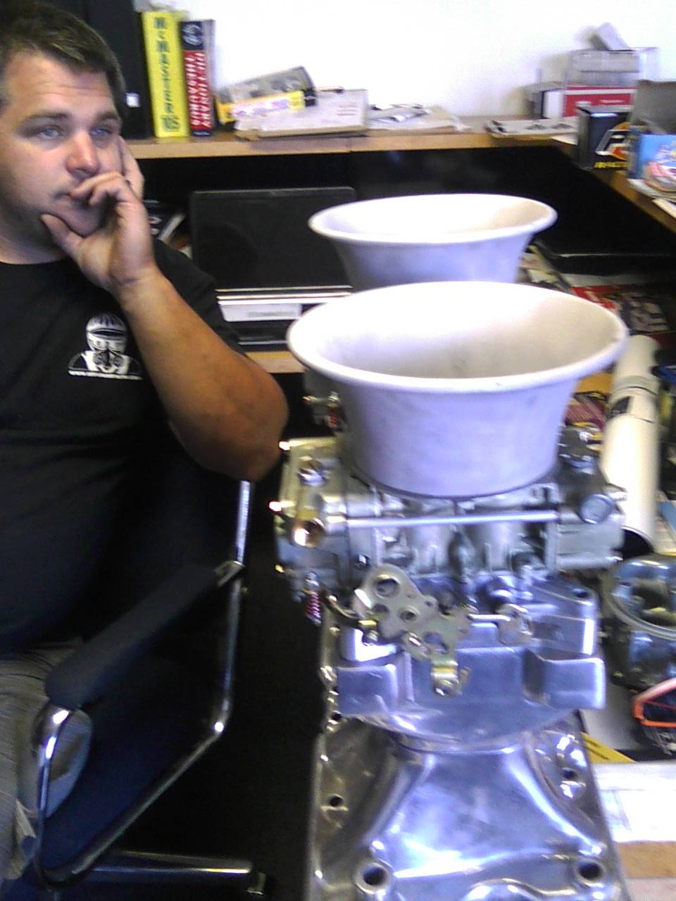

    yes i have 2 450s and finished porting the manifold today here is a mock up
    i like how my older brother is looking deeply at it haha

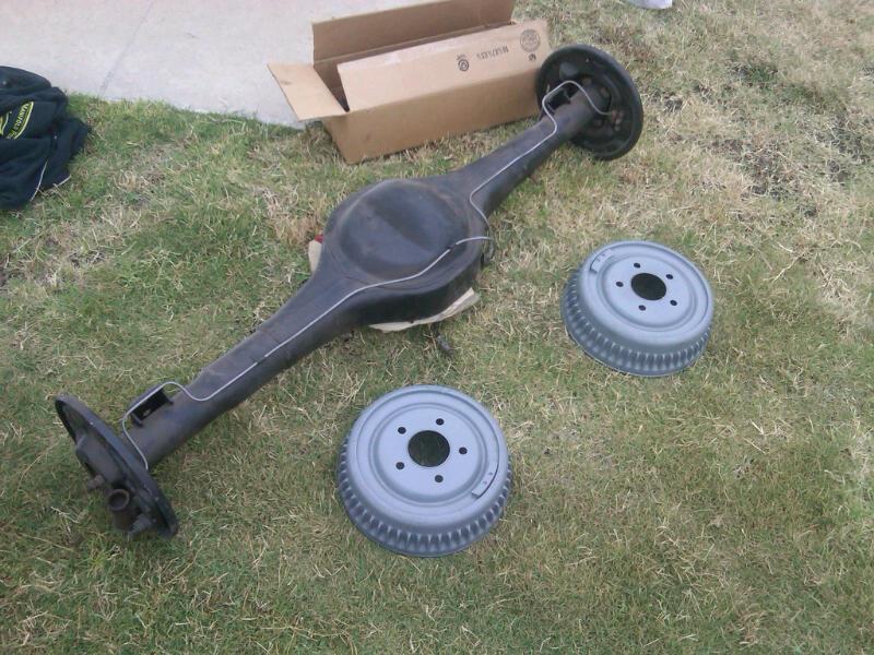

    update i picked up my rear end housing today and here are some mock up americans on it(chevy bolt pattern)

    That does seem like an awful lot of intake for a 260. My buddy in high school put a 500cfm Holley 2 barrel on his 260 and drowned it. Nursed it for 2 days and took it off. Undrivable.
  23. Chuckles Garage
    Joined: Jun 10, 2006
    Posts: 2,365
    Chuckles Garage
    Alliance Vendor
    Looks like you are off to a good start! Keep it up!
    On the tunnel setup....900 cfm is way overkill unless that motor is built to the hilt and revs to the moon. What's your plan on the engine mods?

    ok here is what i have 260 bored 40 over and honed (out of a 63 and a half comet oddly enough) ported tunnel ram(still need to flow test) and ported heads flowing 200 cfm isky .512 lift cam .187 intake valves , compe***ion valve job

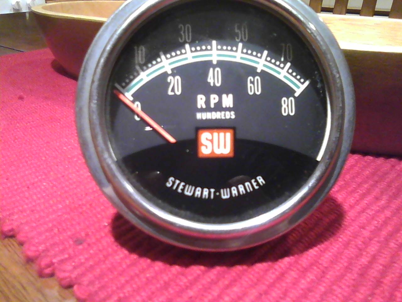

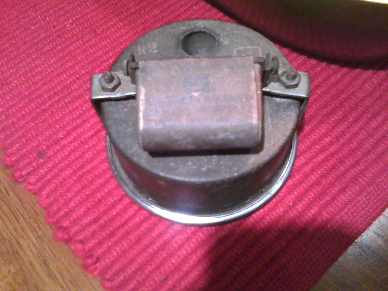

    Well today i picked up my rebuilt center section (4.11 with trac loc posi) and 9 inch housing i also picked up a SW greenline tach... ill post pictures later tonight after i get off work( here they are ...)

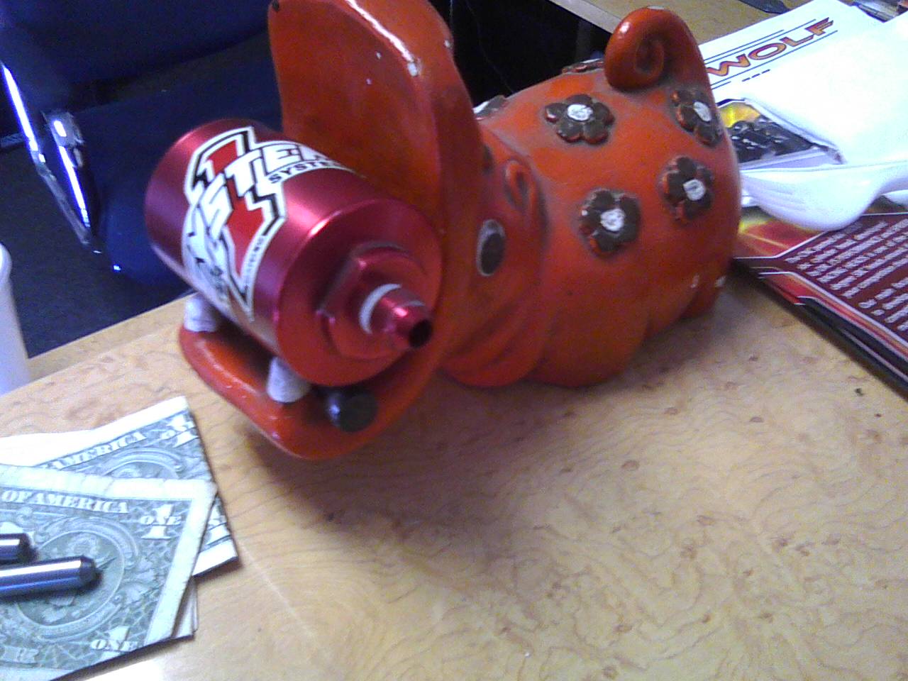

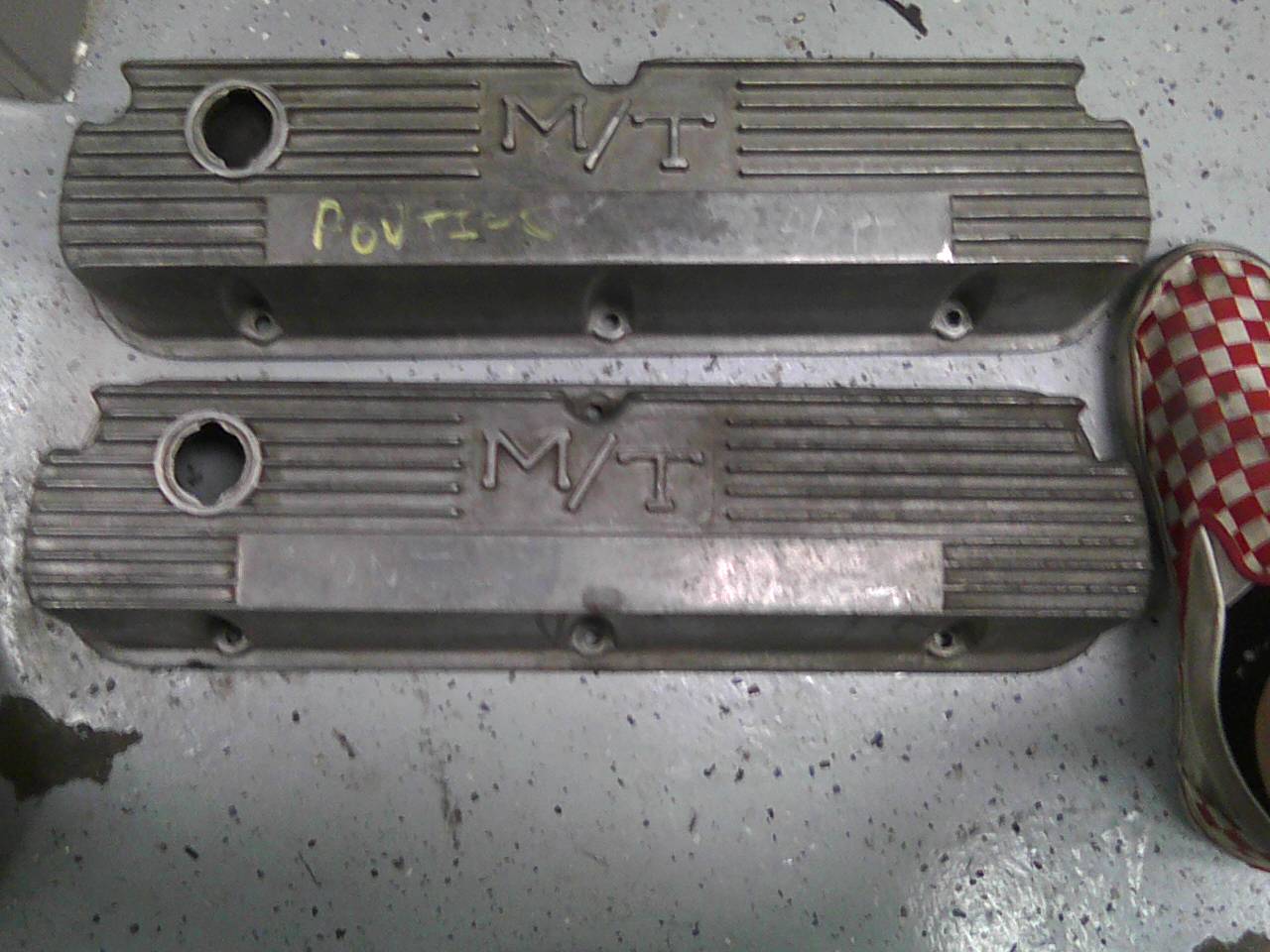

    another update..... some more parts
    Fuel filter
    Valve covers
