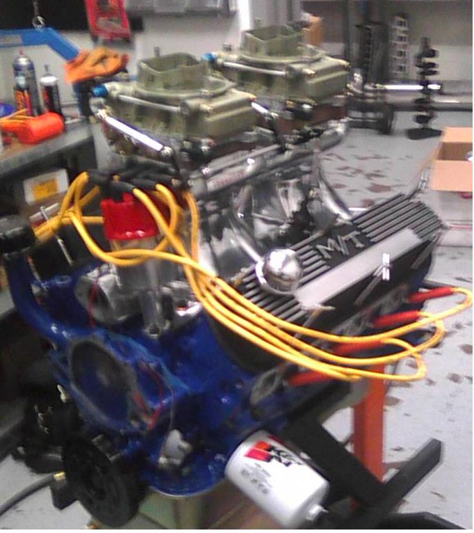

    All ready for the Dyno tmrw!
  10. Better getchu a water pump first.
    (The old style without the steel plate)
  11. 63FalconFutura
    Joined: Feb 18, 2010
    Posts: 308
    63FalconFutura
    from Socal
    They have an electric one at the dyno

    Big cams need compression. I have this same setup sitting on a shelf in my garage (dual quad tunnel ram) for almost the same car (63 Falcon sprint)
    Its still sitting on the shelf because all the trouble it would be just isnt worth it especially since I know I can run that SBF hard on a single 4 barrel and make good power with manners. And I couldnt stomach cutting a hole in the hood of a car thats been in my family since it was new.
    Rob

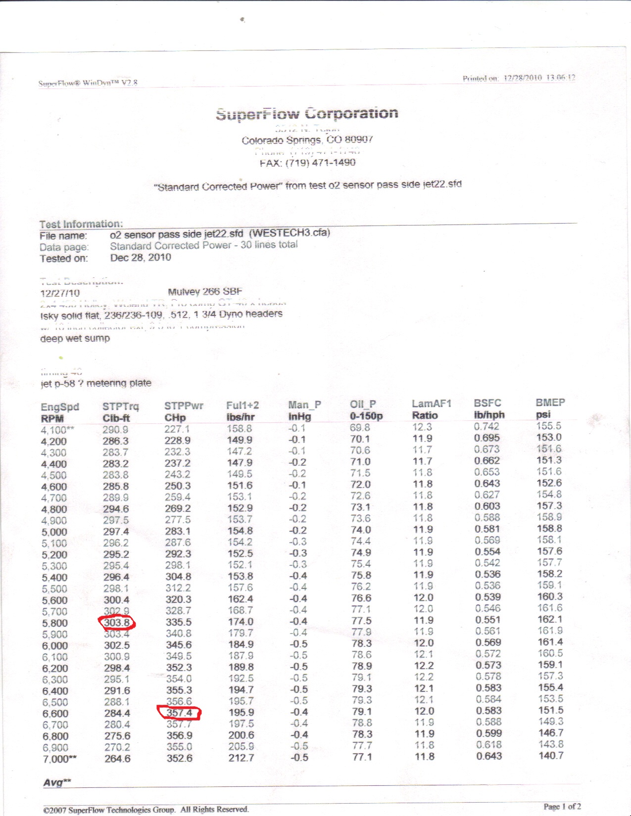

    357 hp 300ft/lbs need to fix printer to upload dyno sheet... need to get video and what not off of my brother camera idles at 1100ish doesnt bog it ran pretty good, not quite the 400 i was looking for but it is pretty much the stock bottom end so i am happy with the results

    Until you get the printer fixed, can you give us some of the hp/tq figures at 500rpm intervals?
    at least let us know what rpms your peaks were, and what was highest rpm seen. I'm also curious to know what rpm the hp started to fall off was..
    357hp is pretty damned respectable for a low compression, small inch mill with the induction you listed.
    rick
    dyno sheet peak numbers circled

  25. Nice numbers from a 260!

    Does anyone one who has been helping you have a set of smaller carbs to try out? It'd be interesting to see any differences. Not bad numbers from a 4.3litre engine, though. Put the Falcon on a diet and it should move along nicely.

    What were your air / fuel numbers??

    That's more than respectfull from a 260 mill.

    they didn't give you a standard sheet with all your measured specs? BSAC, VE%, I dont see a baro - really curious about why they're showing that your carbs are restricting you (any neg pressure and it's full range, so maybe calibration is off). No mechanical efficiency detail?
    what were the baro specs for the day- hard to tell alot with the rest of the specs but it's a good start.
    Haven't seen peak torque that close to 6grand in a long time. cute little ******- drop some 4.56/4.88 gears in her on 28s and pull the trigger - FUN
    good job on your first build!
    rick
