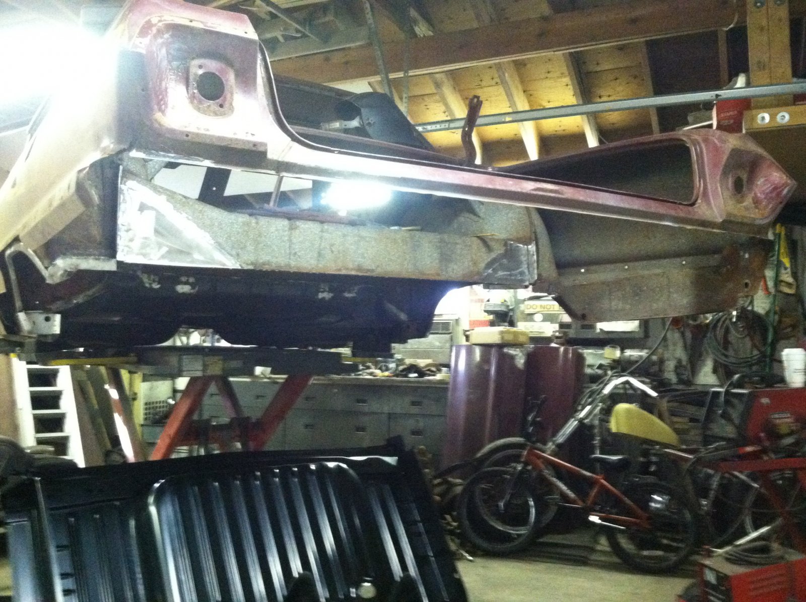

    The trunk pan is in, just need to get and hang the left lower quarter and the main body is ready for blasting.. Then on to body work.
    It kills me how this car rusted. After getting the trunk floor and drop offs off the car, i took a pic of the inner p*** quarter. Its perfect. Even the rear tailpan where the trunk floor attaches is perfect.
    Floors were trashed but aside from the left lower quarter the rest ofthe body is super nice.
    Damp floor storage and mice. :(
    I'll blast the complete body and all the ch***is parts/frame at the same time.
    I'll probably put the whole ch***is together before i start on the body though. I'll just get the sheet metal in etch primer after i blast it.

  10. pitman
    Joined: May 14, 2006
    Posts: 5,148
    pitman
    Ya know, doing the rust work on an A or B Ford, is like a walk-in-the-park compared to this job!
    Appreciate the pictures Tony, so I can see how it should be done. :eek:

    Pitman, i can say first hand i agree! Lol
    The lower 5 inches or so on my 32 was gone, literally..but putting that back together was a lot easier than this just because i really dont want this to look like it was ever touched.
    Still enjoy doing it though for some extremely odd reason. :)
    Dont know if this is how it should be done but im trying. Haha
    Thanks man!

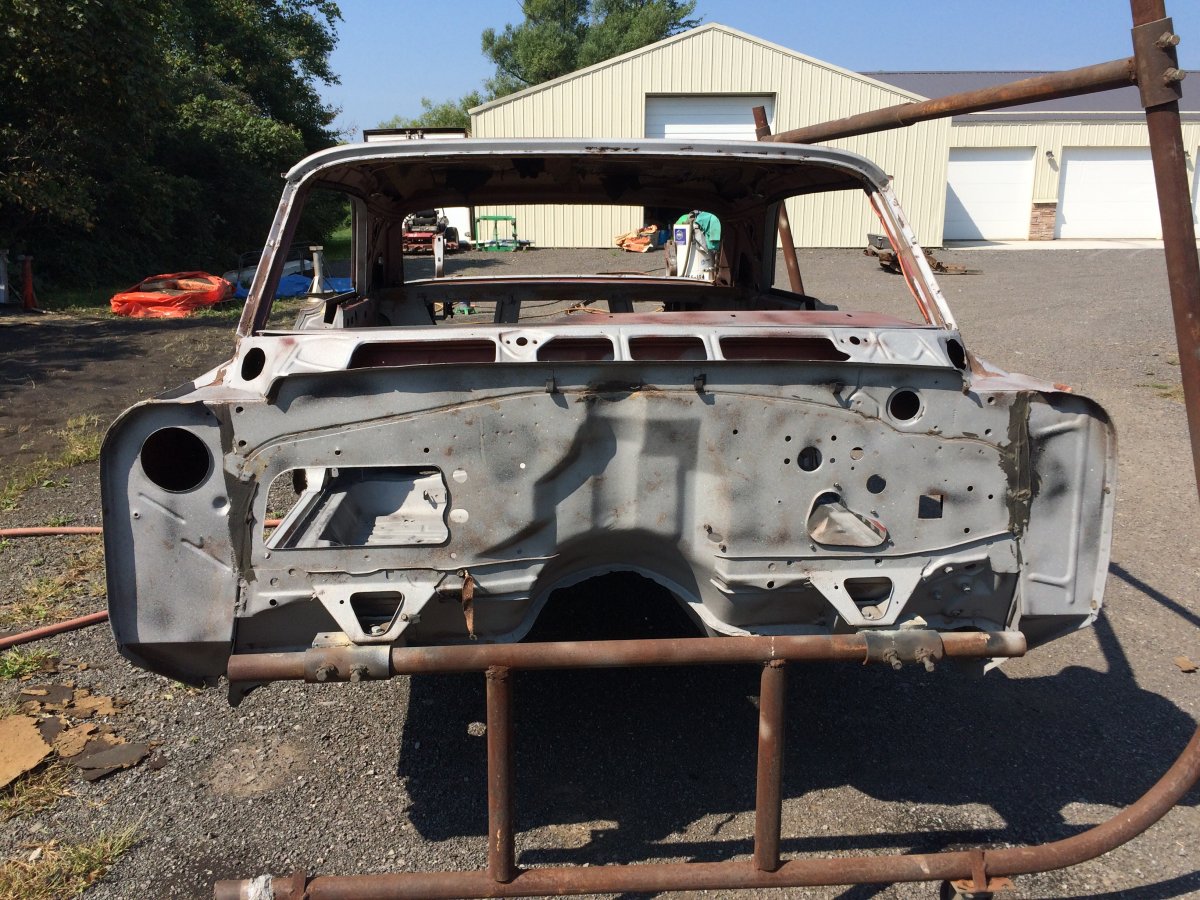

    Been a while since i've really done much to this thing, but finally was able to get a little more done over the long weekend.
    Rented a blaster and cleaned everything up.
    The car is finally one piece again and is just about ready for etch prime and seam sealing.....
    Tony

    Wow. Car rules ... but how about that Darth Vader suit ? Never knew you could rent the whole rig, but ..... probably not as lucky here. You do excellent work sir. That Impala is gonna' love you good.

    I like your body dolly roll over stand.
    I made one like that when I did a floor pan job on a Camaro.

    Thanks fellas. Its been a fun project for me even with all the dirty ****ty stuff with it having a little deeper meaning than just a car for me.
    Kidcampell, that darth vader helmet saved my *** this weekend!
    The hose on the back of it feeds filtered air into the helmet via the shop air comp.
    it feeds through a filter set up.
    Anyway, its been about 90 degrees and humid all weekend and the goofy thing made it possible. Haha
    Normally we'd wear a tyvek suit etc but it was just too damn hot.
    The rental company supplied us with it.
