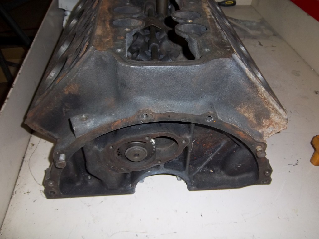

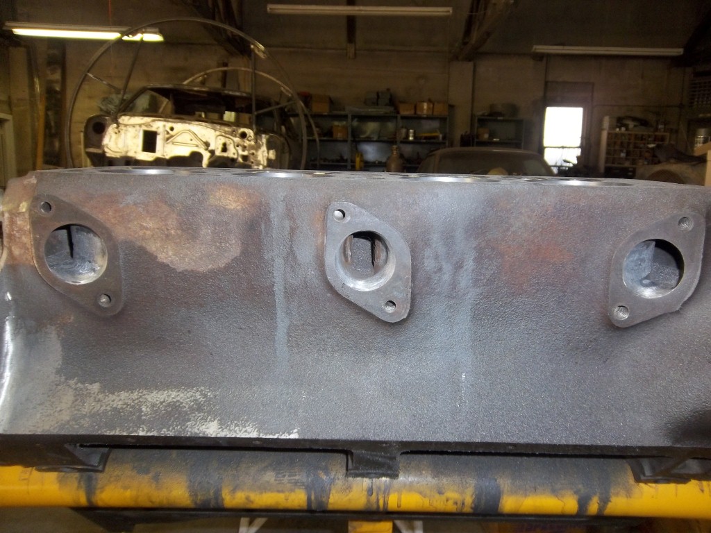

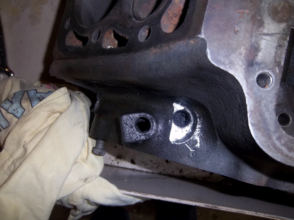

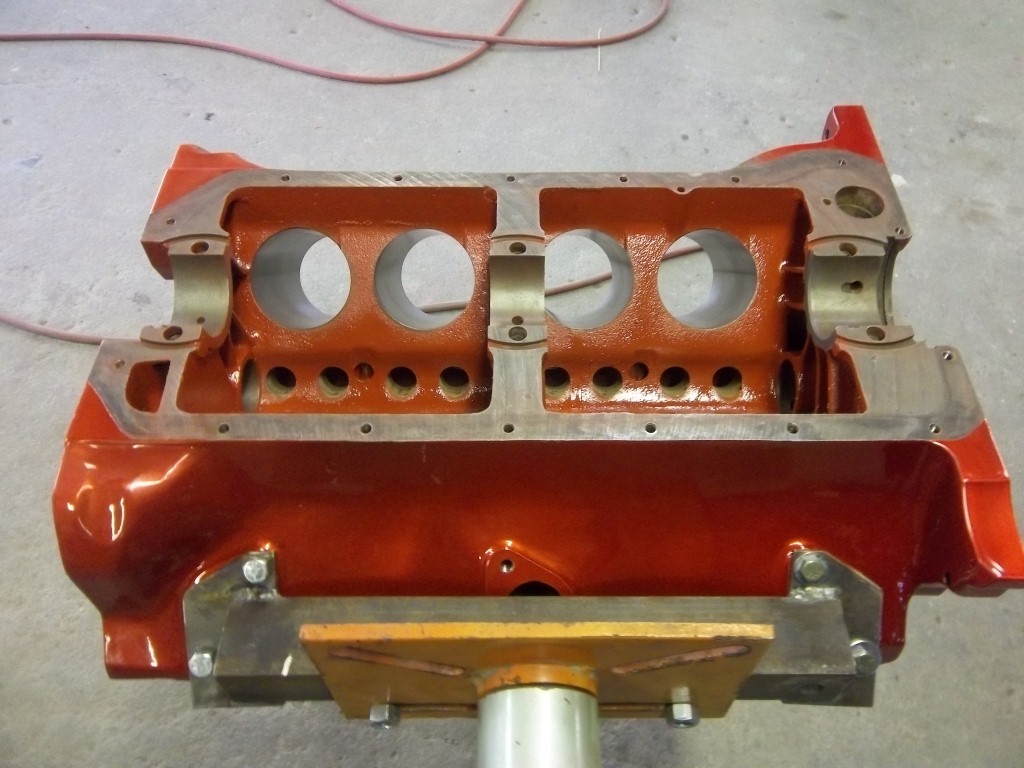

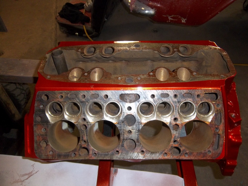

    First installment Getting the Block Machined and ready for powder.
    DSCN0238.JPG DSCN0230.JPG DSCN0231.JPG DSCN0232.JPG DSCN0233.JPG DSCN0234.JPG DSCN0235.JPG DSCN0237.JPG 100_1405.JPG

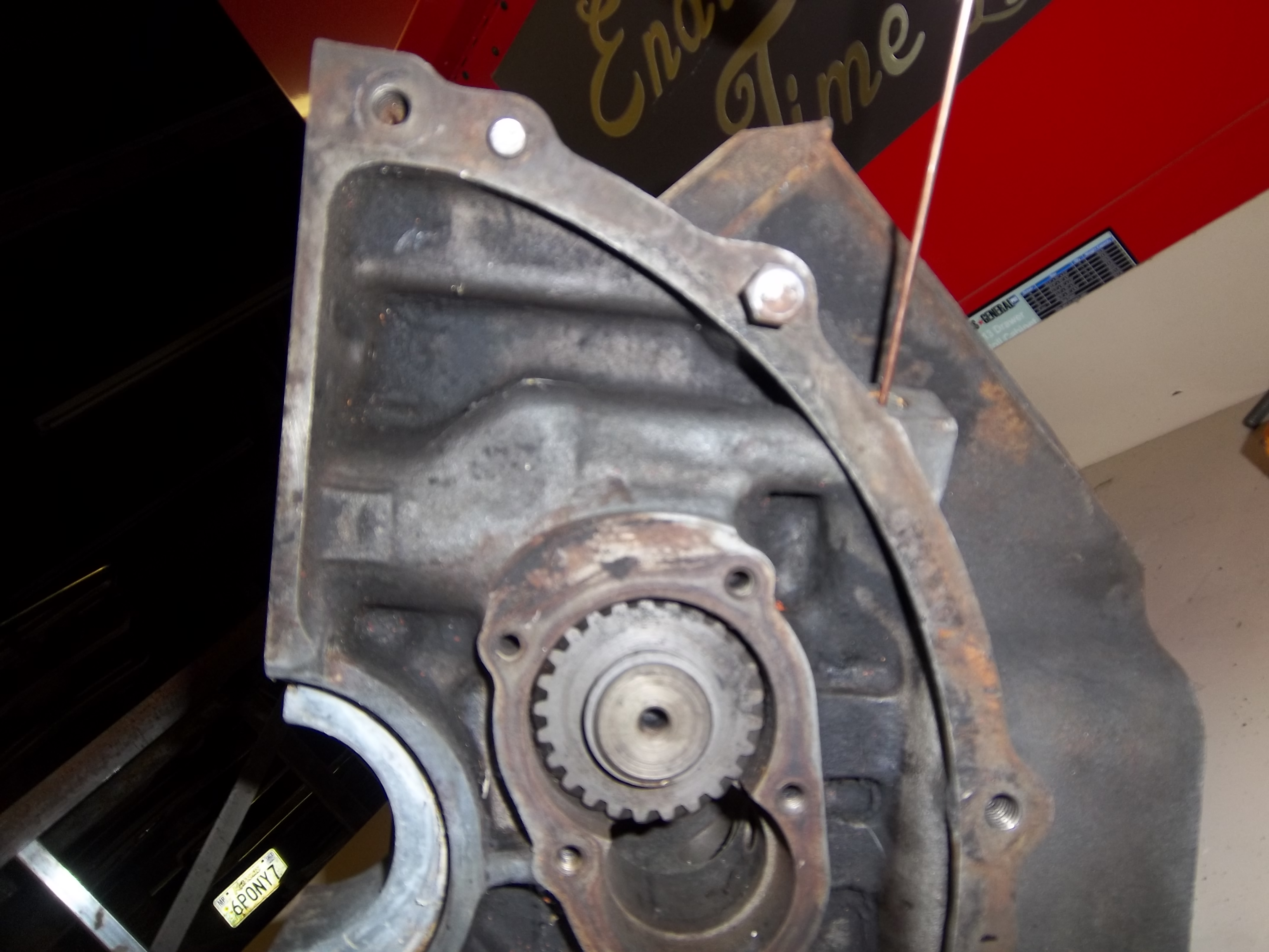

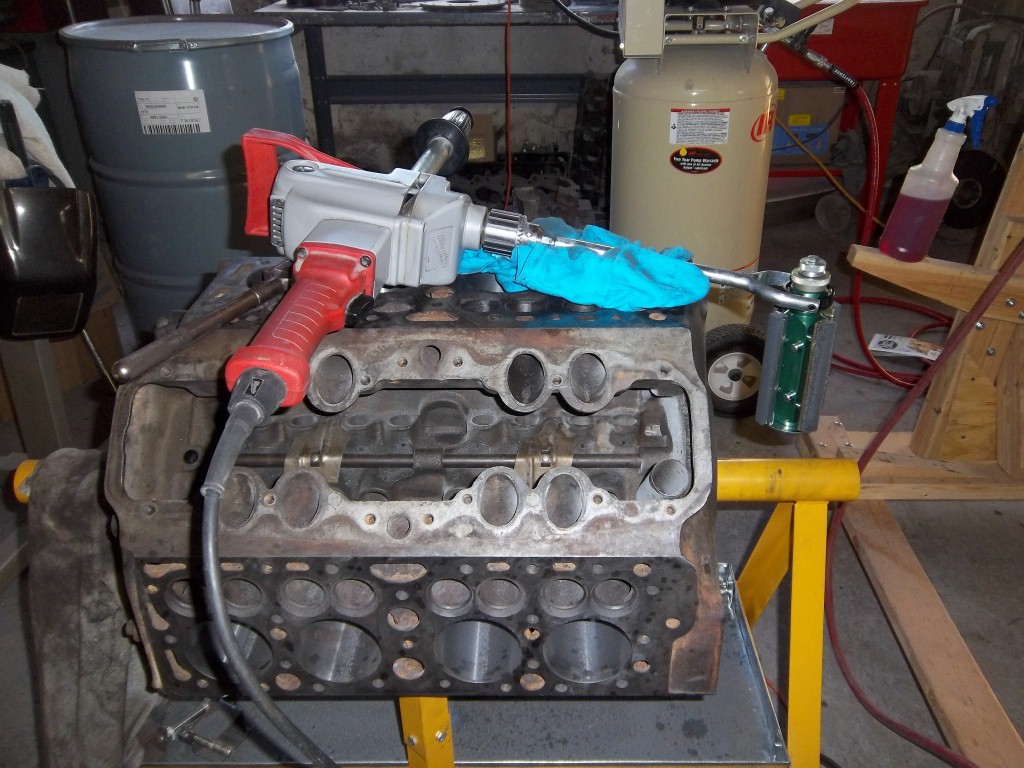

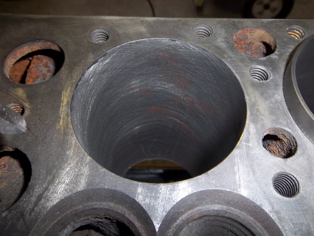

    The block was still standard bore so were the rods and mains. I used a piece of filler rod to locate the oil passage and drill for full flow oiling and measured the block and ground out a flat spot for my fitting. I drilled the main oil passage post filter and plugged the oil passage from the oil pump to the rear main and #4&8 rods and plumbed a line out side the block behind the flywheel. I plugged off the fuel pump push rod hole and the drain hole for the rear cam bearing. So the rear cam bearing is pressurized now and the only thing not filtered.
    100_1409.JPG 100_1411.JPG 100_1415.JPG 100_1410.JPG 100_1414.JPG 100_2456.JPG 100_2457.JPG 100_2482.JPG 100_2578.JPG 100_2903.JPG

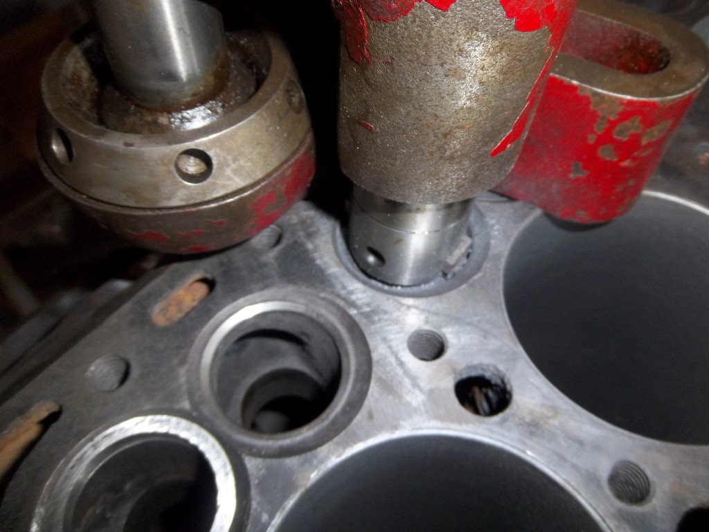

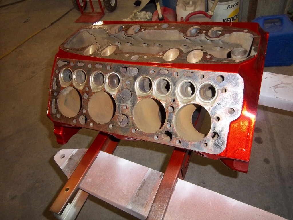

    Next I measured Pistons. We went .030" over so bore size 3.2175". Here is the block set up on boring stand and my Storm Vulcan Bar doing it's thing. My hone set up for now it takes time and you have to check size and for taper(haven't had this problem yet) and adjust and go again. I had to sleeve cylinders #3&4 when I bored them out I hit rust pockets in the bore. I found some Ford dealer service sleeves for the flat head on ebay. I finally cut the rust out at .060" over.
    100_2208.JPG 100_2209.JPG 100_2210.JPG 100_2215.JPG 100_2214.JPG 100_2266.JPG
    I will continue in my next post with more pics

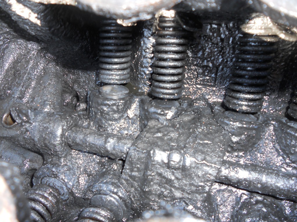

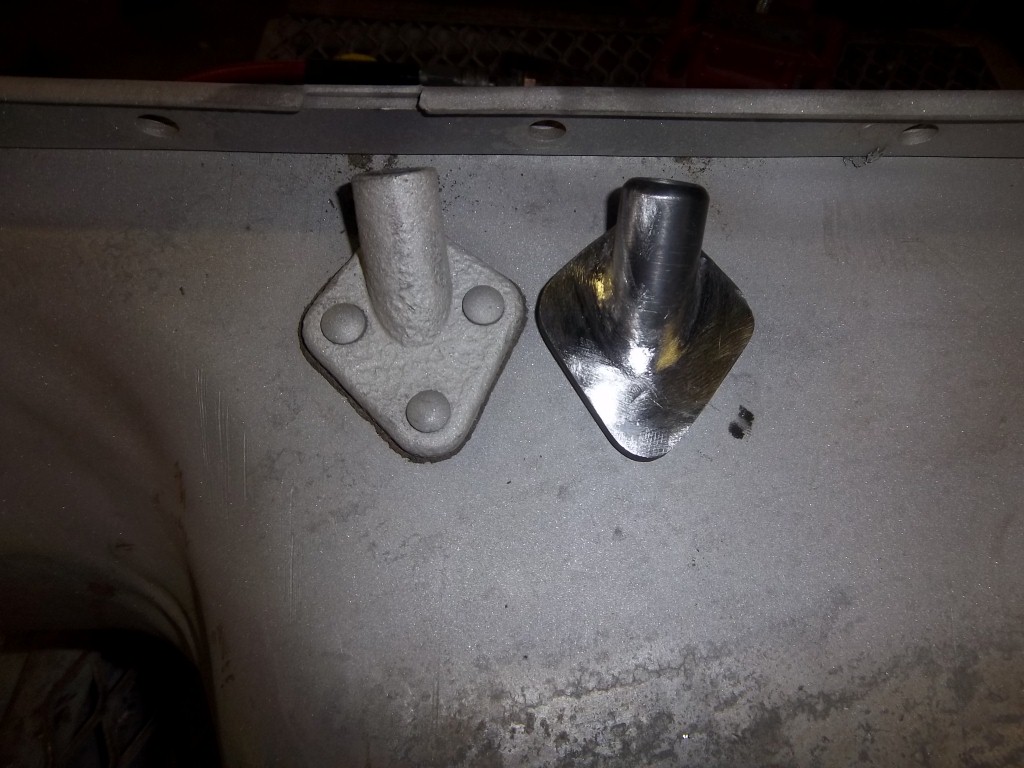

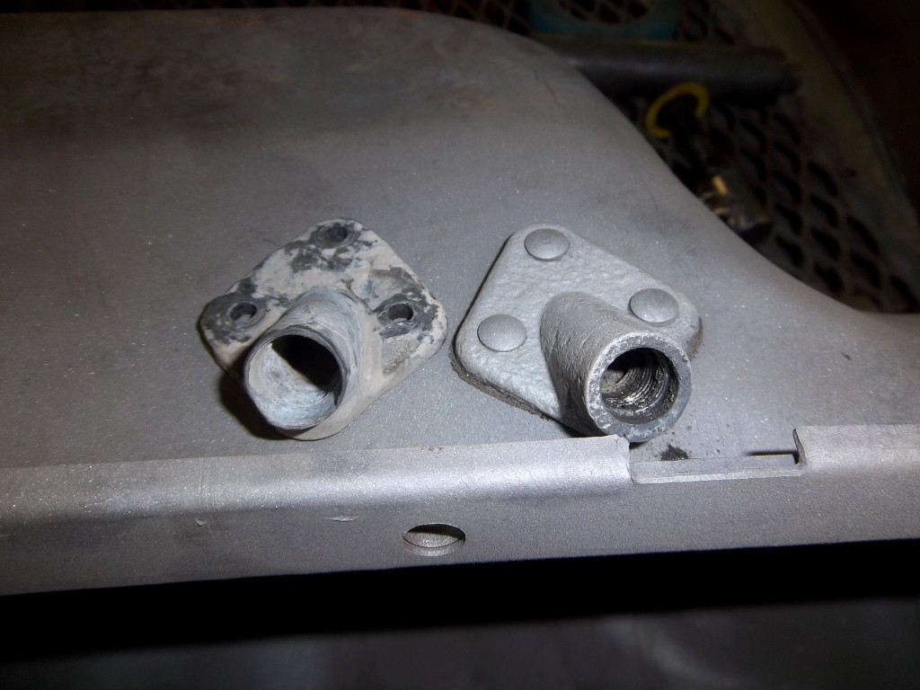

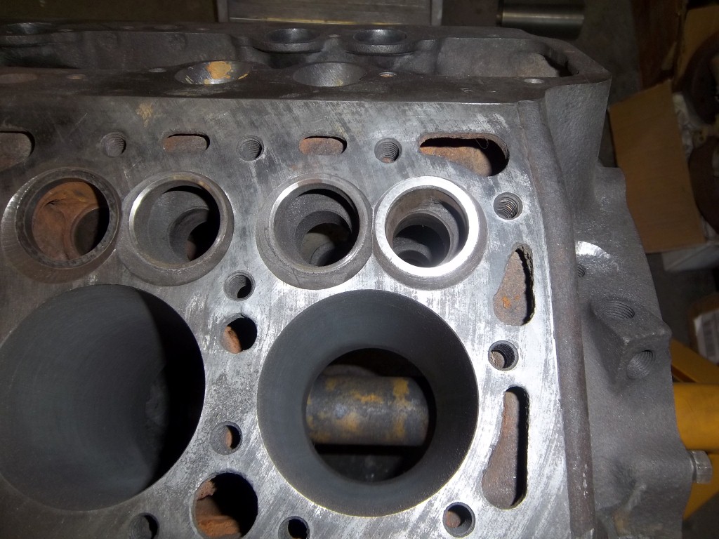

    Some of the valve seats were too pitted to grind out so I installed hardened seats in both intake and exhaust. I popped the factory seats out of the exhaust. I ordered Well-Tite W2871/020 seats for the exhaust and X505s from Martin Wells in California. I installed them with my Waterbury-Hall valve seat inserter. The hall inserter calls for .007" press fit.
    100_2433.JPG 100_2431.JPG 100_2432.JPG 100_2434.JPG 100_2435.JPG 100_2437.JPG 100_2436.JPG 100_2439.JPG 100_2440.JPG
    I blended the chamber part of the deck to get rid of the hard lines and then ground the seats. I painted the deck and scribed inside the head gasket and then worked up to that line being as careful as possible to do every area the same. I gasket matched the ports and cleaned them up a little as well as the manifolds. I made a template for the intake and used an exhaust gasket for the exhaust ports.
    100_2270.JPG 100_2269.JPG 100_2422.JPG 100_2427.JPG 100_2425.JPG 100_2426.JPG 100_2443.JPG 100_2445.JPG 100_2423.JPG 100_2424.JPG 100_2447.JPG 100_2451.JPG 100_2452.JPG 100_2454.JPG 100_2455.JPG 100_2428.JPG

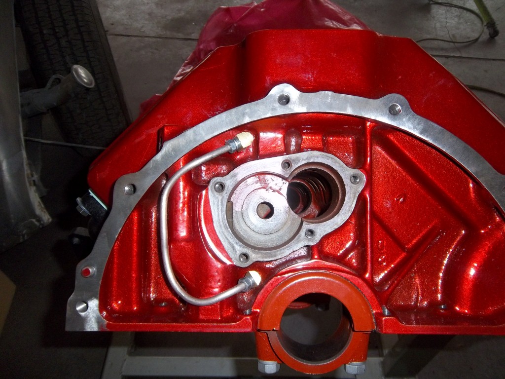

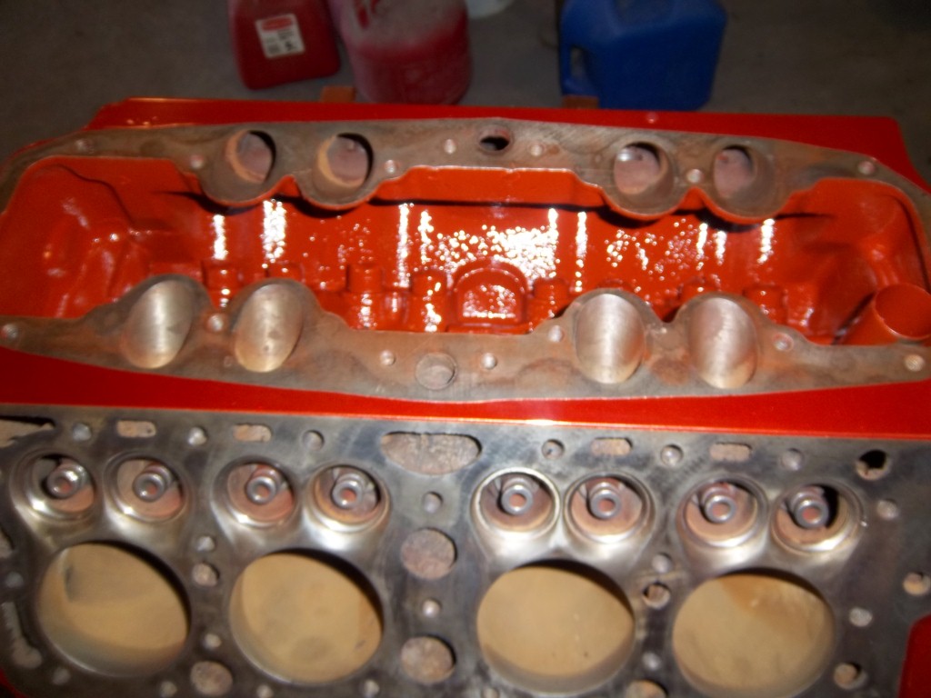

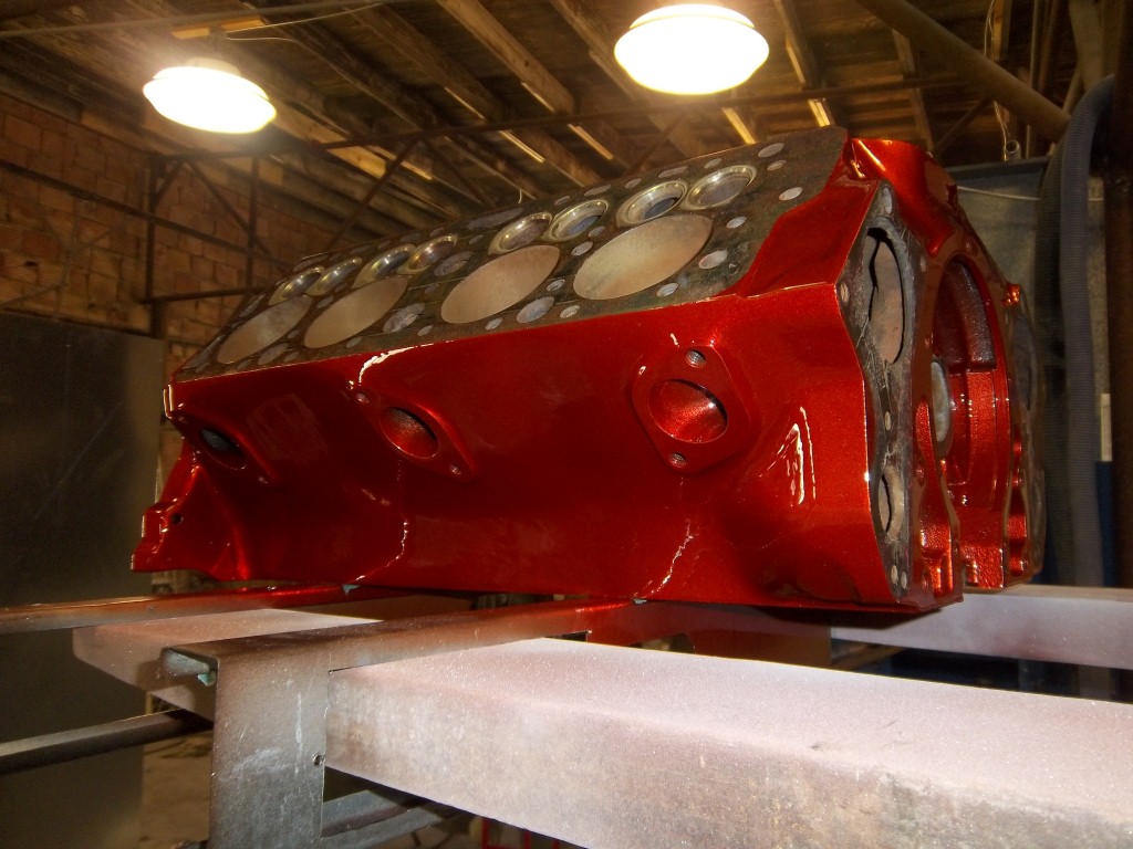

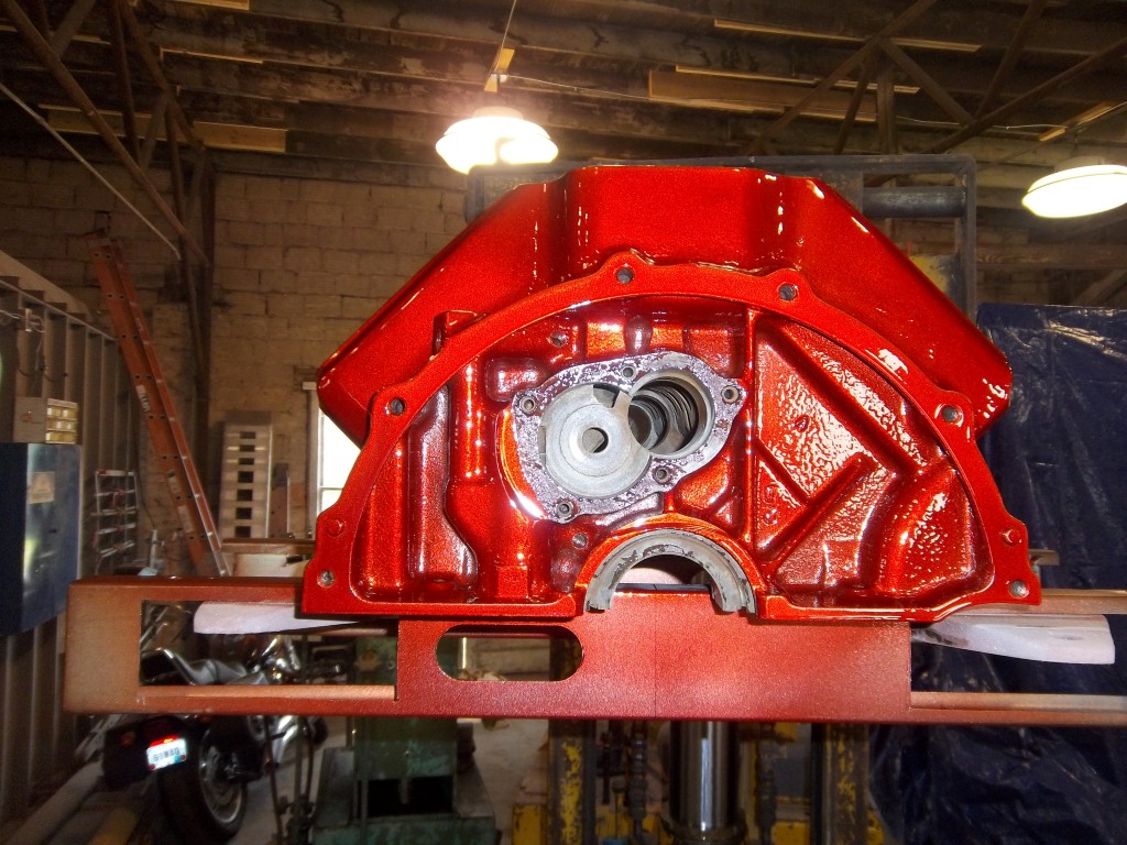

    I then steam Cleaned the block and ran brushes through the oil passages again and then spent 2 weekends smoothing the out side of the block then another steam clean. Then I taped everything off and powder coated the block and glyptol on the inside of the block. Didn't have the stuff on hand or the time to powder the inside of the block also.
    100_2464.JPG 100_2465.JPG 100_2466.JPG 100_2467.JPG 100_2468.JPG 100_2469.JPG 100_2470.JPG 100_2471.JPG 100_2522.JPG 100_2523.JPG 100_2524.JPG 100_2579.JPG 100_2581.JPG
    The color didn't show well in the pics with the shop camera. I will try and get a shot with my good camera. I wanted something kinda like the factory paint but poppier. This is a tangerine but maybe a touch on the red side and metallic really looks good in person.

    Looks like you're doing a superb job. Everything looks great. One question : If you would have known that a .060 overbore was needed to clean it up, would you have skipped the sleeves and gone right to larger pistons? I have a std bore 8BA, and I am going right to 3 5/16" for a little extra "oomph" since the cost of pistons is about the same and there should be room for one more cleanup if it is ever needed. (A 3 5/16" Ford has more displacement than a Mercury with a 4" crank and correspondingly less piston speed.)

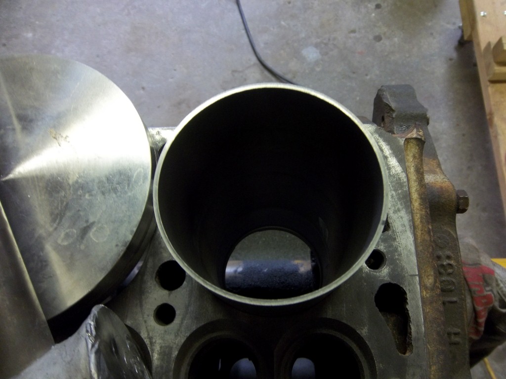

    If I would have know we probably would have just gone to .060" over. The rust didn't show in the bore until I had made a cut. I was just glade it didn't go all the way to water. My Dad didn't want to take out any more than needed to clean it up. But you are right the pistons are all about the same price for size.

    If you don't mind, could you explain how you set the sleeves? Stepped edge? What level of press fit? Any other details to help guide others in this process are helpful.

    I measure top-middle-bottom of the sleeve and rotated 90deg. and measured again. Then averaged the 6 measurements. I shot for .0025- .003 interference fit if it were an aluminum block you would shoot for .004". I left a 3/8" step at the bottom and squared it up so the sleeve would sit flat against it. The step at the bottom depends on engine-piston-position of piston in bore. Since I hadn't reached my final bore diameter when I hit the rust pockets the final bore and hone on the sleeve also cut the block. Hard to even see the line where the sleeve stops and the block begins. I wiped the bore and the outside of the sleeve with a rag that had brake fluid on it to lube it. I chamfered the outside of the sleeve and the top of the bore. I used a 1" thick ss plate I have and a heavy hammer and slowly and evenly drove it in. My two cylinders were right next to each other so I put one sleeve in and then bored and sleeved the other cylinder and the finish bored the sleeves and honed. Sleeveing can cause distortion in adjacent cylinders so if you are doing all of your cylinders you should jump around and do like every other one and then comeback and the others.

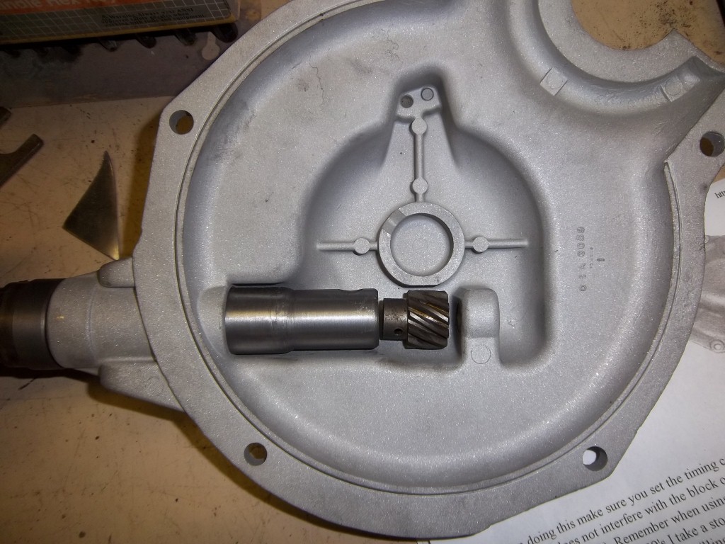

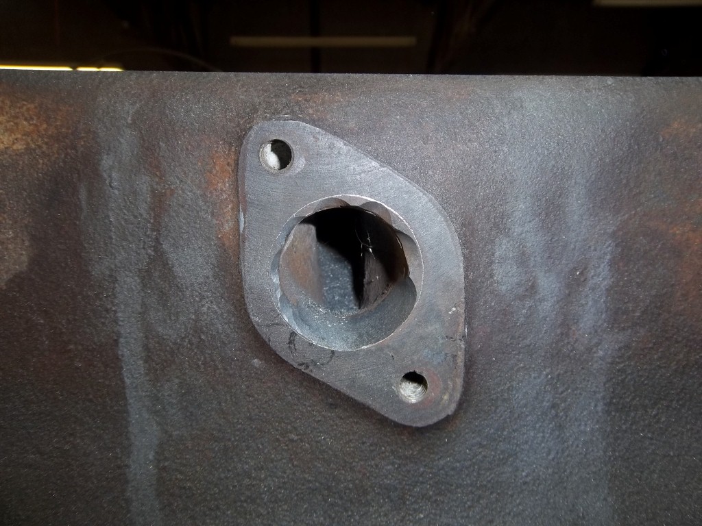

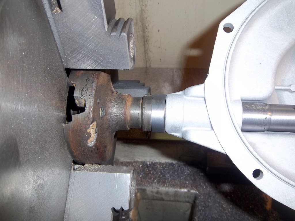

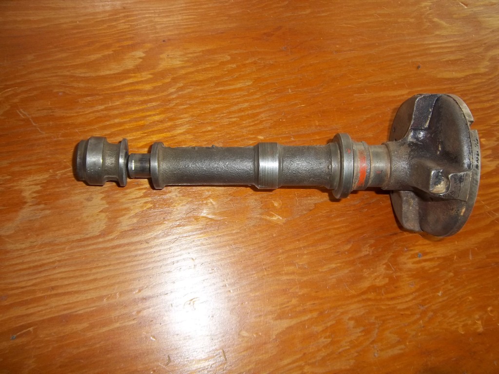

    I had an old cast iron GM Distributor from a 63' Impala with a 283 according to the tag. It was worn out so I cut it up for the flathead. I found some how-to and followed them but used my measurements as my front cover didn't match. I put it in the lathe with a live center and turned the outside down and stepped it, And cut the end off. I turned the clamping pad down to the same diameter as the boss on the front cover. I cut the dist. shaft down to length and turned the end down so the 8ba gear was a palm press fit and drilled it for a pin, I left it long and turned the end of the shaft down to fit in the lower support of the front cover.
    Length below original clamp flange 4.675"
    Length of first step 1.4" Diameter 1.060"
    Second step 2" long Diameter 1" o-ring groove in this step 2.6" from center of groove to end of Distributor
    Last step 1.275" long and .9" in Diameter.
    100_2366.JPG 100_2380.JPG 100_2381.JPG 100_2382.JPG 100_2383.JPG 100_2384.JPG 100_2385.JPG 100_2387.JPG 100_2388.JPG
    My dad took everything apart and did the first clean on it with a home made hot tank but he forgot that the dip stick boss was aluminum and it got eaten up beyond use. The rivets leak all the time anyway. So I made one out of steel to sort of match the original one. I used cleckos to hold it to the pan to check fit to the exhaust manifold. and then welded it and powder coated the pan. The dip stick tube is 1/2-20 threads so it was easy just tap my new piece and use the old tube. I plug welded where the cleckos were and added a drop if weld to the other spot and the worked it with scotch-brite roloc in a 90. Not sure you can see it well in the pics but it looks like it is still riveted.

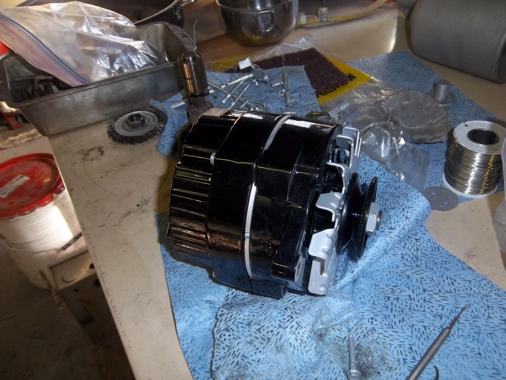

    I don't have a lot of pics of the alt. bracket. I have a terrible time remembering to stop when I am working on something and take pics. I used a 1/2" thick plate a 1/4" thick plate and 1/8"+/- plate these together give me the right spacing to match the original gen. bracket. I started with a chunk of 1/2" plate then drilled 8 3/8" holes in a piece of .100-.125 thick plate the same size as the 1/2" plate and plug welded the two together. I then milled the thin plate off on the edges to make the male step on the back of the bracket that fits into the intake. Then I milled the slot for the stud and nut that hold the fan and the alt. to the manifold. I then cut a piece of 1/4" plate in a y shape to hold the alt. and welded it to the other piece and milled the slot and milled the welds down and set it on parallels and milled the ends where the alt. mounts to make sure it is true to everything else and then I made some wings and welded on the sides.
    100_2874.JPG 100_2875.JPG 100_2877.JPG 100_2878.JPG 100_2879.JPG 100_2880.JPG 100_2915.JPG
    The last pic is of the alt. rebuilt for single wire and all powder coated.

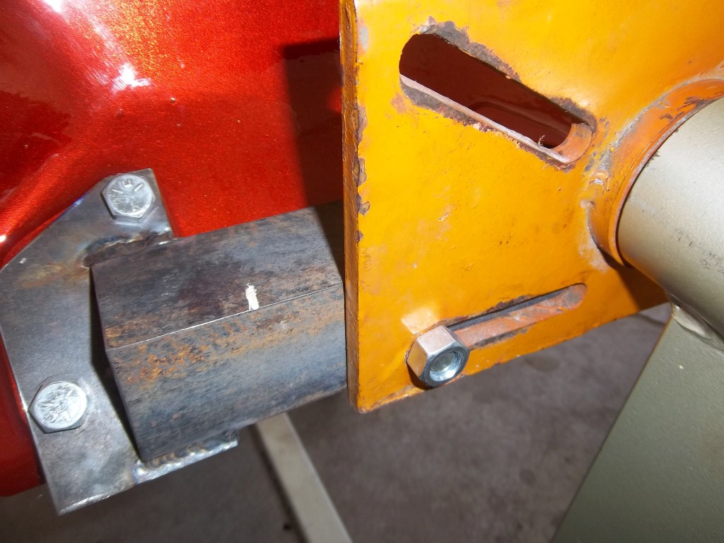

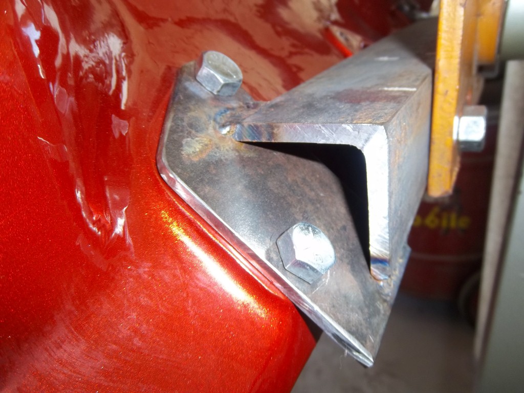

    I forgot to mention my engine stand adapter. You can see it in some of the pics in my first post. I used a piece of 2x2x1/4" angle and some 3/16" plate. I cut the 3/16" plate to the shape of a header flange and drilled hole to bolt it to the block. I bolted them to the block and then laid the open side of the angle on the two plates where I could get the bolts in and out of the block and then tacked it to the plates. I then removed the assembly from the block and finished welding then on. I centered the adapter on the engine stand plate with the regular arms removed and marked and then drilled holes to attach it to the stand. The flathead sits level and I was able to shift the block side to side in the slotted holes to get it almost balanced so it doesn't take me for a ride when I flip it over.

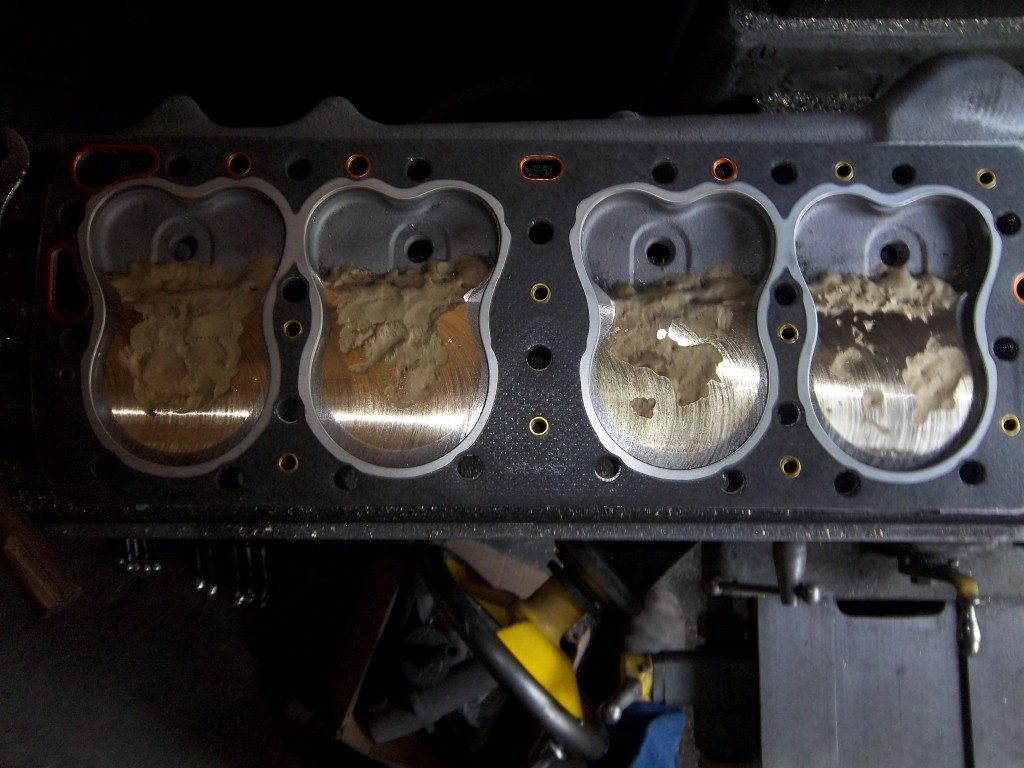

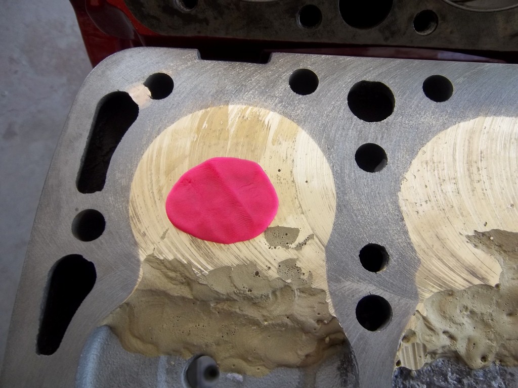

    I have been working on assembly of the short block. We are using stock iron heads but my cr numbers seem way off so I thought I would post what I did and measurements to see if everything looked okay. I have checked everything about 3 times and get the same numbers.I cc everything I could I used a glass 100ml burrett and a piece of clear plexi glass. For the gasket volume I ran a piece of string around the opening in the gasket and measured the length and then used the crush thickness to find the volume.
    Bore 3.2175"
    Stroke 3.75"
    Swept volume 499.39 cc
    head volume 75cc average
    valve relief 10cc
    dome volume 11.965cc
    dome height .255"
    deck clearance .075" 9.988cc
    gasket volume 15cc
    499.39+75+10+9.988-11.965+15=597.413 /(75+10+9.988+15-11.965)=6.095-1 cr
    I think it is the deck clearance number that is dropping the number so much it is a little over twice the factory number.
    D Smith

    I put the head on to check clearances and to cc piston dome and valve relief . 100_3051.JPG 100_3052.JPG

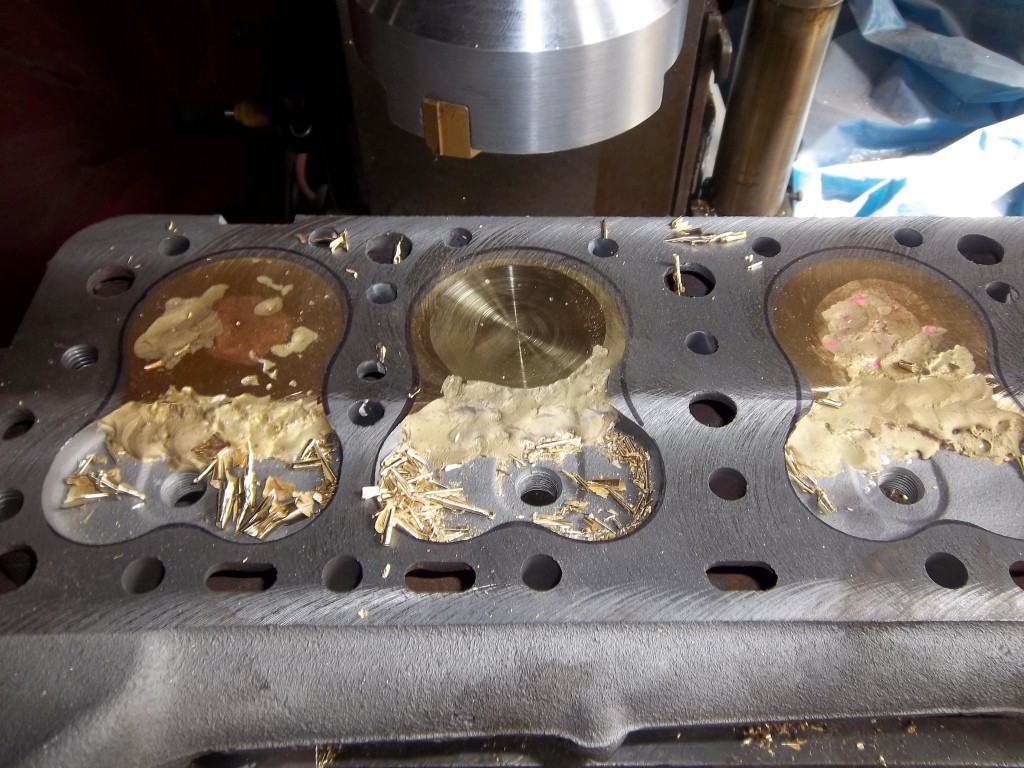

    Sorry it's been awhile been busy at work and the head work took a lot longer than I wanted but we should have 7.6:1 compression now. So I went old school and filled and milled the heads. I used stock 8ba head with an average cc of 75. I blasted the snot out of them and then heated them up to 550 deg F in our powder coating oven and then brazed up everything and then back in to the oven for an hour at 550 and then I killed the oven and let the temp drop slow.
    100_3226.JPG 100_3061.JPG 100_3064.JPG 100_3223.JPG 100_3224.JPG 100_3227.JPG 100_3228.JPG 100_3229.JPG

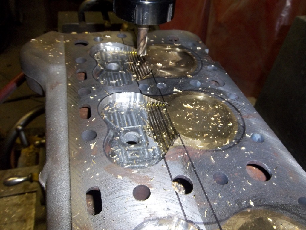

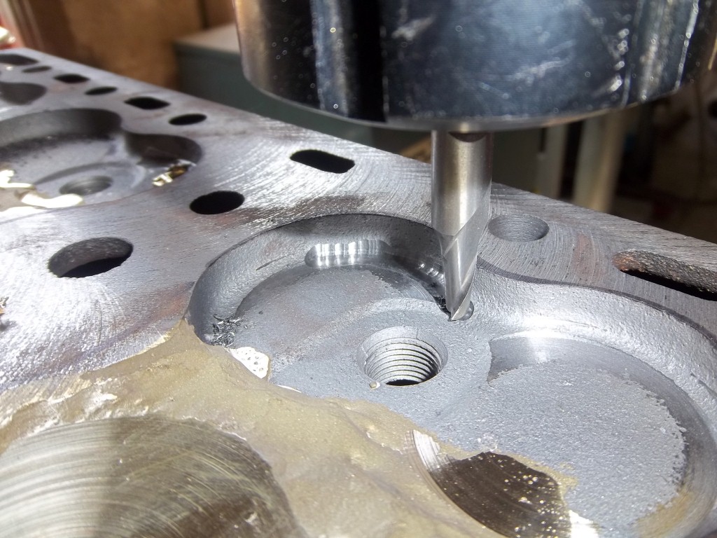

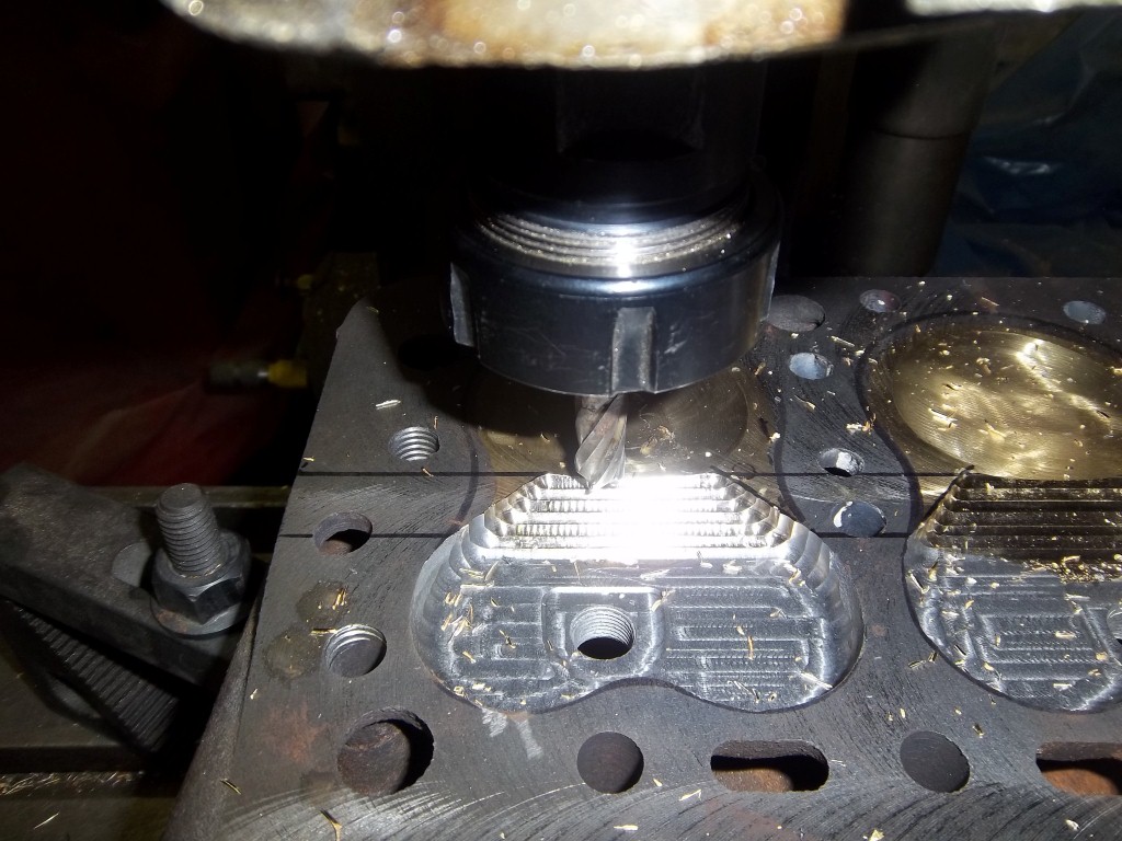

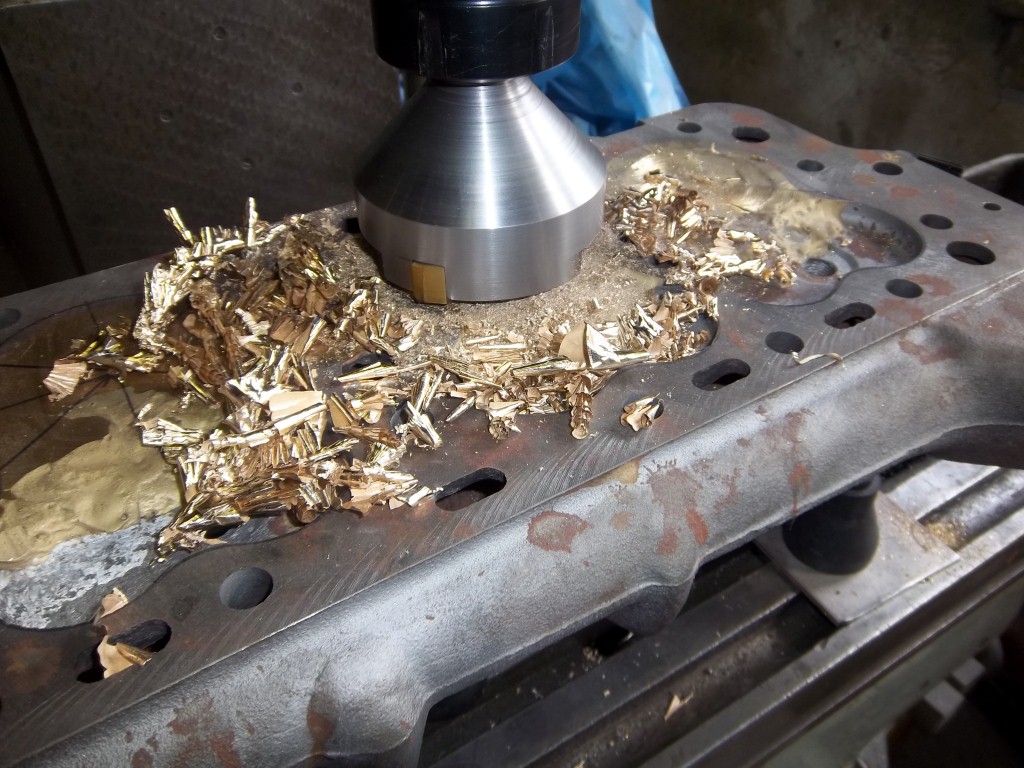

    I then set up in the mill with a fly cutter and cut the head until it was flat. I then set it on the engine and spun the engine over slow with clay on everything to find center and rough clearances. I center punched the the center and then drilled a hole to help center the cutter.
    100_3230.JPG 100_3231.JPG 100_3232.JPG 100_3245.JPG 100_3243.JPG 100_3244.JPG
    I made a cutter that matched the piston dome as close as I could and then measured how far out of the block the dome protruded and subtracted the gasket thickness and .050" squash clearance and machined down to that depth.
    Then I cleaned the heads back up and put them back on the block and clayed everything again. Then back to the mill to open up the valve pockets for clearance and to machine the transfer area. I stepped the cutter up and over and then blended with a roloc and scotch brite. Then checked clearances again. The last step before coating was to cc the heads. Right out of the box all the chambers on each head were with in 2/10ths of cc but the two heads were off 2cc from each other. So that took a bit of finessing.
    100_3409.JPG 100_3420.JPG 100_3423.JPG 100_3435.JPG 100_3436.JPG 100_3437.JPG 100_3469.JPG 100_3470.JPG
    I set up and trued the head bolt pads on the head after coating and then bolted them on.
